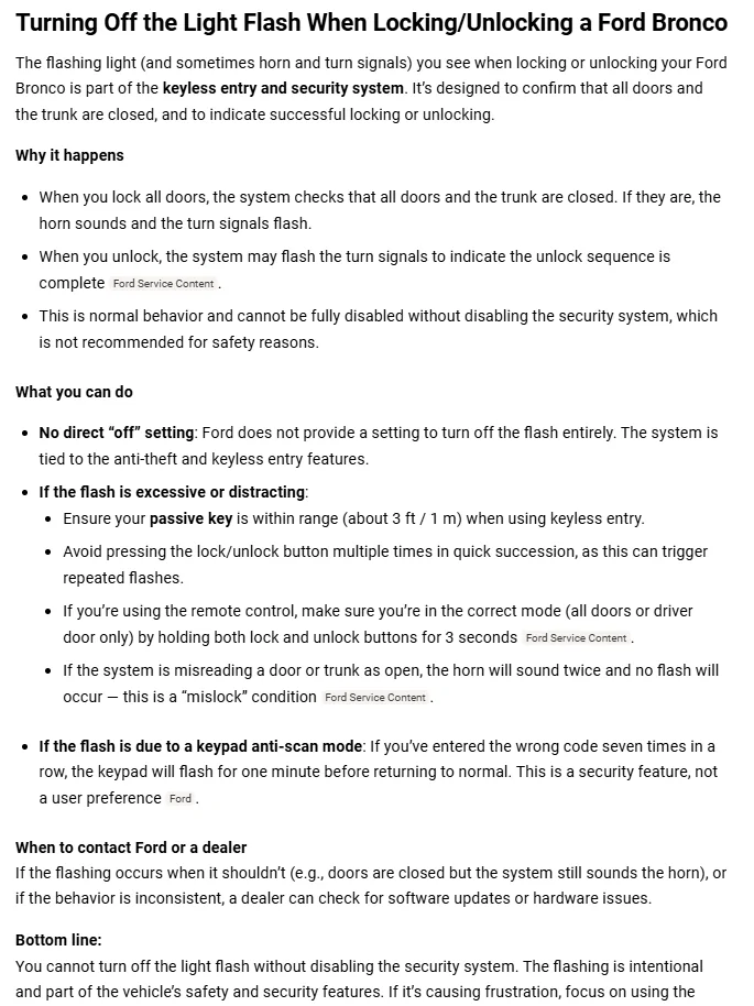

I tried a search but it did not return any results. Surely this has been discussed and I just missed it. Is it possible to turn the feature off that flashes the park lights when locking/unlocking ? I hate when at a campsite after dark that it lights up the area when I need to get something out of the Bronco.
Thanks
Ai says no go :(
Ford Bronco Stop light flash when locking/unlocking light flash
