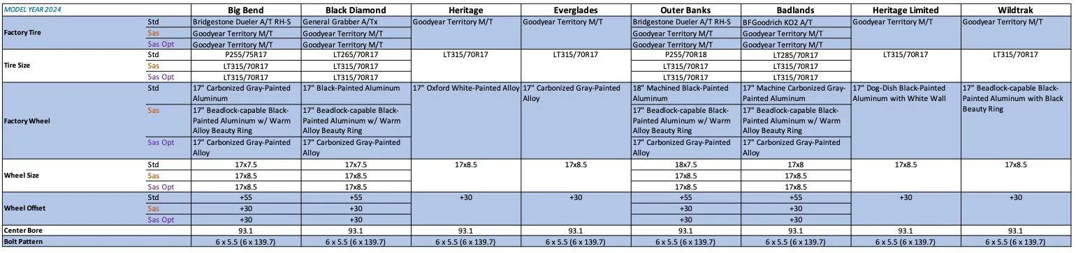

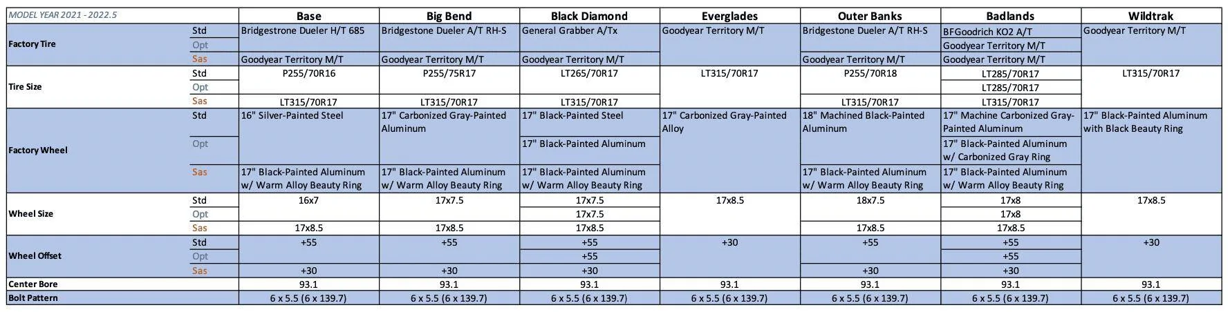

Copy/paste from my post over on Bronco Nation. That chart is for 2021-2022 model years, and some of the wheels in the chart are no longer available, and obviously I'm missing the newer trims like Heritage. But the sizes haven't changed.
Ford Bronco Stock offset 1730568133764-rl
EDIT—

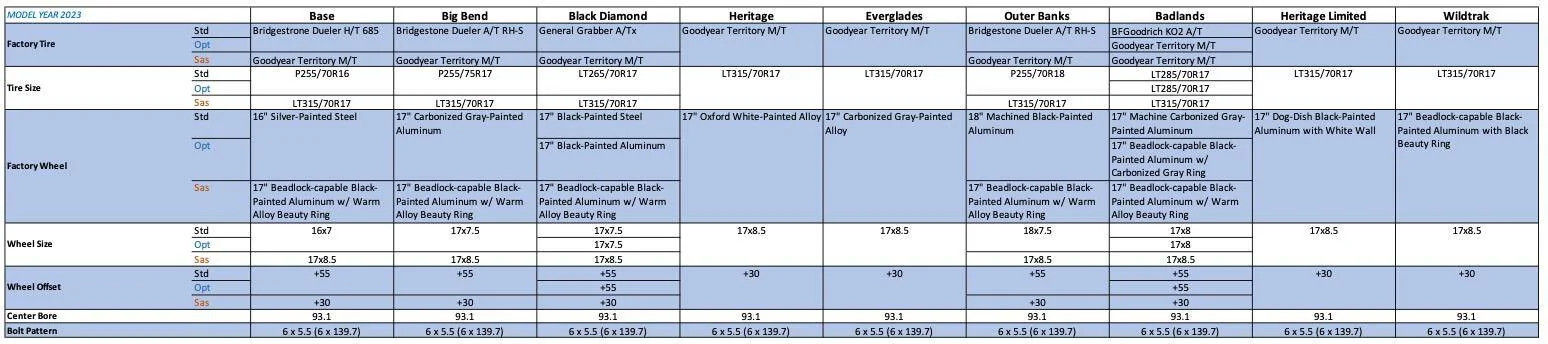

Decided to update it... 2023/2024 chart below.
Ford Bronco Stock offset 1730569881637-cd
Ford Bronco Stock offset 1730569891498-x8
