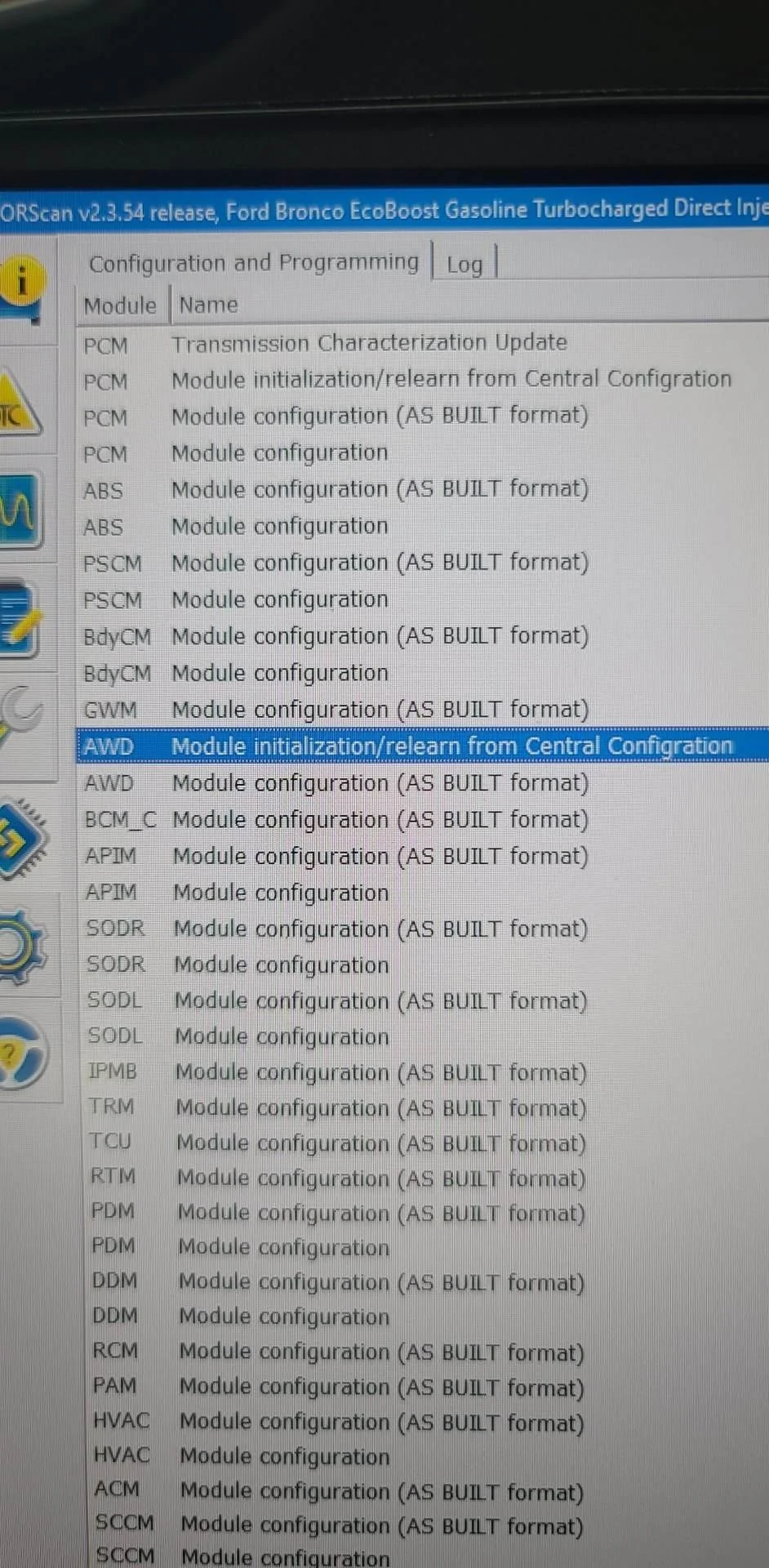

I paid the $12 for an extended Forscan license. This piece of software is so useful that I find it very easy to justify sending the developer $12. Changed the circumference yesterday to 2525 (there was another thread where multiple people confirmed that these are the factory numbers), but this morning I got a "Check 4x4" warning on the dashboard. Wondering if it is related to the change. Will return to 2440 tonight and see if the problem goes away.

no its ok... do what I mentioned with the AWD part. Its a relearn that HAS to happen. It takes a click and its done!
it also lets you adjust that tire MM size to exactly what you want. I mean you can download a GPS app to your phone and see where your # lands you. Then adjust it again. During this time you can drive around the block and then change it for more accuracy. but durning this time you can leave the wrench light on the dash. Once you are happy with your 40, 50, 60 or 70 mph results... then park it and do the relearn. DONE.

And just like this the Check 4x4 message is gone. Many thanks, I was thinking that I need a trip to the dealer.
