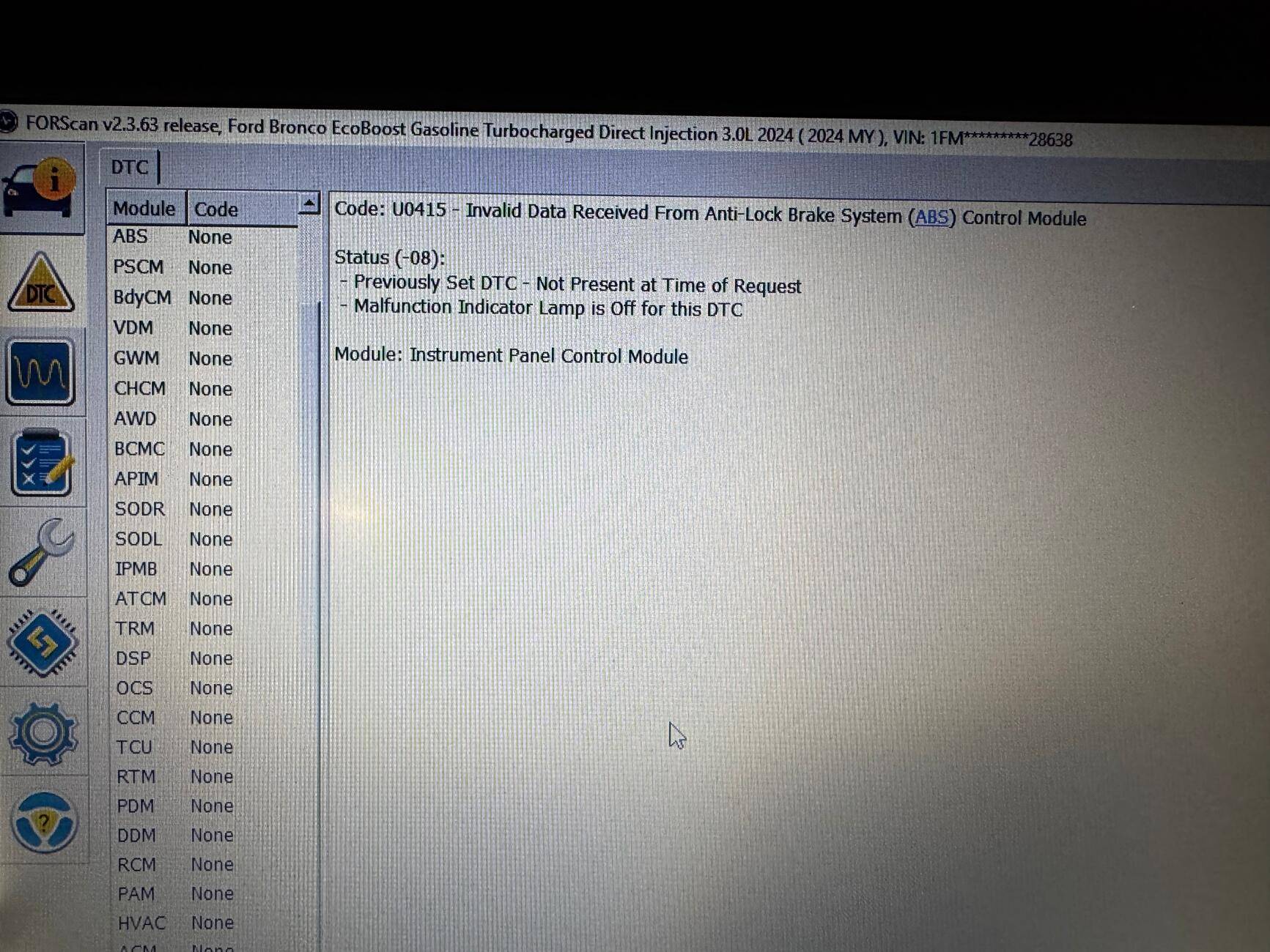

Scanned the bronco and this was the only DTC that was logged. Not sure if it's helpful or not but that is all I have at the moment.
Thanks again for the reminder.

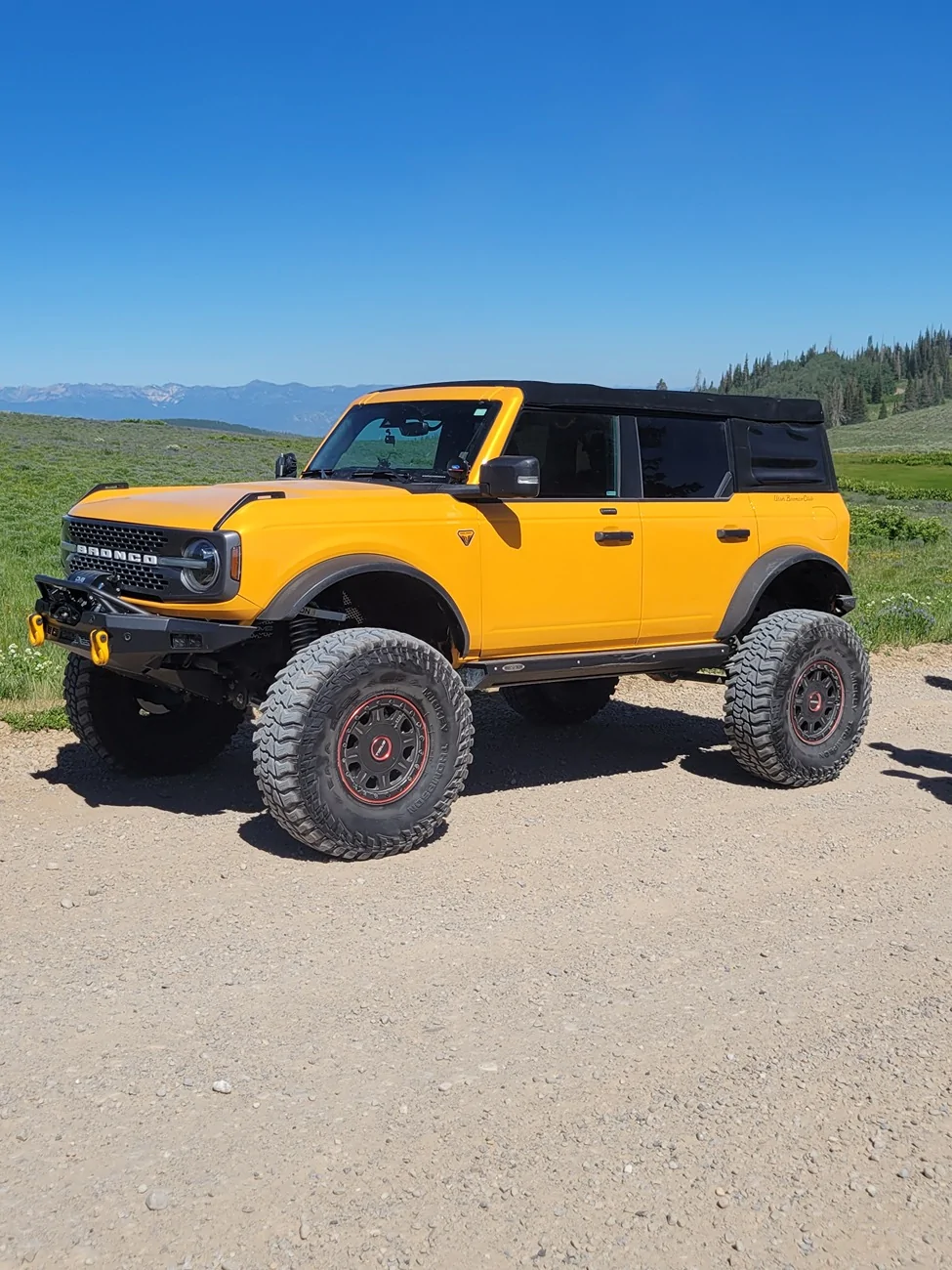

I've had this problem ever since I had the Hoss 3.0 rack installed. I'm running 40s so I thought it was just the tires causing the fault but now after reading this thread I think it may be a wiring issue. I'm going to take it in to see what they say. 2021, 2.7 badlands, tons of mods...
