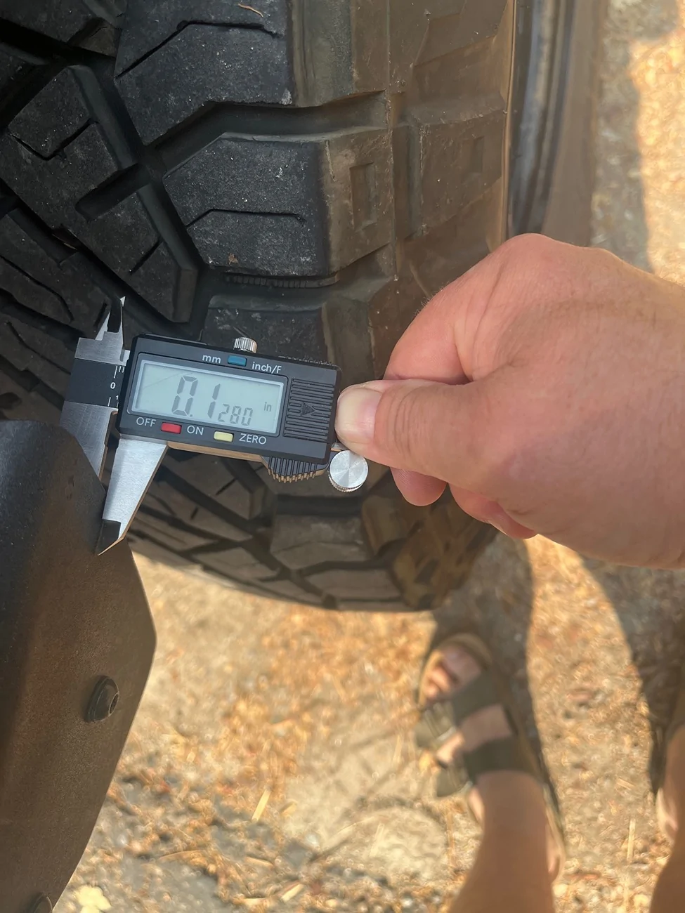

My mod is 0.130” on the exterior - so 10 gauge ~ish
I can’t recall if the internal reinforcements are the same gauge or not - but probably
Not sure about the capable but would be surprised if it’s much different
Thanks so much for measuring that
