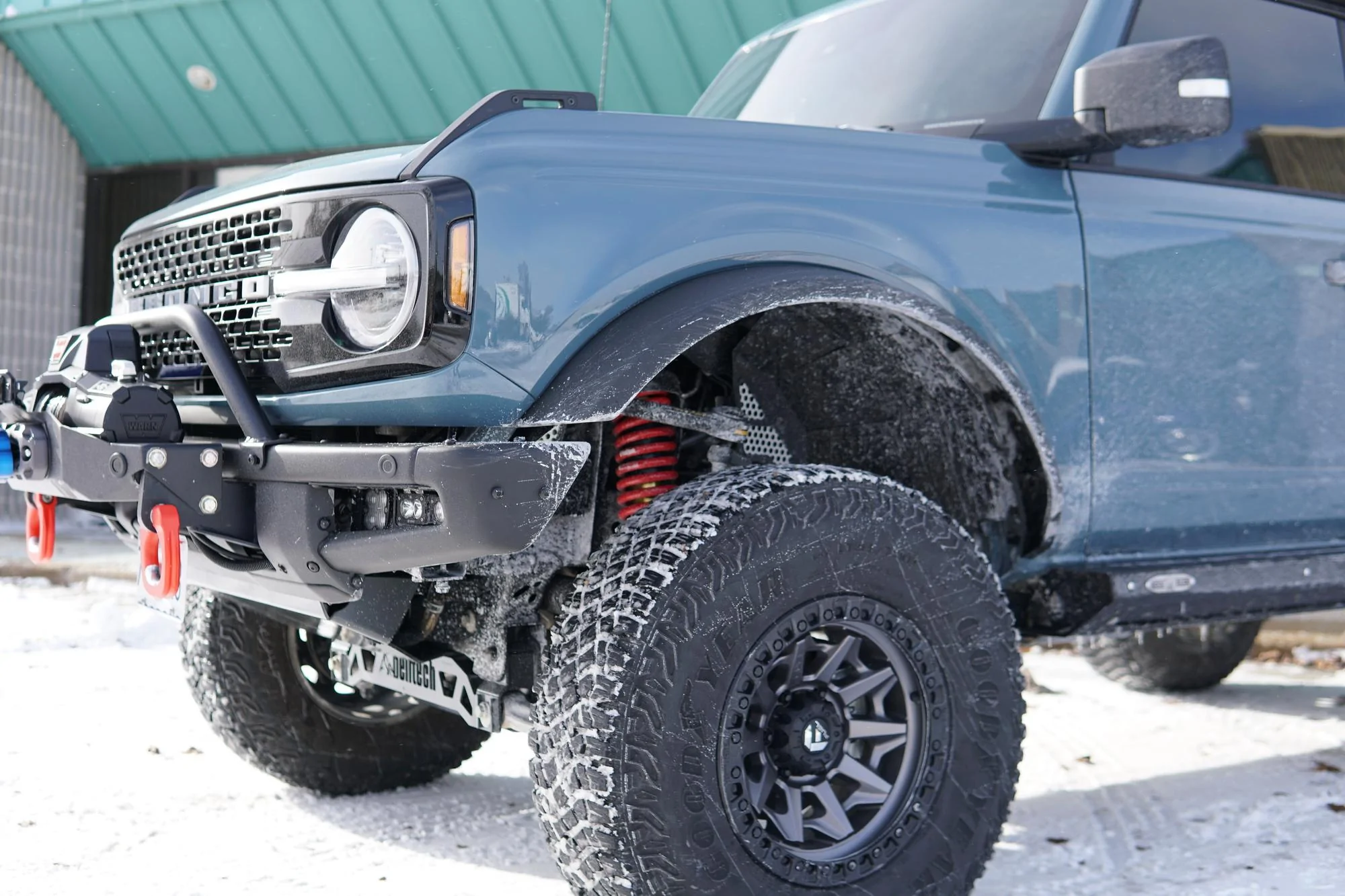

I was in a similar situation with my 22 Wildtrack after I added ~400lbs of bumper, winch, skids, rails, etc... I went with the full Dobinsons IMS kit (IMS shocks, 566/569 springs, track bar, lower arms, and Icon UCA). They offer different capacity springs matched to their height adjustable monotube shocks. Ride quality is subjective, but I've been happy with the ride and increased control over the stock SAS Bilstein setup.
  • Front Coil Spring Specs
    • 2.3L Engine
      • C19-562 - Raised Height (Stock Load)
      • C19-564 - Raised Height (110-220lb Load)
    • 2.7L Engine
      • C19-564 - Raised Height (Stock Load)
      • C19-566 - Raised Height (110-220lb Load)
  • Rear Coil Spring Specs
    • C19-563V - Raised Height (Stock Load)
    • C19-565V - Raised Height (0-110lb Load)
    • C19-569V - Raised Height (150-350lb Load)
Dobinsons IMS kit (height adjustable only)
https://dobinsonusa.com/products/do...ft-kit-ford-bronco-4-door-2021-on-dsskit22fb/
This kit wasn't available when I ordered, but could be the subject of a future shock upgrade...
Dobinsons MMR kit (3 way adjustable plus height)
https://dobinsonusa.com/products/do...-for-ford-bronco-4-door-2021-on-dsskitmrafb4/
I limited my install to two inches up front with plans to raise once I address the 2.0 steering rack.
