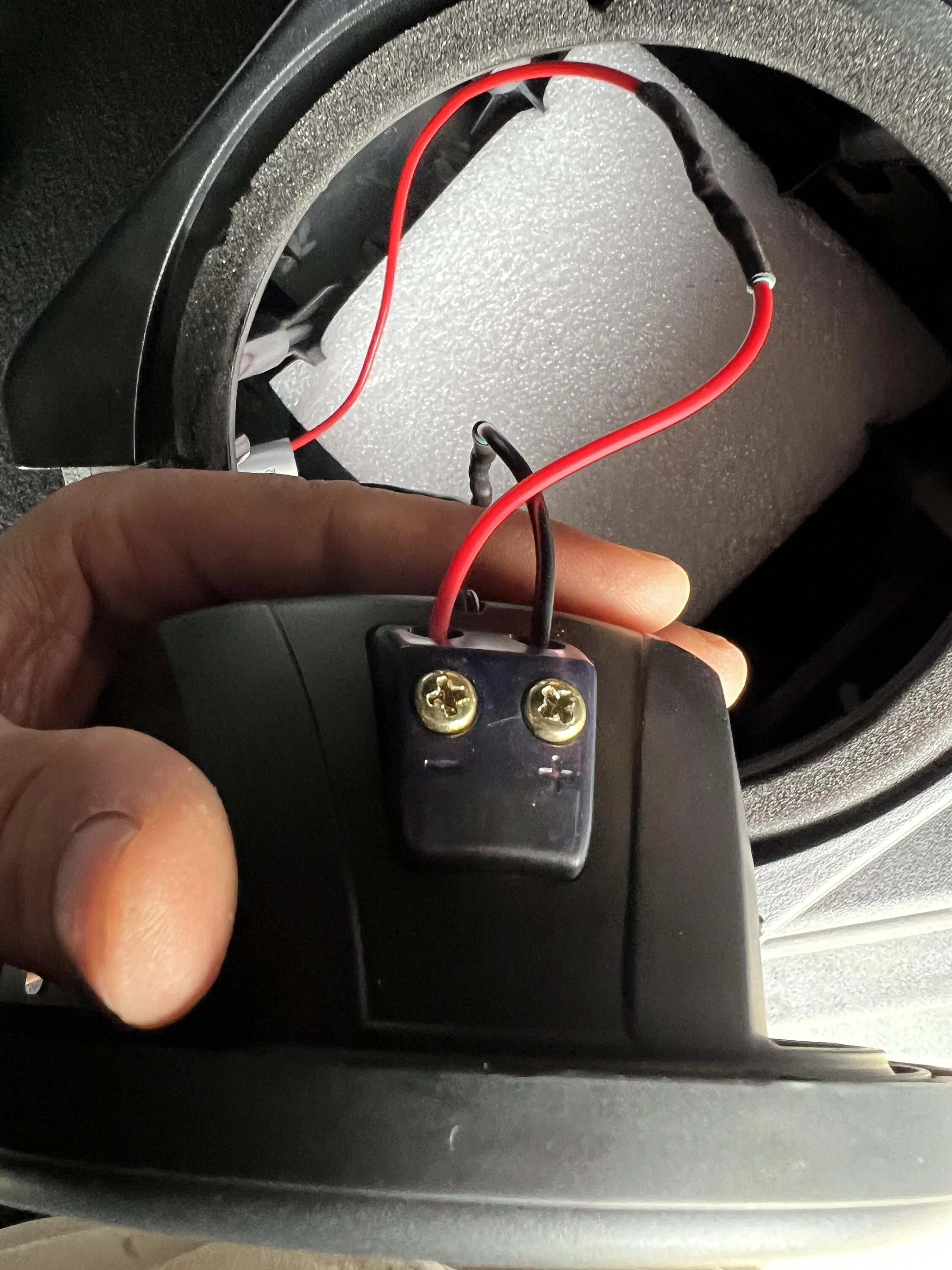

I have the SSV. Mine had the polarity backward at the SSV connector. There are good Ford diagrams in this forum to validate if you search for them. “Trust but verify “ It made a big difference.
I added foam to the back for sound improvement.
Could have been a bad Bach.
quick fix.
quick fix.
