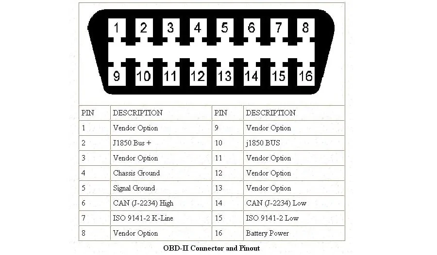

ODBII port would work. It would allow quick install and removal. I wouldn't put too much power through it. A couple of amps should be OK.
Pin 16 is battery, pin 4 is chassis ground.
