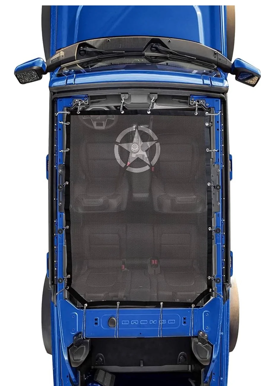

After an successful experiment with some insulating board scrap I had lying around, I added a new cut-to-fit sheet of 3/4 inch insulating foam board over the roll bar. $25 for the kind with a reflective side from HD. Cut the length to reach from the windshield frame to just over the rear speaker SSV pods.
This was over an Amazon sunshade on sale for $40, and under the soft top canvas.
Ford Bronco Soft Top - Mod for Sound (Stereo Audio Quality) IMG_1401
Results were massively improved soundstage, clarity and bass. More on sound later.
Around town driving noise, lessened. The cabin is much quieter. Highway driving no improvement - I’d have to add a layer of that mattress foam in there to press on the canvas I think, like others who’ve gone that route.
Cabin temp control - I noticed an improved experience. Parked out in sun 100 degrees plus this afternoon, it didn’t get flaming hot as usual inside, needing to open all windows to ventilate. Just a bit warm - blast AC and go, I was really surprised.
The sound improvement was the biggest win. Hertz speakers, JL Amps & Sub, but the sound was so weak til this “acoustic paneling” was in. I thought it was my tune. Never could hear the rear pods in any realistic fade setup, voice stage was muddy, and sub bass had no musicality. Now I hear it all, passengers noticed too.
I’m looking forward to one day getting an Armadillo hard top but this has sure lessened the urgency for it.
