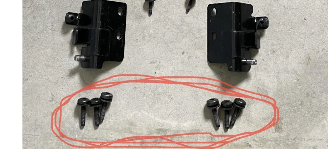

I also just purchased a soft top from another member here. The long brackets are already on your Bronco but you’ll need the short brackets over the rear seats. I think these bolt down with the same bolts used on the hard top. You’ll also need the two clips that hood down the rear base of the soft top that allow for the tilt up function. I need to go to the hardware store and get the six 13 mm bolts for the soft top frame. They’re the same size as the other hardtop torx head bolts (M8 1.25).
I think all of the hardware can be left installed under the hard top also making the swap even faster the next time.
This Is everything needed except for the 6 bolts.

Great Post! Know size information for these bolts?
What is the name and part number for the the two brackets above the red circled screws. Thanks, I think I have all the parts except the 6 circled screws and the two brackets above the screws. Thanks in advance...
