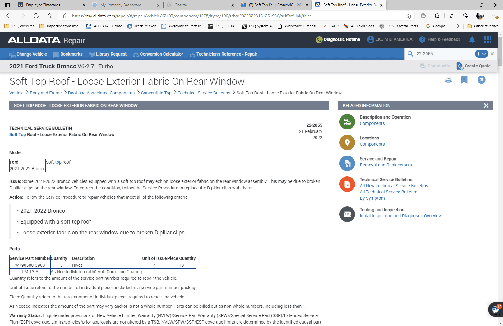

I did the same thing this week, Ford Does have a TSB for it ( 22-2055 ) where they use rivots to reattach both side. Much stronger and its covered under warranty.

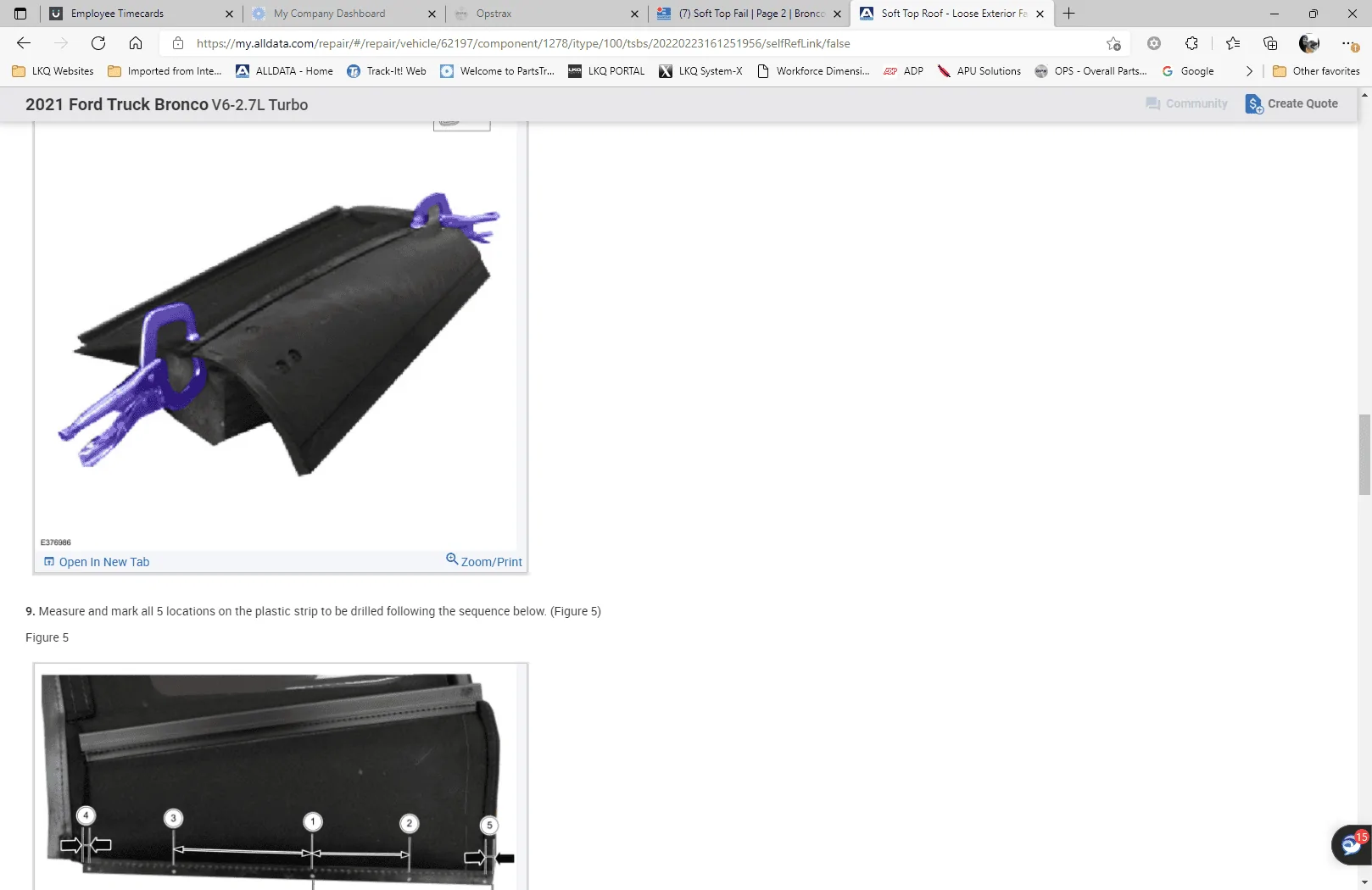

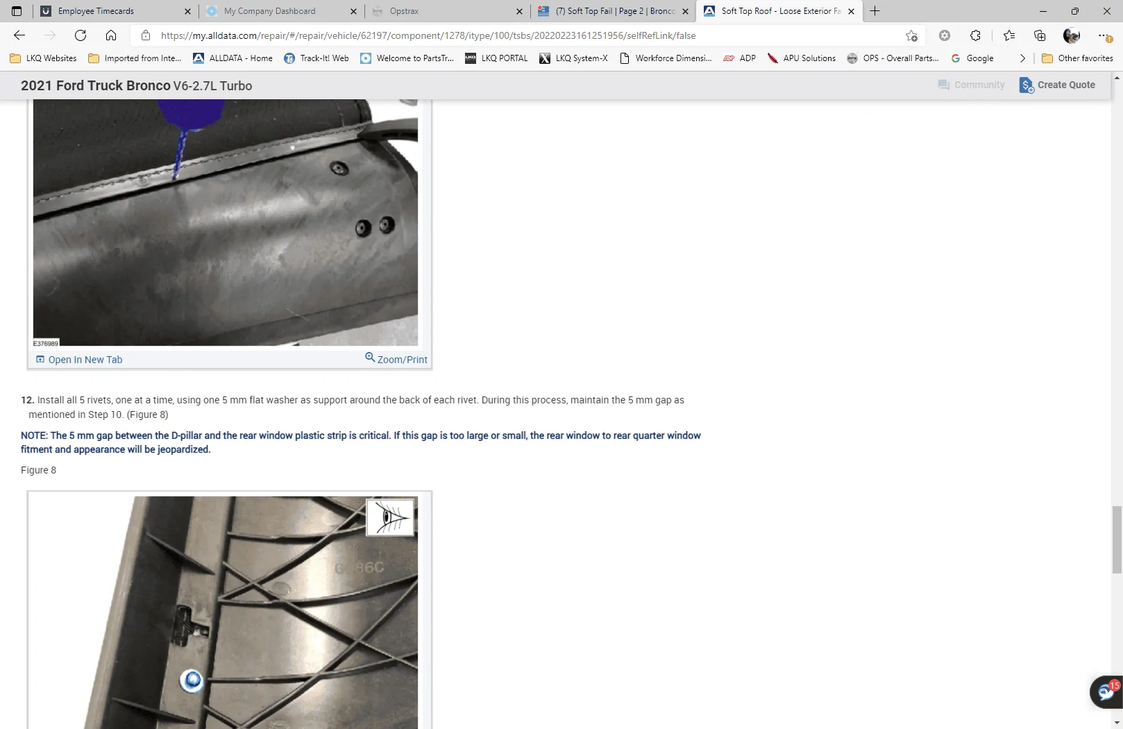

Pics of how they are doing it. looks like a simple and much stronger fix

The rivets are backordered and about $8 each.
This is the TSB.
I modified the process a bit to fix mine using 1/8 X 5/16 aluminum rivets.
IF you DIY, make sure and run the rivets in from the inside of the seam out so it has the thicker corner plastic to pull against vs. the super-thin plastic inside that fabric seam.
It's not hard, but it's not necessarily easy either.
More nerve-wracking than anything.
Truthful advice if it's covered under warranty, I'd let the dealer sort it out.
but if you don't, just use care and caution.

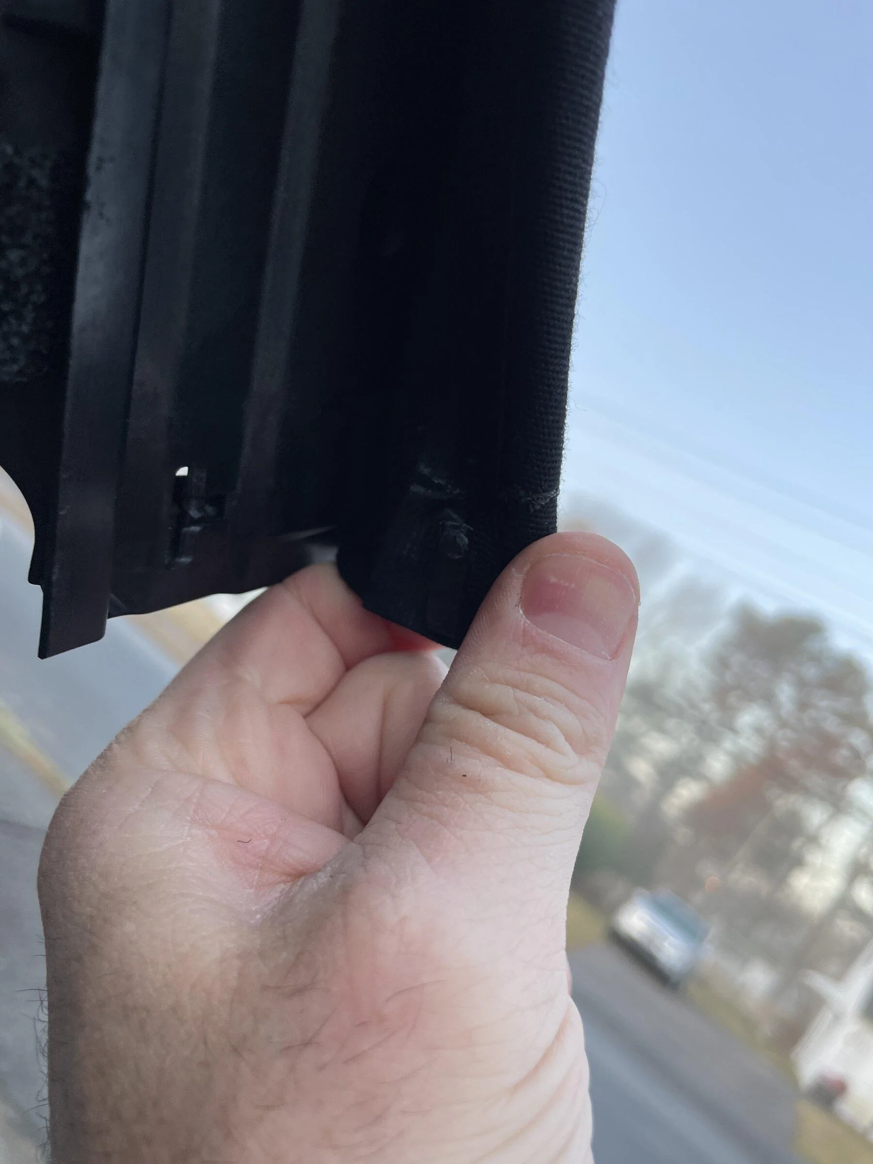

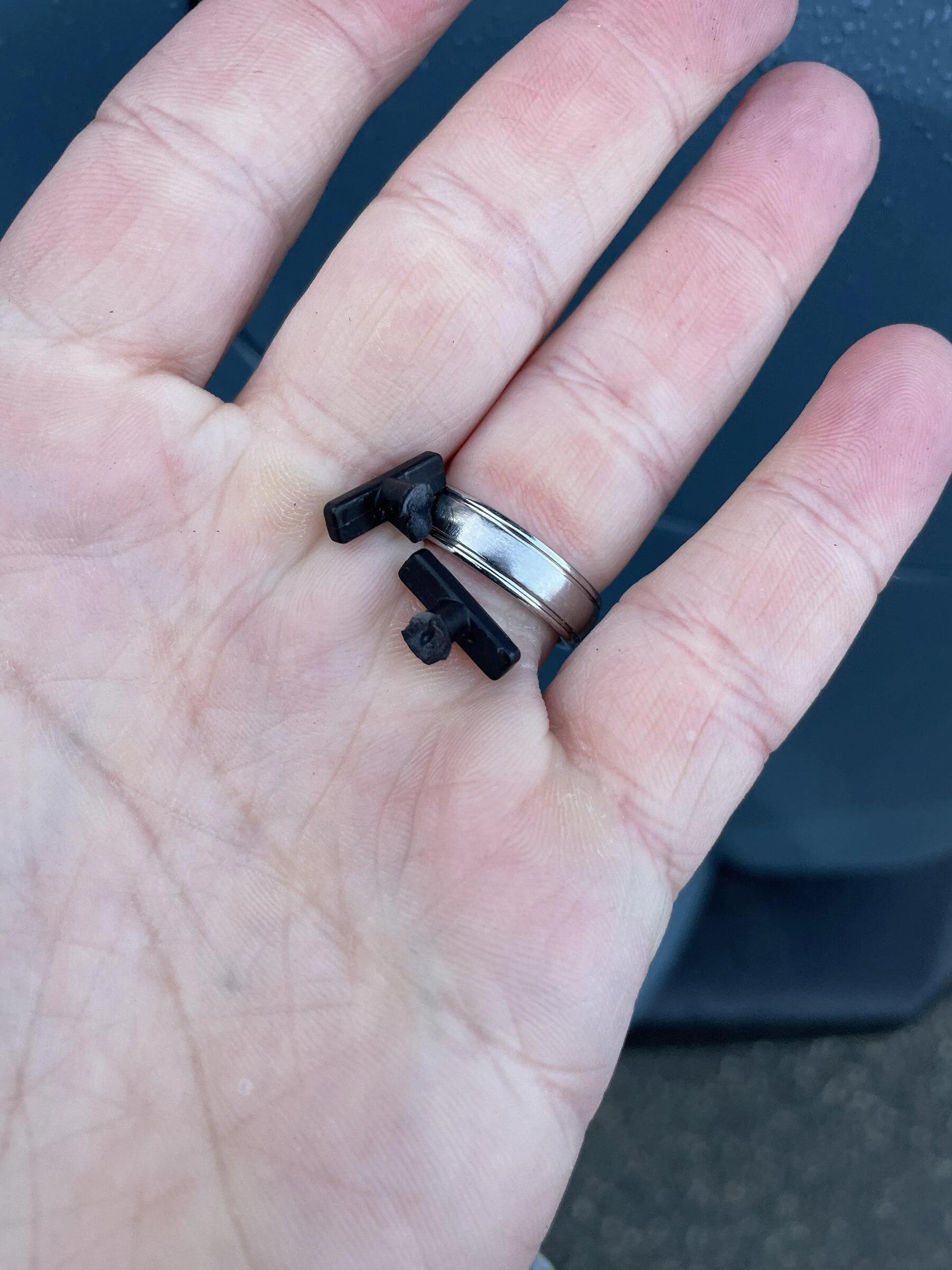

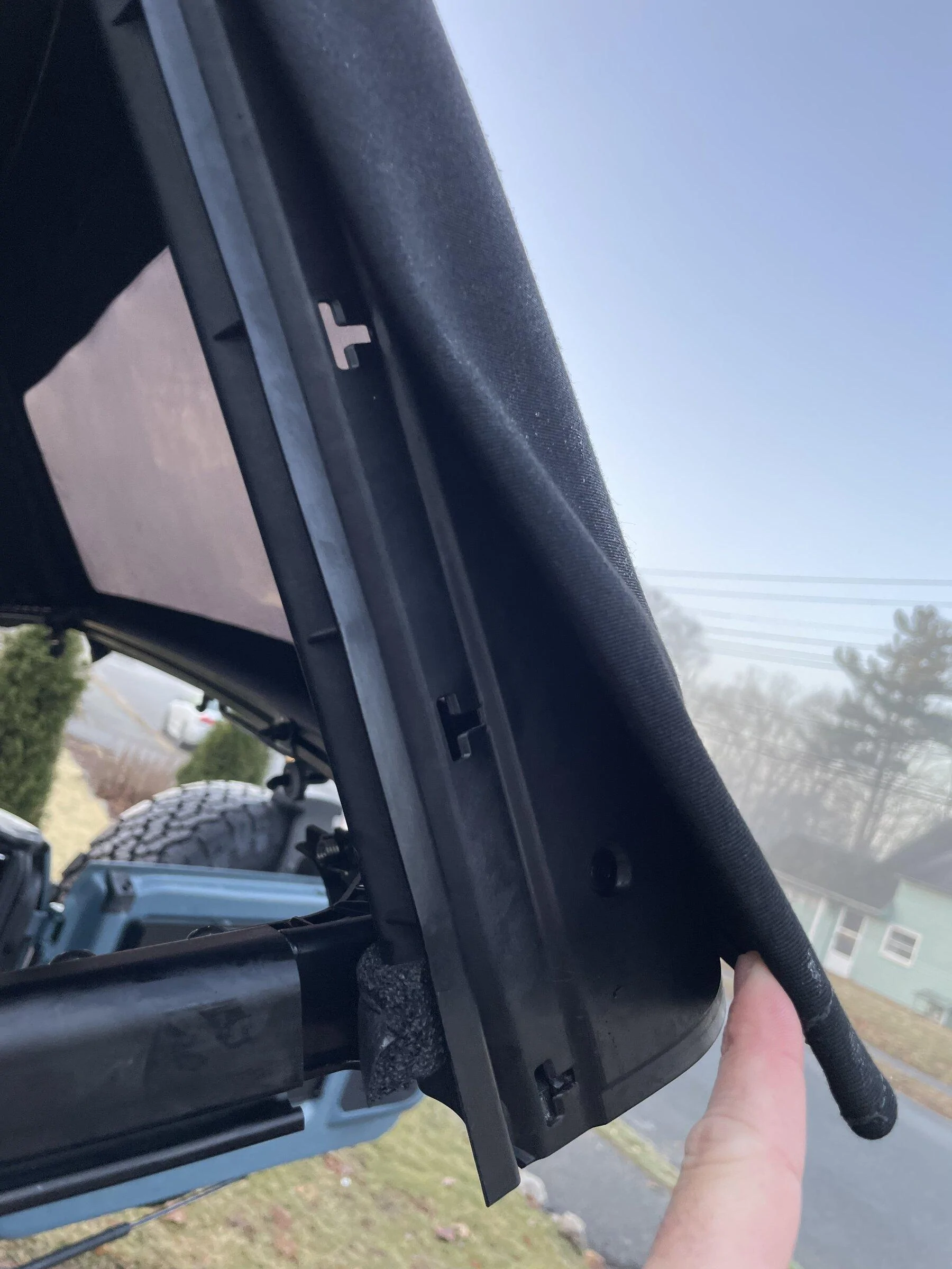

Well sh$t. Was very excited for over 70 today in MA and wanted to take the windows off the soft top. Even after watching the video numerous times I still screwed up. Overall it was an easy process and not the tops fault, but much like many first times...it wasn't smooth and I broke some clips. Pics below.
Thoughts on if I can fix or do I need a new rear window? Any idea of the cost of new rear window?
Might be worth taking to your dealer and "playing dumb" saying it broke when you were putting the top back together, had a friend get his back panel replaced for free under warranty this way after he broke his the same way.

hey i just took mine off at lunch too 70 at this time in ma is amazing!! sorry it happened i did see someone else on here fix theirs with wire I watched videos on it and still had no idea how to remove the rear window i was so afraid i would break it. good luck
