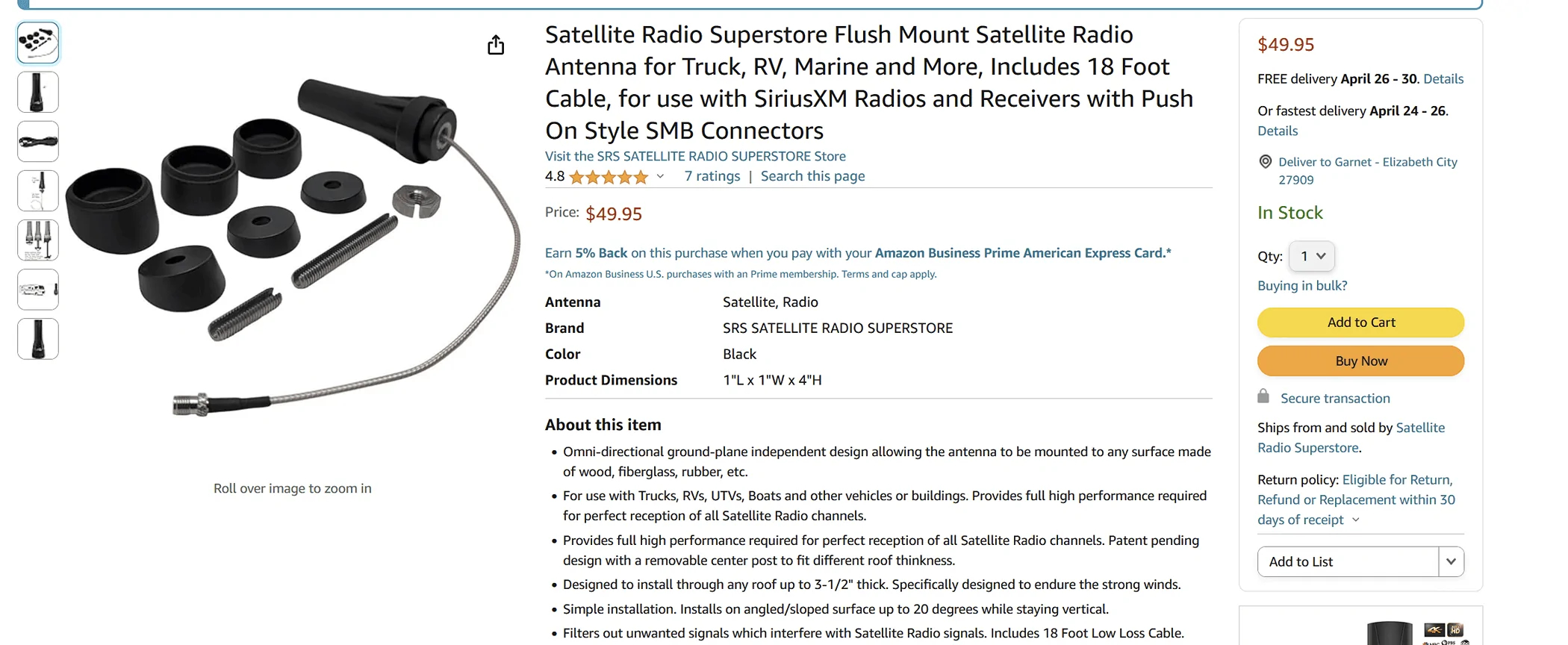

I replaced my stock Sirius antenna with this one, radio fired up immediately and the reception is perfect. Lost GPS though.
Ford Bronco SiriusXM reception Sirius Antenna
