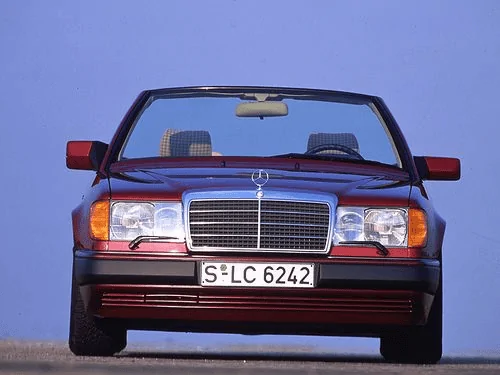

Used to it as I had several mid 80s-mid 90s Mercedes e-classes. The all had one rectangle mirror and one square mirror. Some people would trade mirrors with RHD guys overseas.

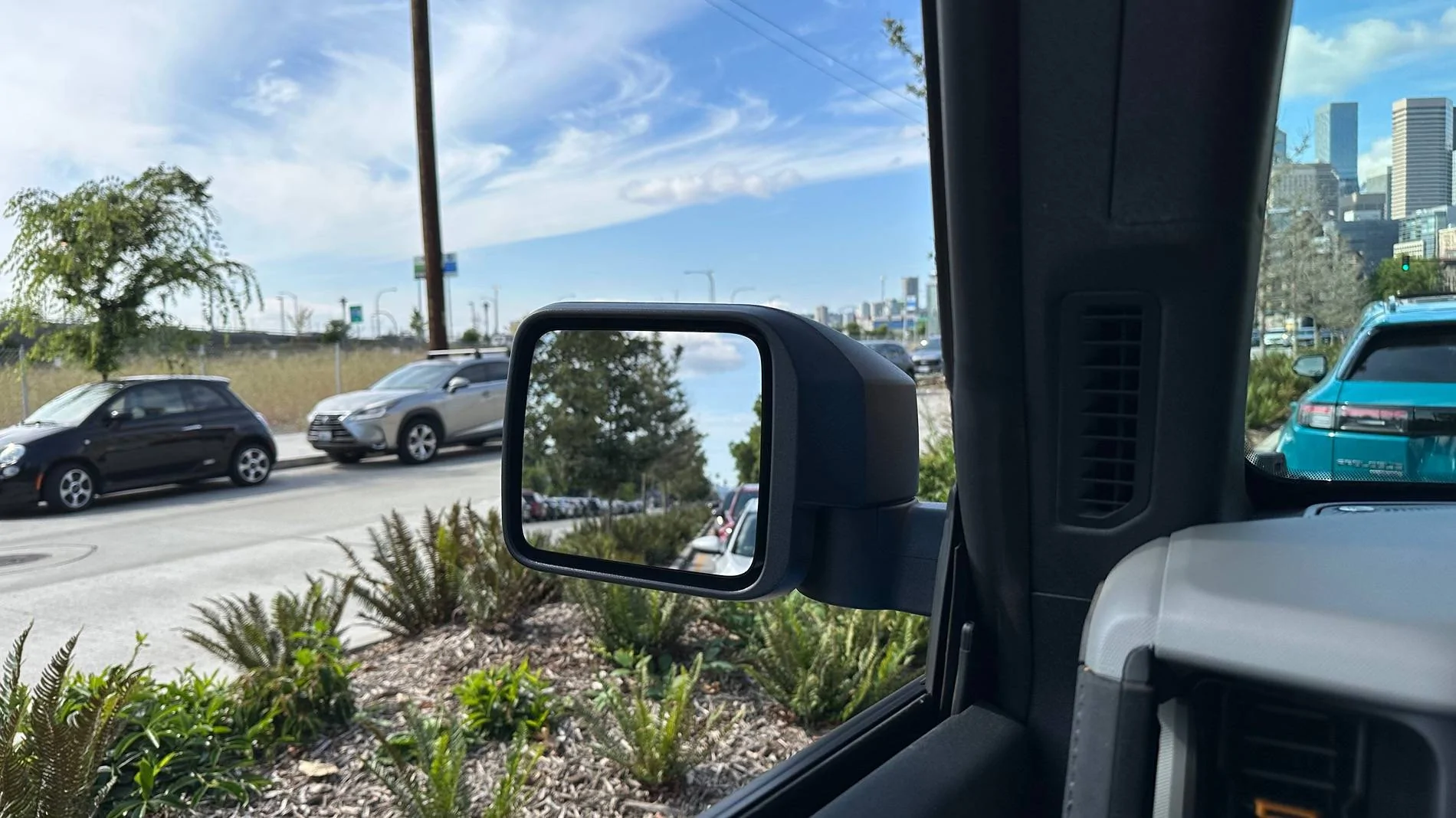

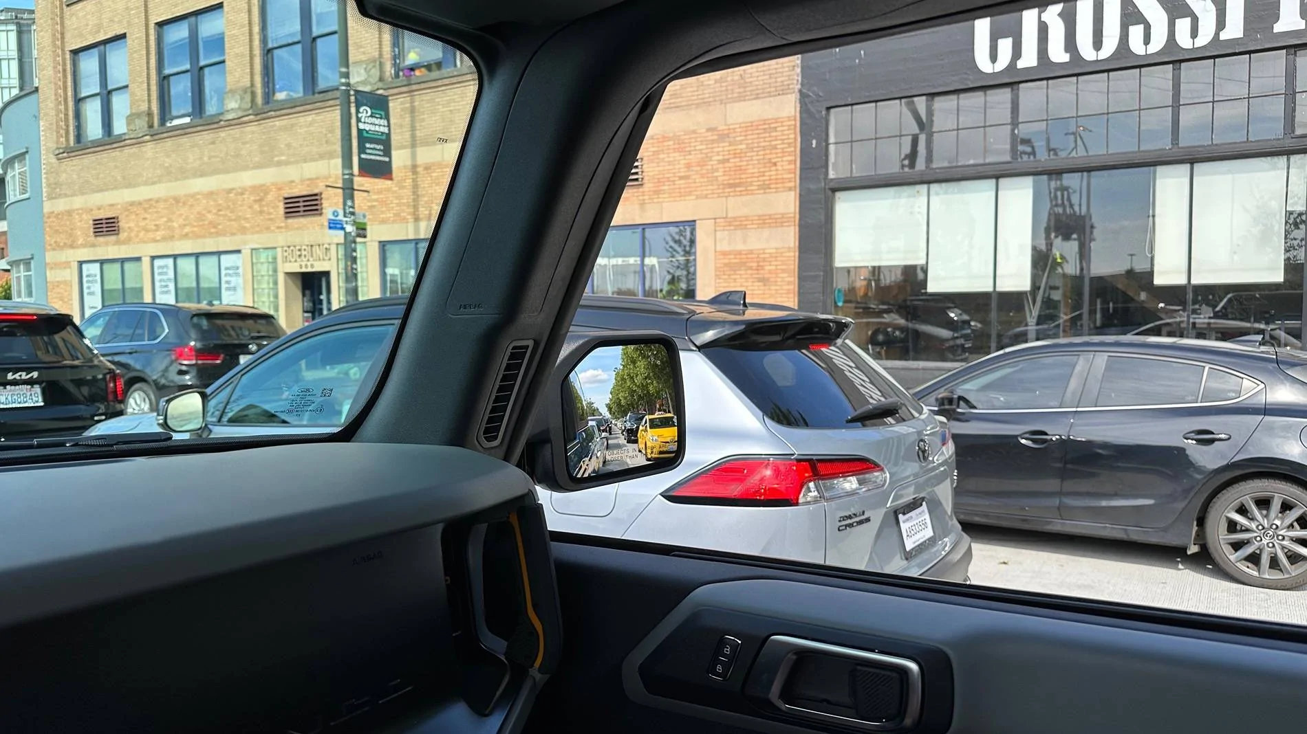

As one who prides himself on his powers of observation, I'm sorry to say it took me 2 1/2 years to notice the difference in the shape of my driver's side and passenger's side view mirrors. :wait:

My understanding is no part of mirror may be obscured. Passenger side top corner would be obscured by pillar. This is due to placement of mirror on body versus door. To get around the design rule. The corner is removed. Mirror still meets field of view requirements. But is not obscured.
