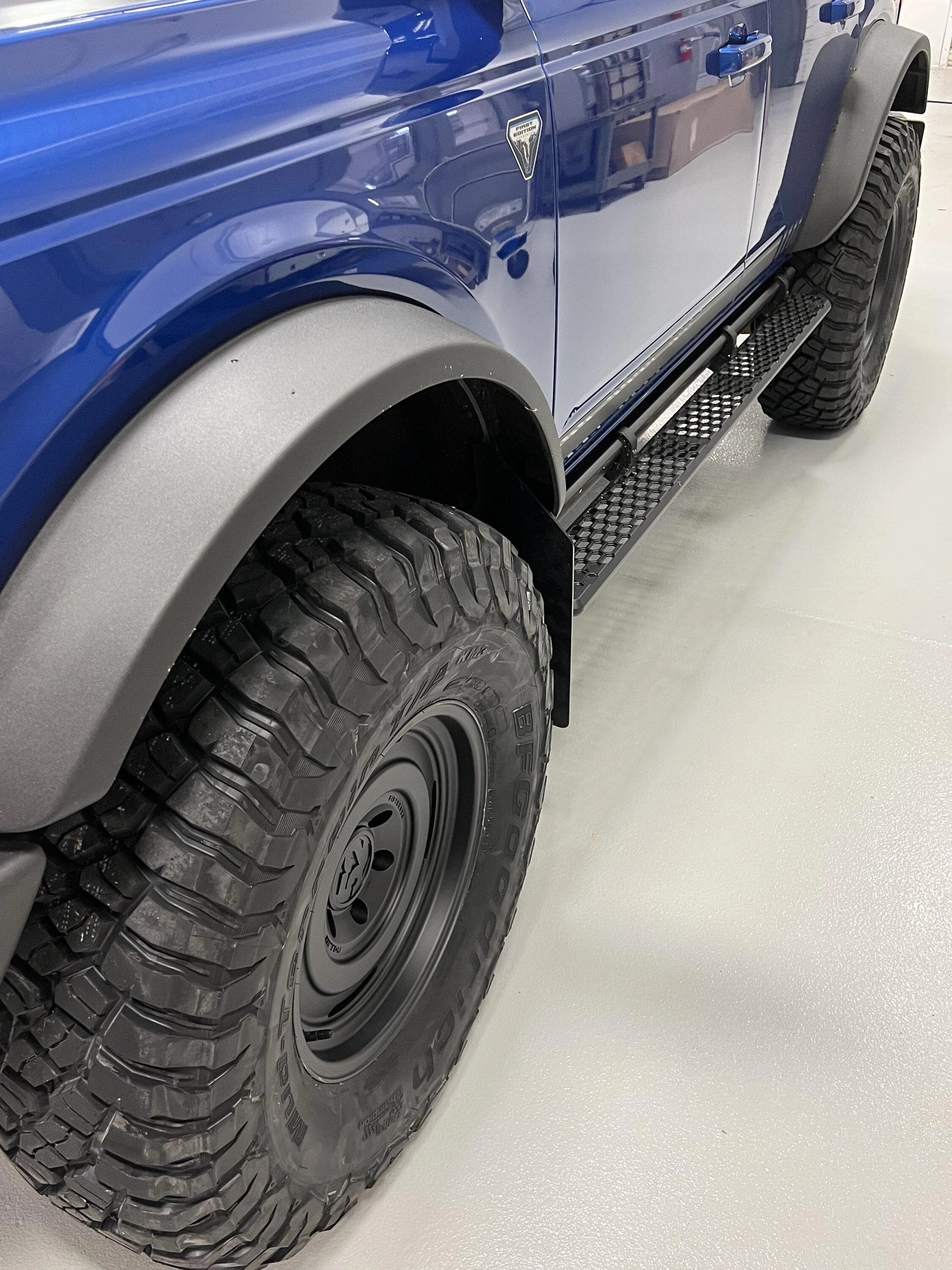

Installed some 315 Firestones yesterday. No rubs on full lock. Haven't tested while flexed.
Rides like a John Deere now. Kidding, the MT2's arent all that loud actually.

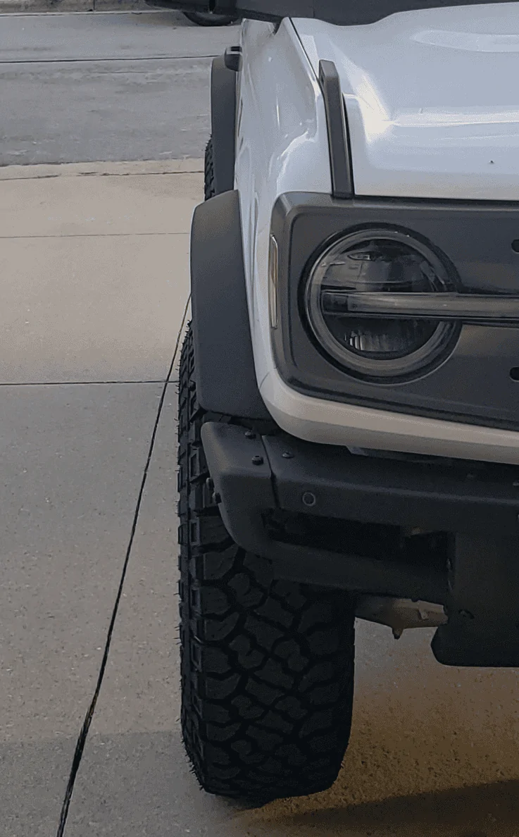

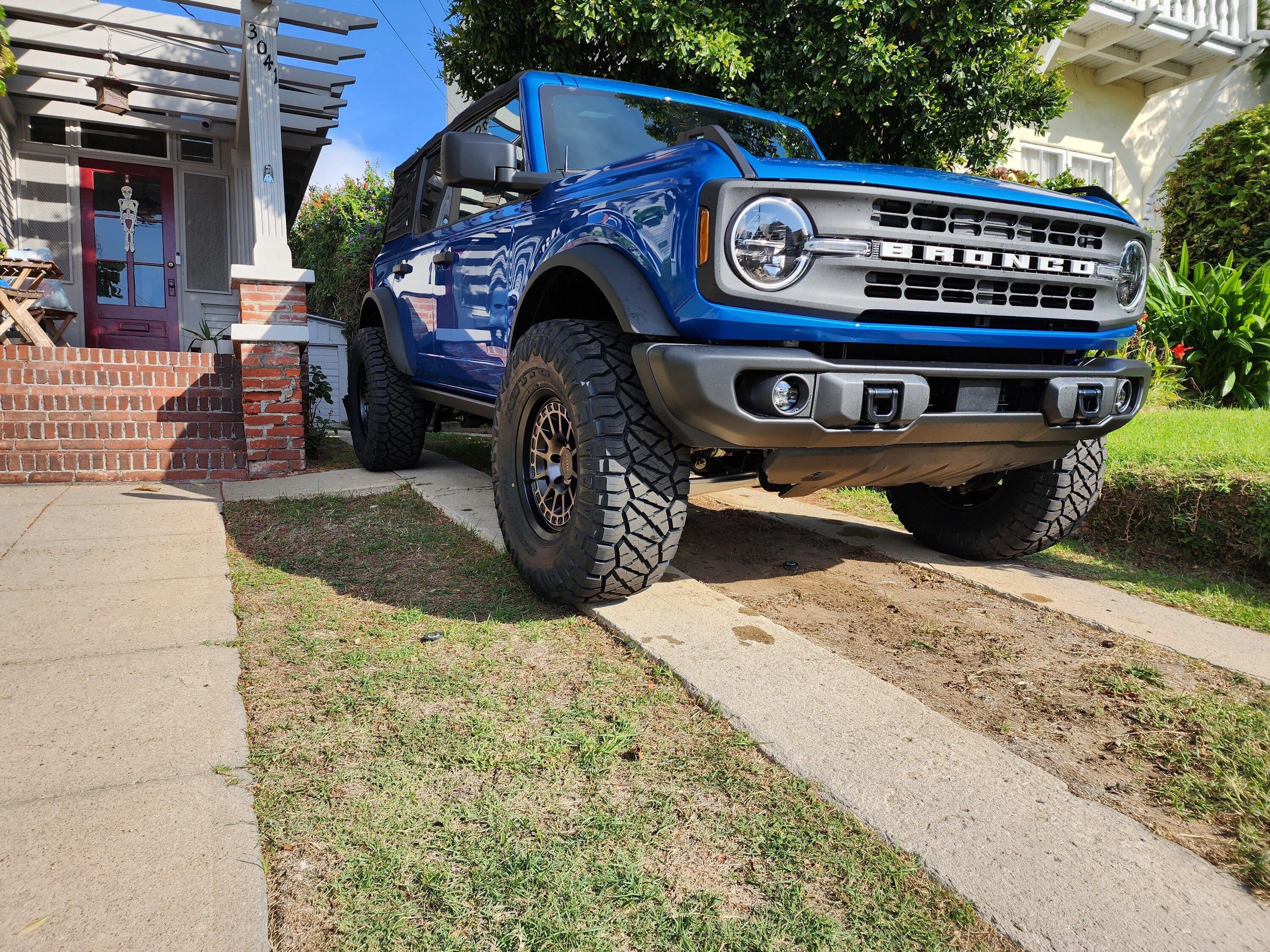

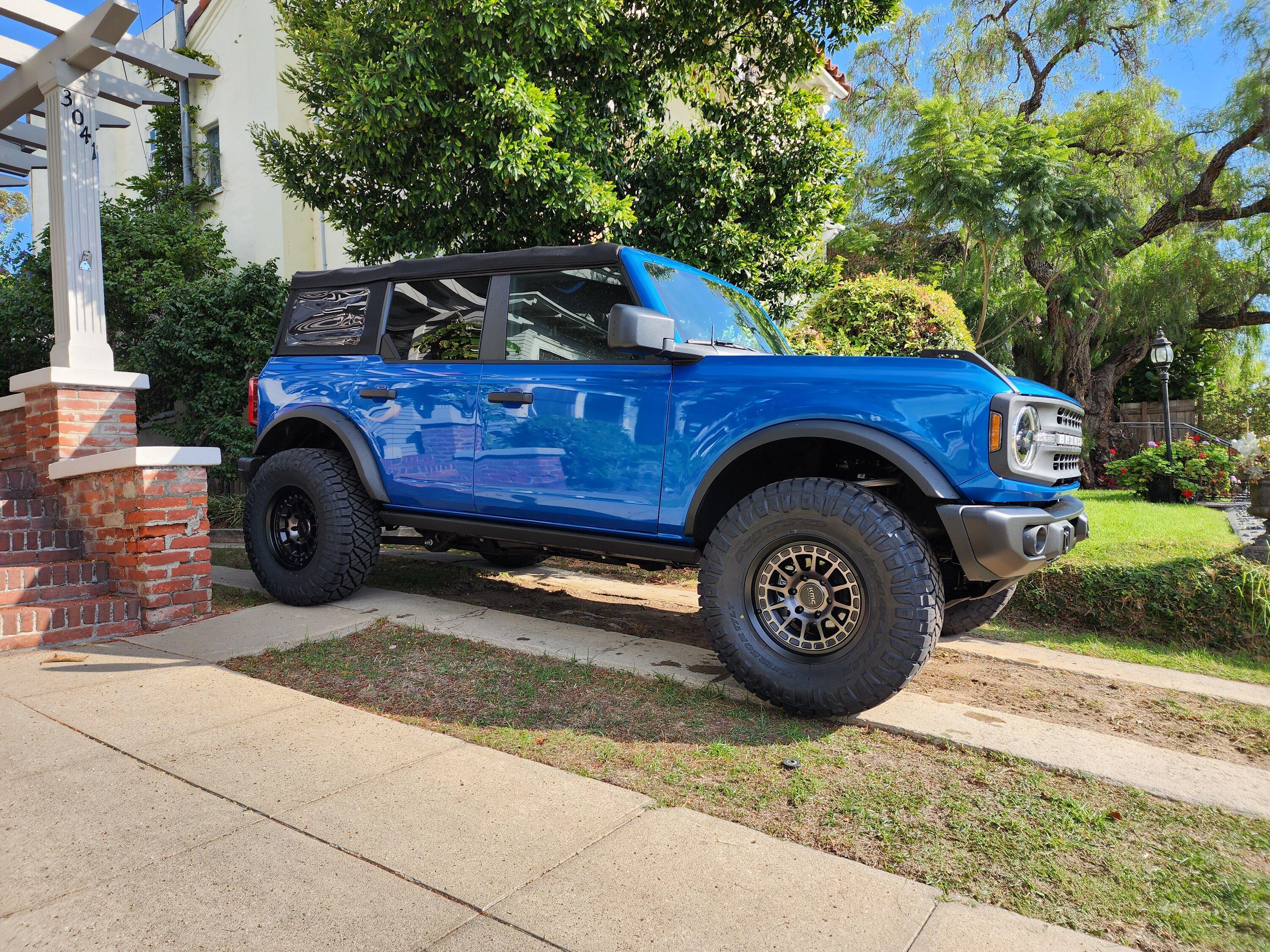

KMC Canyon 17x8.5, 0 offset wheels in Satin Black/Grey with 35" Nitto Ridge Grappler.
Love the setup/look so far.

What kind of lift do you have on that? Any picture of how much poke you have? I'm looking at the 305 Nitto Recons so I'd be a little skinnier and I was thinking a rim with a +12 or +18 offset. I want some poke but not a ton. I'm also Velocity blue (former cyber orange guy).

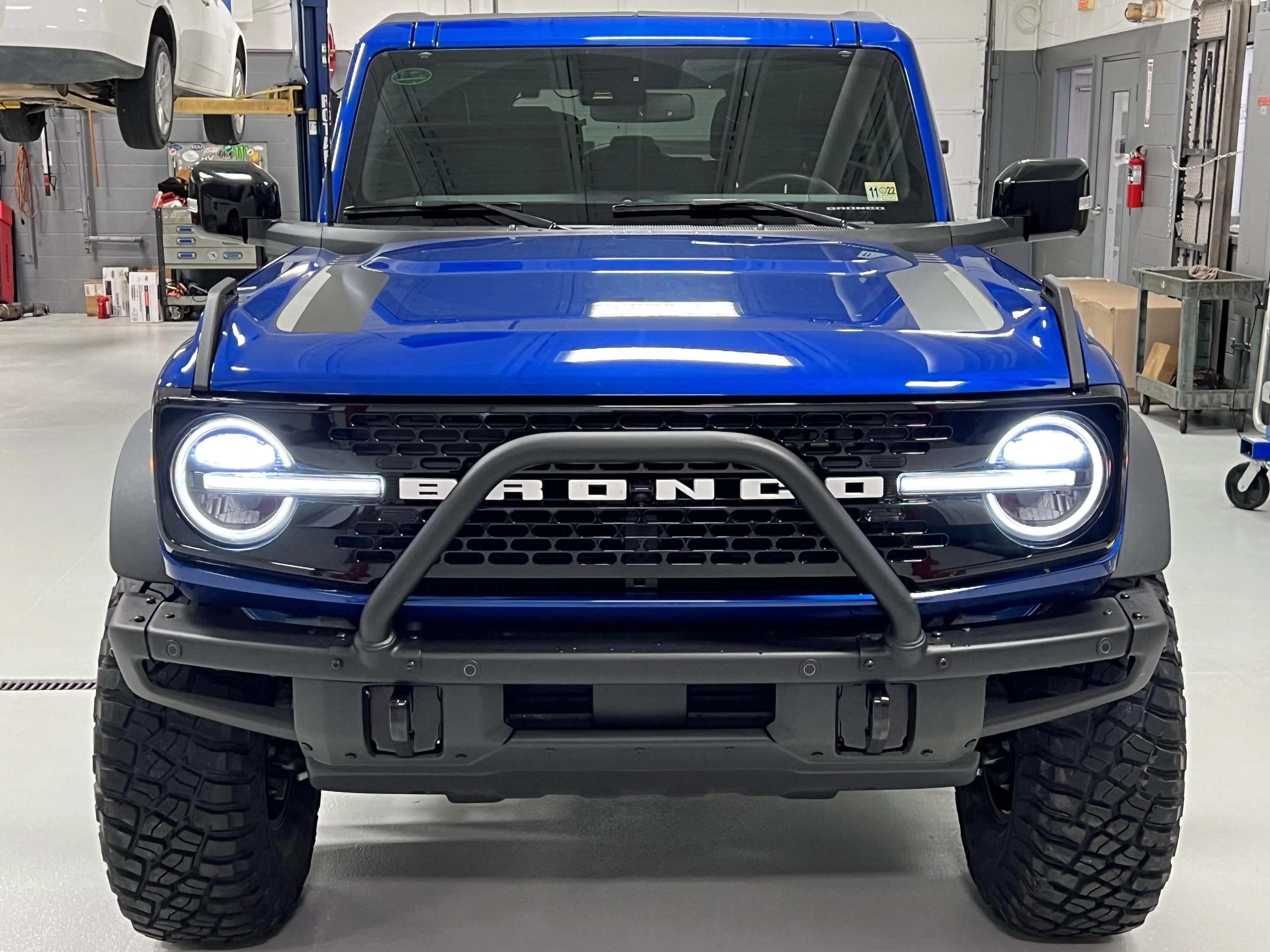

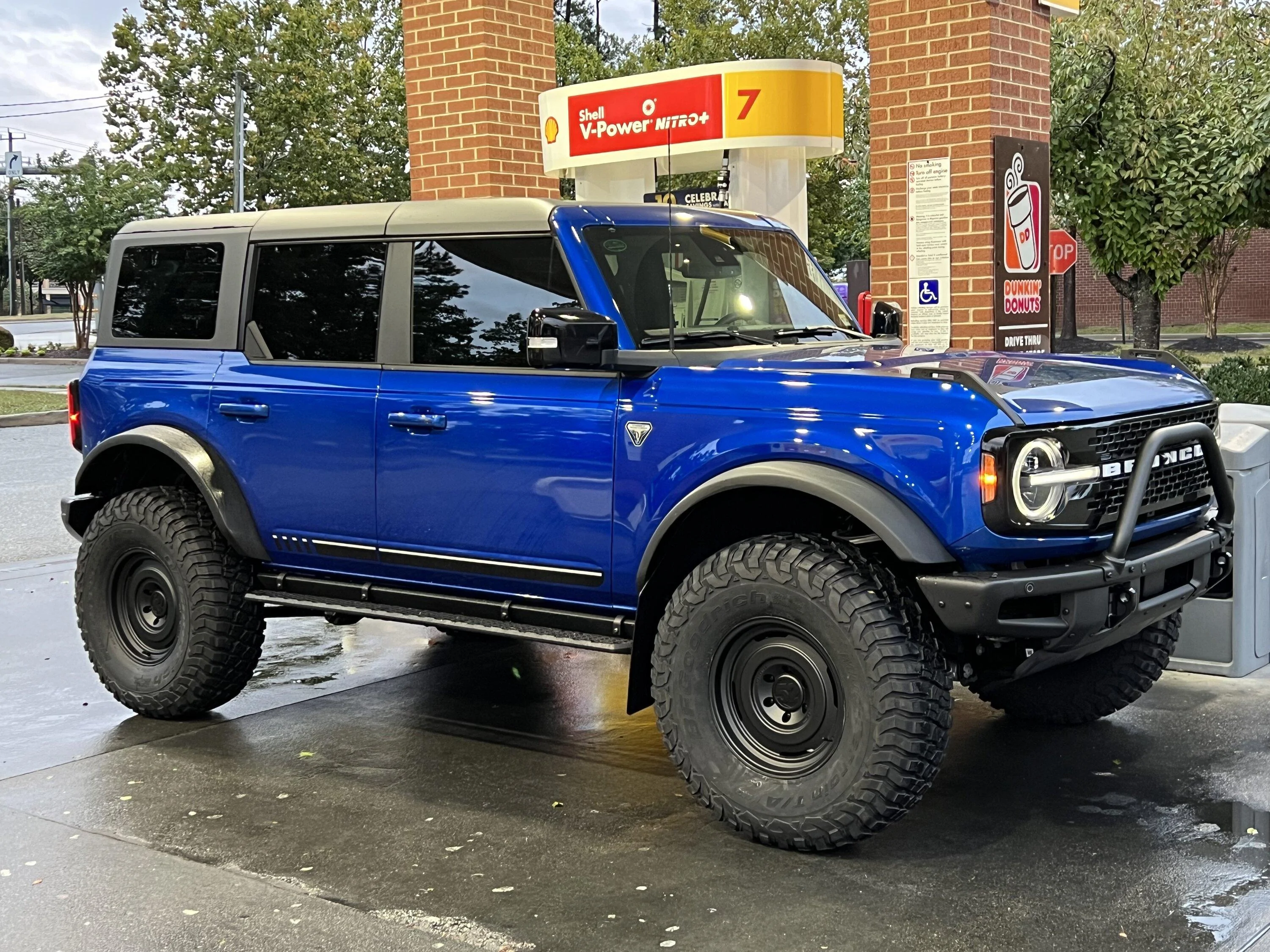

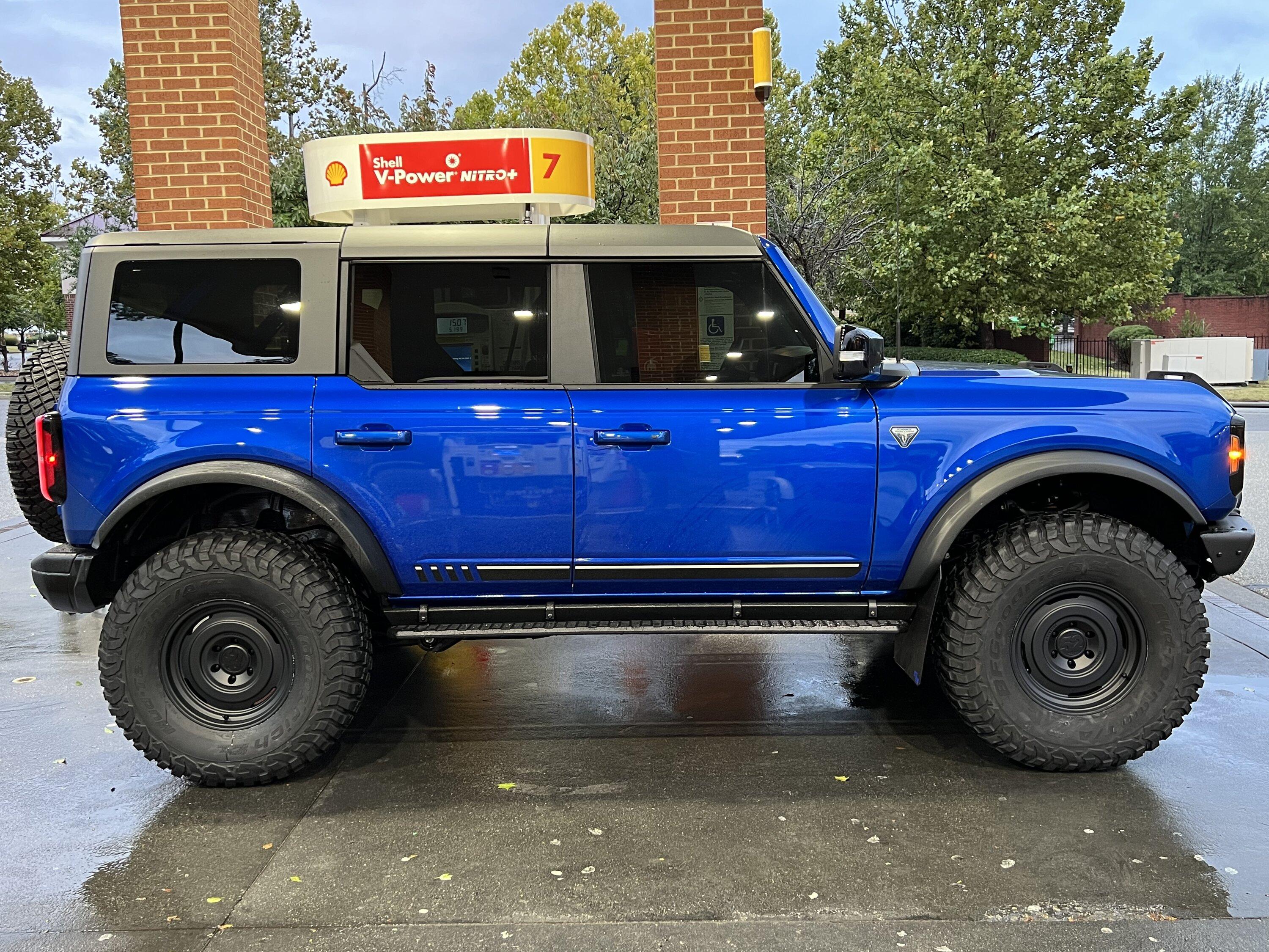

2.25” perch collars crash bars removed and BDS UCA’s.
35x12.50x17 Nittos on Fuel Block wheels +1 offset

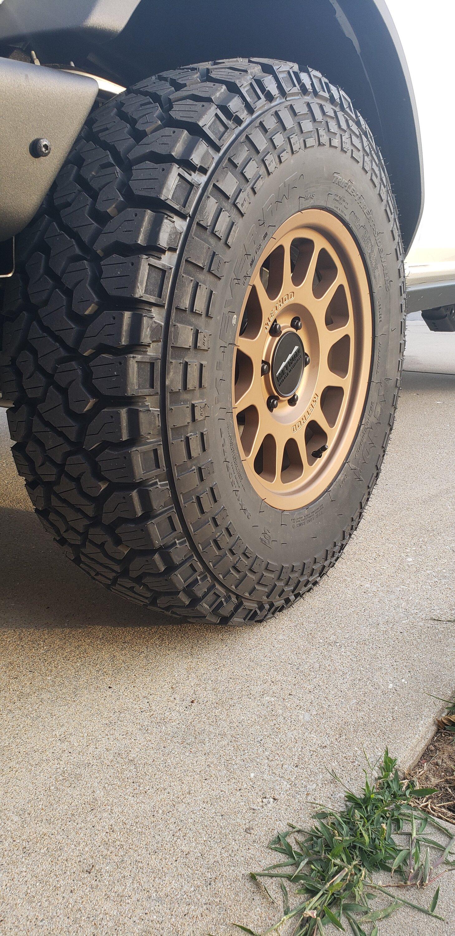

Method 703's 17x8.5" +35 offset with 35x10.5R17 Kenda Klever R/Ts on a non-sas badlands

No rub running around town, but need the crash bars removed or there will be some rubbing when the wheel is turned and the suspension compressed

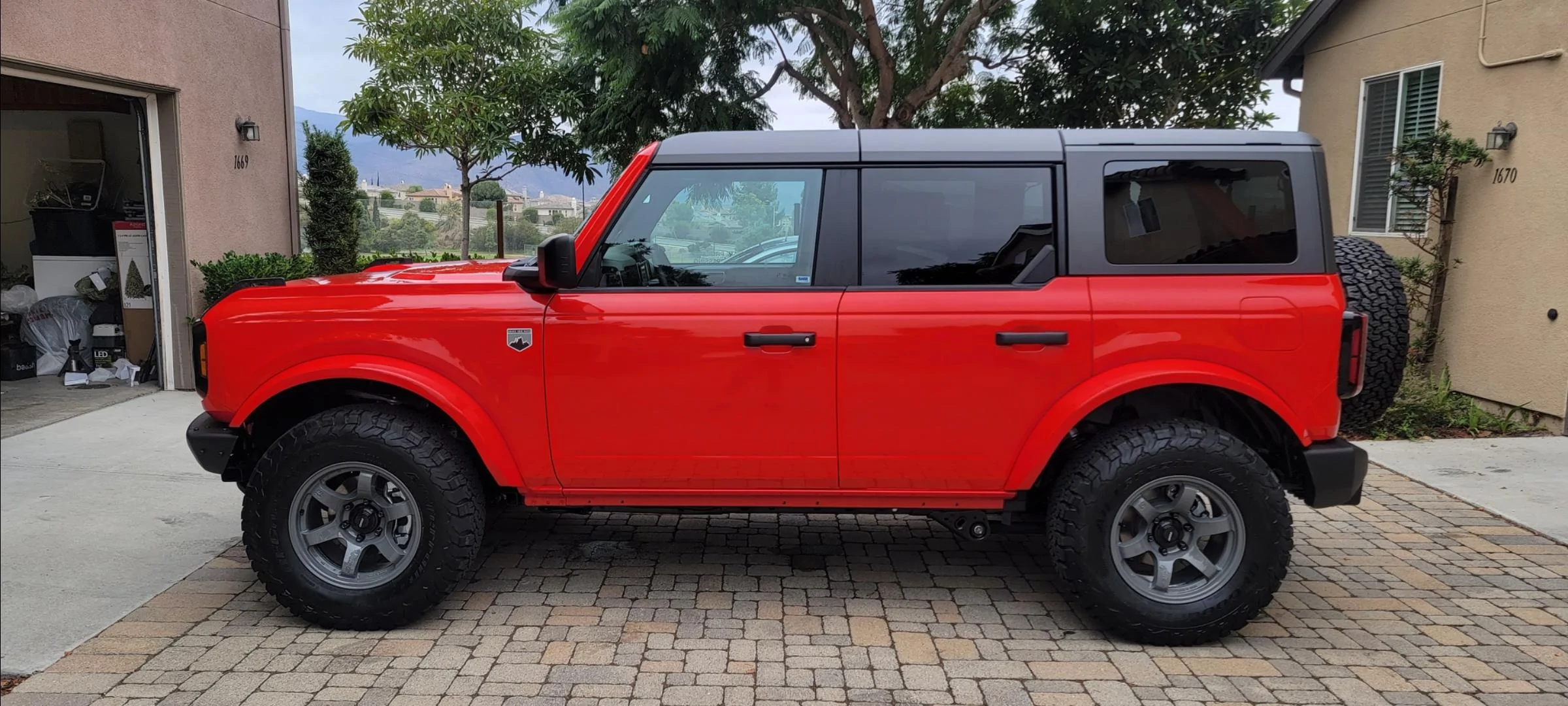

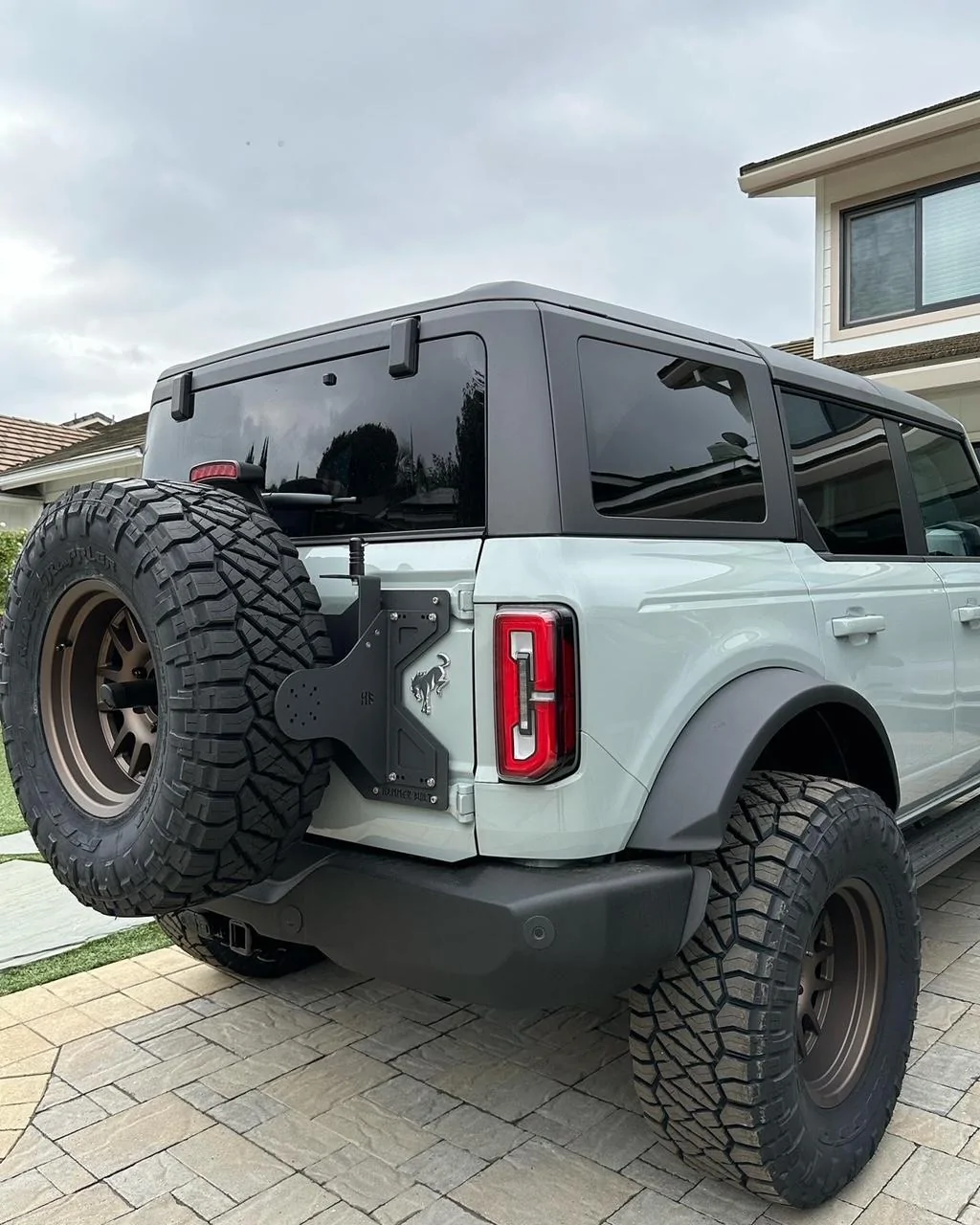

Black Rhino Guide in matte bronze: 17x9 -38
Wrapped in Nitto Ridgegrapplers 35x12.5r17

Do you have stock suspension and did you have to do any trimming for them to clear on the front?

Stock SAS suspension. No trimming at all but the tire slightly rubs the plastic corner of the stock side steps at full lock. I plan on removing them, so should be fine afterwards.
