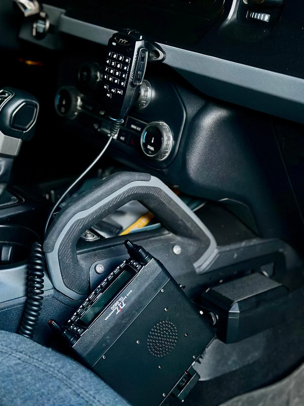

Fast forward to 2024.....I wanted to up my game :cool: -After comparing B-Tech, Woxun, Midland, etc.....(like 5 more brands) I decided on the TYT-9800. I initially was thinking....."Well, GMRS is great cause it's so easy! I'll likely ever ever need HAM frequencies." However, the more comfortable I got on the trails, the more I would go out and adventure by myself.....and I figured "I don't want to be THAT person who can't call for help if needed". Therefore👆!!!! - I Got a nice, solid MOBILE unit = More Range + More Frequencies + More Power. It isn't as easy as a direct GMRS unit (which is "turn on and use"). This one required some advanced programming, which I DID NOT DO (had a buddy do it who is a radio expert and programmed all the channels for me). BUT WOW. When done it is crazy awesome. The unit is literally like having TWO radios in one, each side with its own separate controls, big screen and HAM FREQUENCIES!!!....Now I just have to learn more and I automatically got a new hobby (HAM RADIO!!!). Also got a TRAM Antenna that has Dual-Band capabilities and also mounted everything on the passenger side of the center console w/ a MOLLE PANEL. Clean install and the grab handle does not get in the way :) I would HIGHLY recommend this setup!!

Ford Bronco Setup - From Baofeng (handheld) to TYT (mobile) IMG_7029
Ford Bronco Setup - From Baofeng (handheld) to TYT (mobile) IMG_7030

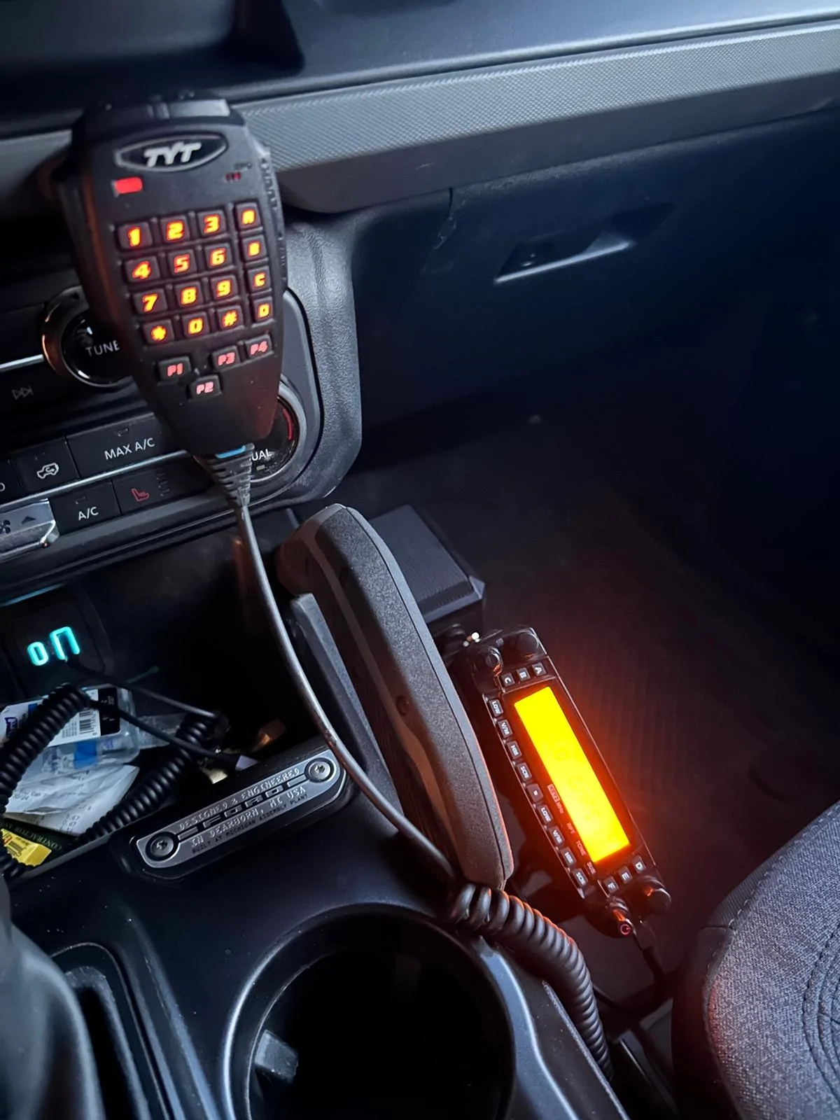

Do you have any pics of the finished setup using the MOLLE panel? I'm torn between mounting locations. Trying to avoid the passenger side but it may be the best option.

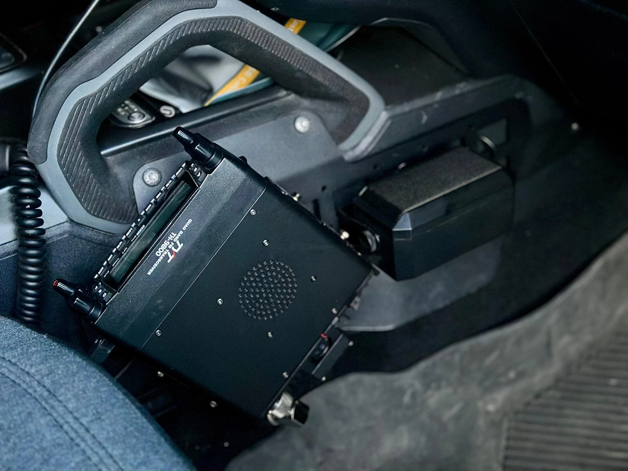

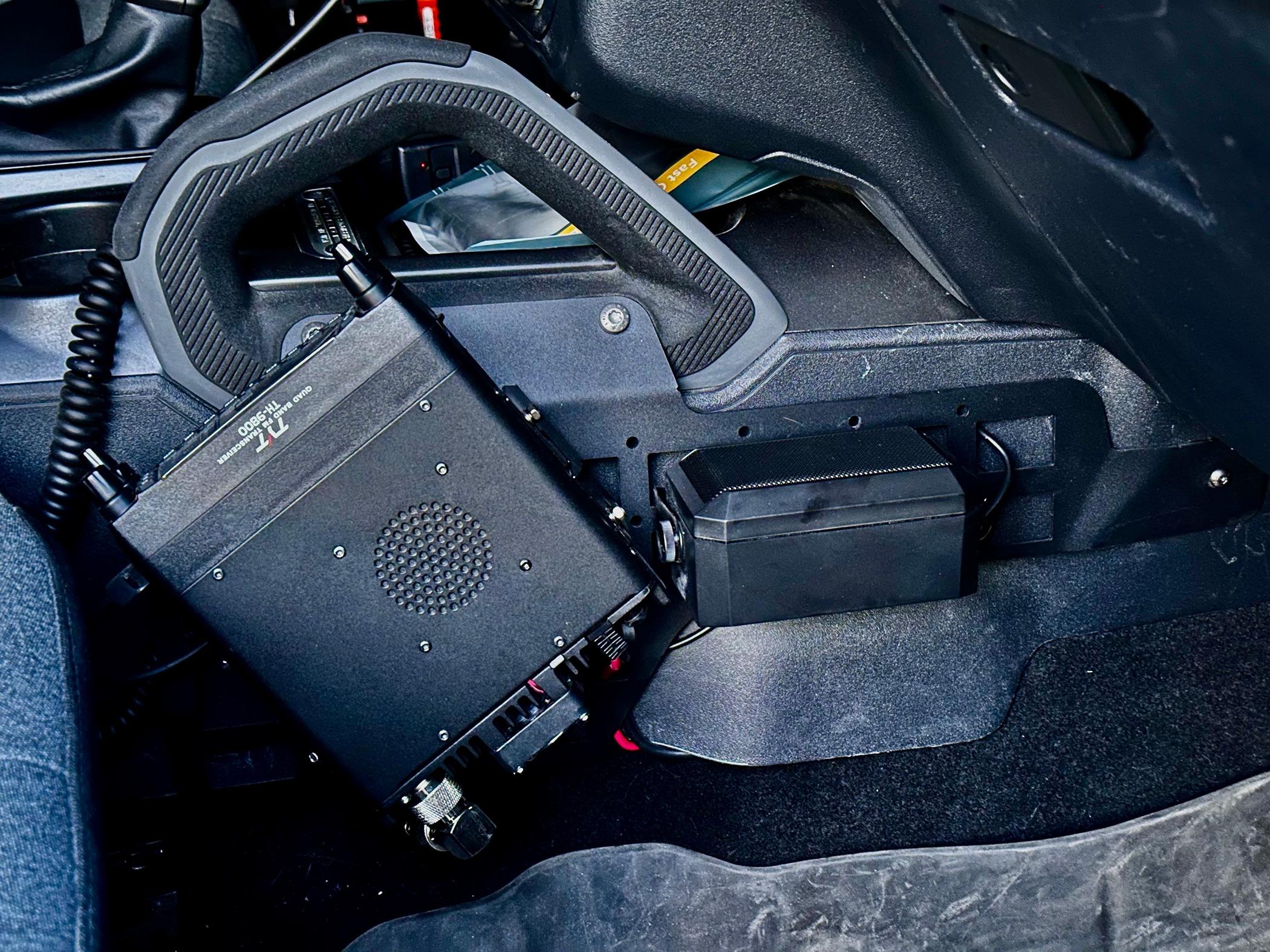

Here ya go! Let me know if you have any more questions :) I also added an external speaker - (non-powered, $15 from Amazon...works great!)
Ford Bronco Setup - From Baofeng (handheld) to TYT (mobile) 2023_LeaseApt2
Ford Bronco Setup - From Baofeng (handheld) to TYT (mobile) IMG_7028

Nice and tight. Yeah, that location is the way to go. You sold me. Thx for sharing! 👍
Just get some bolts from home depot - I used 3 mounting points on the MOLLE panel. The Bottom 2 bolts i added EXTRA washers so the radio would "tilt" towards me a little ;)
