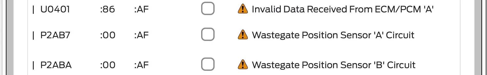

The wife and I took a ride tonight with the tops and doors off. I noticed my throttle response was lacking right before I got the wrench light. I could also smell very rich exhaust fumes from the truck. Made it home and parked it. I’ll contact the dealer tomorrow I guess. Anyone have any ideas? 2024 Wildtrak.

/1FMEE2BP3RLA43994. And 1900 miles. Turbo doesn’t seem to be making any boost.

*Update. Started the truck yesterday after making an appointment at dealer and everything was fine. I drove it for an hour trying to replicate the issue. All was ok. So I cancelled the appt. Just went for a drive and 30 mins into an easy drive same thing. Loss of power and no boost from turbo. I think it’s a stuck open watergate? Any suggestions?

Yeah looks like a wastegate issue.
Bring it to the dealer and let them diagnose the issue.
