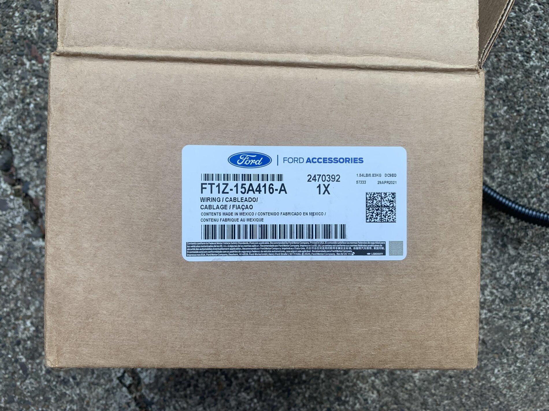

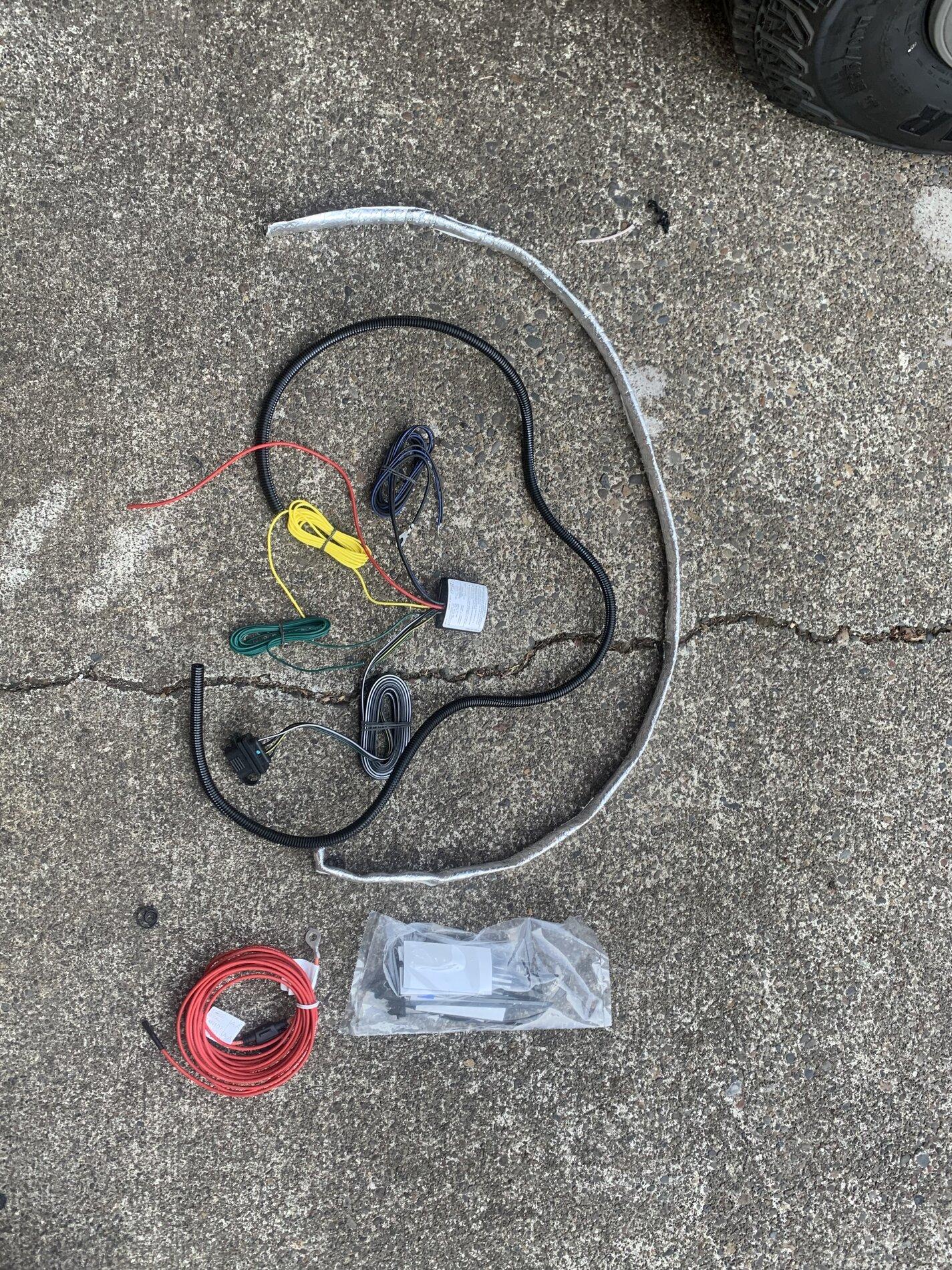

Ok, steps 1 through 13:
I followed instructions so far. I ran the red power line supplied from the battery to the fire wall access shown.

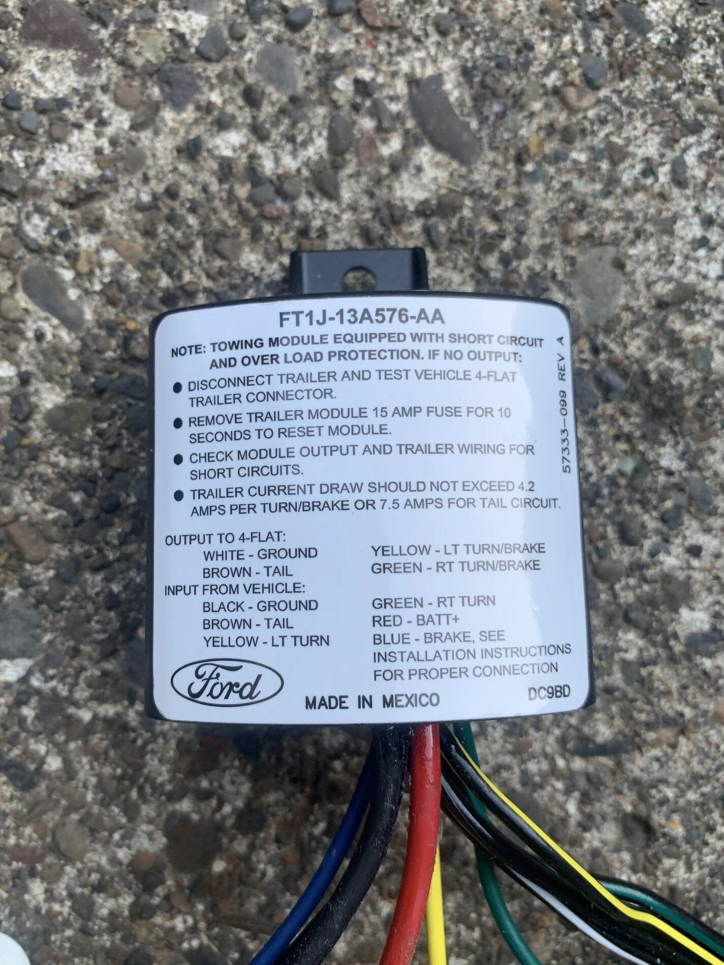

now comes my first deviation from the instructions. Once the power wire is laid in the interior to the rear driver’s side. They want me, somehow, to place the module up into the exterior of the interior wall near the taillight. I opted to mount it inside the interior wall. The next instructions are about feeding the wires through the grommet to the interior to attach the red power, the ground, and the blue line to ground (for halogen lights).
Ford Bronco Self wiring flat four-pin hitch receiver 0D8D9CFE-CD53-41D0-8C00-E96A53BB8A9C
I went reverse running the connecting lines through the grommet to the exterior as well as the four-pin through the grommet. This last measure was made easy by removing the grommet entirely and feeding through a hole I made then refitting it back in.
