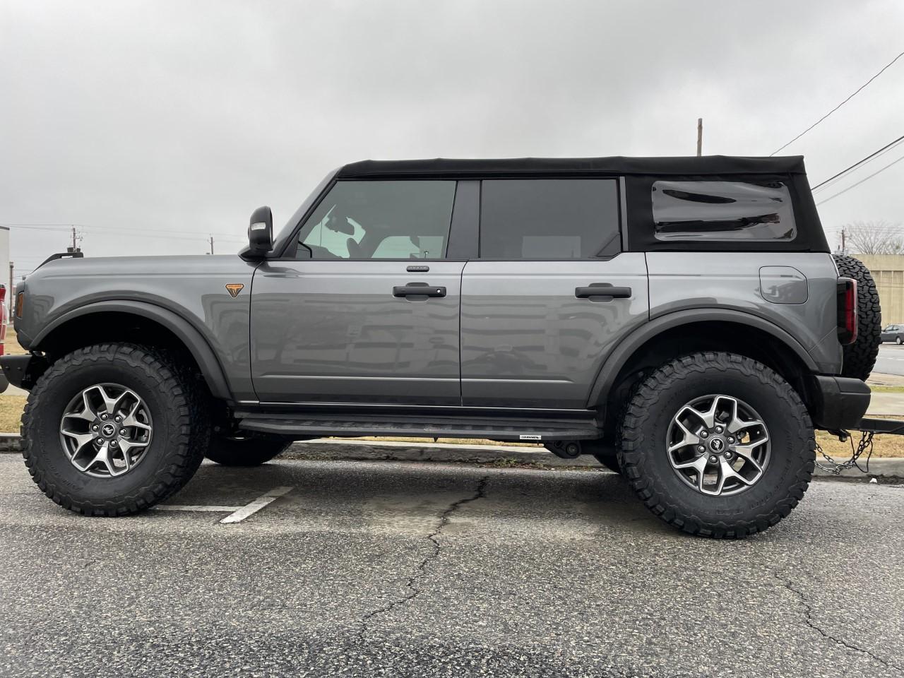

youre welcome. yes you should have no issues at all. so stock rims are +55 plus 1.5" spacer if my math is correct and if it is the correct way to figure it out, I have something equivalent to about a +17. Correct me if that is not correct way of calculating.
now wondering if the plus 30 like sasquatch rims would work?

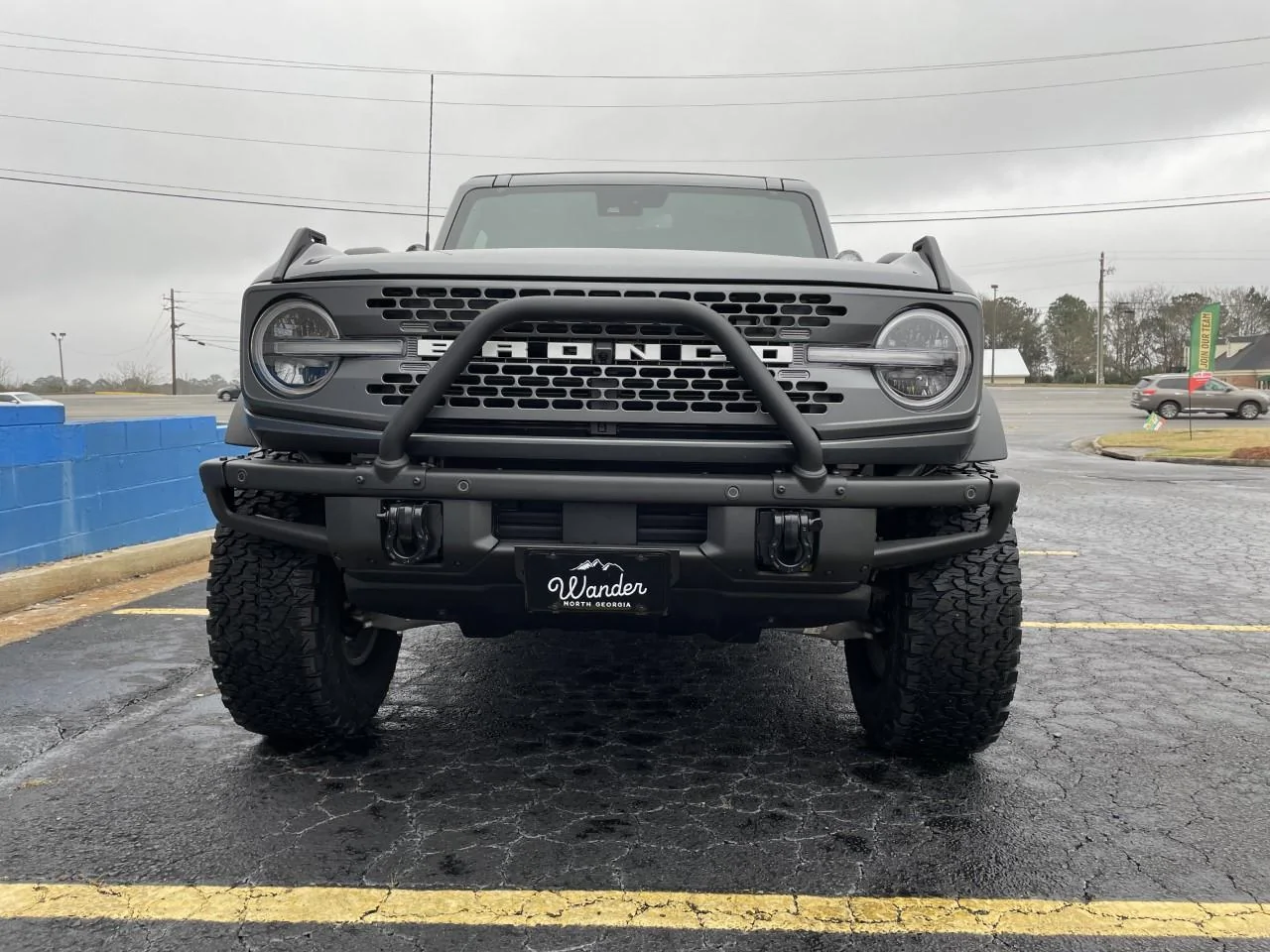

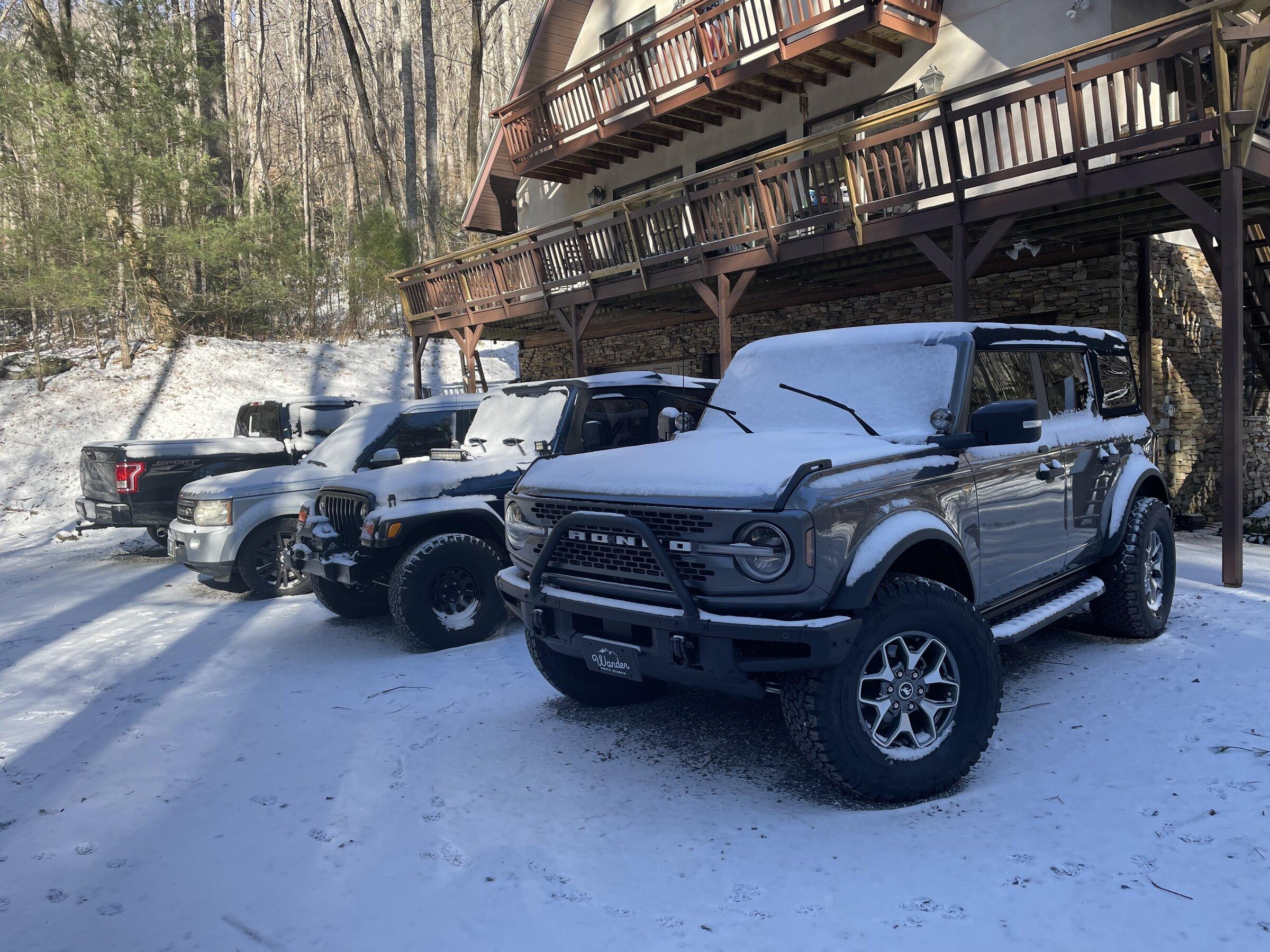

View attachment 257675 View attachment 257666 View attachment 257666 View attachment 257670

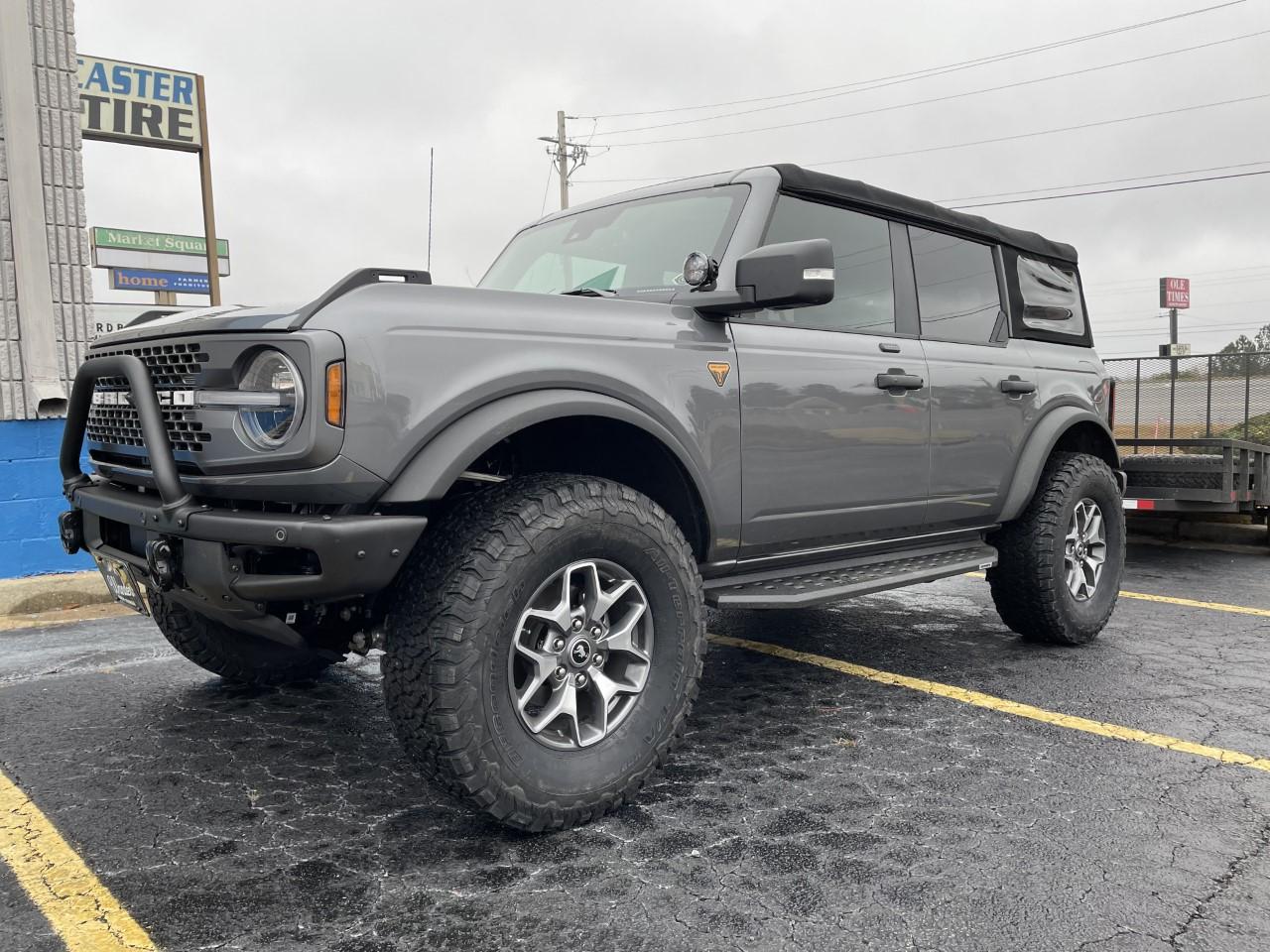

The blank slate: 2021 Bronco Badlands. 4 door. 2.7. High Package. Carbonized Gray. Soft Top. Took delivery 10/27. Ordered 01/29.
The usual accessories: Safari Bar. Rigid Pod Lights. PPF. Tint. Husky Liners. Valkyrie License Plate Relocation Kit.
How I made it mine: Ready Lift 1.25in. Level. 1.25in. BORA Wheel Spacers. 4Wheel Parts Big Tire Kit(modified crash bars). 315/70r17 BFG KO2s on Factory Badlands Rims.
Built Wild!

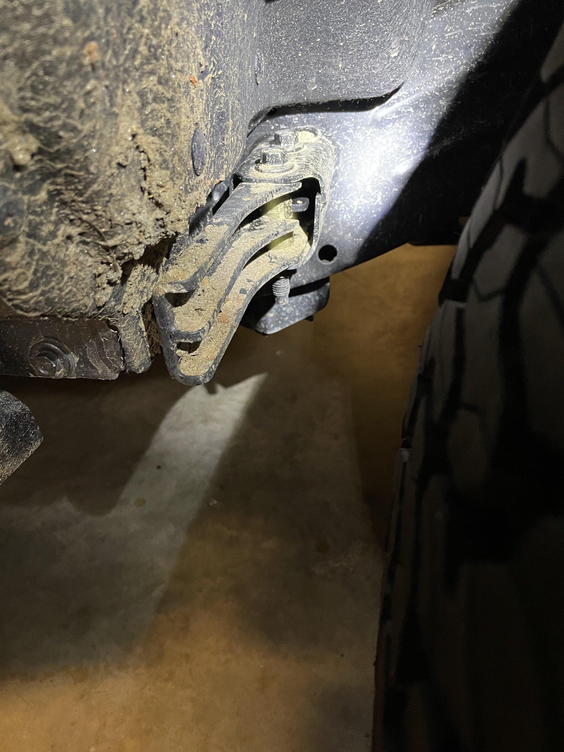

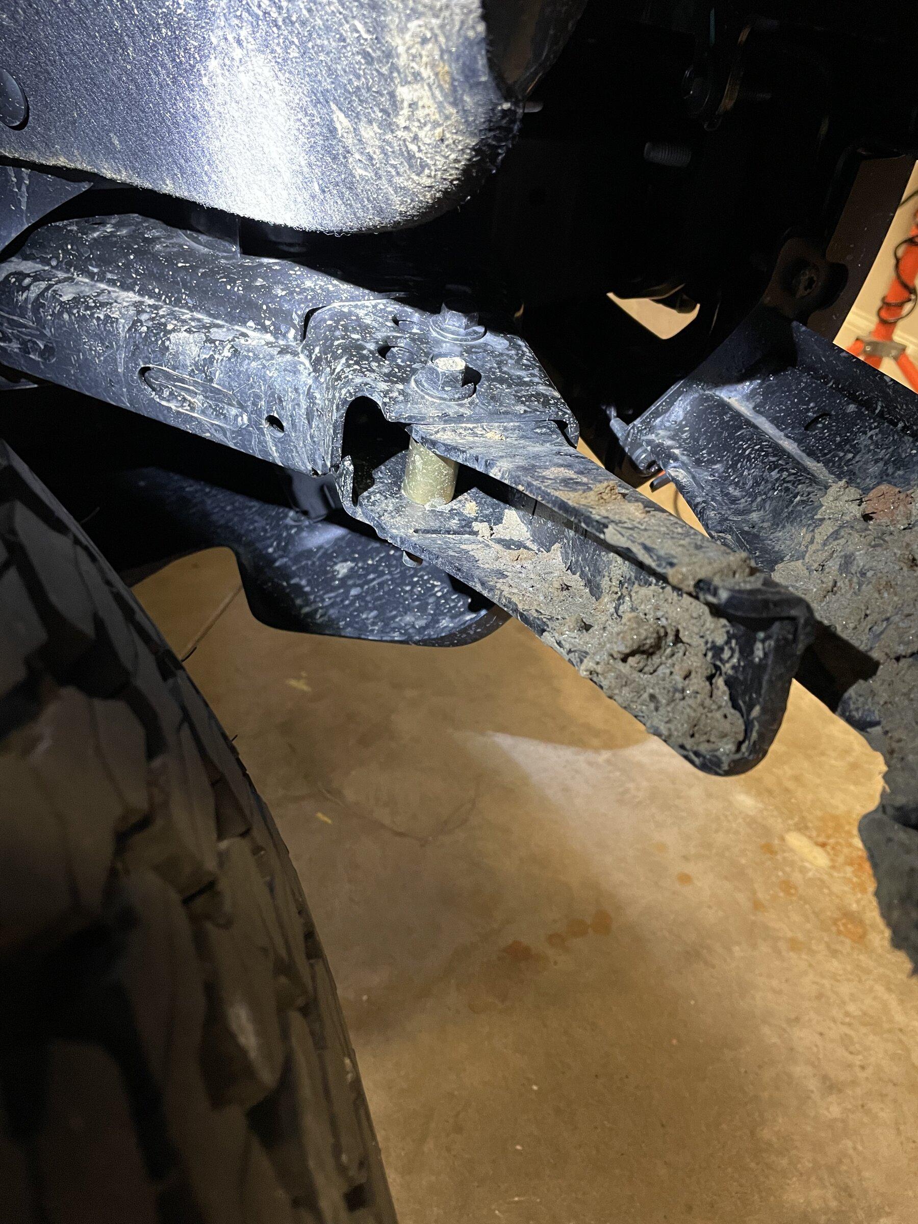

“Modified crash bars”?
Maybe a silly question. What’s modified? Remove?
I will take a picture tonight. 4Wheel parts makes them. 4Wheel parts calls them

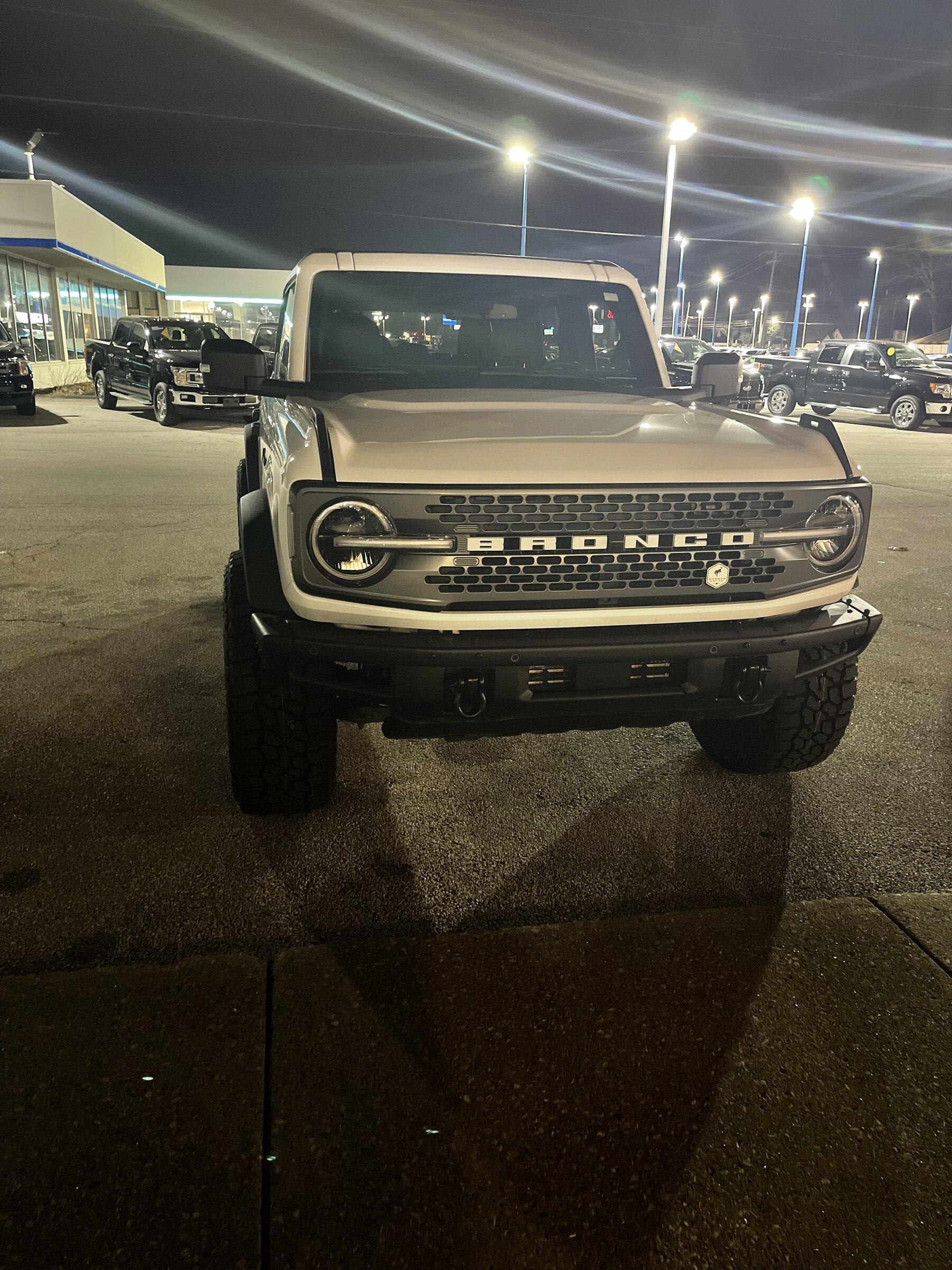

Ford Bronco Badlands "self squatch" finally done! 37B49BE6-1264-4F9E-82DA-0CF4B70DEC6C
a “big tire kit”. They replace the factory crash bars with modified crash bars that allow more clearance while turning bigger tires.
Ford Bronco Badlands "self squatch" finally done! 09ACA3EF-6ABF-4DBE-B764-B750E746C0C6

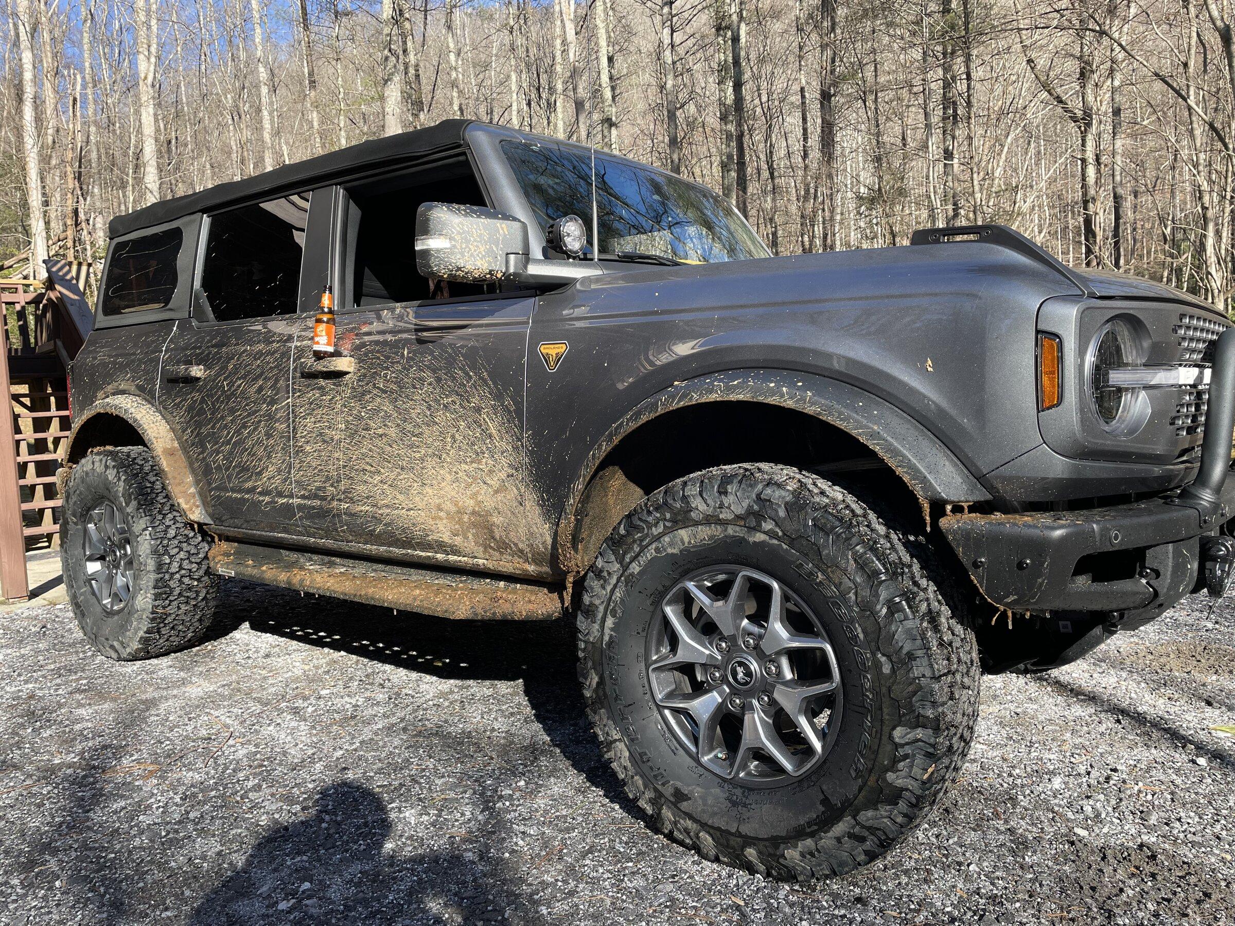

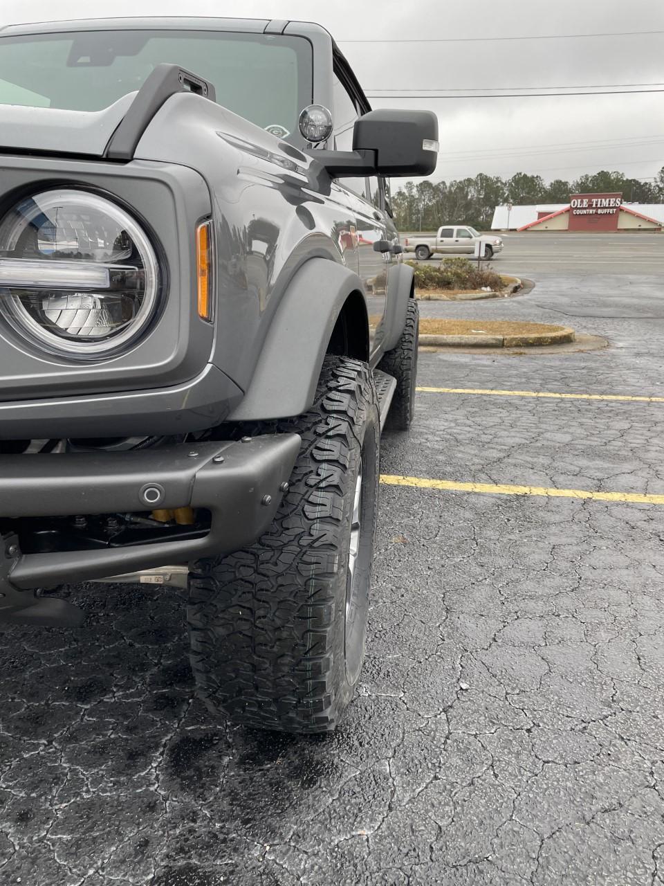

Wheeled like a champ. Nothing crazy. I did get to play with several of the GOAT modes, lockers and trail turn assist. Most importantly, no scrubbing or rubbing!

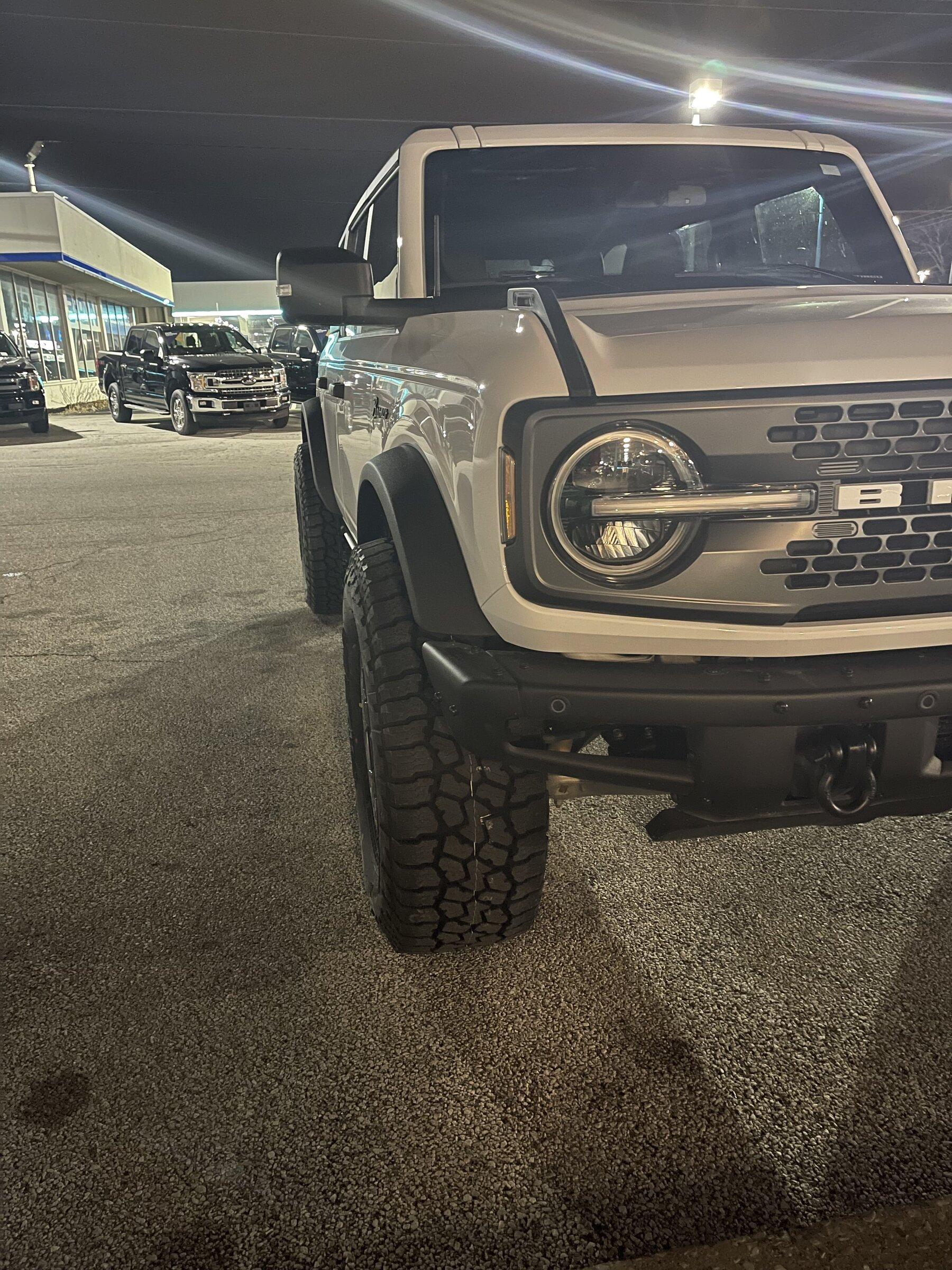

Big Tire Kit (modified crash bars)
Ford Bronco Badlands "self squatch" finally done! DDD90FE2-360C-4B2F-BF08-4989D3961832
Ford Bronco Badlands "self squatch" finally done! 050A1AE6-E30D-42E0-A958-EF298CE11A70

Any concerns that your spacer will push your CV joints to far at full droop? I read a detailed post describing how the BL and SAS had already maxed out CV joints that might not take the extra angle. I ask because I contemplate a self squatch on my BL one day.

I have wheeled twice so far (we are going again this weekend) with 0 issues thus far. I'm sure that over time, (any) modifications will stress factory components. However, my build is very mild compared to countless others I've seen. My goal was to add larger tires with no scrubbing while maintaining my factory wheels and ride quality and while ensuring that all factory drive components remained intact and fully functional.

Just found this post. So just to confirm, if i swap for SAS wheels (+30) and the Goodyears (315/70/17) I won’t really need any spacers even with the longer travel Bilsteins that come with the standard Badlands? I plan on occasional off-road but may require full articulation at times. Thanks!!
