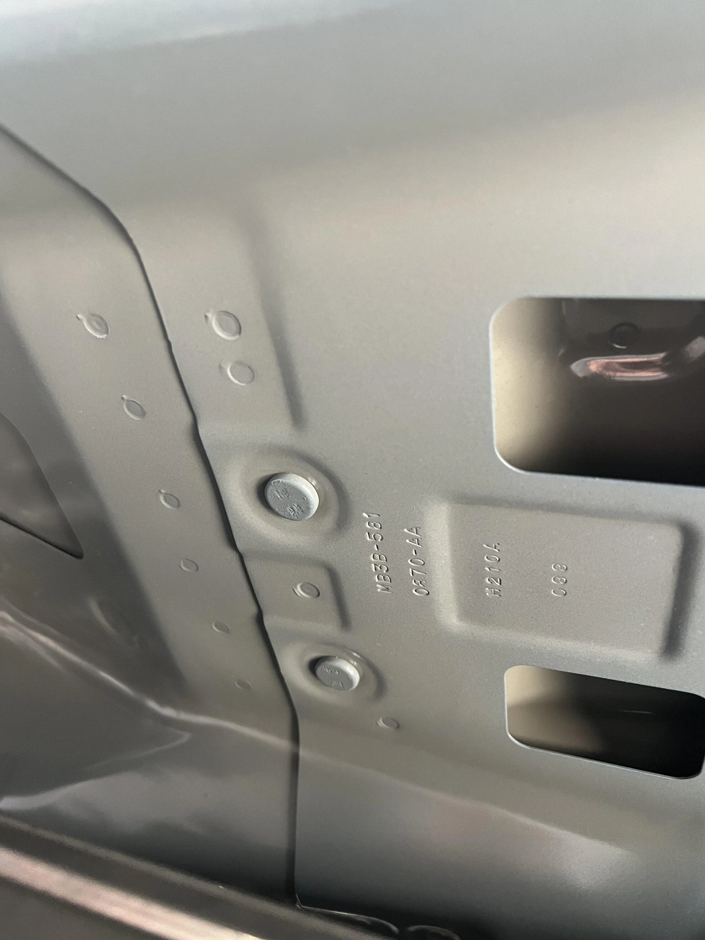

Got a picture from underneath. Looks like it was pressed in. Wondering if I can punch it out from inside the Bronco.
Those are weld studs. They are welded in place, not pressed. It will take some work to try and pound them out.
Been talking to some guys at work and we are going to try and Drill it out from the top side. Then tap. Insert new larger bolt from bottom and place a nut on top.
we will have to file the broken stud downbefore starting to drill
