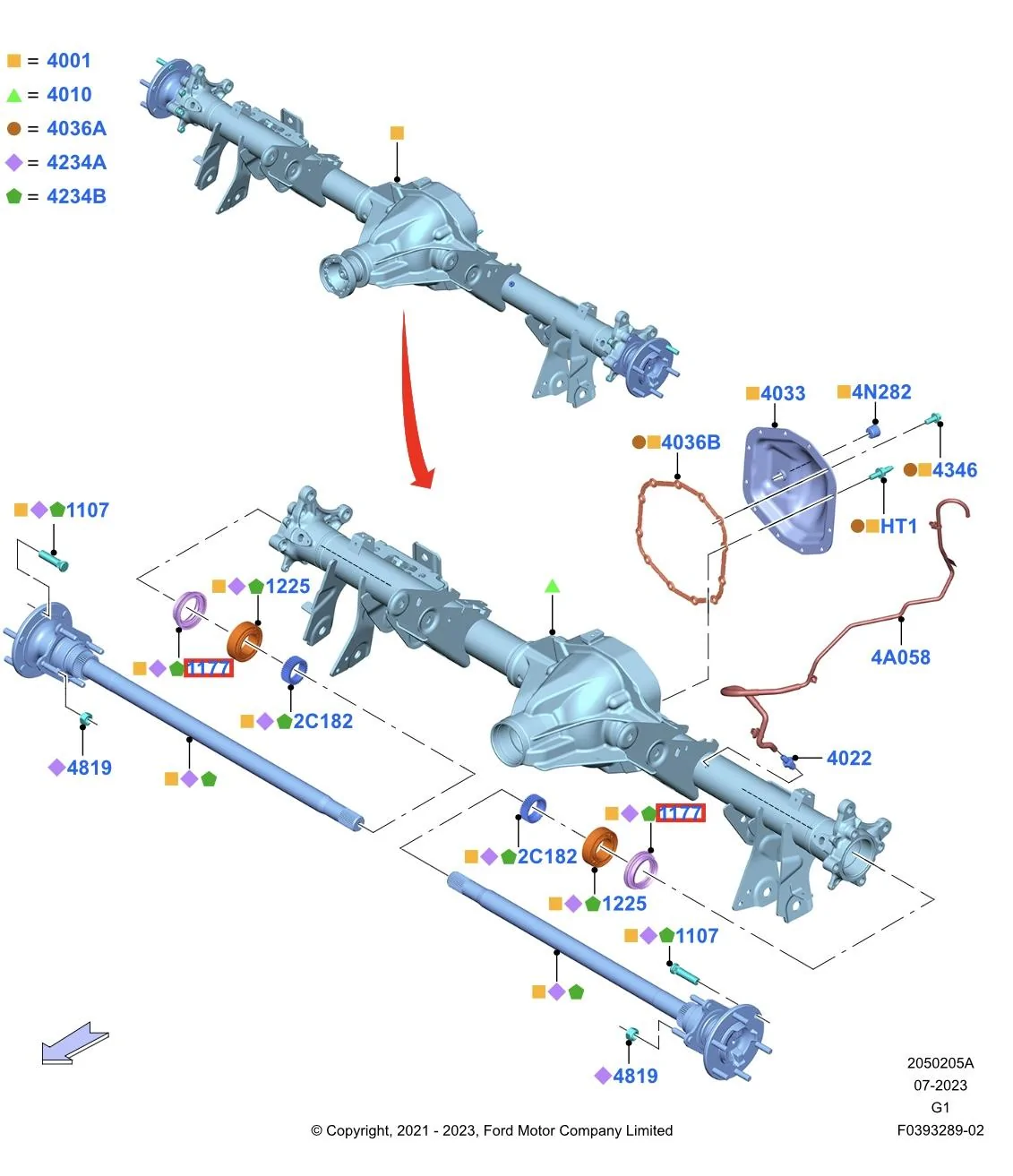

Looking for a catalog image rear axle 2022 2 door Sasquatch. I have a right rear axle leak. Looking to see what parts might be needed for repair.

2022 should be in the 36k/3yr warranty? Have you tried talking to your dealer?
I agree with this.
Rear axle seal is covered under powertrain 5/60. So it should definitely be covered by warranty.
Here’s the catalog image either way:
Ford Bronco Sasquatch rear axle leak IMG_1984

Oh I agree. Just trying to figure what items need to be replaced. My vehicle is sitting until parts arrive. Was told axle on order. Just wait and see. Other than that one issue the Bronco has been a blast. Thanks I new someone on here has access to EPC. Thanks again.
