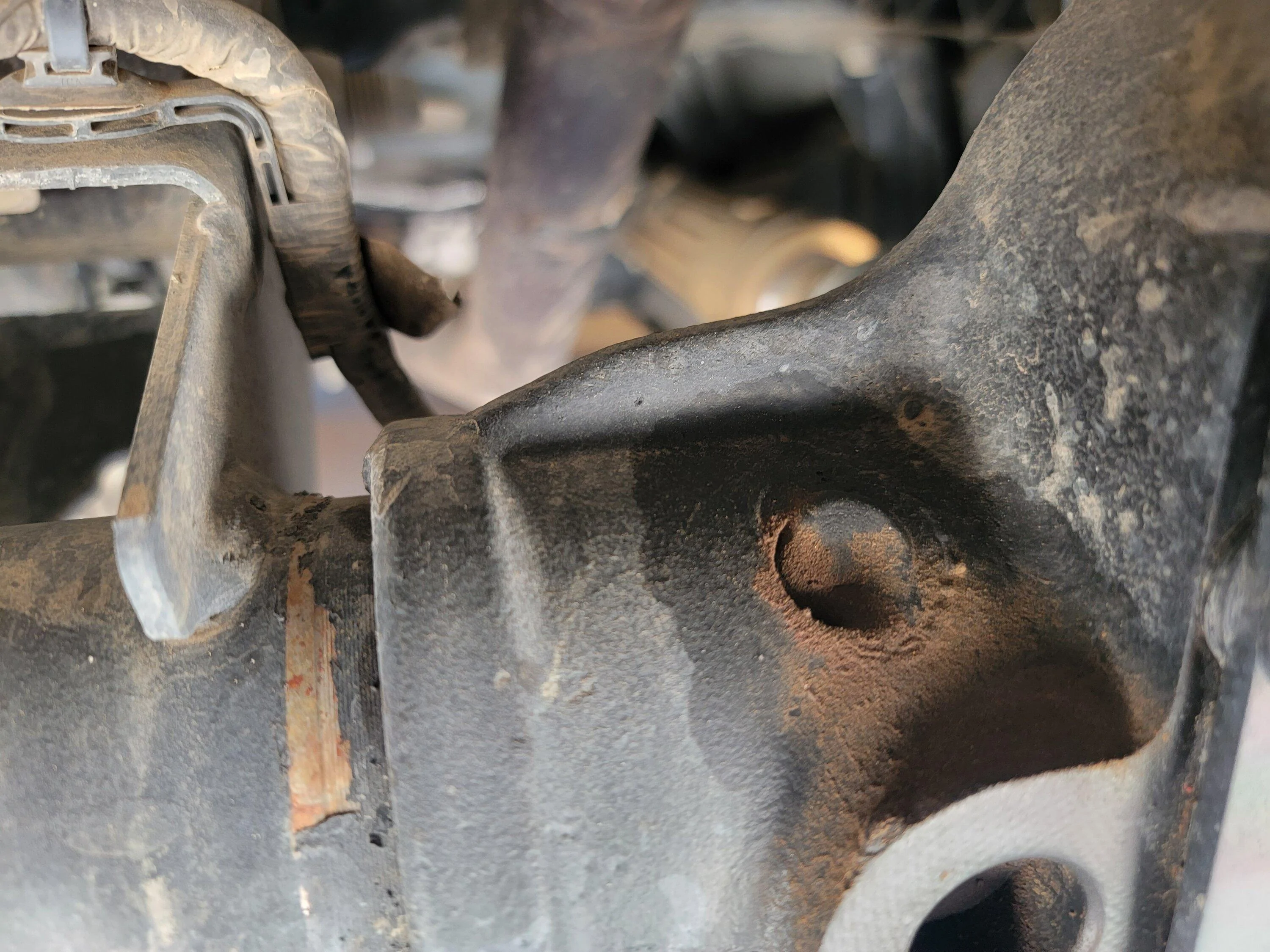

The dealer replaced an 'O' ring on a sensor that was leaking, and said the fluid levels were acceptable.
Fast forward a few months and 500+ miles, and my rear axle appears to be leaking from all 4 plugs welds.
I am wondering how much longer it will go before something catastrophic happens, and is it even safe to drive?
Is this fixable at the dealer level, or is that a whole R & R of the rear end?
Upper Left of Rear Axle
Ford Bronco Rear Axle leaking part 2 8-23 Upper left Axl
Upper Right of rear Axle
Ford Bronco Rear Axle leaking part 2 8-23 Upper right Axle
Lower Left of Axle
Ford Bronco Rear Axle leaking part 2 8-23 Lower Left Axl
Lower Right of Axle
Ford Bronco Rear Axle leaking part 2 8-23 Lower Right Axle
I had some fall trips planned with the Bronco, but I'll put them on hold now.

IF I WERE YOU ID MARK THE AXLE WITH A SCRIBE. THAT LEAK DOESNT SCARE ME FROM DRIVING…. IF THE AXLE ROTATES ID BE CONCERNED
