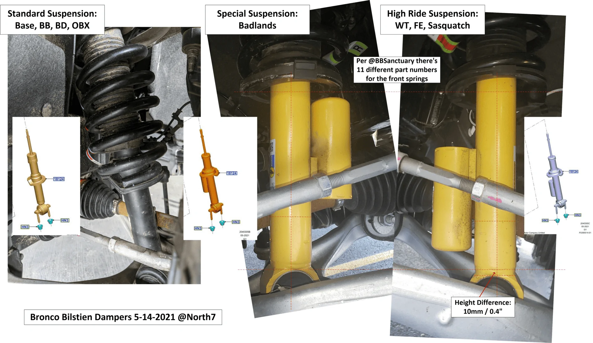

Remember that the SQ package includes an upgraded suspension package, so it may not be an apples to apples comparison with some trims. The upgraded suspension that is found on the SQ is included with the BL and WT.
Wildtrak comes with the Sasquatch suspension but not the Badlands. While the Badlands does have the Bilstein coilovers with reservoirs, the differences stop there. The reservoir mounting is different and the Badlands has .4" additional travel for better articulation. The Sasquatch Bilstein's have a built-in .4" hydraulic bump stop.
The Definitive Guide to 2021+ Bronco Ride & Lift Heights with Wheel & Tire Sizes
Bilstein HOSS & Position Sensitive Dampers Part Numbers & Differences
Ford Bronco Sasquatch On-Road Driving Experience? 1620995530591-png-png-png

I thought it was on the BL as well? With the sas package only being 2500, instead of 5000.
https://thebronconation.com/forums/...n-badlands-vs-sas-suspension-difference.3626/
Then this:
Or maybe stiff springs which also increase ride height? Contradictory info on some of this stuff from Ford...
But yeah, Badlands is more or less the same as a Sasquatch.
Sas has the 35s on wider bead-lock capable wheels, wider fender flares, and different final drive ratios.
I'm just looking to see why the sas package is much cheaper, if the suspension is not the same.
Then this:
BL and Sas share very similar shocks, but they are not identical… They are the “same” position sensitive dampers… likely the same cost to Ford (compared to Base-OB), but not the same part numbers…. They are designed differently but we’re not sure for what purpose. They are both the same and not the same… if that makes sense.
Springs vary greatly by trim to accommodate differences in GVWR and ride height aims... but shouldn’t differ in cost in a meaningful way.
BL does already include things that Sas has, like the upgraded front diff.
BL is closer to Sas than Base-OB, but isn’t exactly there, so the upgrade cost to Sas on BL will be smaller than it would be on other trims…. If that’s what you’re asking.
