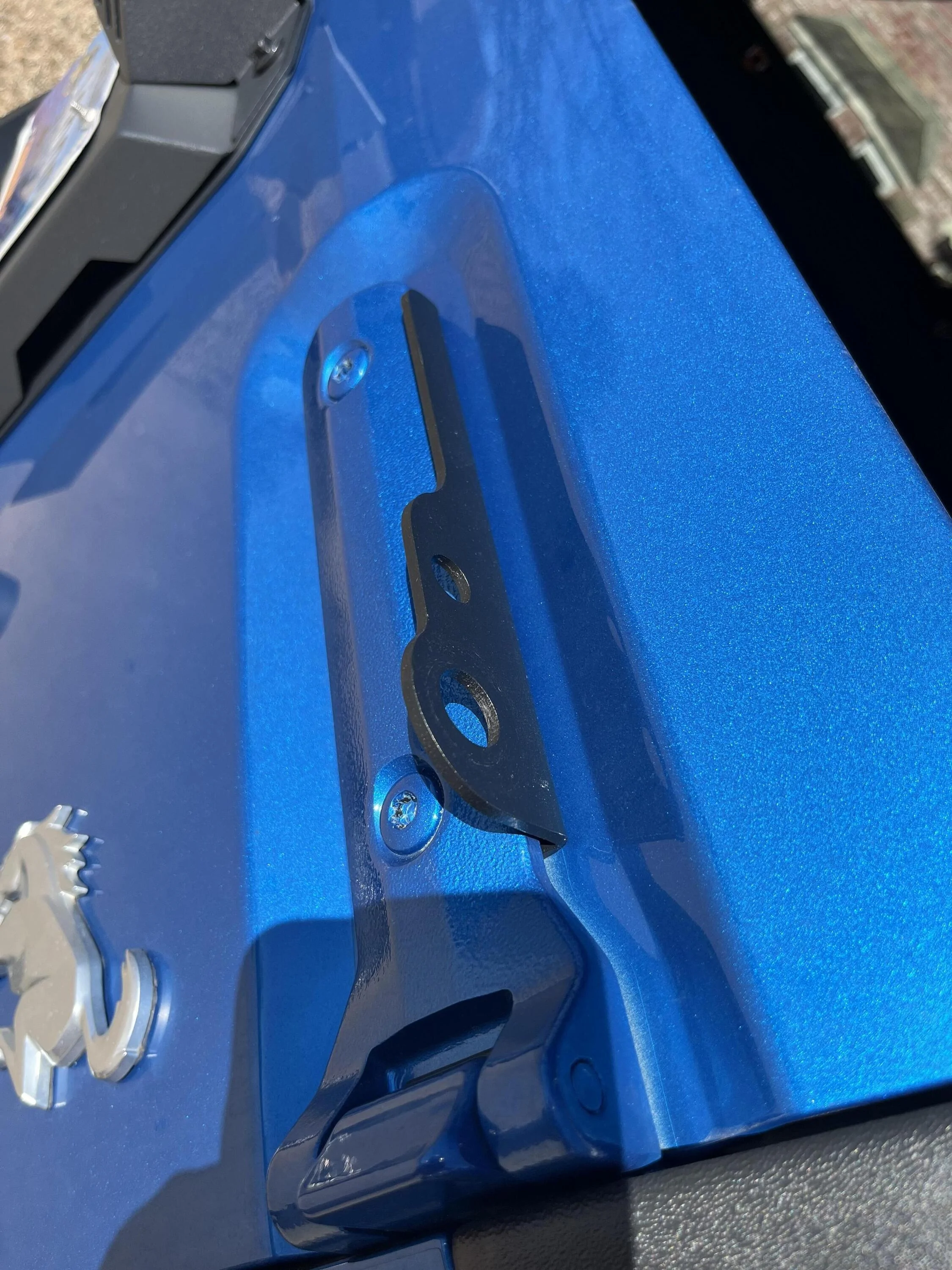

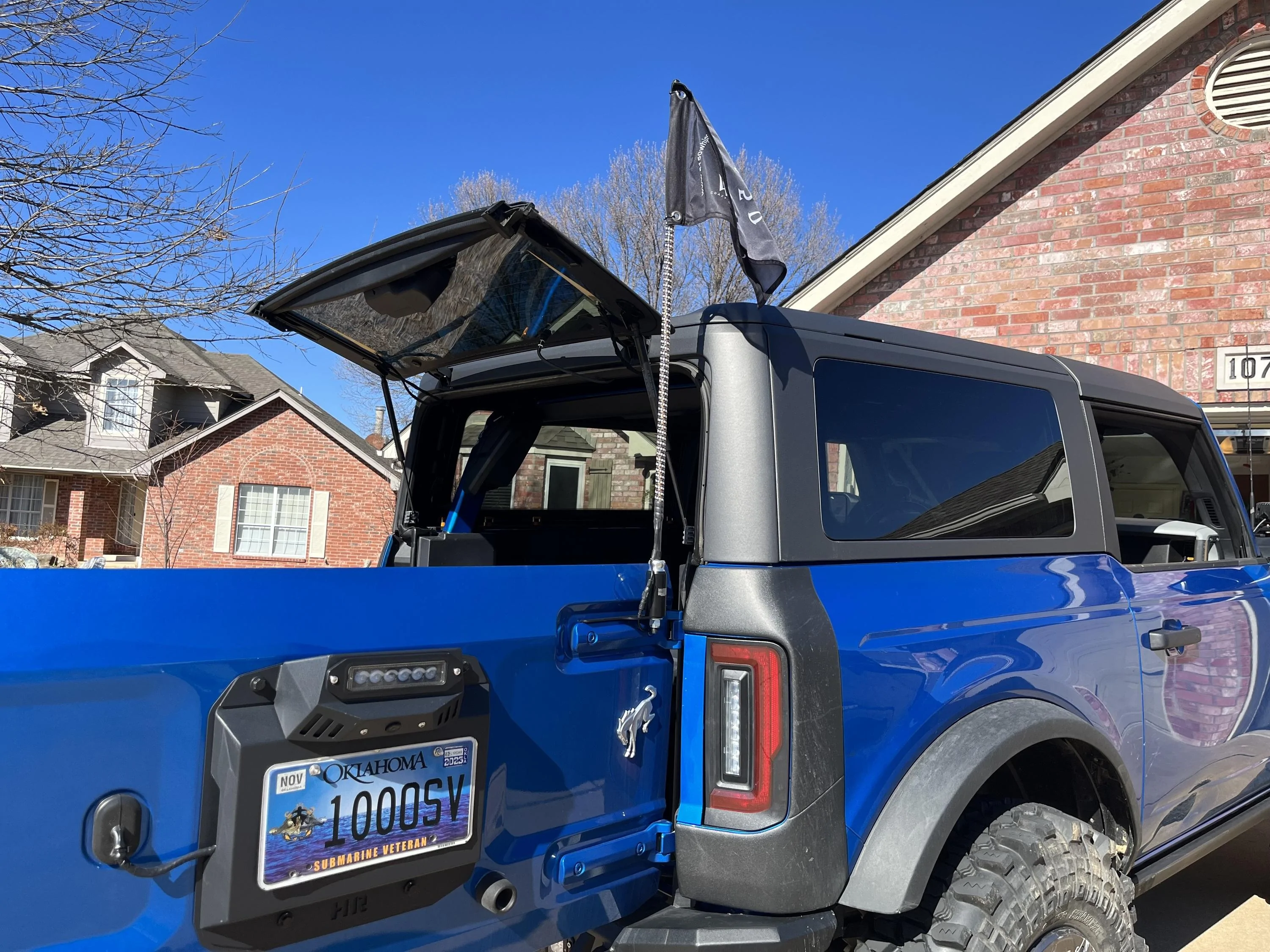

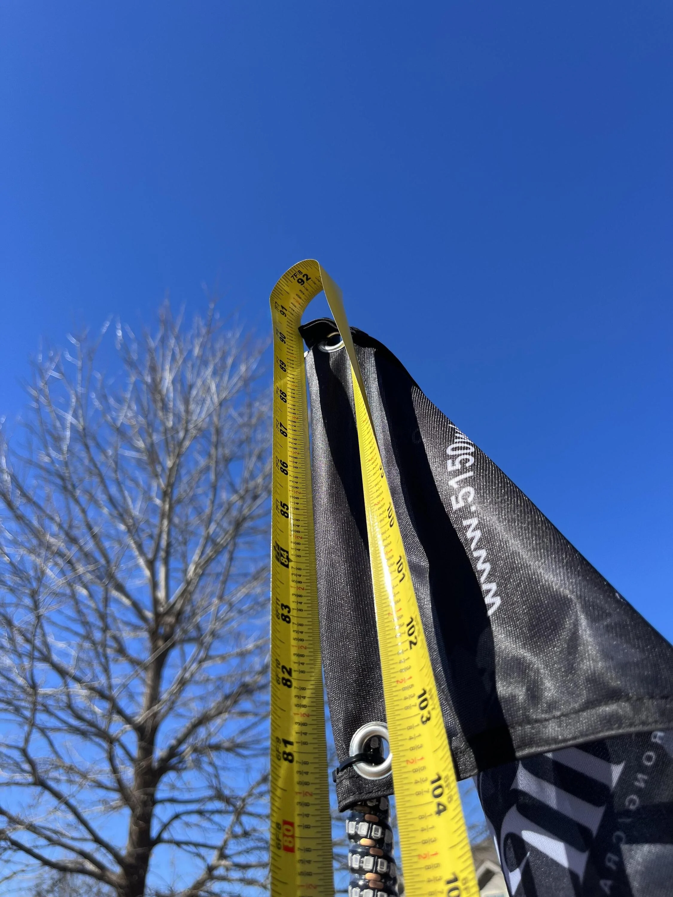

eBay seller (not me) has a mount I used for $28. It mounted easily behind the top tail gate hinge. I purchased a 3 foot Whip and I'm only at 7 foot 6 inches, so I would recommend the purchase of a 4 foot Whip for use with this mount on the Bronco.
I would think that would mess up your door alignment?? I could be wrong lol
I see what you mean. I didn't have any alignment issues, but I also didn't have a heavy spare tire weighing down the door when I installed my piece. My door still opens and closes like it did before. 🤷‍♂️
That is interesting I would of thought that having that spacer would bind the hinge 🤷🏻‍♂️.. well cheers that person lol
