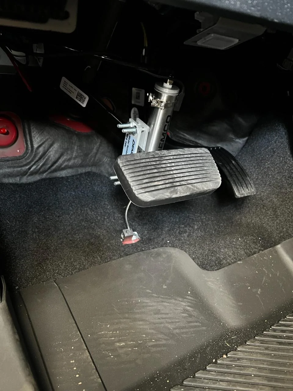

Well we took the Bronco out for a maiden voyage behind our Winnebago and it worked well. The air brakes worked as expected, the tow mode while not simple to get into, seemed to work once we got it set.
Getting out of it wasn’t as simple as I thought it would be, but after a little playing around it worked. After some practice I think it will be straightforward.
I checked that my charging cable was indeed charging the battery, and I verified that the brake pedal was being pressed by the air system. Everything worked as expected.

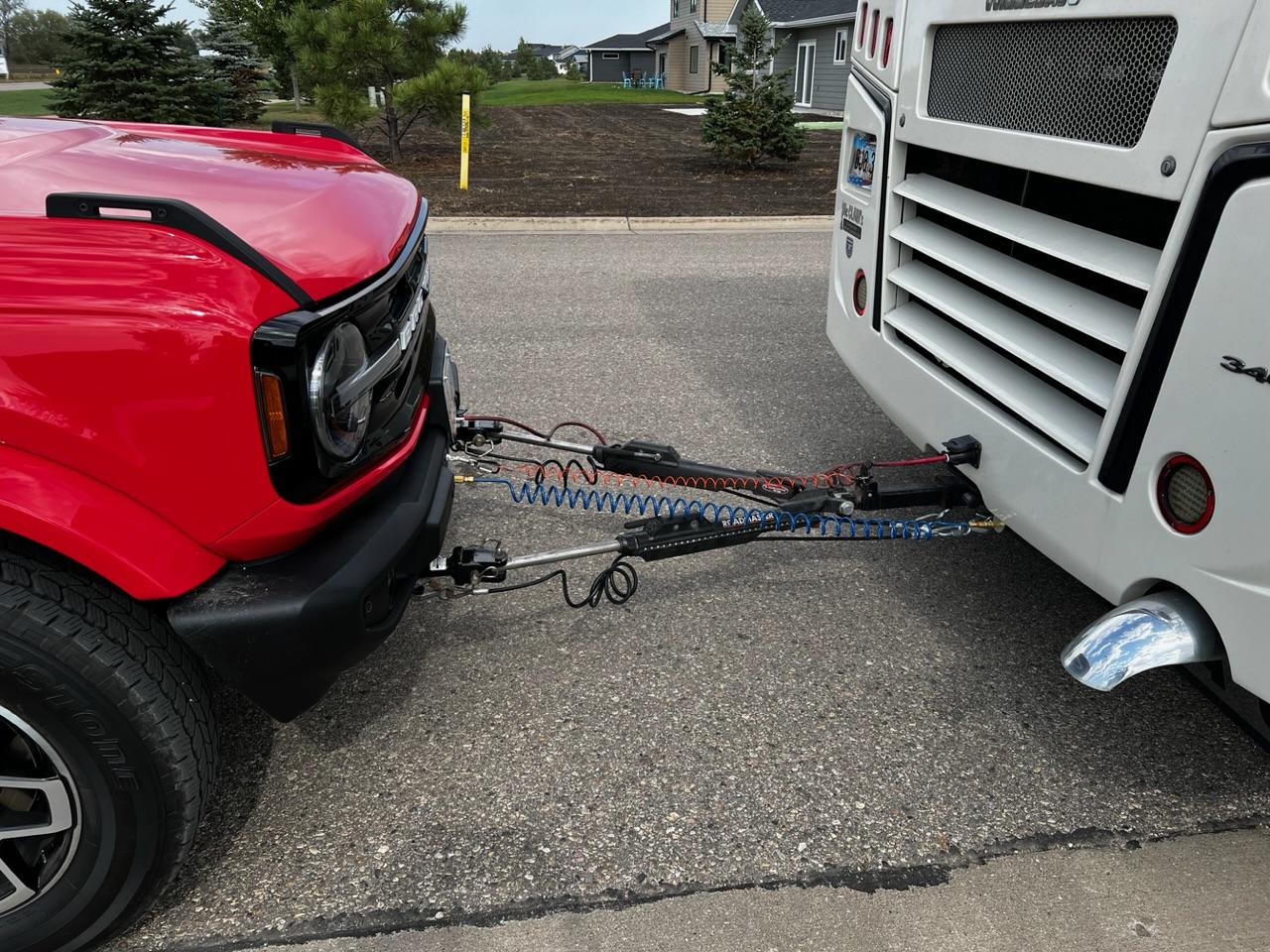

Ford Bronco RV'er from South Dakota IMG_5211
The thin red curly cable is the breakaway which will activate the bronco brake system if the bronco breaks away from the rig. The blue line is the air line from the rv that activates a cylinder that pushes down on the bronco brake pedal.
Ford Bronco RV'er from South Dakota IMG_5221
The large red cable is the lighting cable that activates the bronco taillights through diodes.
The black cables are safety cables in case the tow bar fails somehow (yeah right lol)
We only did a short drive so I’ll put up more info when we do a real test.
