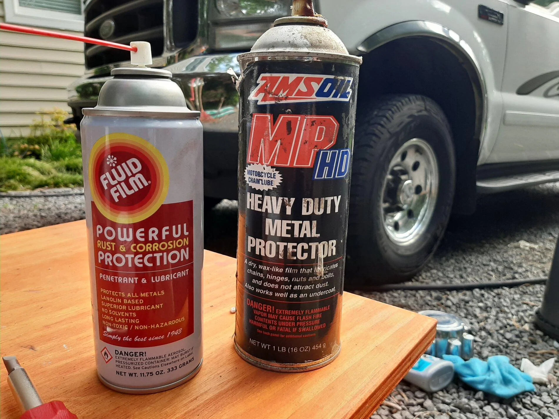

While I wait for the configuration tool to become available I'm researching things I'll need/want to do after delivery. First thing on my list is rustproofing/undercoating. I live in Northeastern IL where they use tons of salt in the winter. Toyota replaced the rotted frame on my 05 Tacoma DCLB at a cost to them of about 15K (per service manager). Even though they covered it (after a class action lawsuit) it was a hassle (2 months with a loaner minivan!) and didn't address rust anywhere else on the vehicle. I see so many rusted/rotted vehicles here I want to be proactive and avoid that to the max extent possible on my new Bronco. Know to avoid rubberized/asphalt products for the undercoating as crack/chips can make matters worse when moisture gets underneath. Used LPS3 on Tacoma's new frame. Not familiar with/have never used any body panel, door, fender etc rustproofing products
What are others planning to do with regard to this issue?
Good products/experiences to recommend? Bad ones to avoid?
Thanks in advance

I'm planning on Fluid Film. I used Amsoil hdmp on my 2013 f150 and it has worked well also.
I dearly hope they have done a proper job on this thing at the factory. My early Broncos were rust buckets and my 2003 f250 is shockingly bad.
