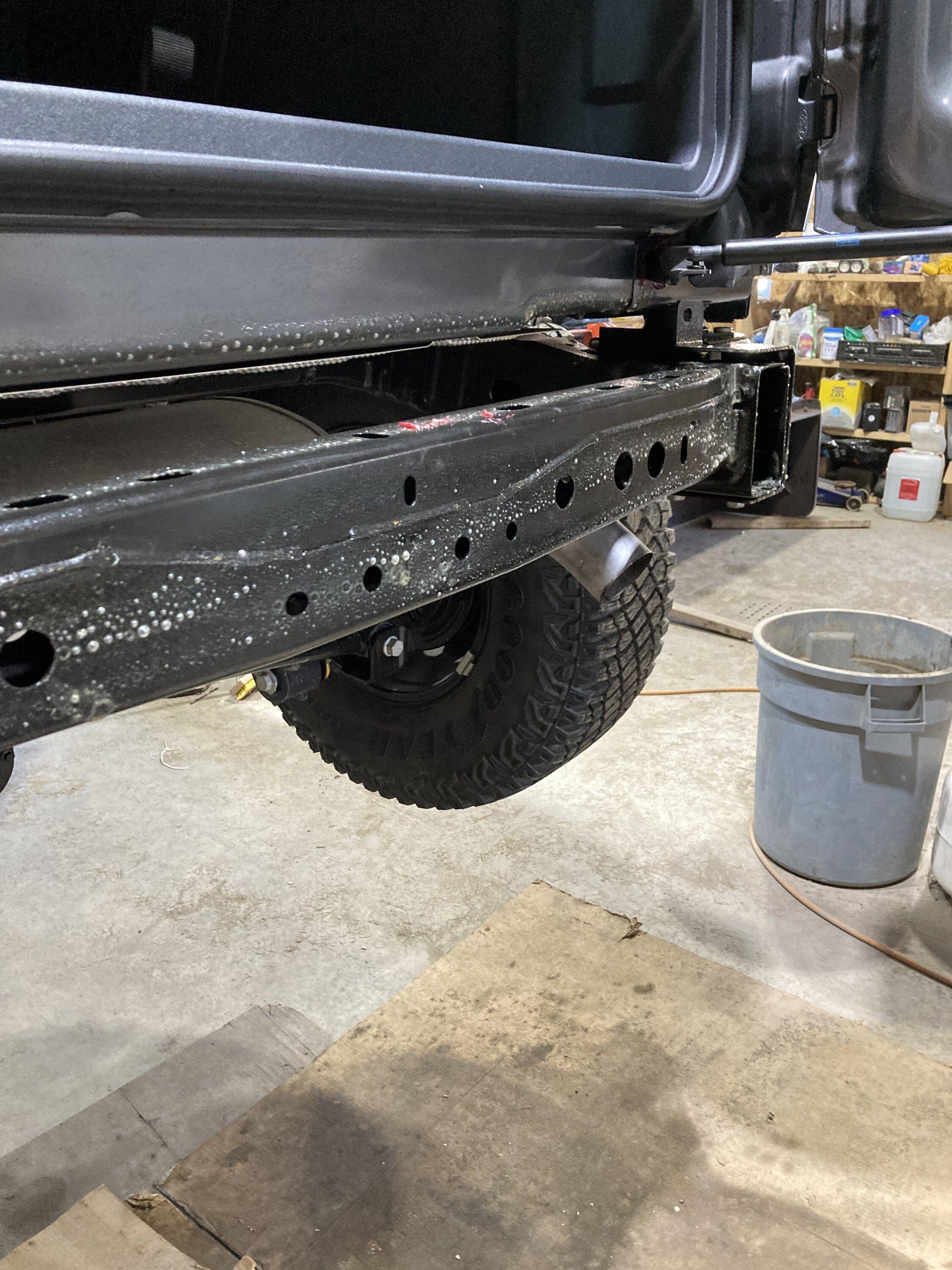

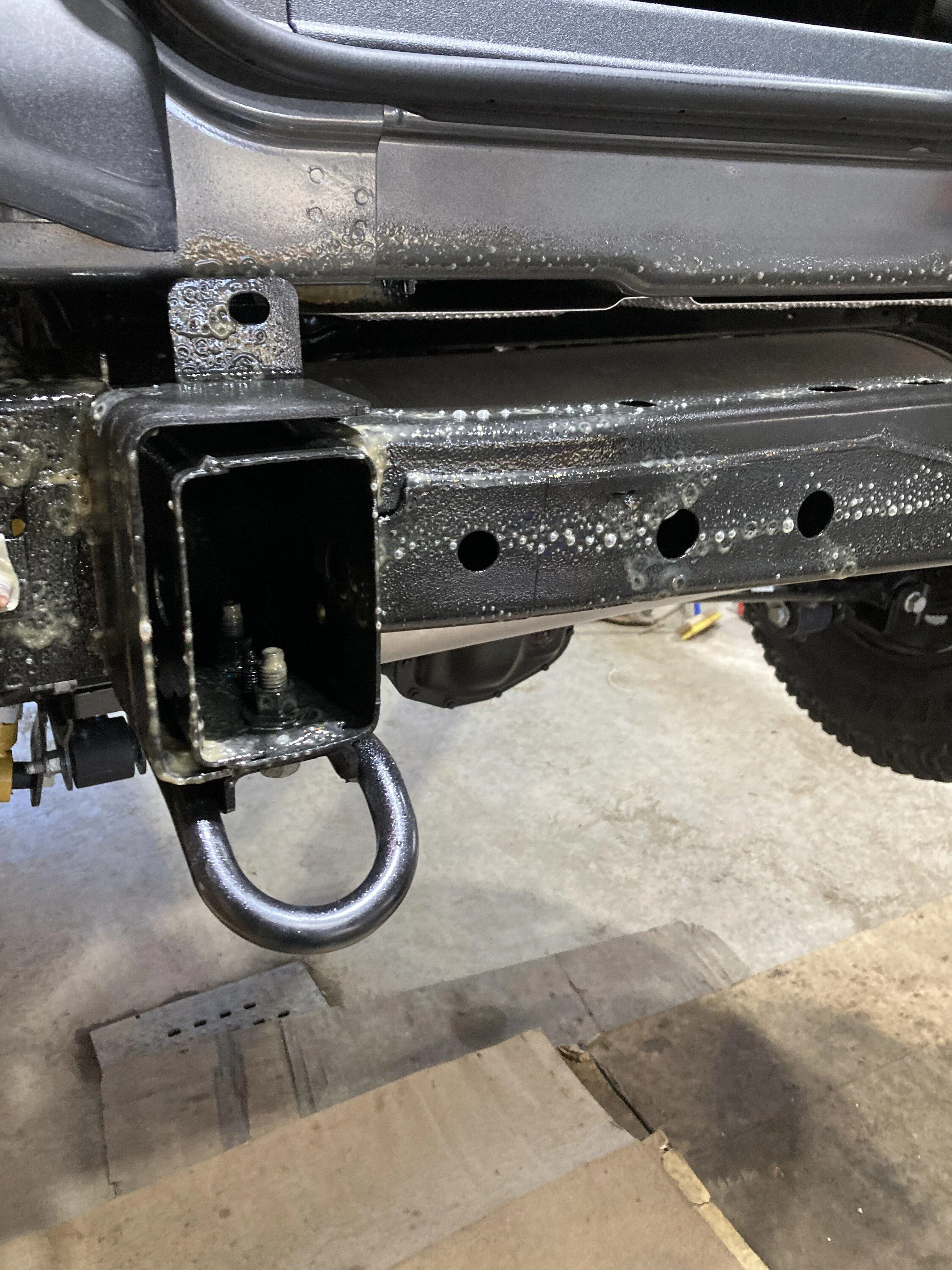

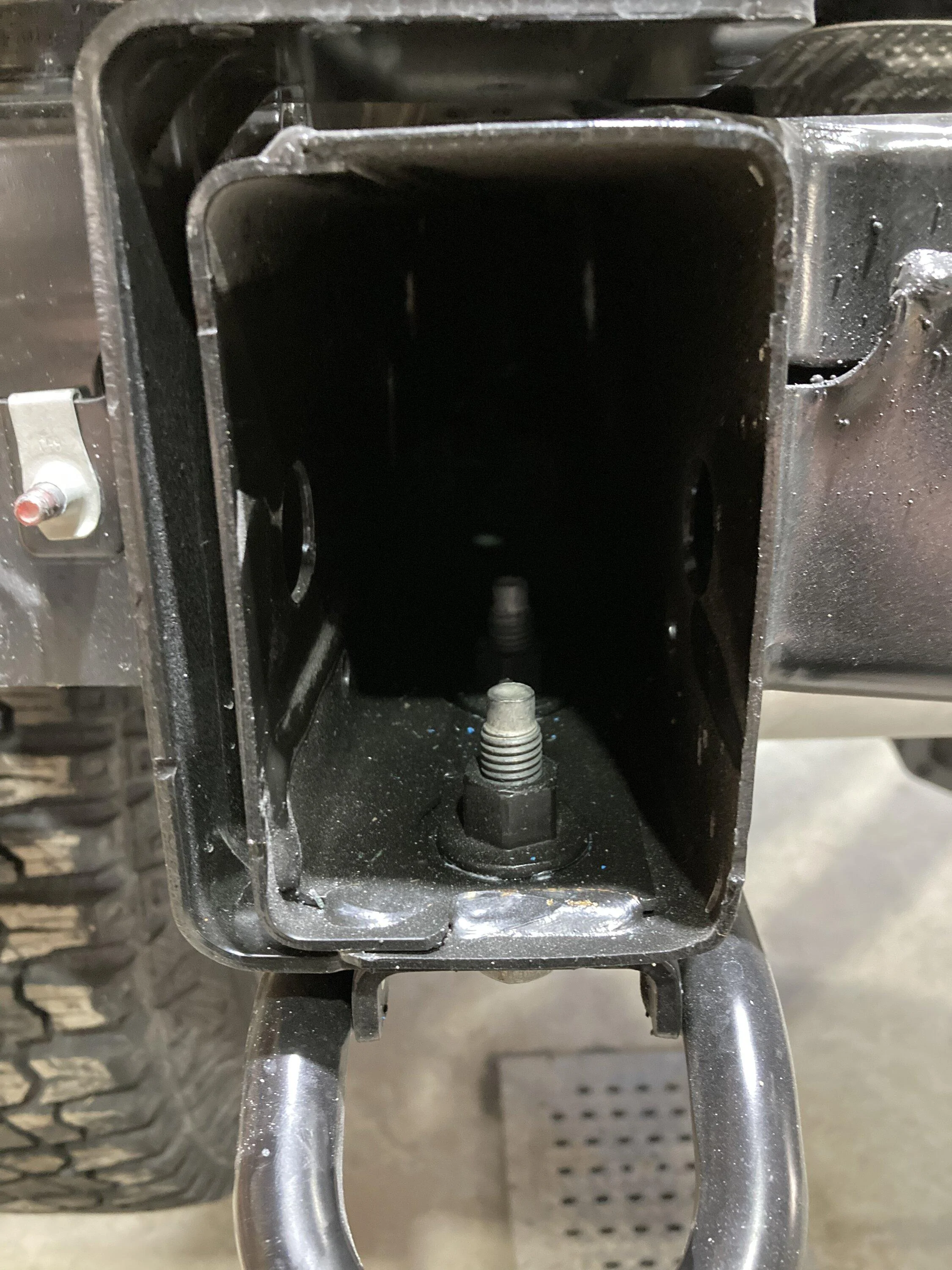

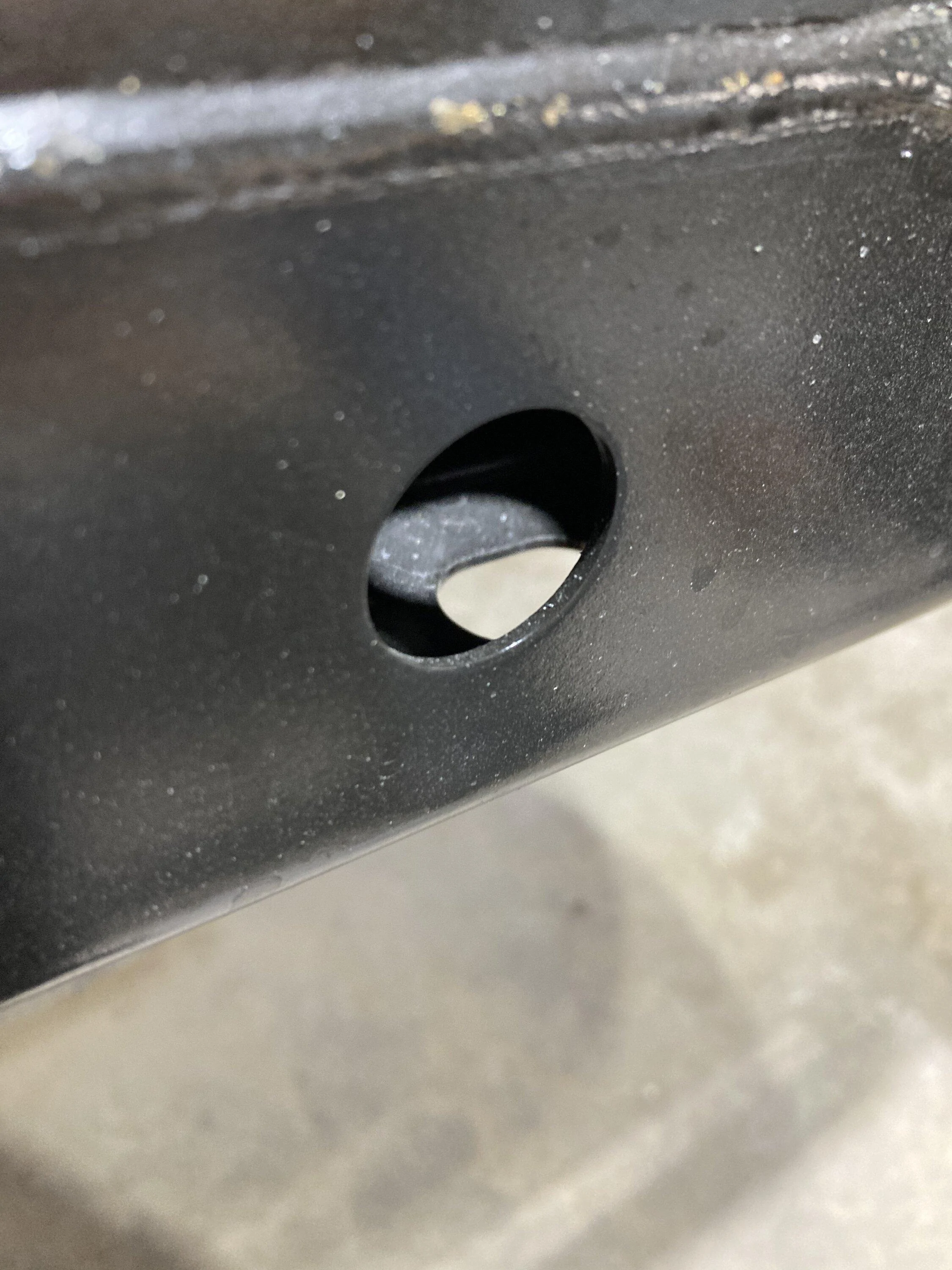

I got my Bronco last week and first thing I did was to pull the bumpers and rust proof the frame.
I can confirm that the rust proofing that Ford puts in the frame is only on the middle part of the frame. The ends and the rear cross sections aren’t rust proofed from the factory.
first 2 photos are before the rust proofing
