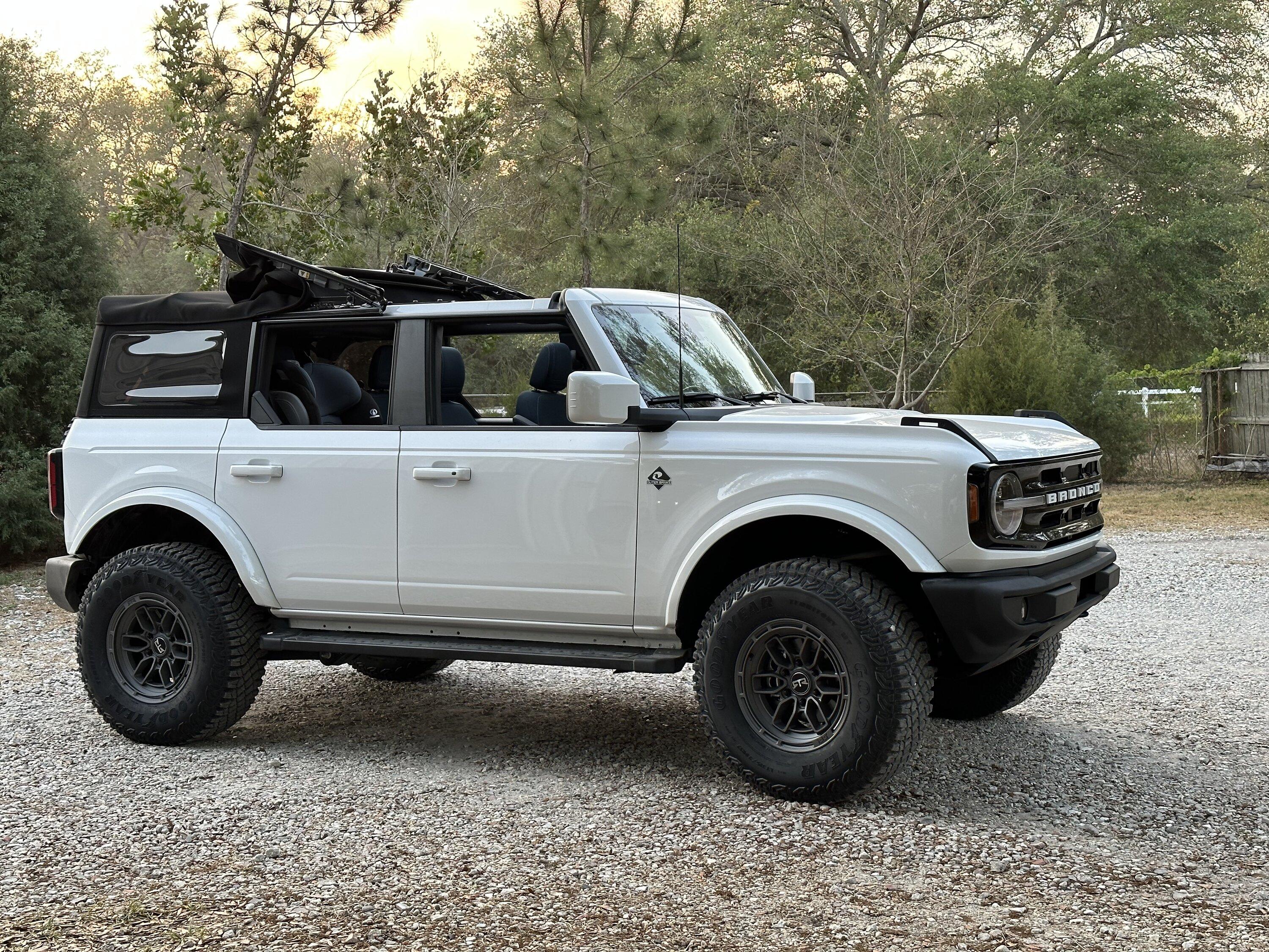

Here is the evo 6 in et 18 with the factory 37 ko2s. Im actually selling the tires as im going to 39s next week.

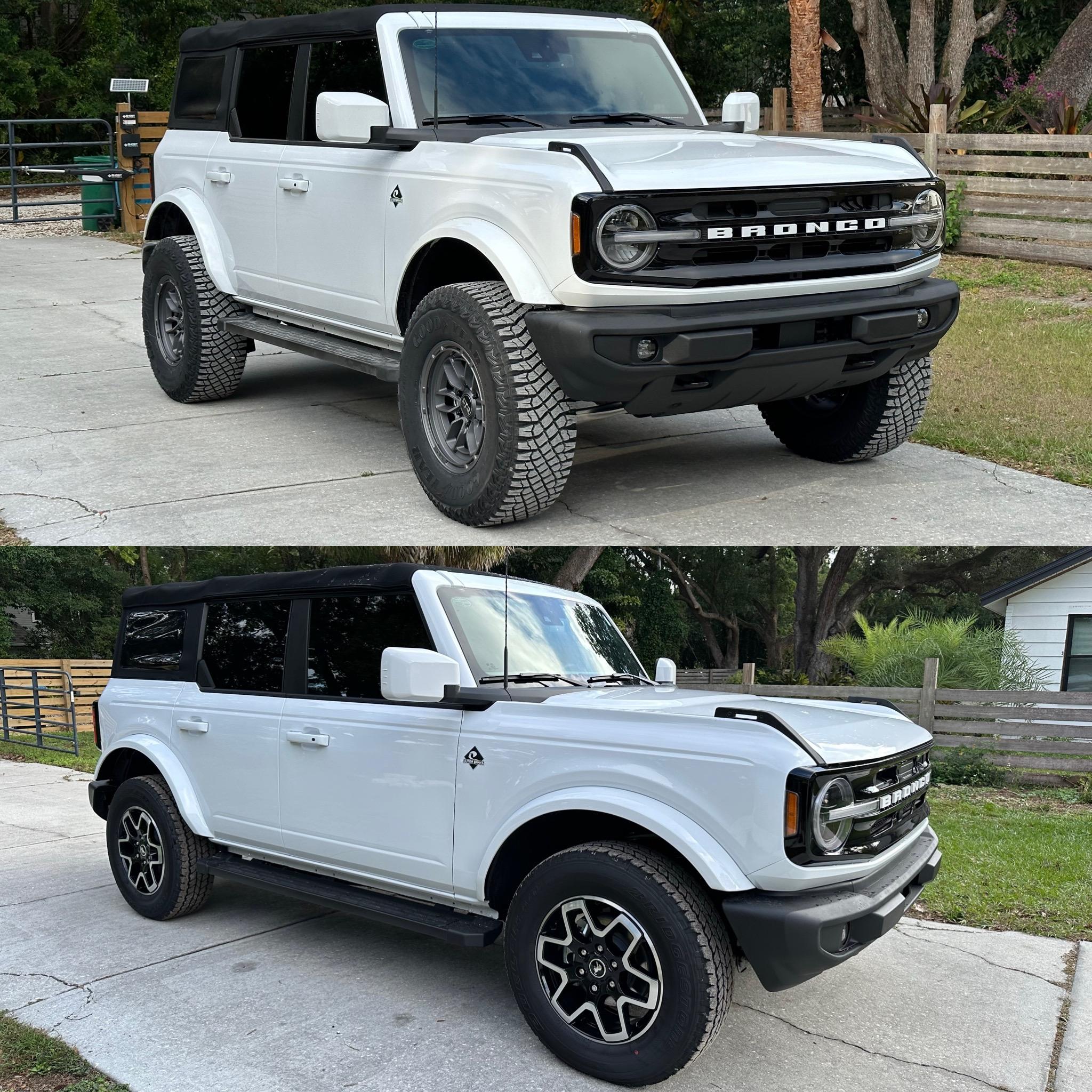

I went with the +30 on my SAS to try and keep the stance close to OEM. I haven‘t done the whole lock to lock / flex check yet, but fitment appears to be very close to stock with the 315s mounted up.
Not perfect but I think you can get the idea:
Stock
Ford Bronco RTR EVO 6 Wheels IMG_4537
RTR EVO 17x9 +30 w/Pirelli Scorpion AT+ 315/70-17
Ford Bronco RTR EVO 6 Wheels IMG_4536
