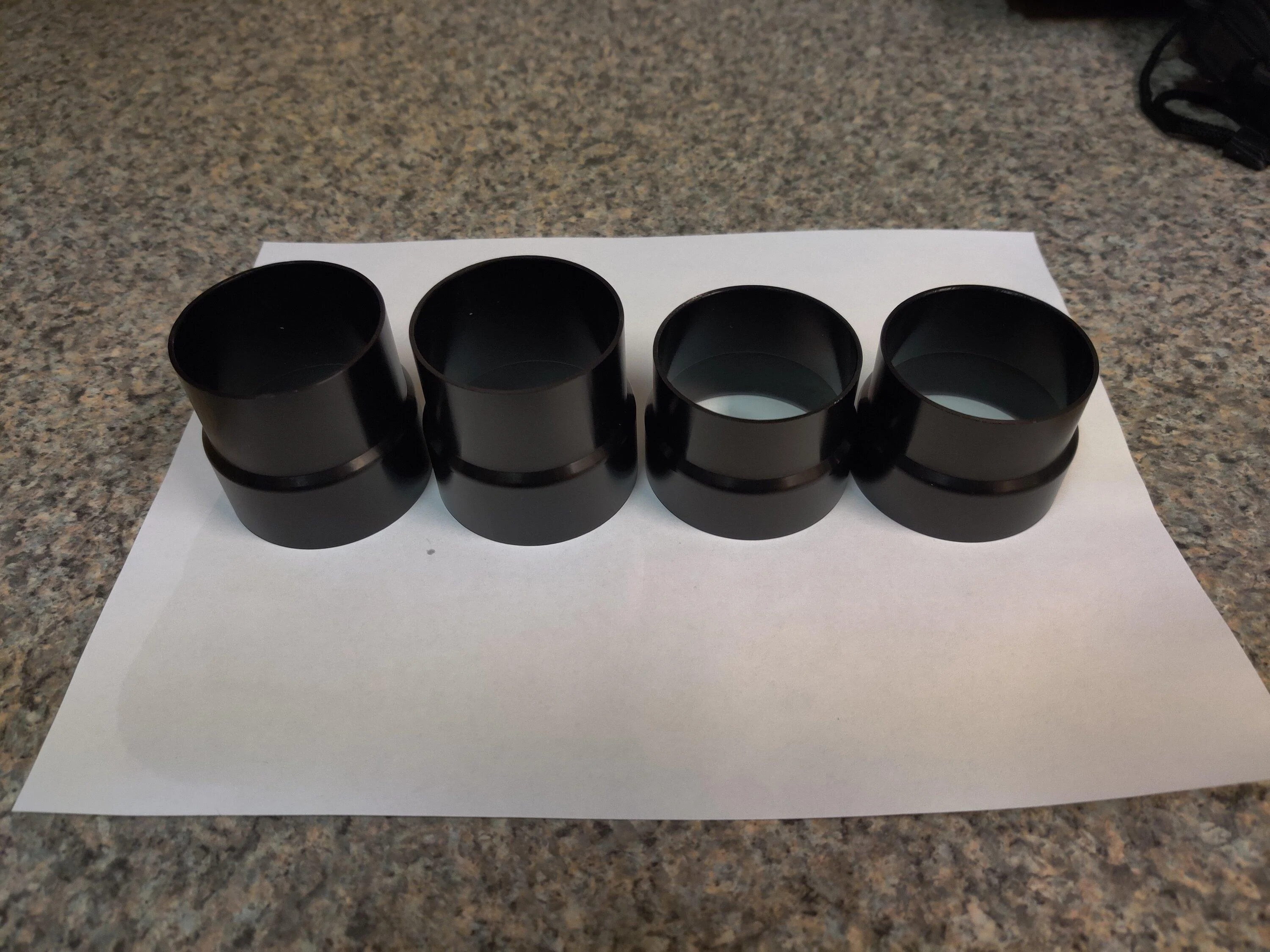

I recently ordered a set of RPG Perch collars for my 4DR Sasquatch. After looking at them, they look like a base set as opposed to Sasquatch based on install videos I've seen. Seller is saying that RPG redesigned the collars to work with both the Hitachis and Bilsteins. Anyone aware of this? The last thing I feel like doing is pulling shocks apart and either the collars don't fit, or the lift is wrong and having to pull everything apart again.

You could always grab a caliper and measure the diameter of your shocks at the spring perch and the collars and make sure it’s similar
Shock outside diameter 50.3mm/1.98" perch collar inside diameter bottom 53.8mm/2.118" and top 50.3/1.98"
Of more concern is the height of the shoulder that creates the new perch base ( measured at the highest point of what the perch sits on) - 27mm/1.06" for the front, 21.95mm/.86" for the rear. Ive seen it somewhere but cant remember, but I know the height to lift ratio for the front is most definitely not over 2:1 to get close to the 2.25" lift

I went back and forth on this option, and it may still be on the table if I can't get a definitive answer on these collars. I have steel F&R bumpers, winch, and full skids so it sits lower than stock and I would like to get the Bronco back to stock height if not more. I am going to be doing a live valve coilover setup next year and would prefer to avoid spending the money on another set of shocks before then if I can, prefer the cheaper option for something temporary.
If they’re selling perch collars that advertise a certain amount of lift but that they fit basically any Bronco (2dr, 4dr, SAS, Non, 2.3/2.7 etc) then no two Broncos are going to achieve the exact same final product anyway. Should be close since theoretically the various trims/versions have different springs to start with I guess though. I know with spacers you can count on 2:1 in round numbers on IFS but perch collars won’t be linear as spring pre-load isn’t linear.
I don’t have any personal experience w/ these but if you’re off-roading then you’re not really going to want to start out by spotting it 2.25” of your down travel before you ever get off the road.. riding that high in your range of travel just at ride height it going to have some significant downsides once you leave the pavement. Spacers aren’t going to be your answer either

For those that may find themselves wondering about this in the future, RPG has confirmed they will fit both Hitachi/Bilstein shocks. Hopefully RPG and resellers change their listings ( all have drop down selections to choose between Sasquatch/non) on their respective websites to get rid of any confusion.
