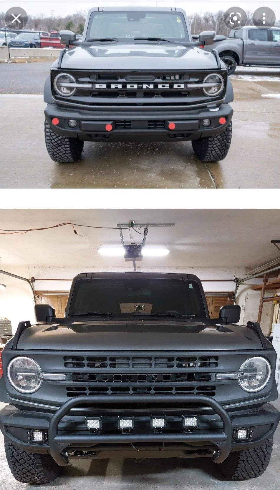

Probably a dumb question; but I'll ask it anyway. I saw this nudge bar wouldn't work with the BL bumper due to the sensors. Would this work with a Black Diamond with mid package though? I know BL and BD both have the same bumper; but would the sensors differ based on the package?
Not a dumb question at all. Here is what I found. I took a screen shot of a Bad Lands standard front bumper. I marked the sensors with red dots. It looks like the nudge bar will block those 2 sensors in the middle of the bumper. I have a Base/Squatch so I don't have those. This may work, but I don't know that. I don't want to give you hope, then after you install it you have sensor problems.
Thanks for the reply! I'm wondering if the sensors would be the same on a mid package Black Diamond vs. a high/lux package BLs. Meaning if the vehicle doesn't have adaptive cruise control, would the sensors be located in different spots? I just want to find some kind of a bar option for my BD! Lol

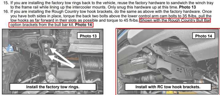

Does anyone know if you can install both the Rough Country nudge bar AND their tow hook brackets?
Looks like you can use any combination of the bull bar, tow hook brackets, and winch Mount.
This is from the installations for the RC winch mount:
