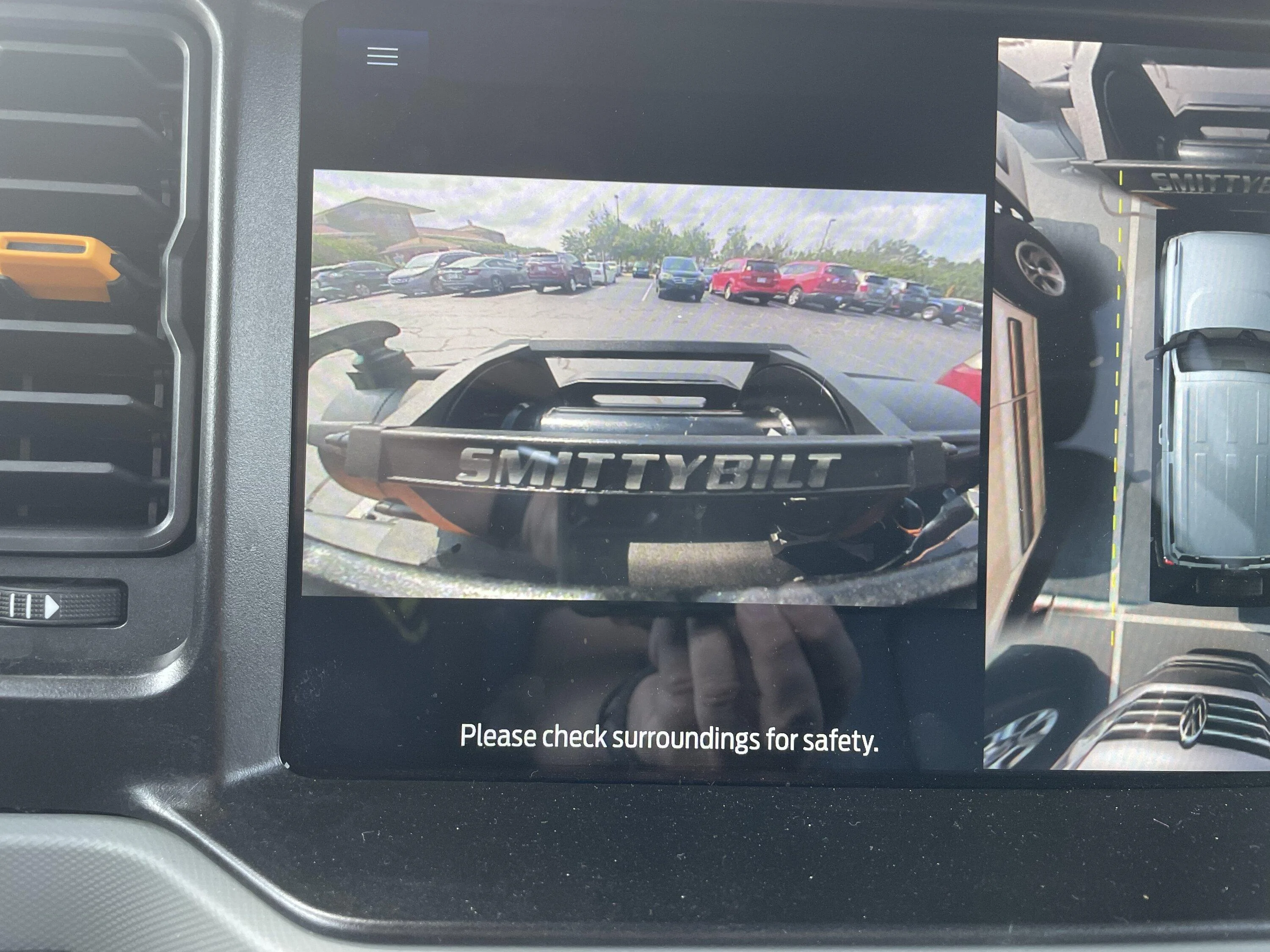

It’s not too bad for parking etc. If I ever intend on rock climbing or steep trailing, I will relocate it.
Thanks for the image. I bought it and haven't had good to install yet. I do some off-road a few times a year. Hoping to see some reasonable relocation kits coming out.
