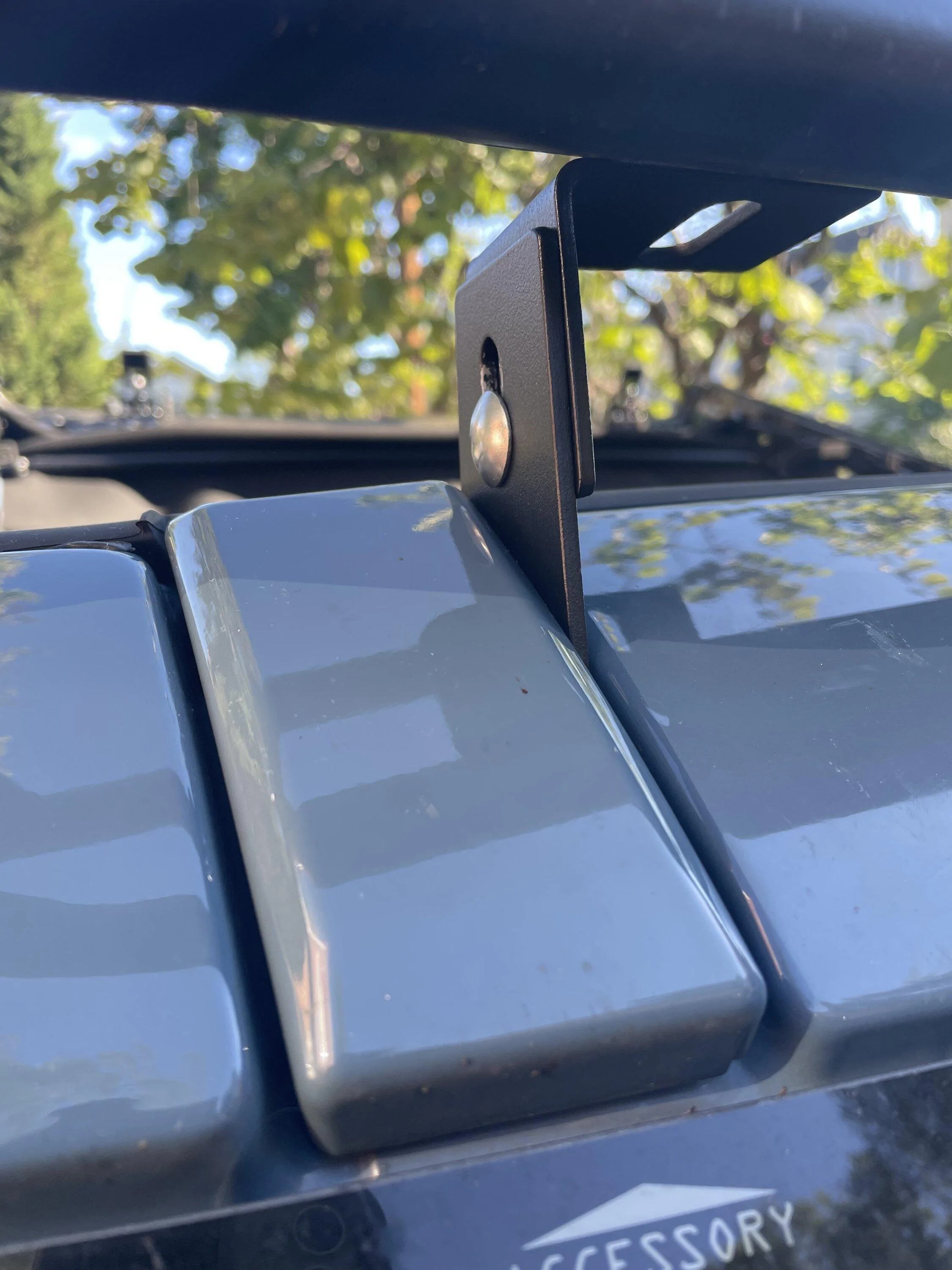

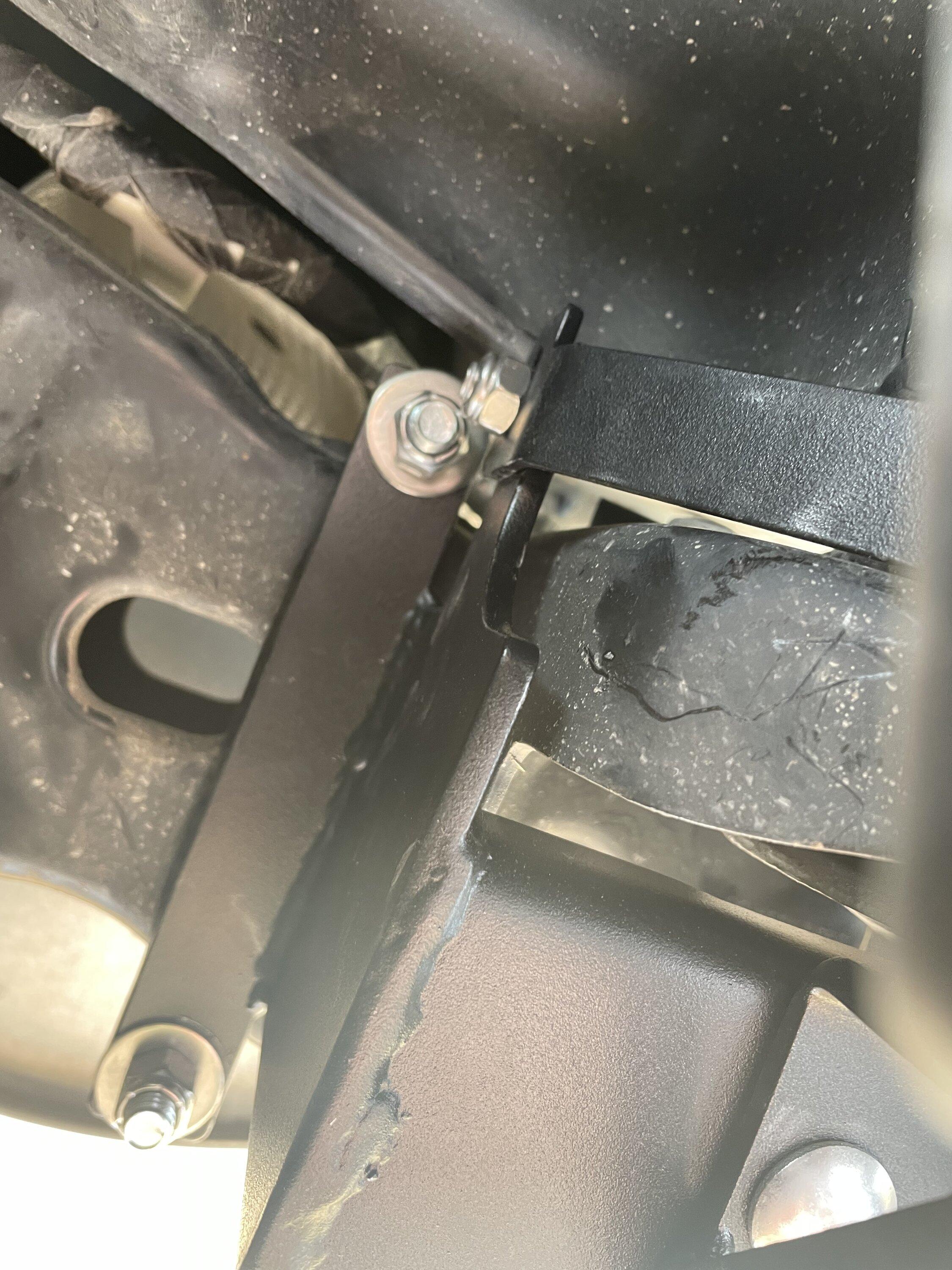

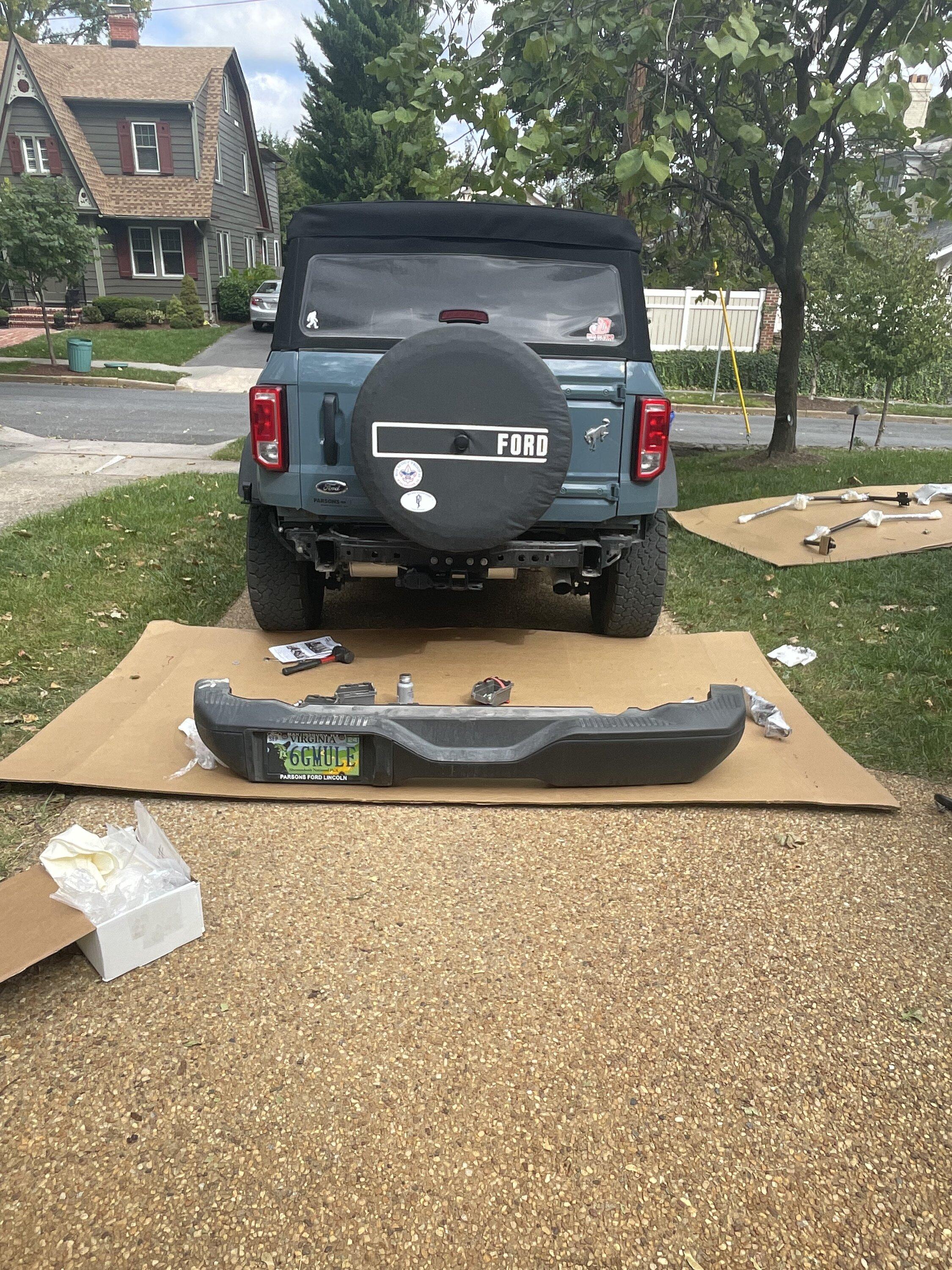

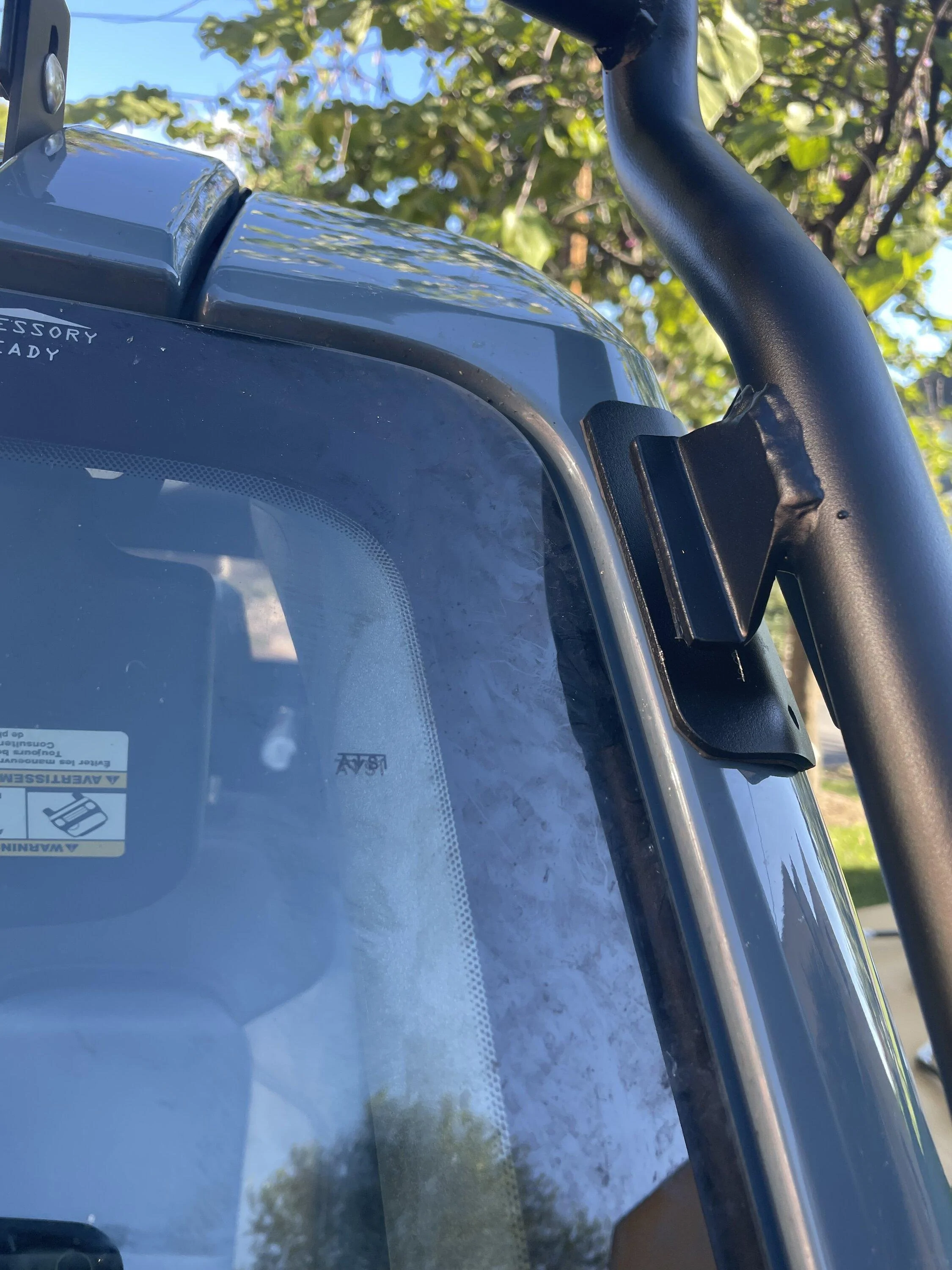

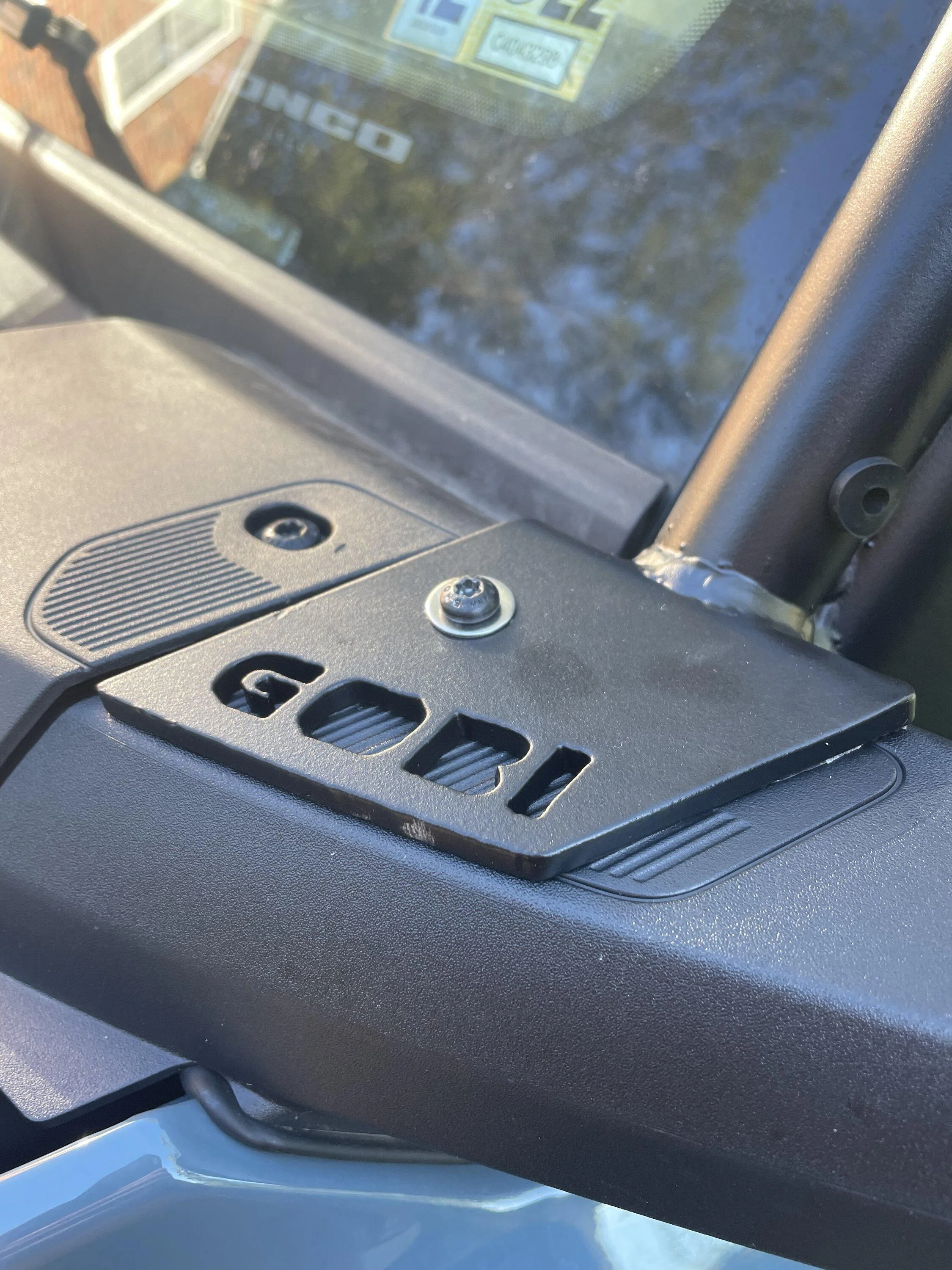

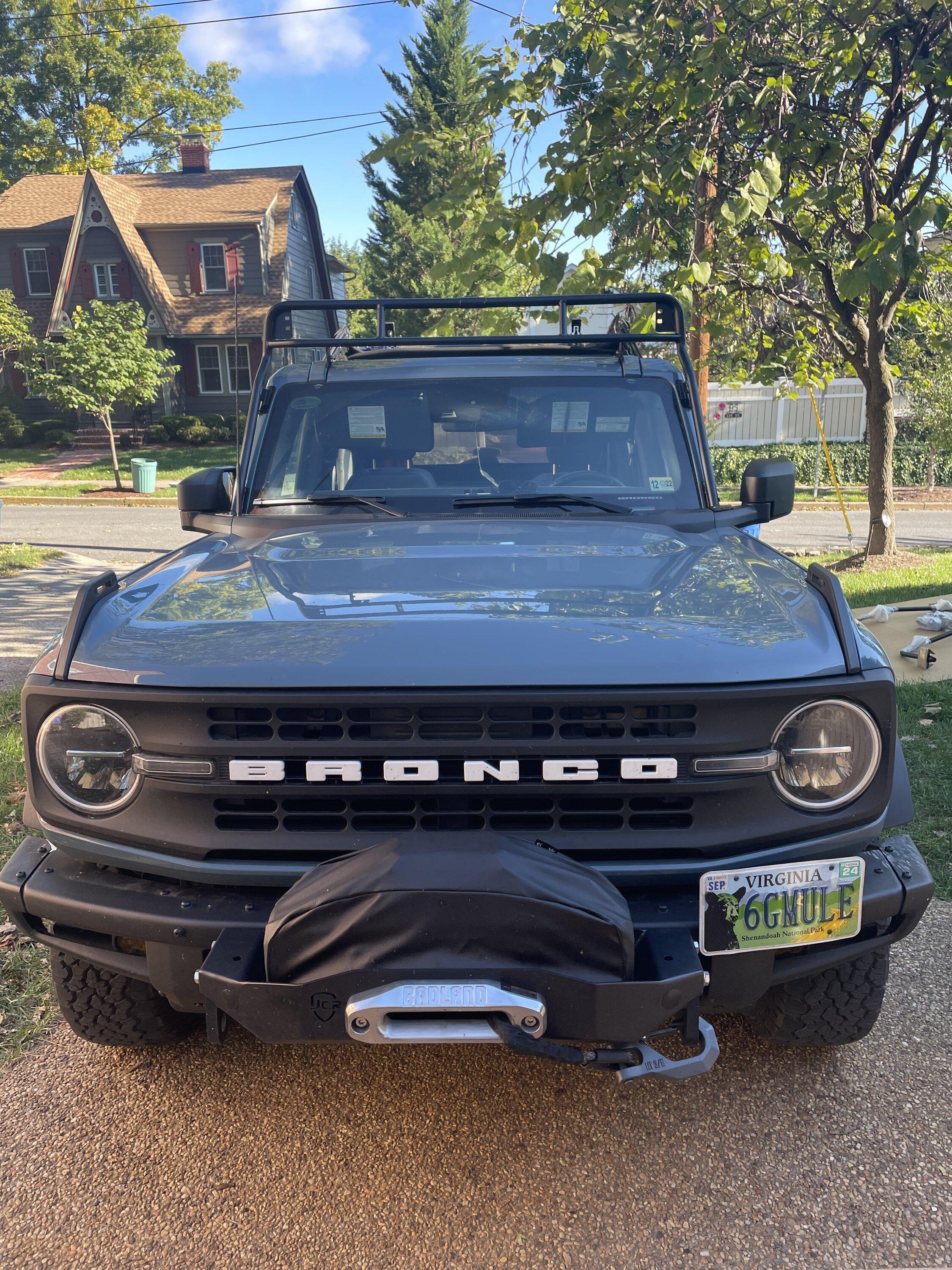

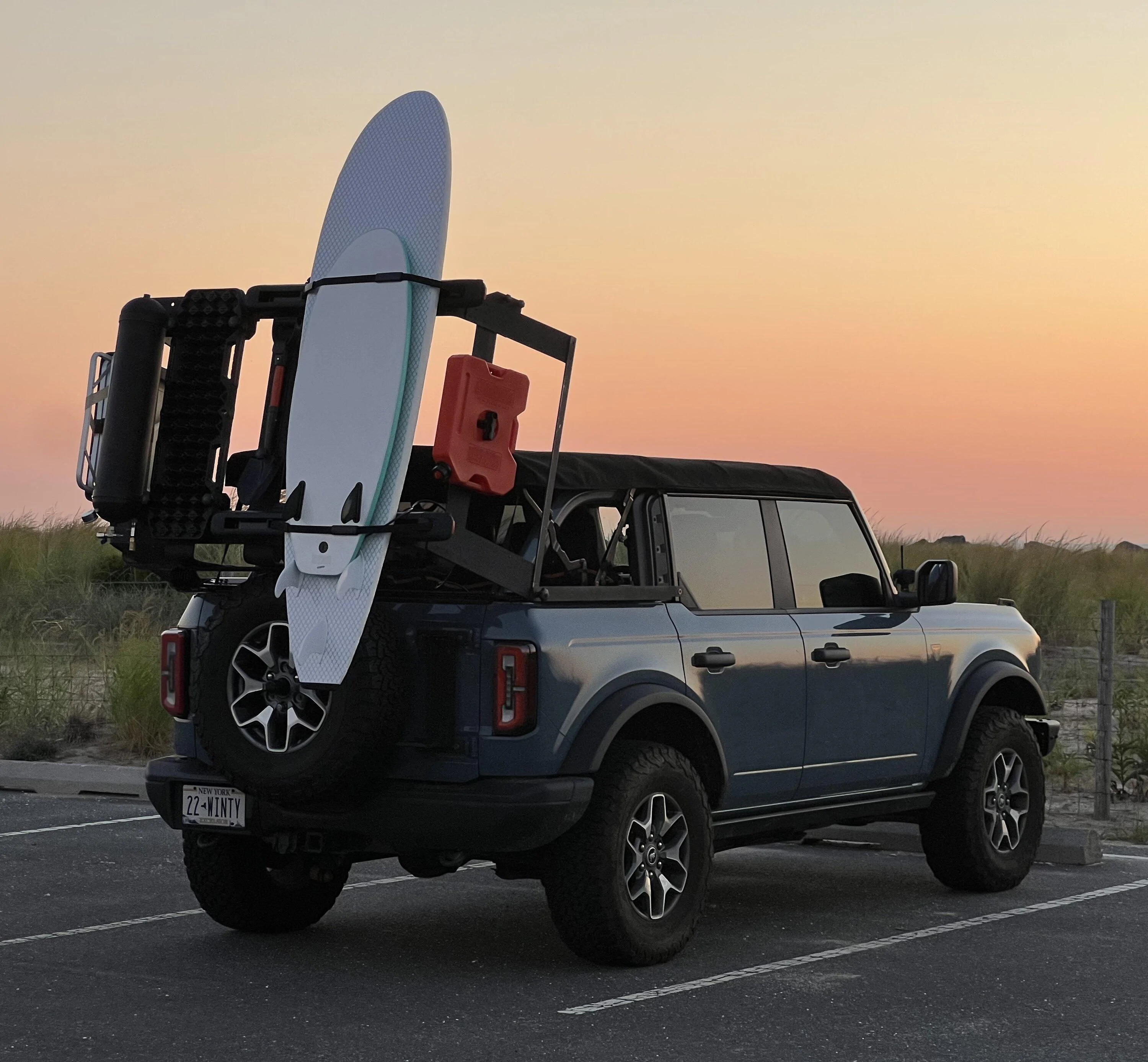

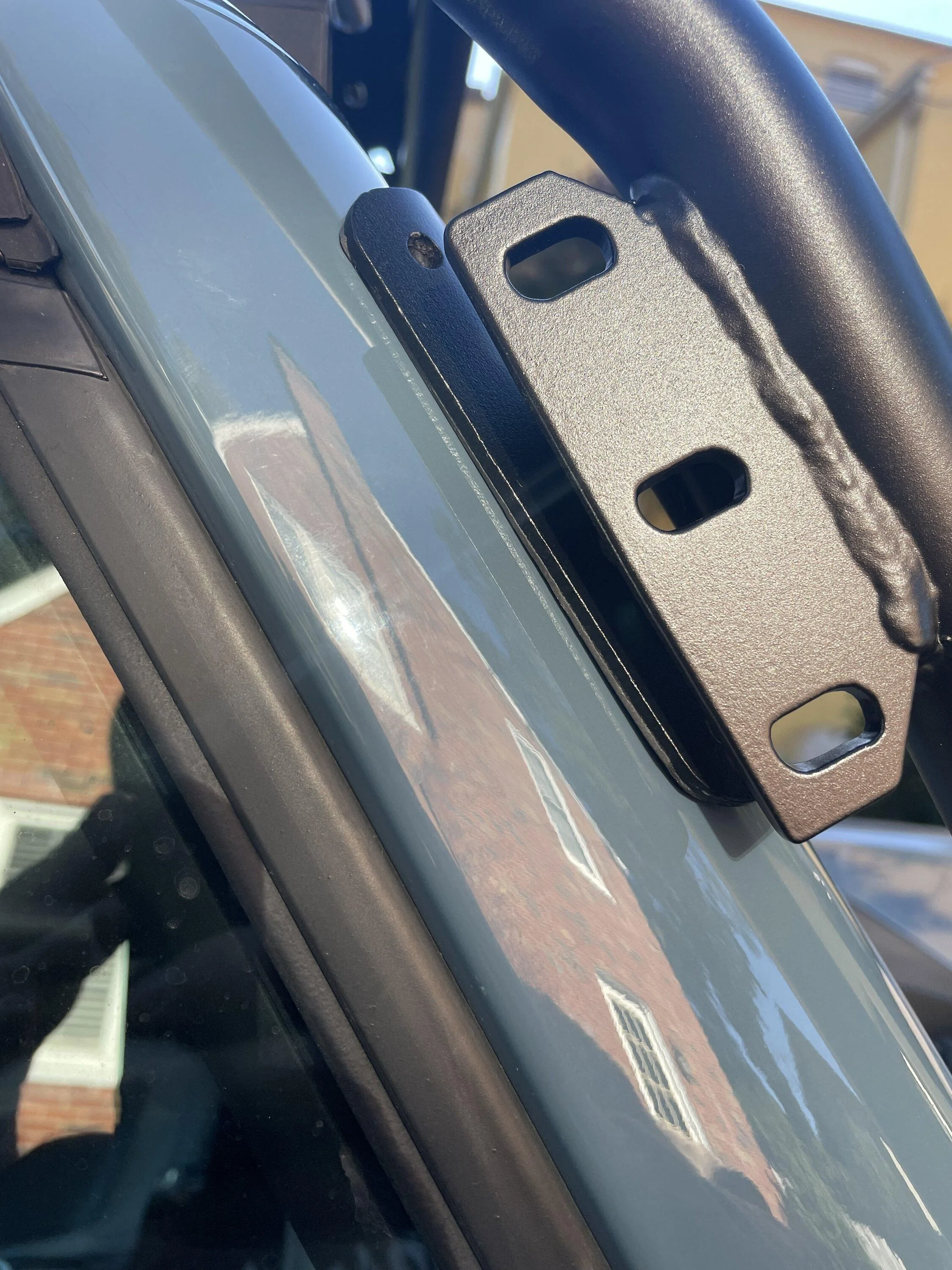

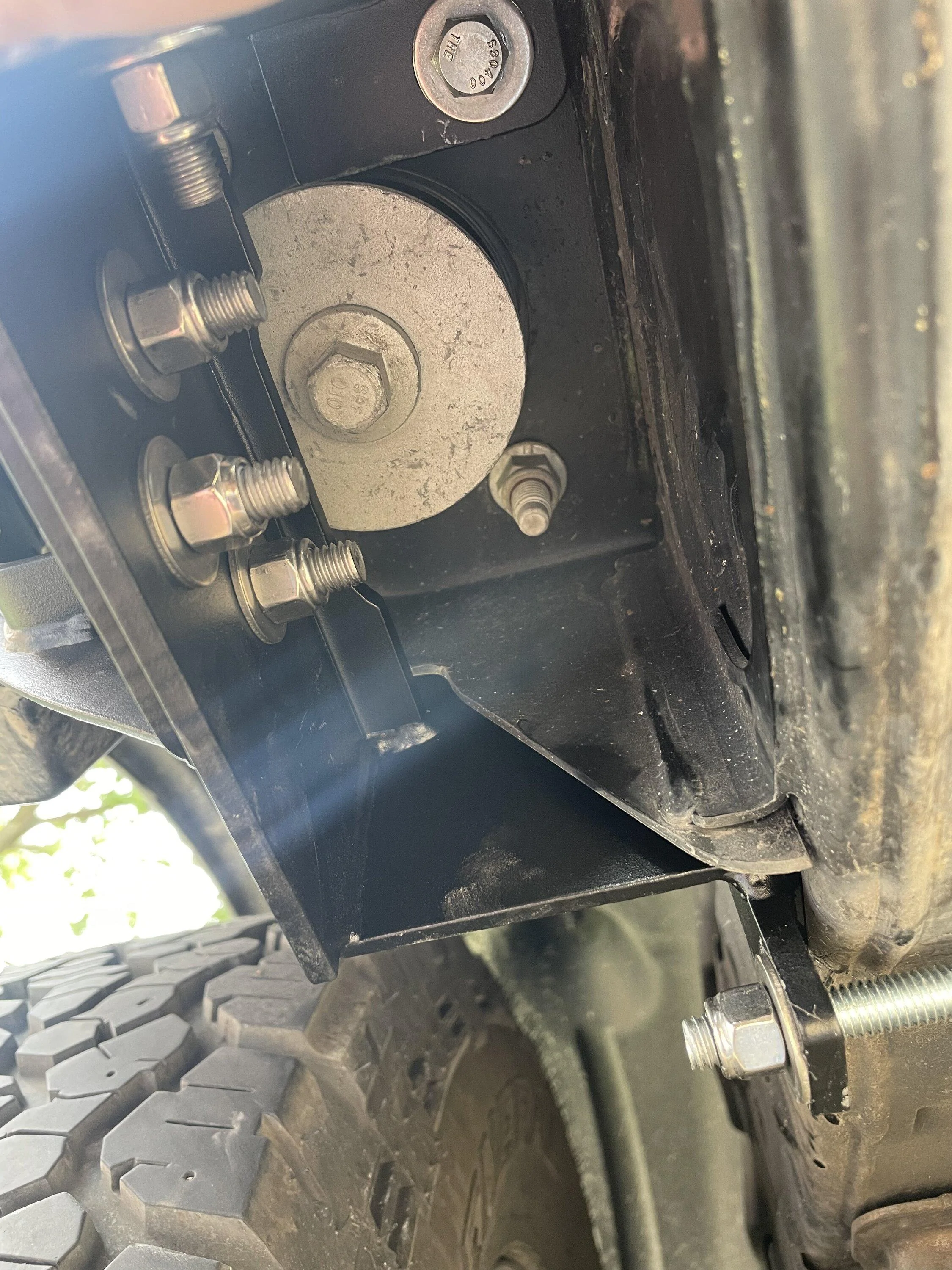

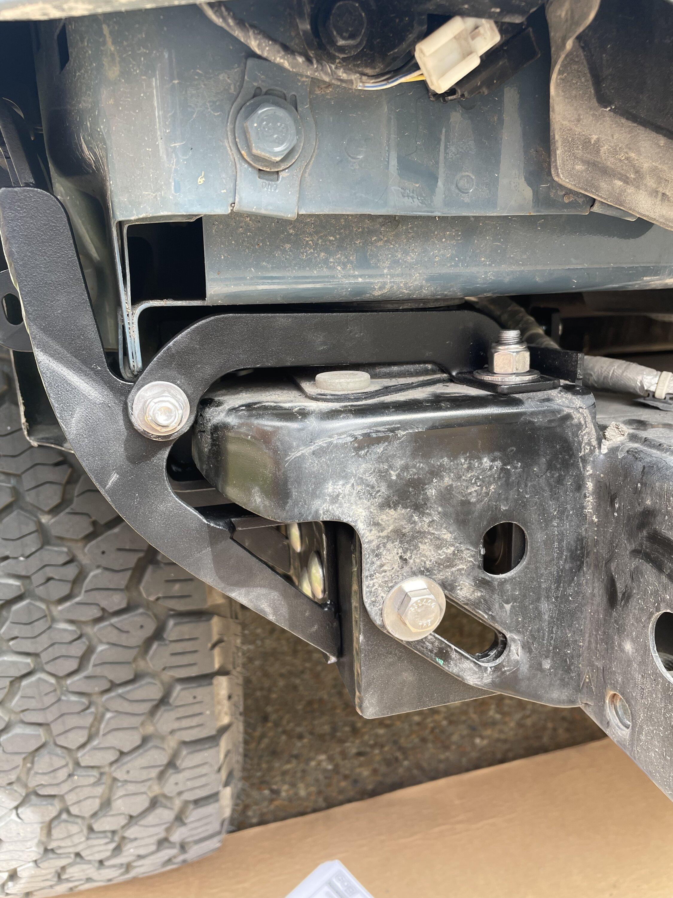

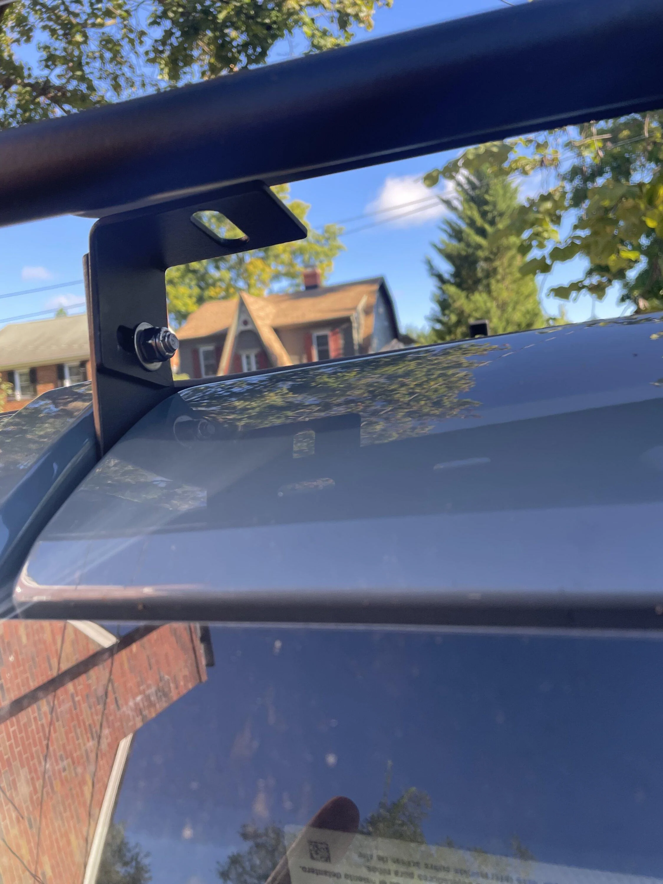

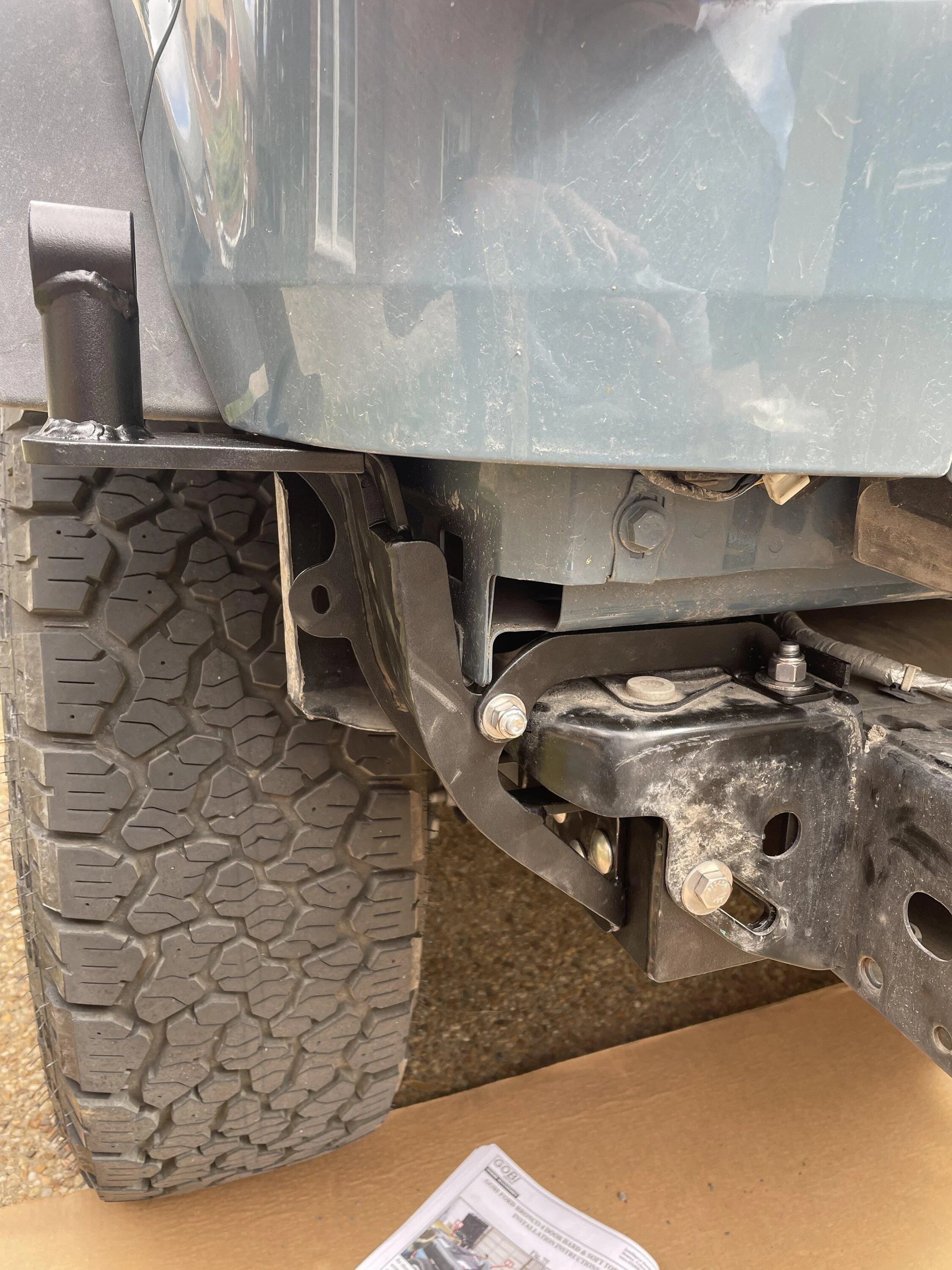

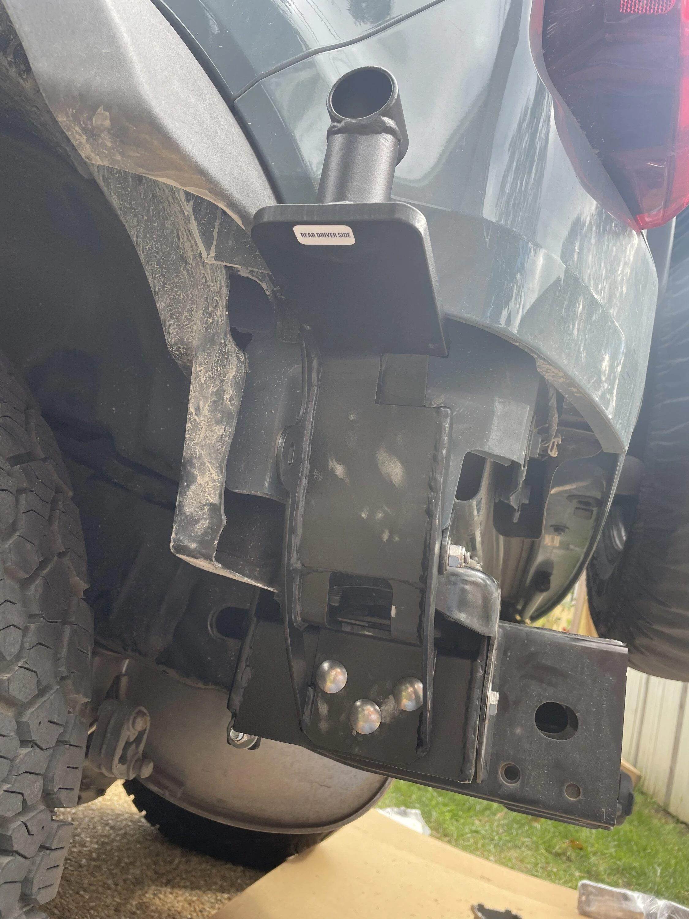

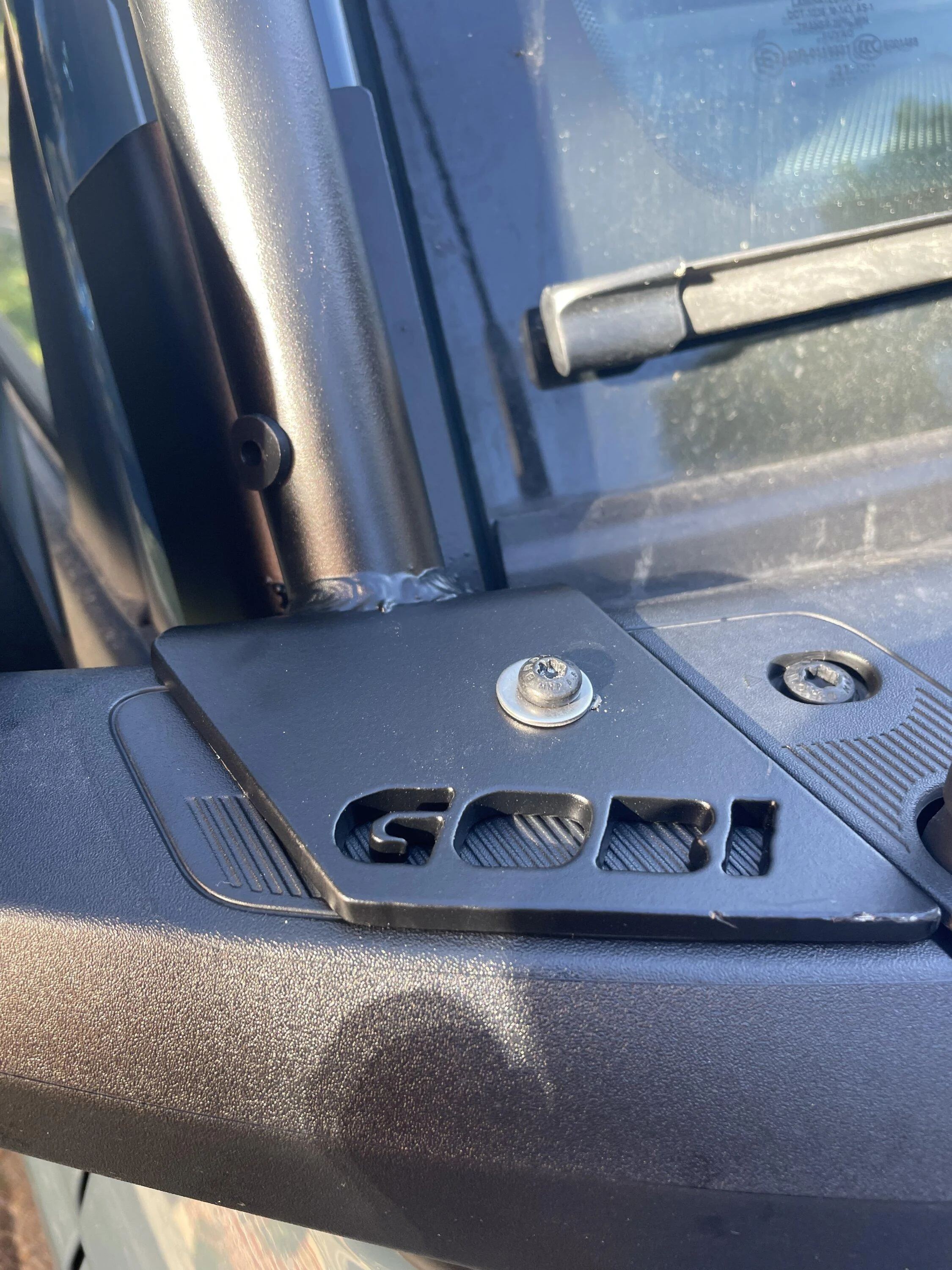

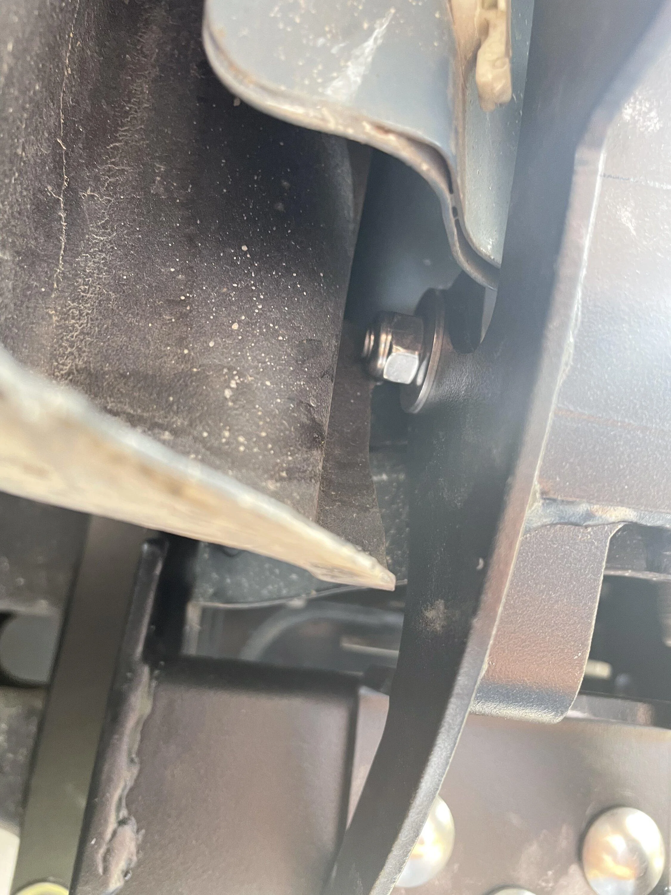

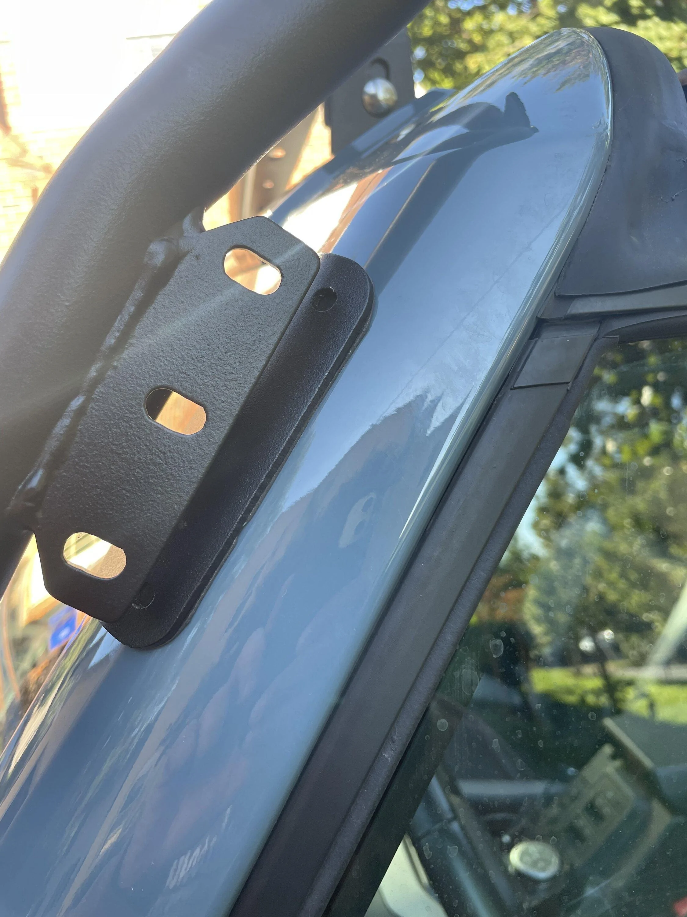

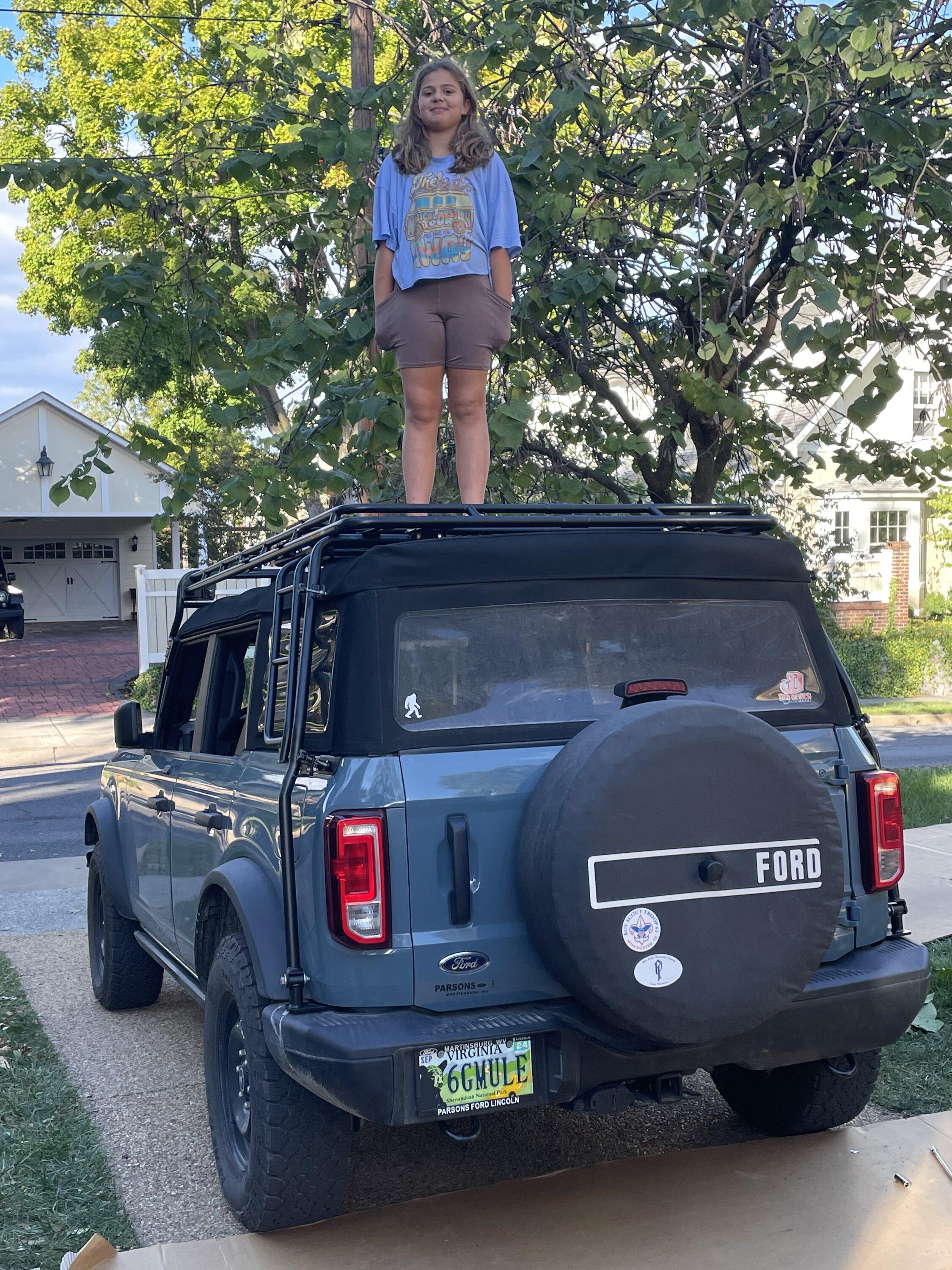

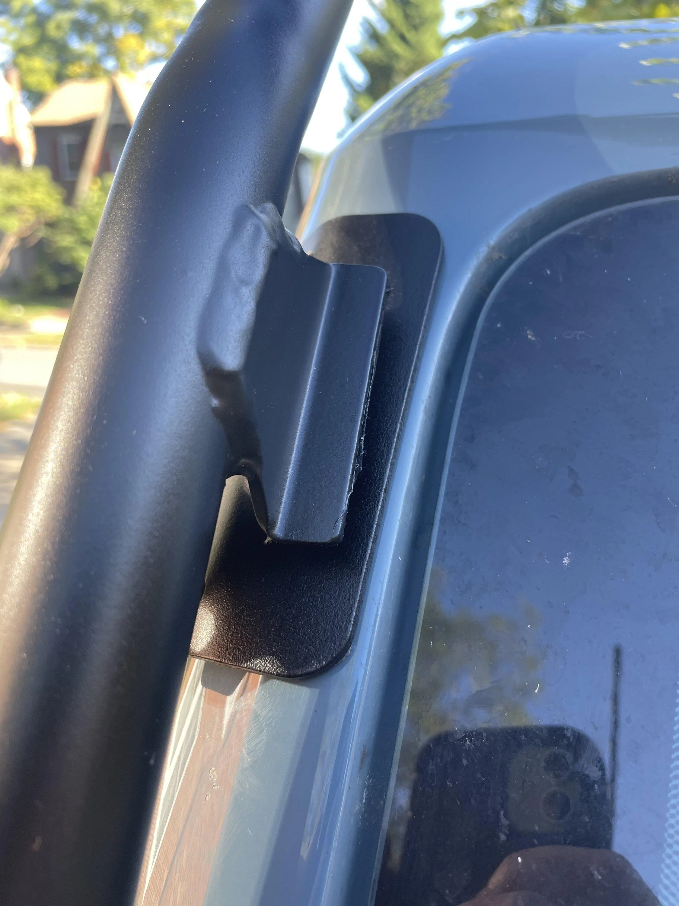

Just installed mine. Mpg dropped to 18.5. Wind noice is more and the stock black diamond suspension will take a beating from the weight. Going to go with the OME heavy spring setup to handle the weight.

The million dollar question for me would be "What do you need to to to open or remove the top?" My assumption is the at minimum the upper platform would need to be removed or if possible (depending on design) swung out of the way.

The front mount has quick connect clips on it. The whole rack then tilts backwards to fold the soft top down.

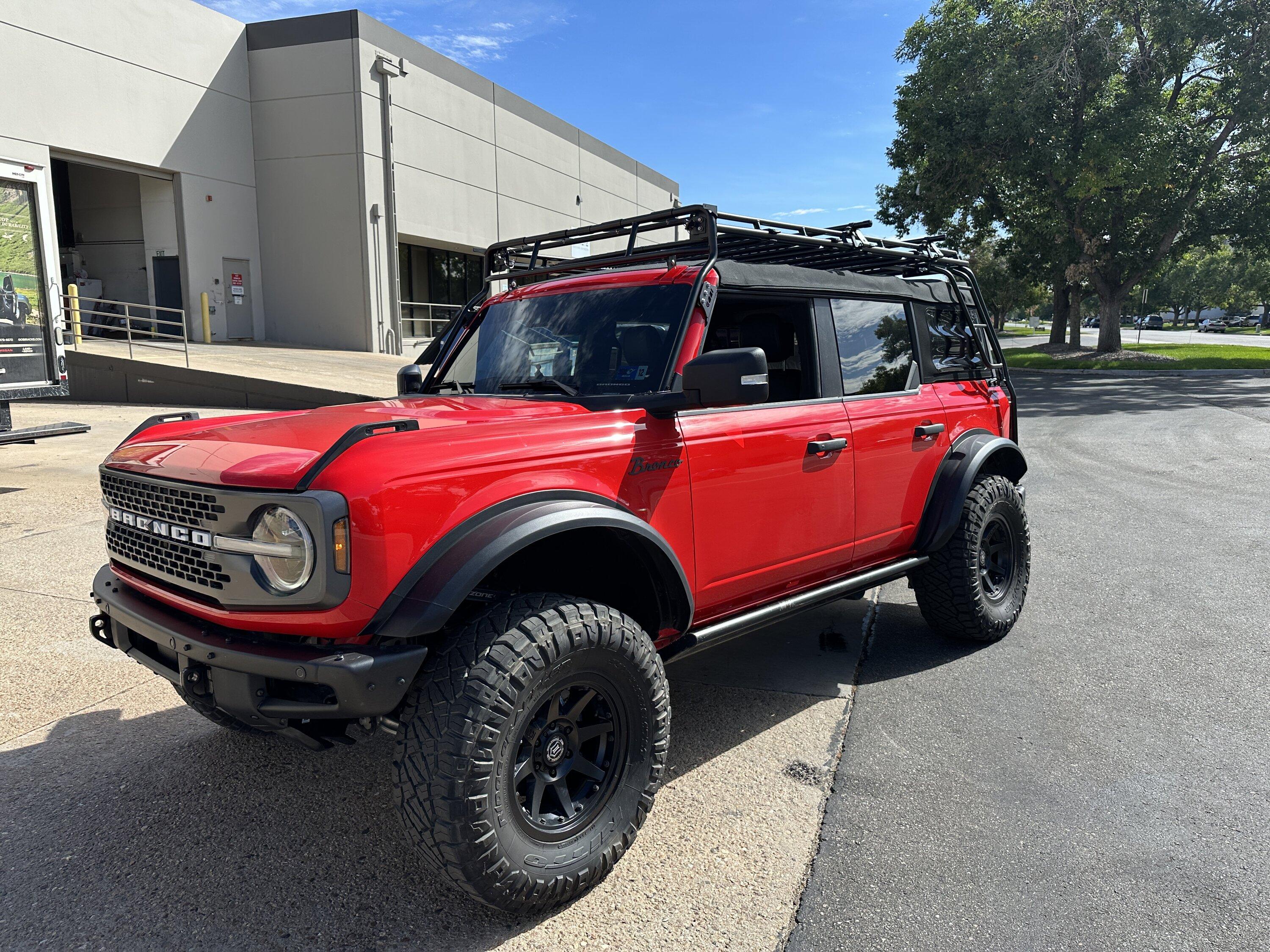

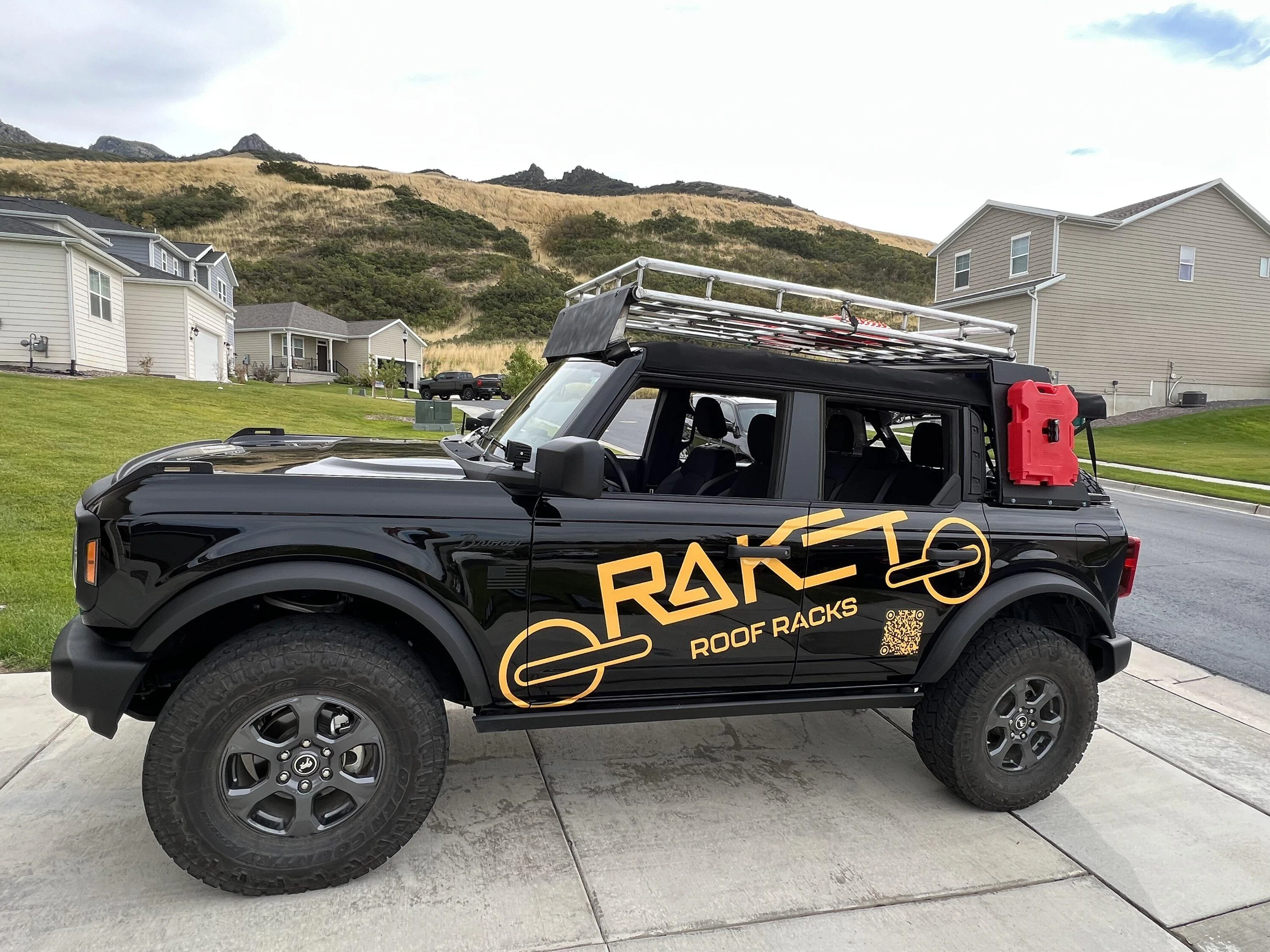

These are in development and will be featured on a SEMA ‘22 build. The next prototype will be lower by 3+ inches (including cowl) and rear tower. The system is built with aluminum so you have a light, removable, modular rack system. This is usable with soft/hard/no top. Learn more at www.raketdesigns.com.
