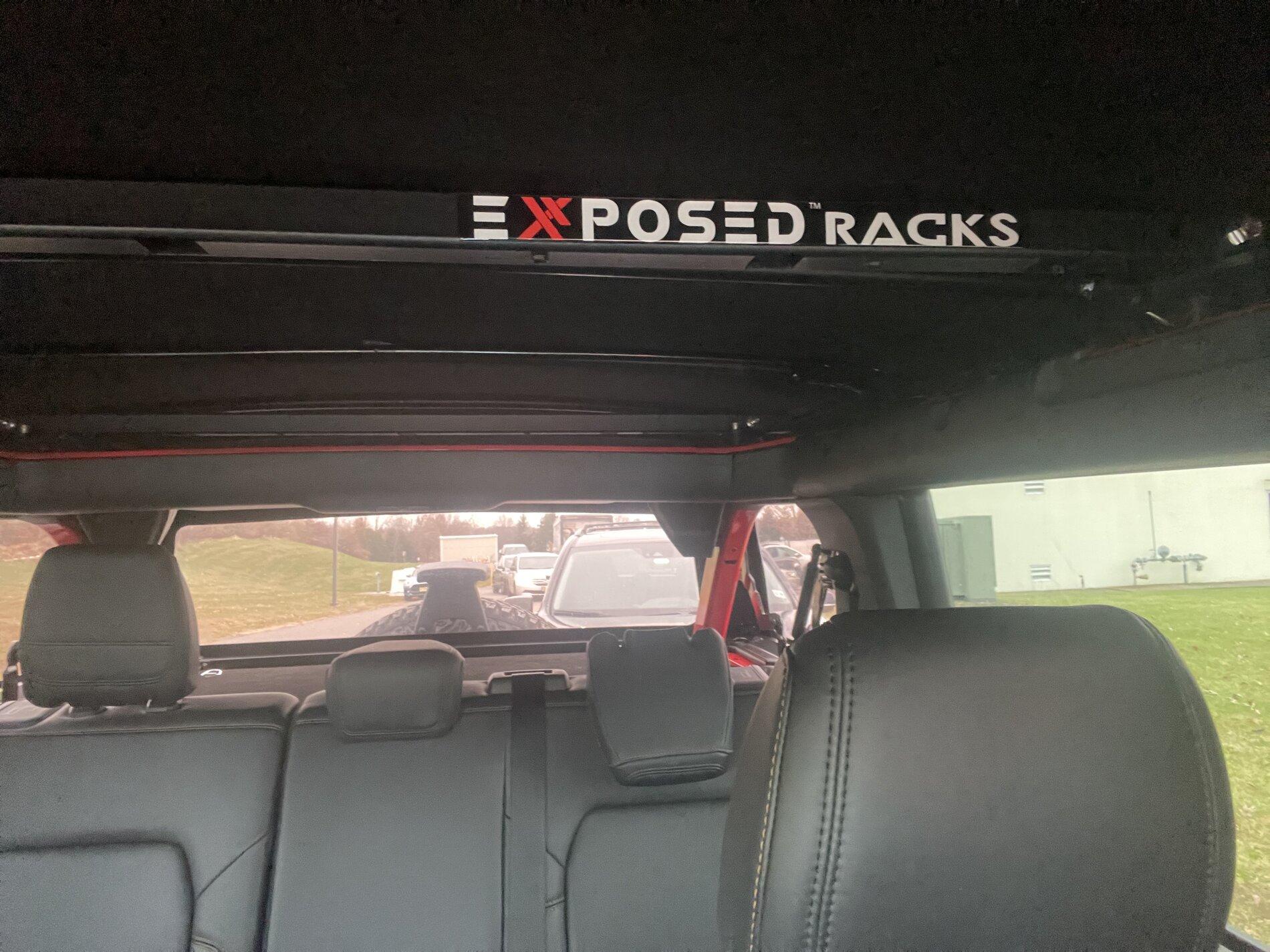

perfect, so if the exposed rack supports a tent, then the problem to solve would be what to put underneath to protect the interior -- could it be as simple as a tarp or raincover idk
Still sounds like it might be a hassle to install, remove, and still use soft top
Here ya go!
Ford Bronco Roof Rack for Soft Top?? 27457F56-4C9B-4F5F-9418-760E5B59D8D4

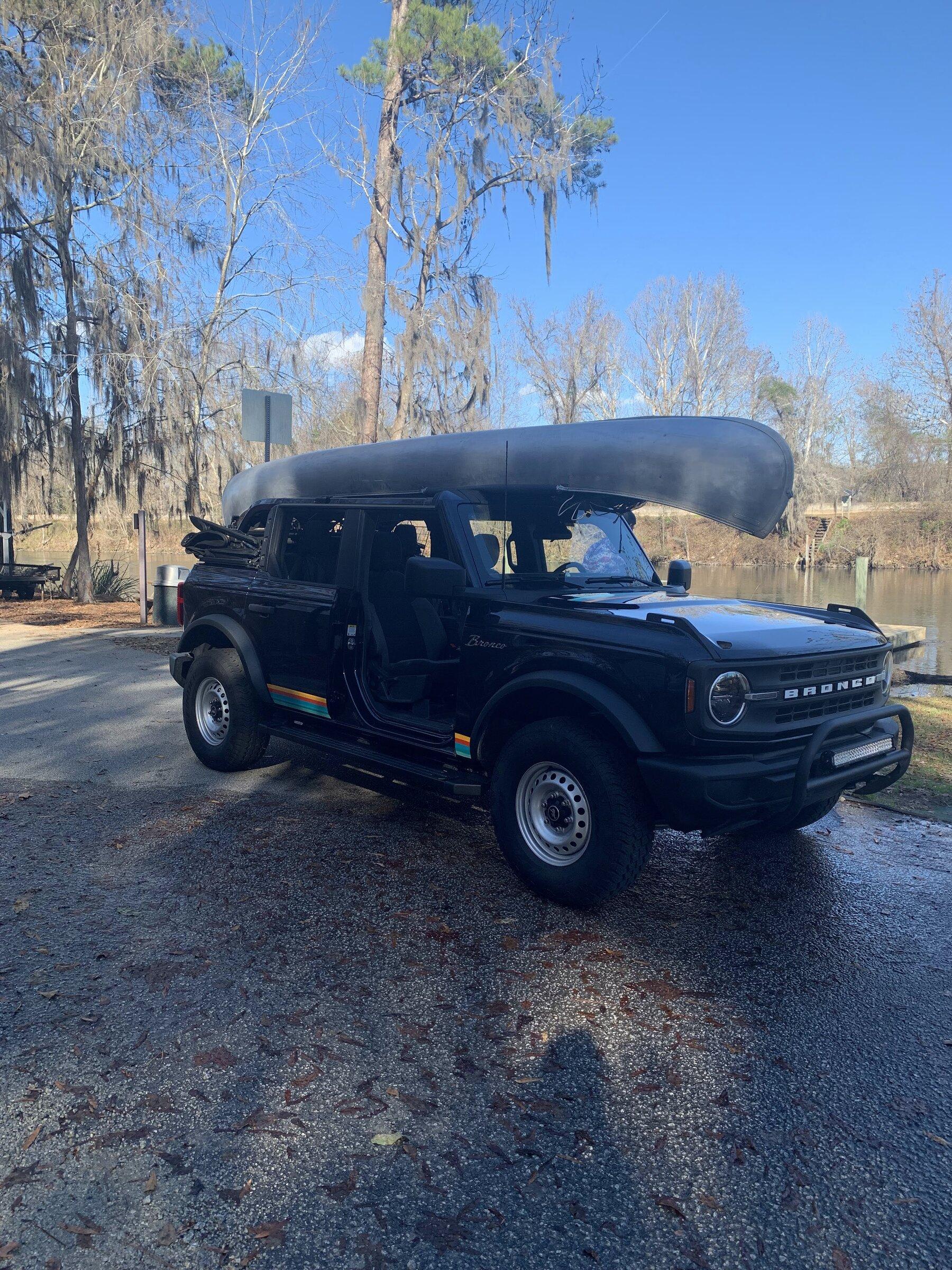

The 4wp concept had a bracket for a soft top roof rack, but that hasn't happened. Anybody know of anything that's available yet?
Seems like a good opportunity since 90% of broncos will have soft tops for the next year or so.
I know it's not for everyone, but I carried my canoe with the top down this past weekend and it worked great. Use noodles, or in this case pipe insulation to pad the gunnel on the A pillar. I covered the B pillar, that says "Bronco", with felt RV stair covers from Walmart ($20). They were perfect size. Front strap secured to brush bar or trail guides, rear strap to tow loop, mid strap on B pillar.
Ford Bronco Roof Rack for Soft Top?? IMG_0951
