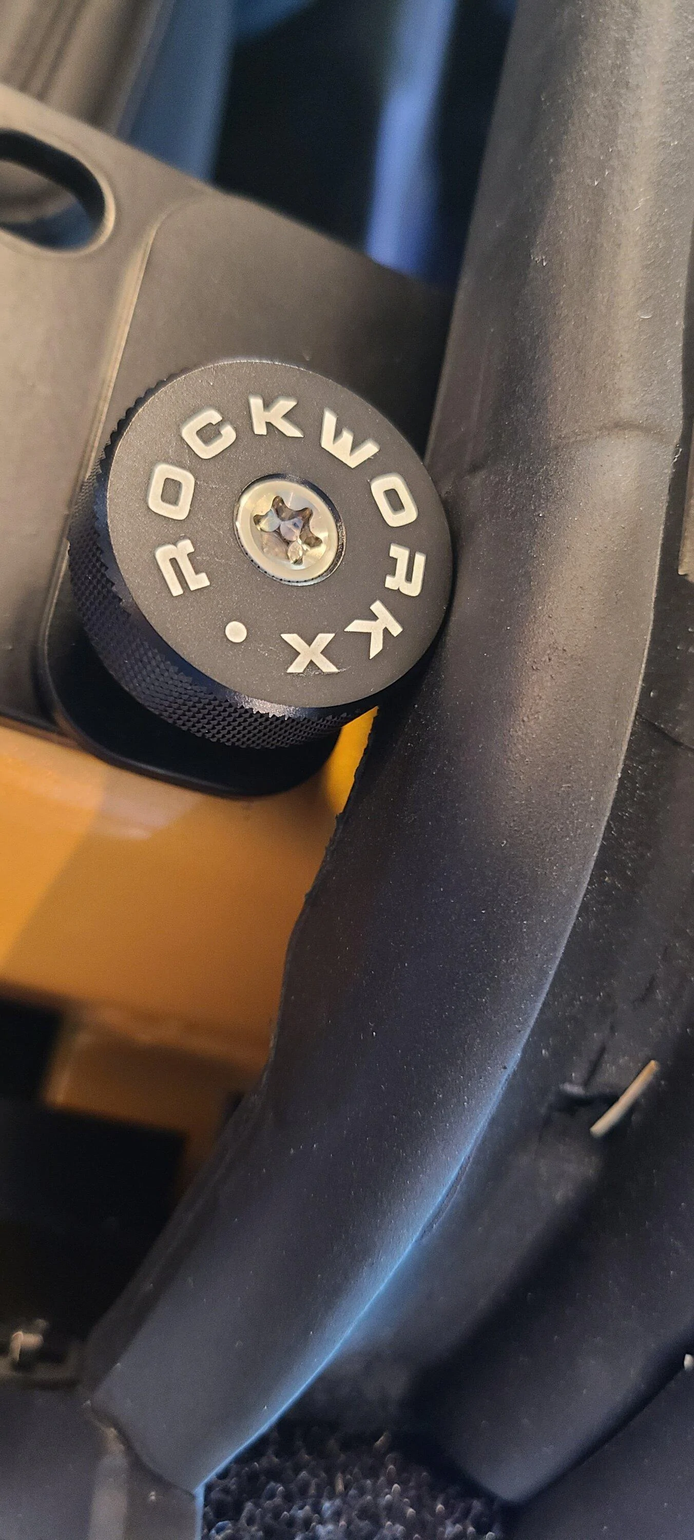

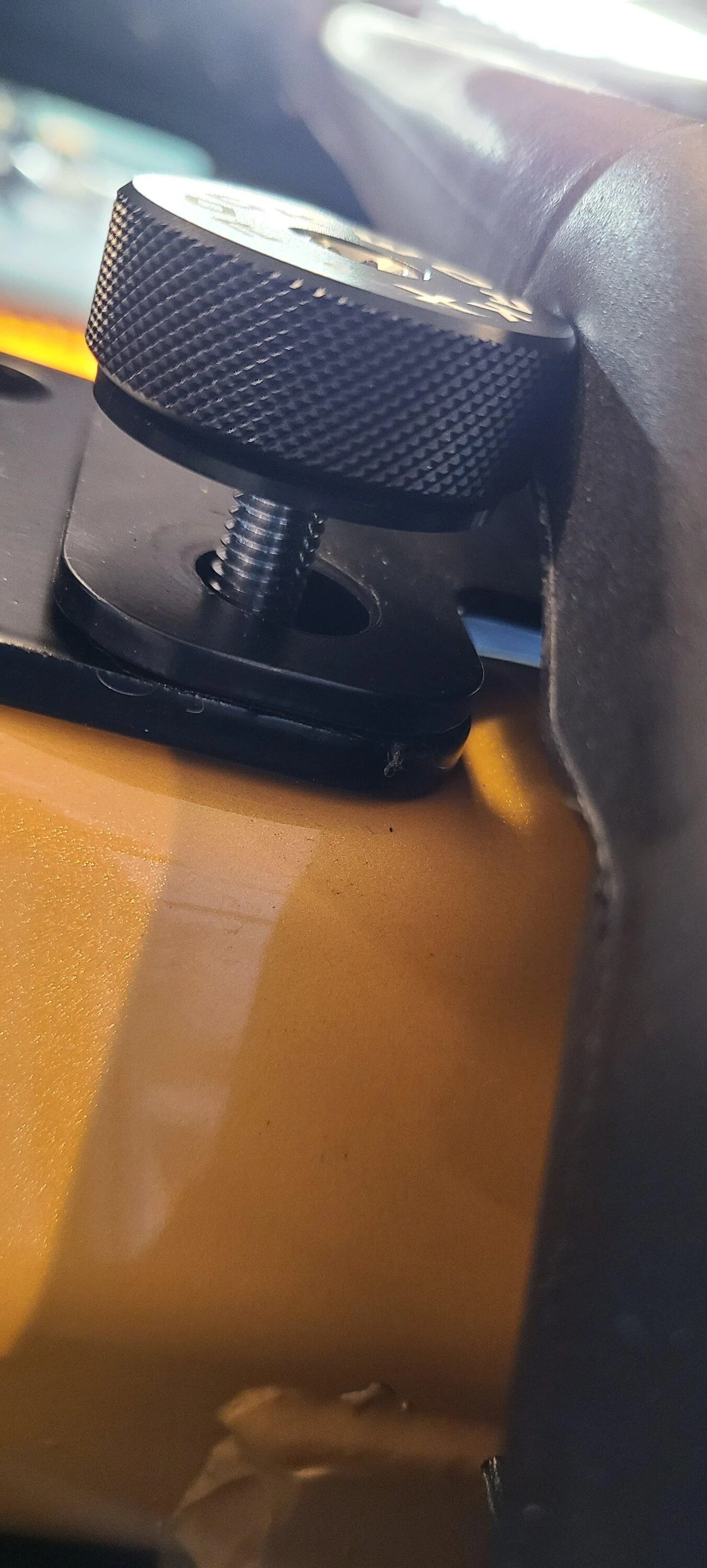

I recently received my hard top thumb screws. However, tonight upon installation I ran into a couple of issues.
I have a 2022 2 Dr Wildtrak, V2 MIC Hardtop.
1. A riding condition common to the clamshell bulb seal and Thumbscrew. Ref pics below.
2. Unable to tighten thumbscrew all the way. (They are quite a bit longer than the OEM Bolts). The OEM bolts thread in easily and completely. The second pic is of the Thumbscrew tightened as far as it will go.
Pics attached.

Hi Cat, Thanks for your message! We have been made aware of the interference issue on the 2 door broncos and are working on a fix. We will make a smaller Diameter "dial" portion for the aluminum. We have been sending out emails and will need to replace the torx bolts for everyone with a 2-door Bronco!

Glad you like them! If you have a 2-door, we will need to replace the Torx bolts. The "dial" interfere with the weather strip and we have a fix coming!

If you have a 2-door, we will need to replace the Torx bolts. The "dial" interferes with the weather strip, we have a fix coming!
