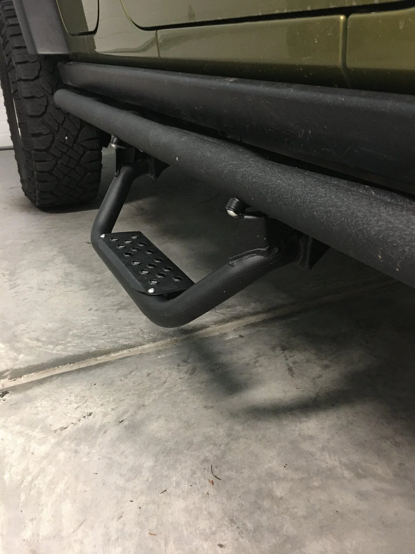

I’m curious... what’s wrong with the rails on Badlands?
1) not frame mounted. When frame mounted (or bolted to the body mountthey can support more weight as you’re sliding over rocks, etc.
2) they don’t have tubes out to the side to provide stand-off protection.
The Rubicon guys drop the rock rails for sliders / side armor if they are planning on using a Rubicon for what it is made to do. (I left the rock rails on mine to cover the pinch seam but you can see how the rail provides stand-off protection getting around trees and rocks. Also, the bolt on step is removable for off-roading.)

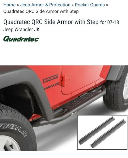

Examples:
Ford Bronco Rock Rails on WildTrak E2570B27-D5DC-46EC-9C2C-7B292FABBD4E
Ford Bronco Rock Rails on WildTrak 551A62DA-E917-46FF-AB86-A68F5FF2B7E1

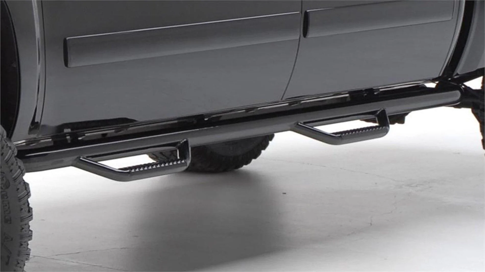

Ford Bronco Rock Rails on WildTrak Step rail

I guess these types of sliders provide more protection from the sides (you slide sideways into a rock) but the stock rock rails will be plenty good in most situations where the issue is clearance underneath.
If you’re really concerned about body damage, just remove the doors and fenders.
I suspect those 2nd ones with steps would be more of a liability for getting hung up.
Frame vs body mounting seems like focusing on the wrong thing... regardless of how the stock rails are mounted, the fact they can support the full weight of the vehicle is what matters.

I prefer a lower profile route. Seen some nice powder coated ones on an F-150 but can't for the life of me find them again.

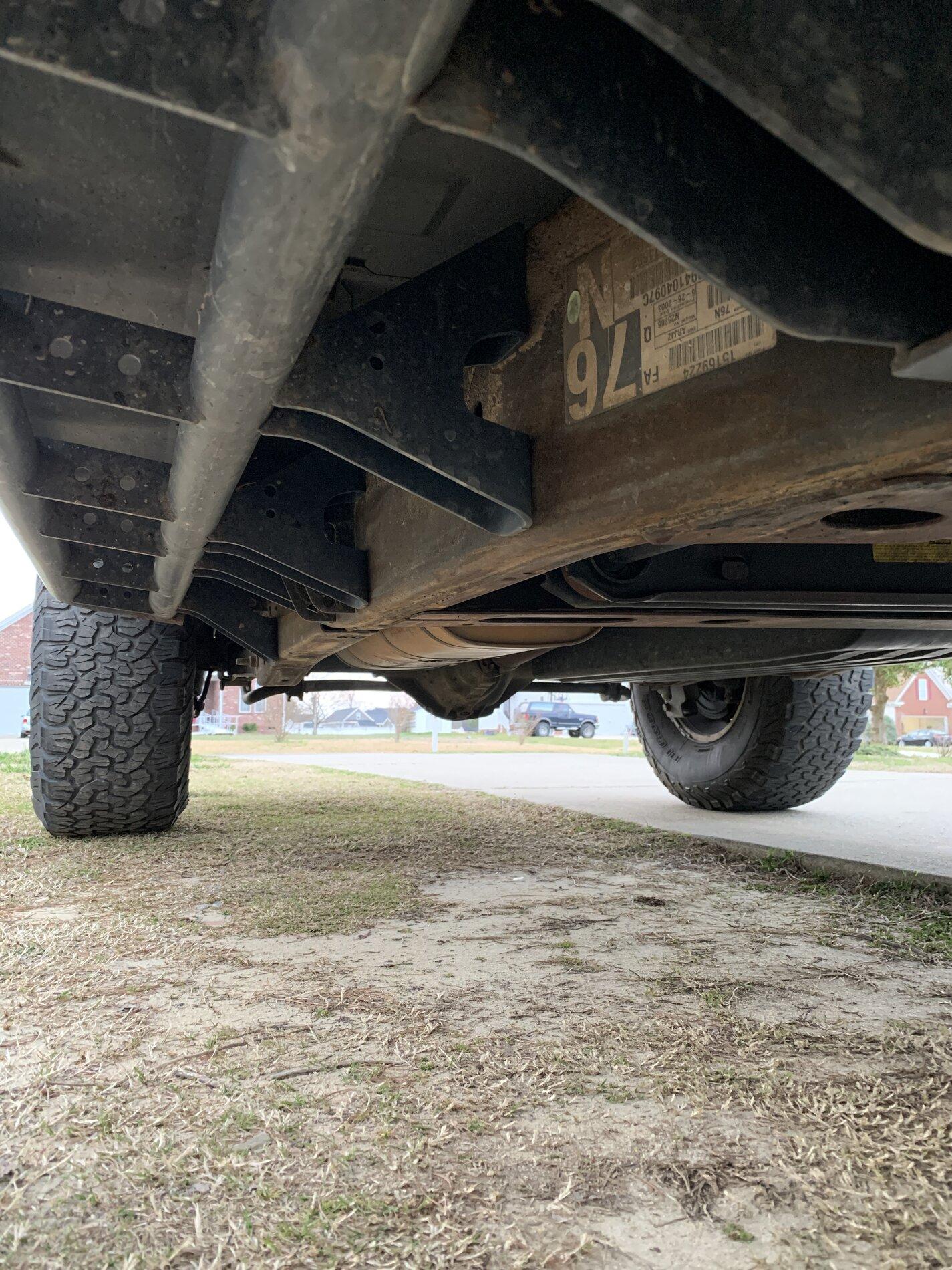

I've had both and I will take properly made BODY mounted rails over frame mounted rails All Day, Every Day. This is what I ran on my last jeep.
They extend under the rocker panel area and they sandwich between the body and the frame mount. Most brands have 5 to 6 points that bolt through the side of the body to a metal panel on the inside of the vehicle.
While these are not the exact brand/model of what I had, this is a really good view of a similar product before installation
Ford Bronco Rock Rails on WildTrak 1615677762724
https://shop.poisonspyder.com/LJ-Ricochet-Rockers-p/15-50-050.htm
When you are rock crawling, every inch of clearance, at every point of the vehicle is important. Eliminating things that can catch on a rock, or worse get caught under the vehicle, and cause you to get hung up, are things to avoid. In this picture,
The rails have reduced the clearance of the vehicle by somewhere between 2-4". On top of that, there are 3 significantly large pockets [if not more that I can't see in this picture] that can result in the top of a rock getting wedged in there.
At that point, the vehicle is 100% stuck and would need a Hi-Lift Style Jack to lift up that side of the vehicle and then winch or try to drive out while on the jack.
Been there, and done that to help out a fellow crawler who was jammed up.
It's much better to have an absolutely flat and smooth surface that can not get caught and slide over all rocks. The smaller your tires and the lower your body is, the more important this becomes.
