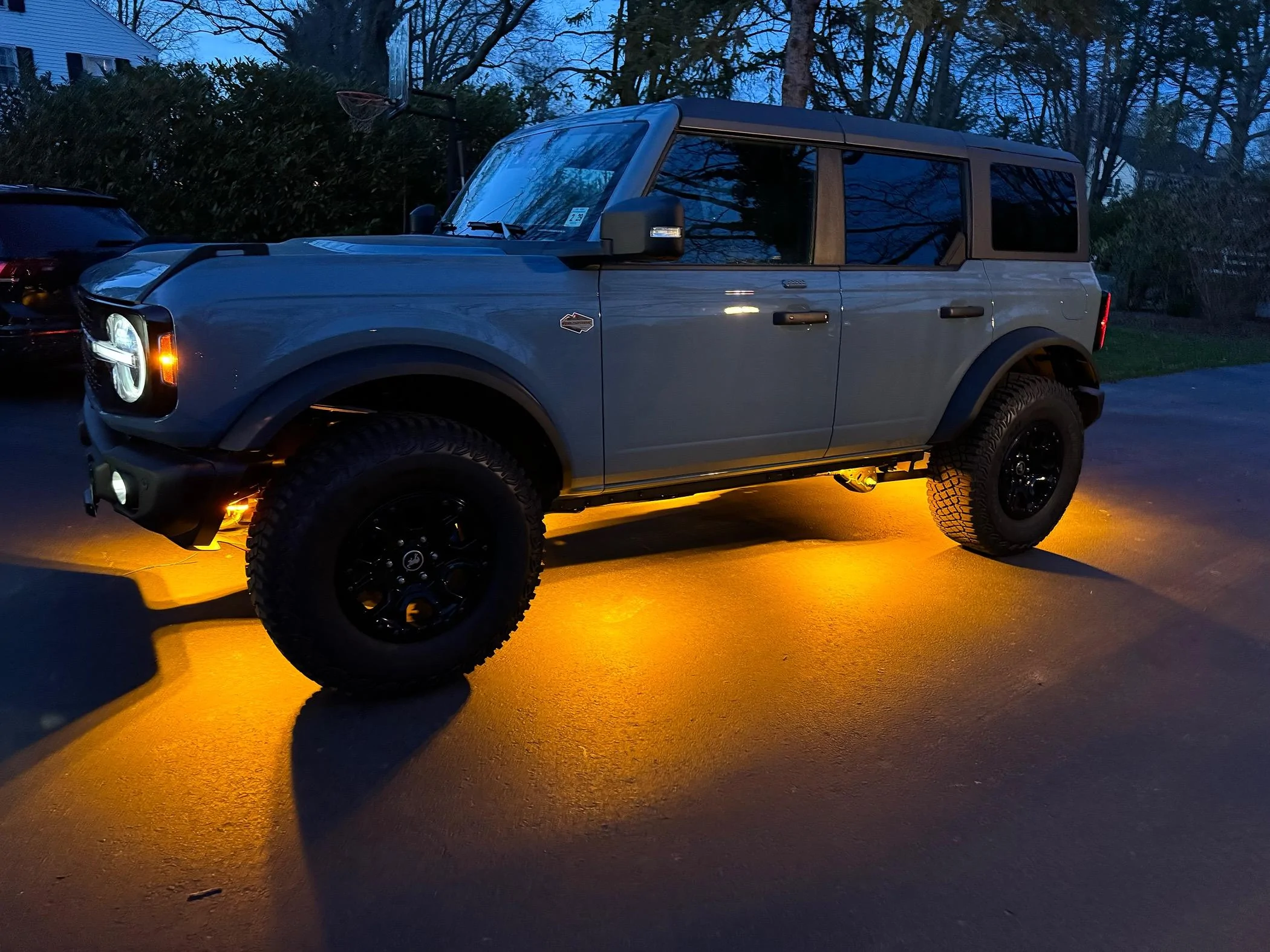

I installed the Diode Dynamics rock lights in my Wildtrak and love them. Install and wiring were straightforward. I used a combo of magnetic mounts and brackets that I made from Home Depot parts. I can send pics of the mounting when I get home from work.
Ford Bronco Rock light mounting location IMG_4058
I shifted the lights around after this pic to get full coverage and no shadows.

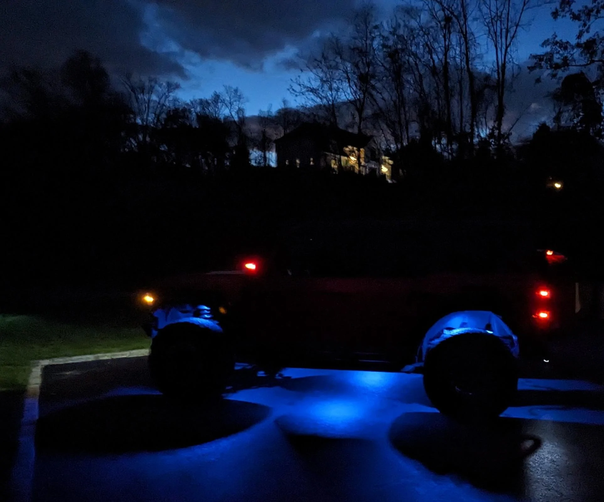

I used KC HiLites Cyclone rock light kit - definitely felt like the mounting options were pretty limited, but found some nice little bump outs (ins really) in the fender liners. 6 light kit (thought I'd need 8 but pretty bright with 6. I will also say that the mounting locations for the buss bar are pretty limited and as a result the wiring may be a reach for the farthest rear from the engine bay and you'll have to extend. I sent them feedback on it but not sure if they adapted. For the middle locations I used their magnetic mounting kit - works well. Clear white is SUPER bright - I switched to Blue (which is illegal in NY but eventually if needed - I'll go to diffused white instead (that apparently is legal)
https://photos.app.goo.gl/kFM34SBeXEBbHD1FA
Ford Bronco Rock light mounting location PXL_20231127_220934399-EDIT
