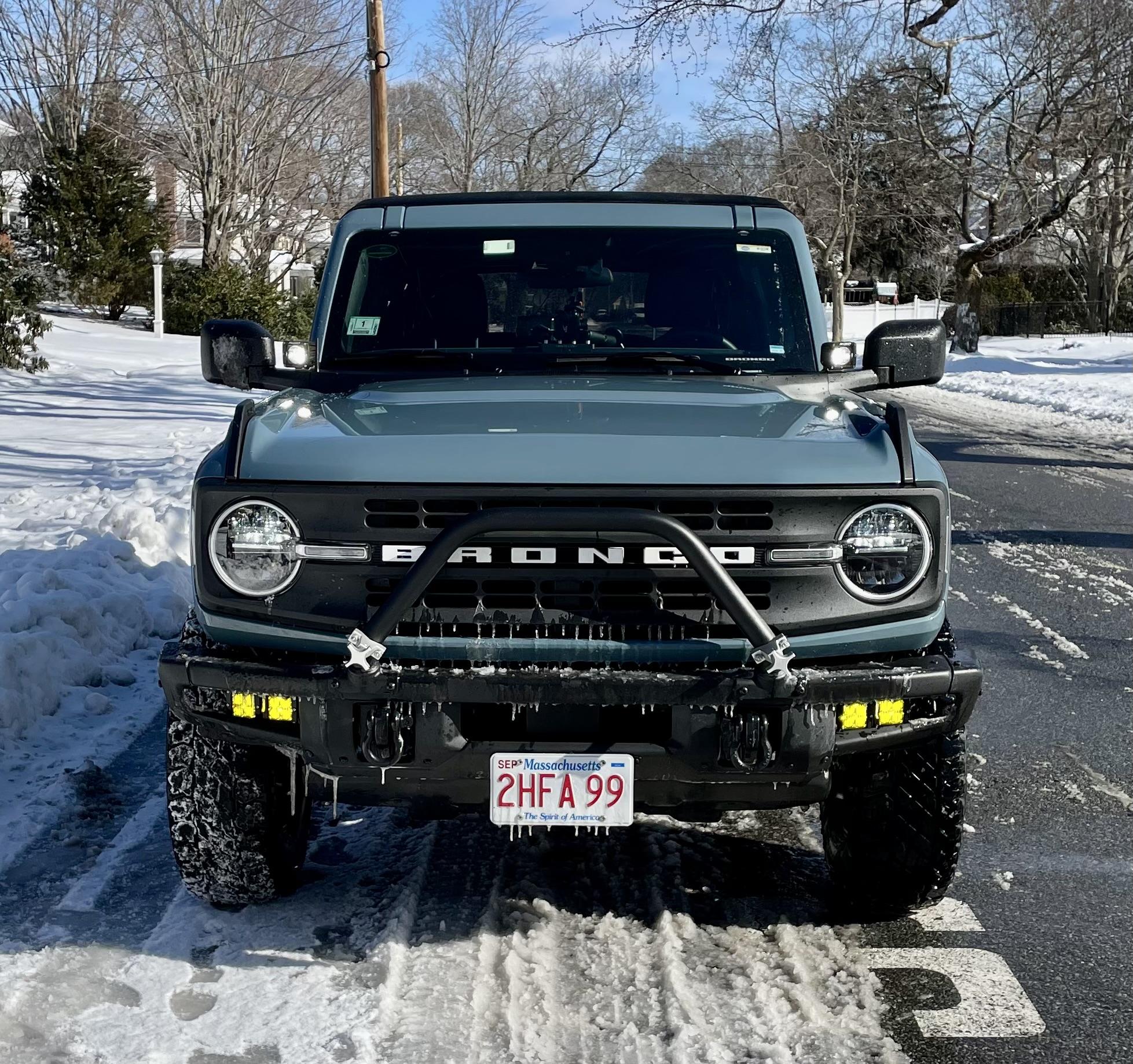

The end caps come right off without affecting the lights, which hang independently from a bracket attached to 3 bronco bolts on the underside of the pocket. i.e. the lights hang from the top part...
With that said, the lights would then be exposed to rocks etc., but you can remove the whole bracket as well by just removing the 3 bronco bolts and unplugging the lights. It takes longer to remove the end caps (6 bolts) than it does to remove the lights (3 bolts).

Yeah I worded that badly. I meant basically what you said, that the lights are exposed. That you can't take the cap off without the lights fully exposed. But it's good to know the bracket comes off so quickly and easily.
I'll most likely be mounting somewhere else still for various reasons. Mainly I don't completely like the look of square lights in that opening. Now that I've seen the setup a lot, I'm not digging it. I also don't feel like realigning the fog lights everytime I reattach.

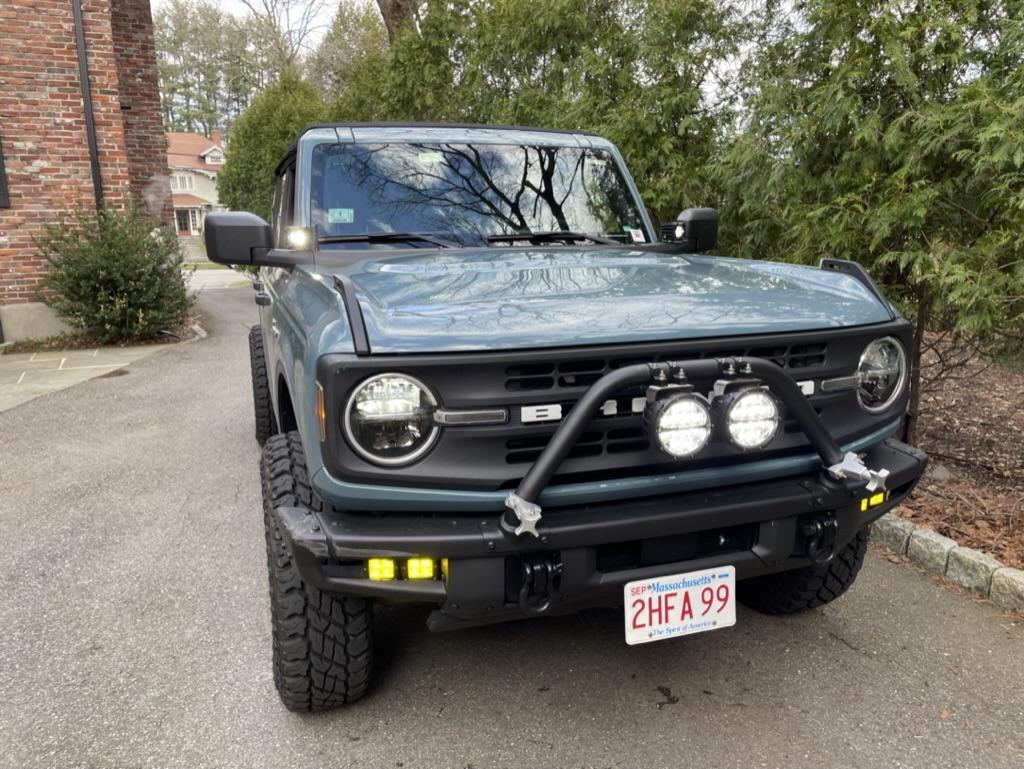

I mounted a pair of Rigid D-series SAE fog lights in each pocket using the KR Offroad bracket from 4x4truckLEDs. For ditch lights, I got the Rigid Radiance with amber backlight - certainly not as bright but fine for ditch lights. I'm contemplating either 4" or 6" Rigid 360-series hanging from the safari bar...
Replying to myself... here is a pic of my new Rigid 360 6" spot lights hanging from the safari bar.

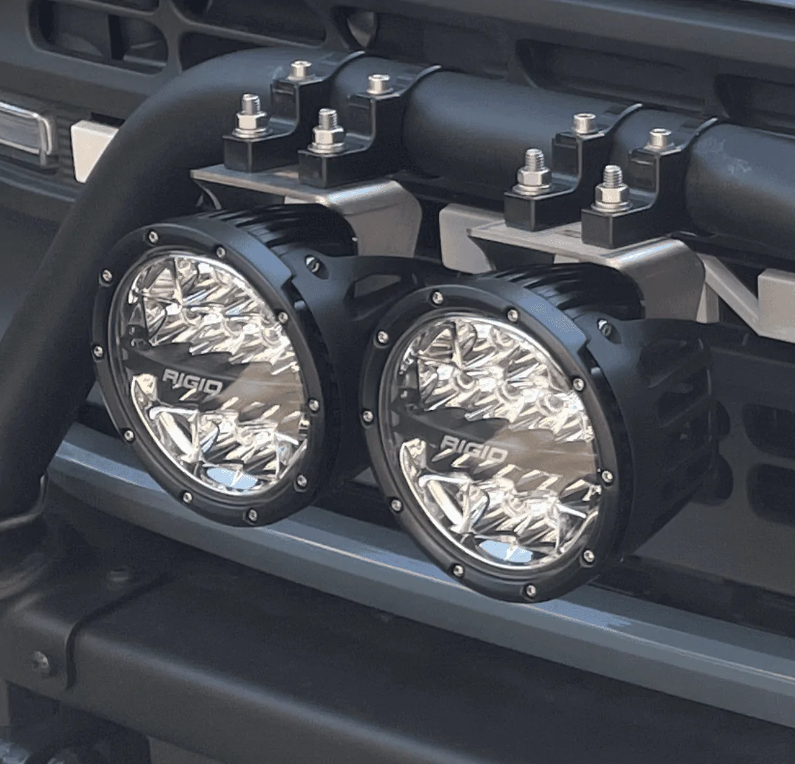

What did you use for a mount on your bull bar? Do you have a link?
https://axiaalloys.com/product/small-light-mount-for-4-and-smaller/
I used two of these (2" dia, black e-coat) on each 6" light. These work great since the Rigid bracket has three carriage bolt holes. Note also that the Rigid bracket can be mounted hanging from the top (as shown) without flipping the lights themselves upside down. The adjustment range is about +5 deg to -45 deg, and the housing is symmetrical on top / bottom.

Thanks for the info and close up pic, those are the same lights I am planning on using, been trying to find mounts.

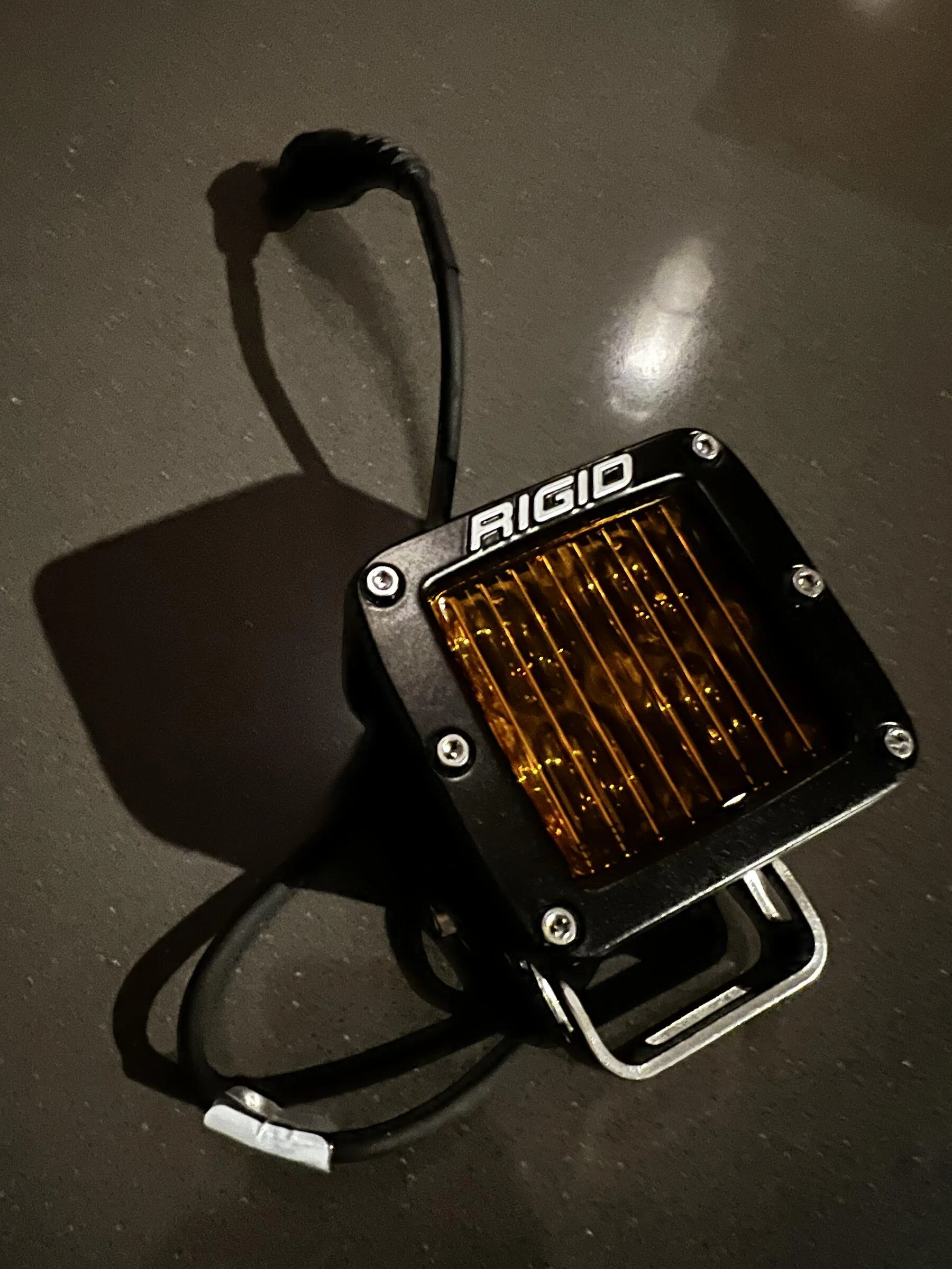

Since this is the official Rigid light post, does anyone know if flipping the faceplate so the logo doesn't display the logo upside down will void your warranty?
I picked up a couple of amber lights this evening and would prefer the right side up displayed.

With the Rigid D-series (3" square) the mount point is below center, so the bracket can only be mounted on the bottom. They do, however, offer a longer "extended" bracket that can be mounted hanging from above. Hence, the logo is right side up. I don't think you can flip the faceplate. With the Rigid 360 series (6" round), the bracket mounts symmetrically on either the top or the bottom, so the logo will be right side up.

Thank you, I shall do the international google search for thy brackets. once again, thank you sir!~
