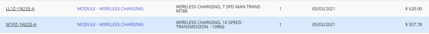

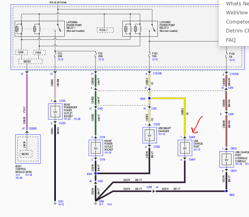

Yeouch on the price, but you could buy the Wireless Charging module and add it in.
So @flip, where does the upper dash Lux power port plug in? The one that is part of that center B&O speaker up by the windshield.

I know—I can do a lot of plugging and unplugging for $600!

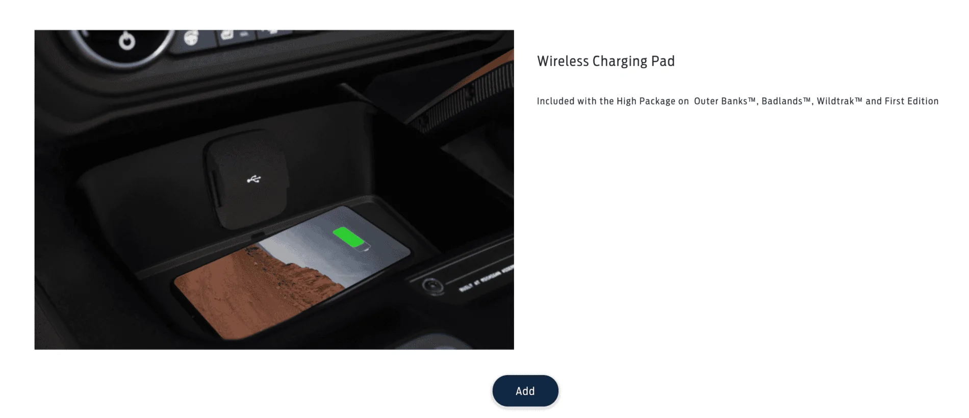

I like my vehicles looking oem looking inside with no cables showing. I wouldn’t think it would be that difficult. I retrofitted both my wife and I vehicles with oem wireless chargers after the fact. I think Im more looking forward to the wireless carplay than the wireless charging. Thats what stinks now is that a cable is still required for my sync 3 and her uconnect screen.

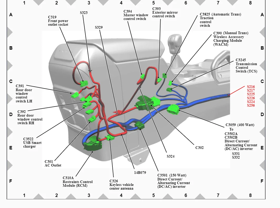

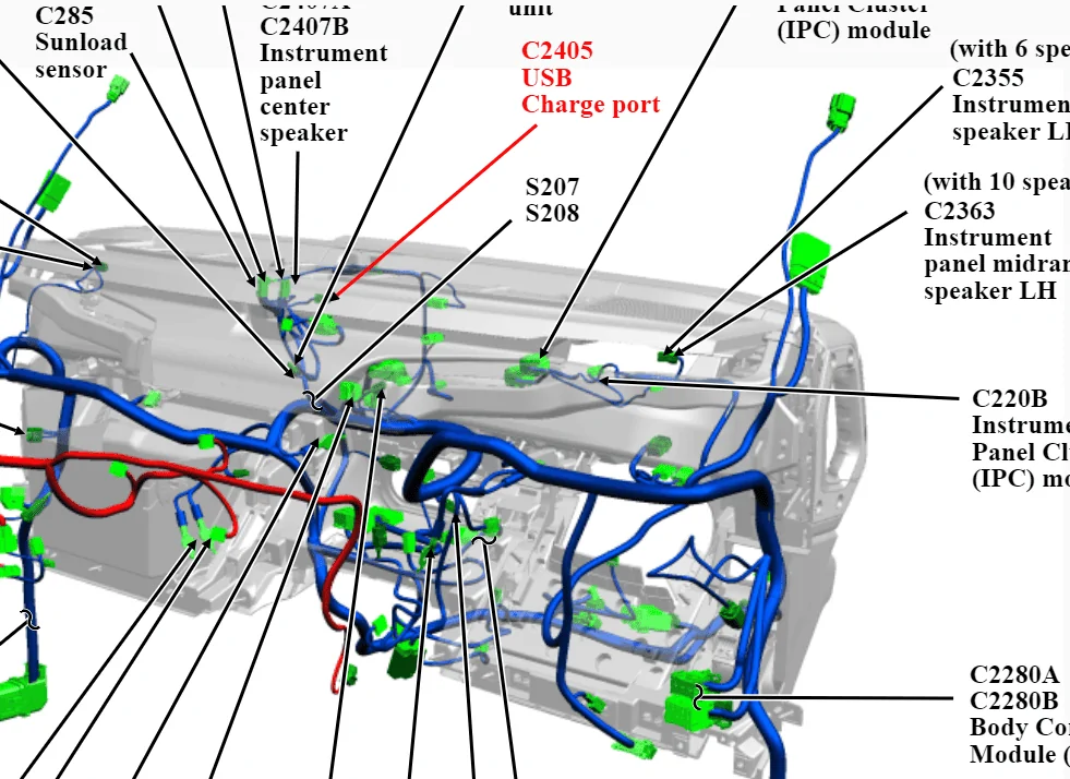

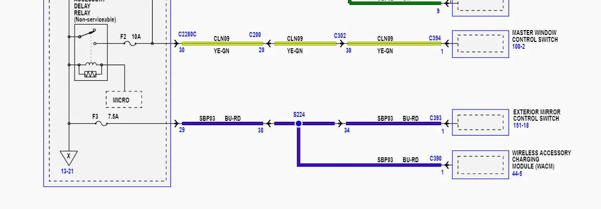

OK - so IF the same wiring harness is used and those connectors are there, theoretically you can buy the wireless charger and add it.
Depending on the connector part, we probably can drill the right diameter hole in the blank that fills the B&O center dashtop speaker location, and retrofit that too, if not it is certainly possible to add the Bluesea one.
I'll have to go fishing for connectors once I get my Bronco.
Also thinking about swapping the driver side visor out for a Homelink one....

The High does not have a wireless charger, it’s exclusive to the Lux package.
Also for those looking to do this, the spot where the wireless charger goes is premolded with the hole cut so on non Lux models there is just a plastic block off piece installed in place of the charging pad. At least that’s how it has been up until this point. If no longer that way it still wouldn’t be hard to install the oem pieces, just need to power it.
