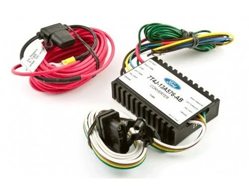

This is what you will need to add a four pin trailer connecter to a Bronco without the tow package.
The issue is the tail and brake lights are controlled with FET (Field Effect Transistors) and cannot handle any extra current draw.

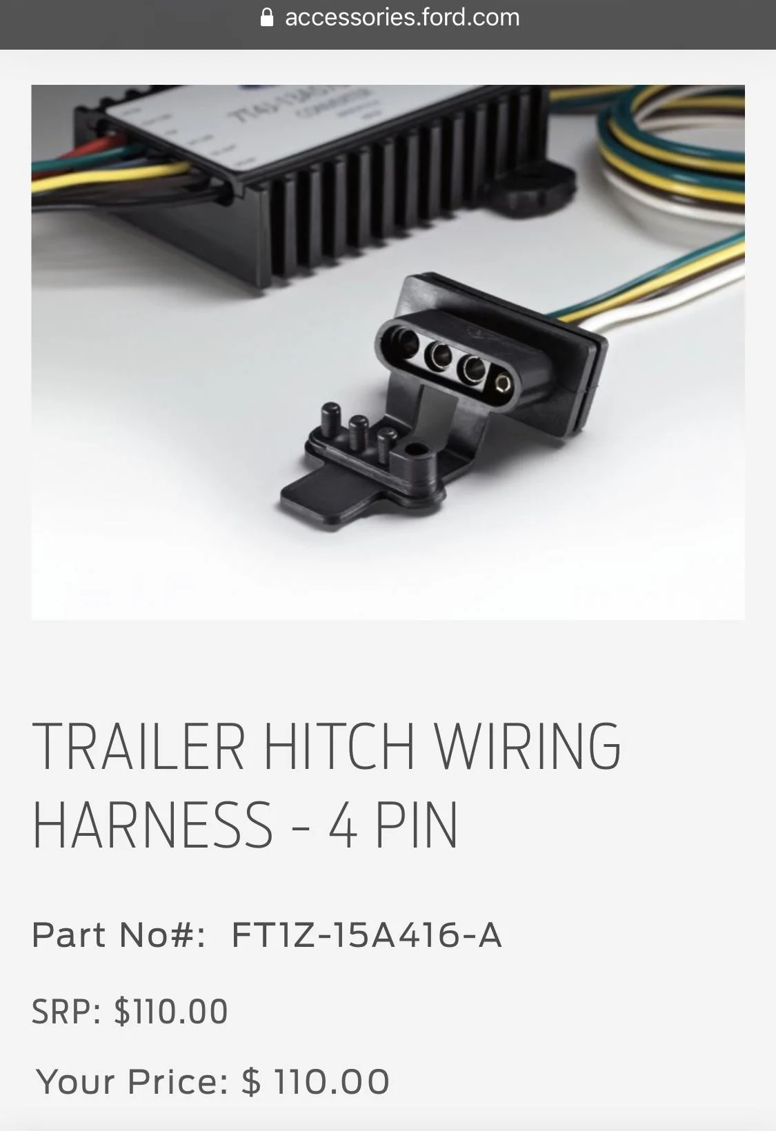

This is the currently listed part on ford site. Part# FT1Z-15A416-A
Cheapest online I saw was $90.
The Bronco style hitch in aftermarket for jeeps is about $70, hitch only. Gonna have to wait a little while for aftermarket or pay Ford $350 for hitch only, or $460 w/ wiring for parts only.
I only need 4-pin, but would be nice to get the combo connector to add for a cleaner look.
The wire harness looks to involve splicing wires. Would’ve prefered plug and play from a new Ford product.
Oh well, thats the only options right now for us Baseheads!

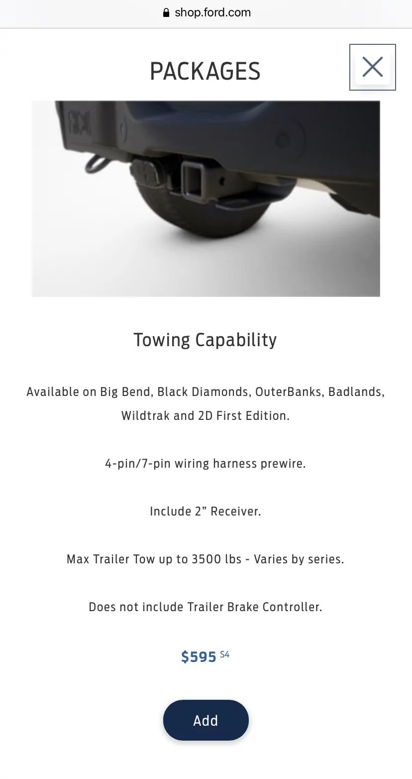

Together, this makes it seem like in order for the plug-and-play trailer brake controller accessory to be able to be installed, you need to have some sort of harness/interface in the bronco that only comes with the factory tow package. Additionally, if the emergency pre-collision braking system on the bronco is to interface with a trailer brake controller, that may also require additional capabilities only included with the factory tow package.
If you never ever intend to want a trailer brake controller, or you dont see a need for a 7-pin.. it would stand to reason that it would be cheaper to just get the 4-pin accessory after the fact and mate it up with a cheaper aftermarket receiver.
If you ever want to add a trailer brake controller, or you want the other additional functionality of the 7-pin, I would opt for it from the factory.
