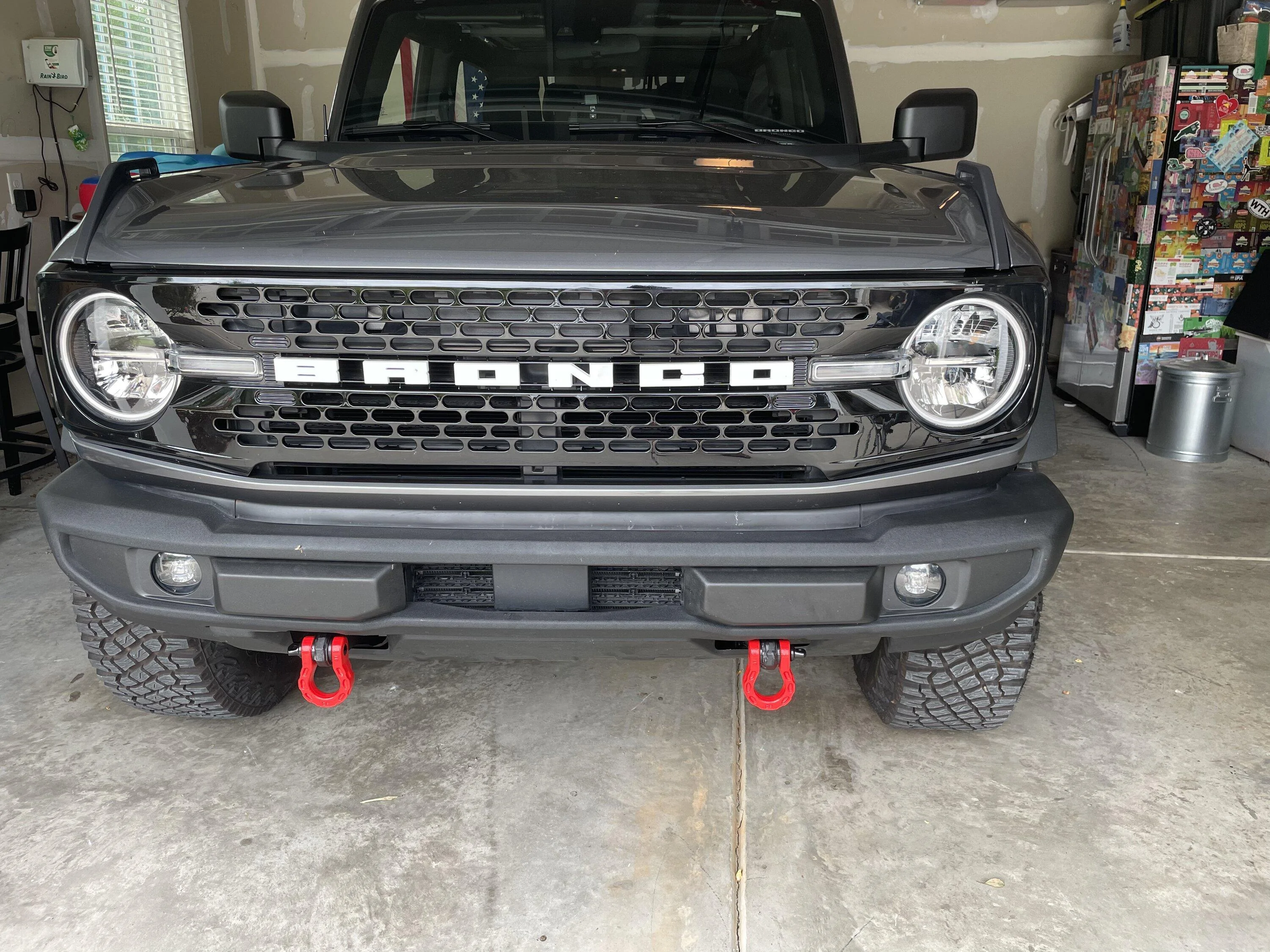

Quick question. I have a 22 Big Bend and just put R/C shackle mounts on. This required removing tow hooks. All that being said doesn’t the base/big bend share the same bumper? If so no cutting was required for mine.
