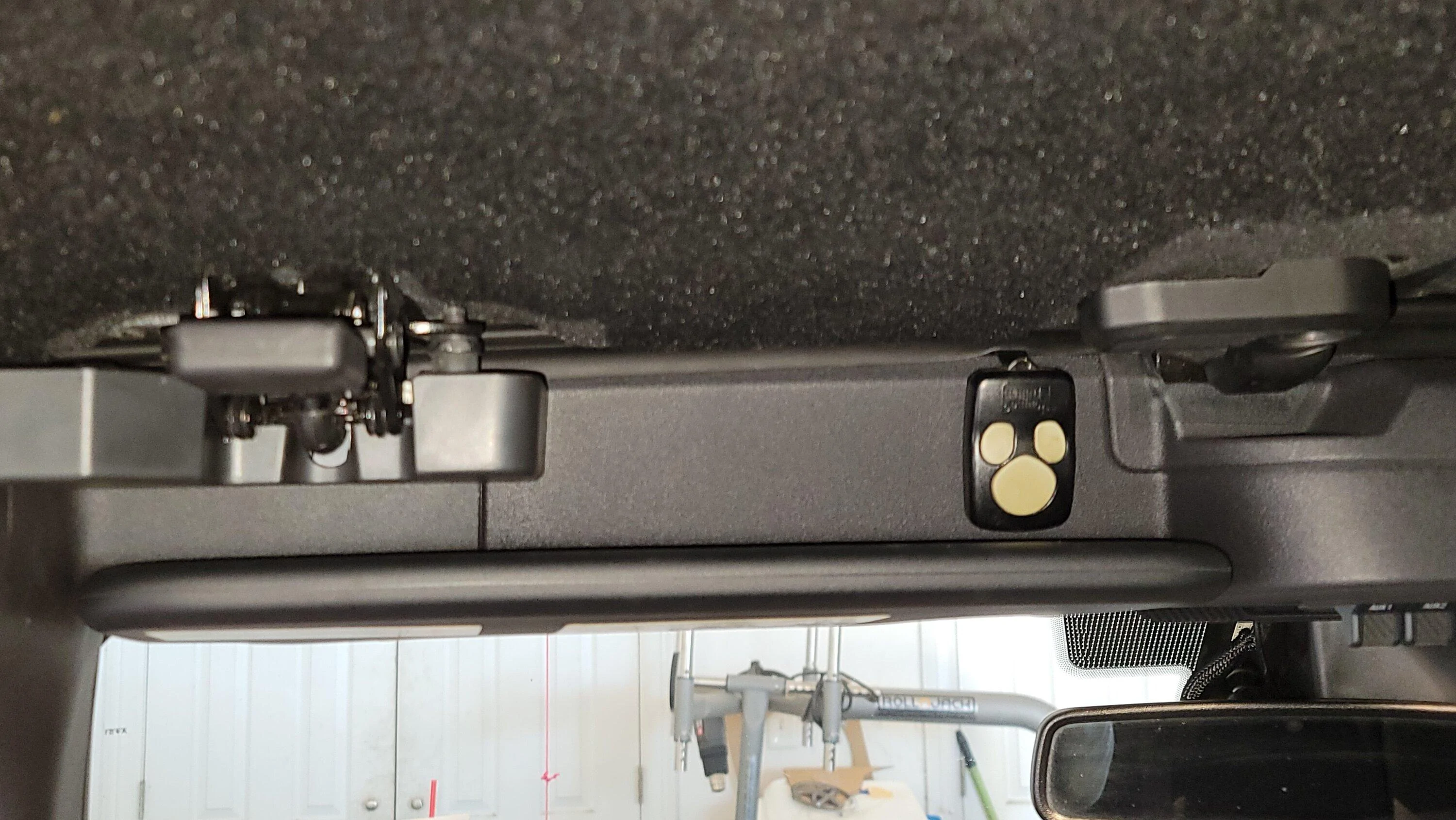

I just slipped my remote over the windshield trim and viola it's in basically the same place, out of site, and free.

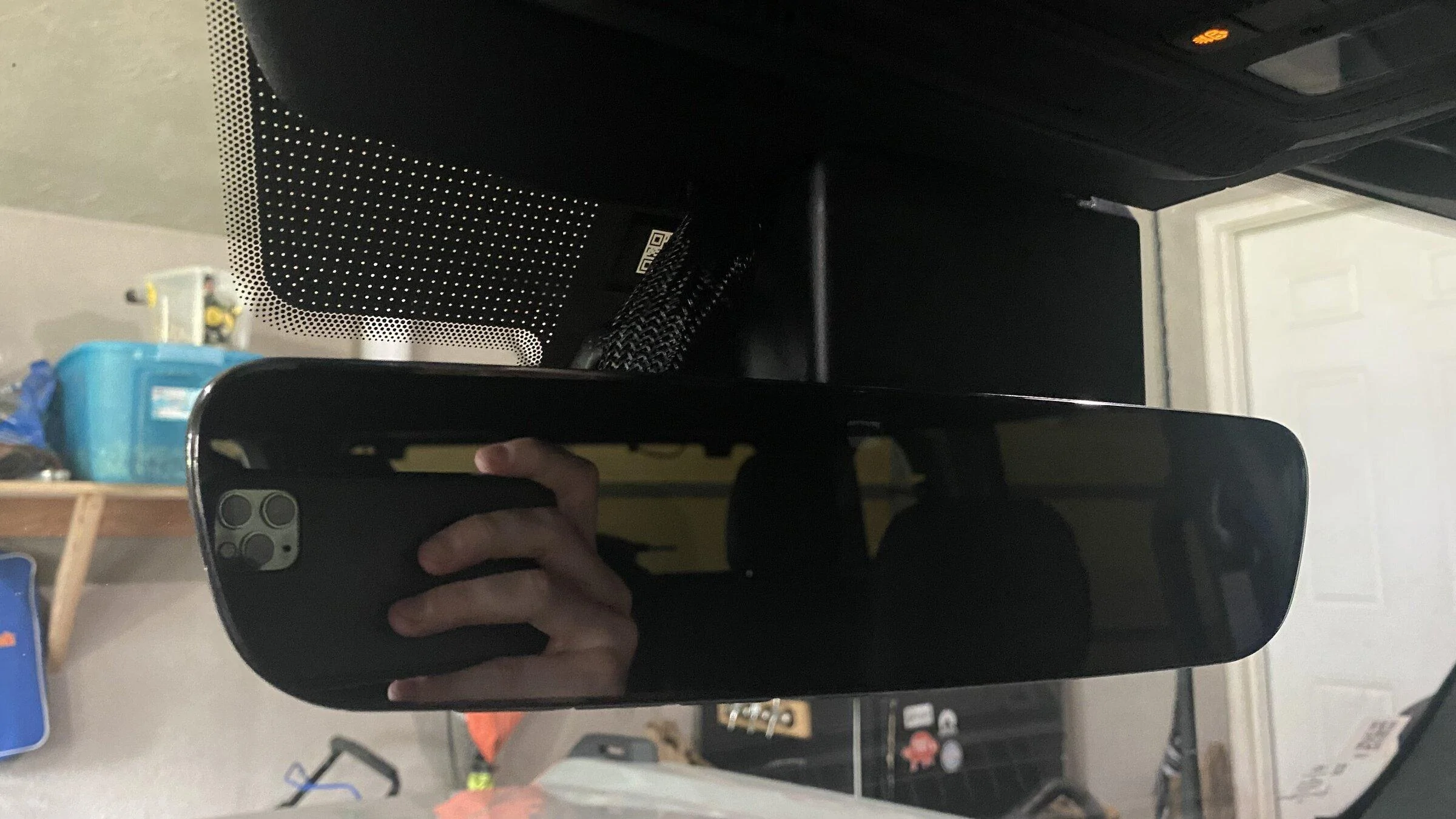

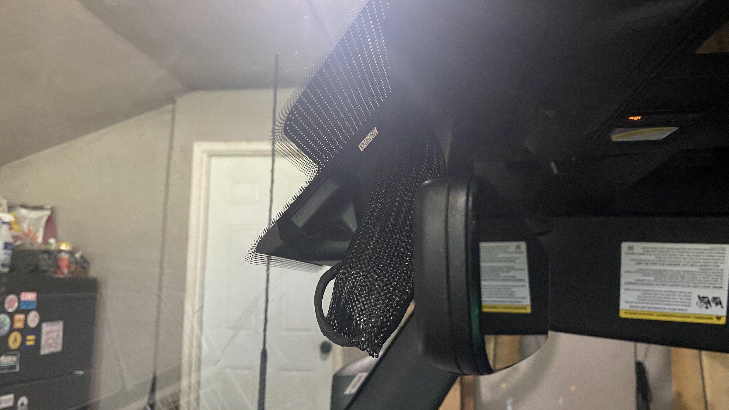

Ford Bronco Rearview Mirror w/HomeLink 20230113_133640

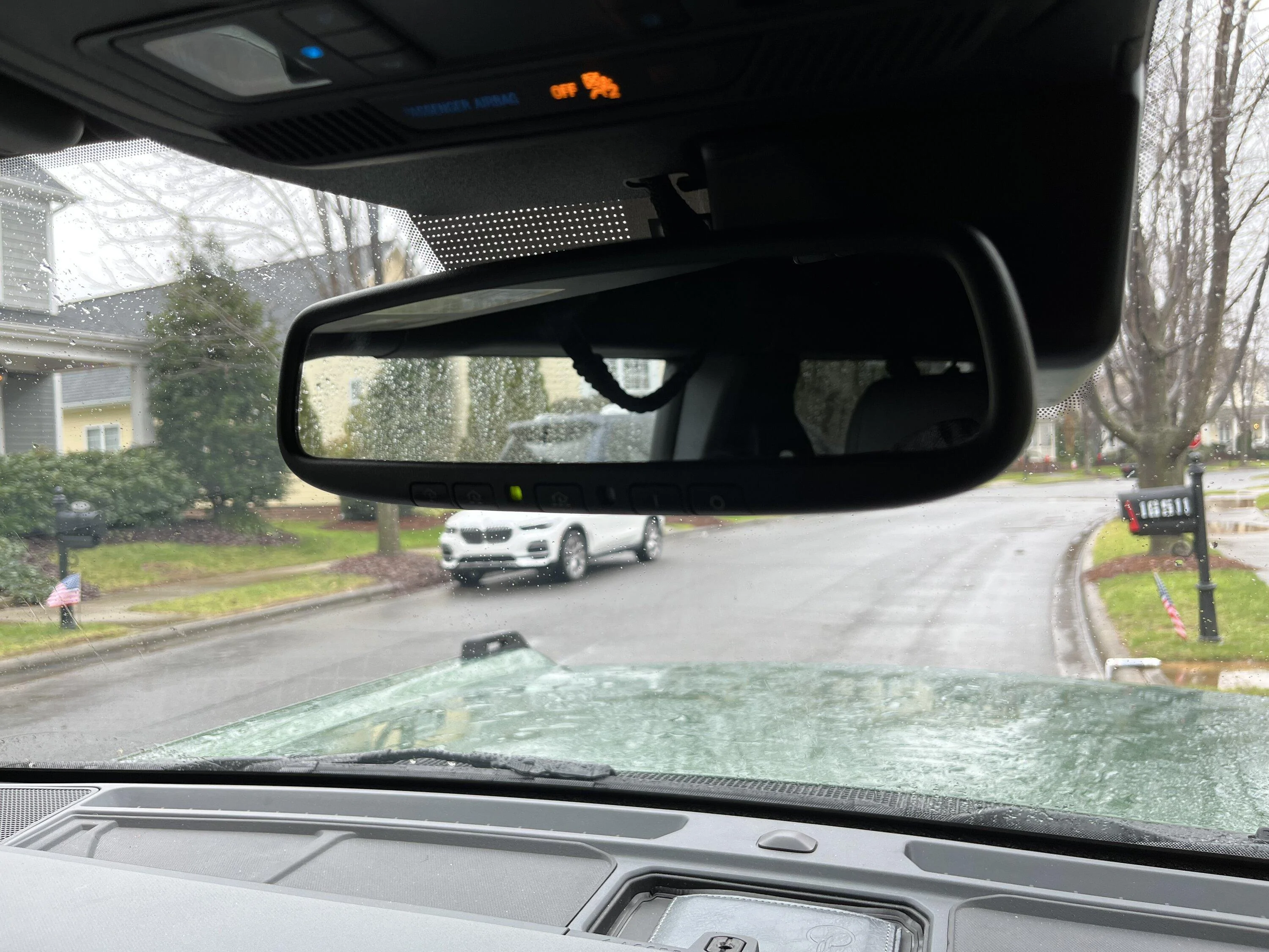

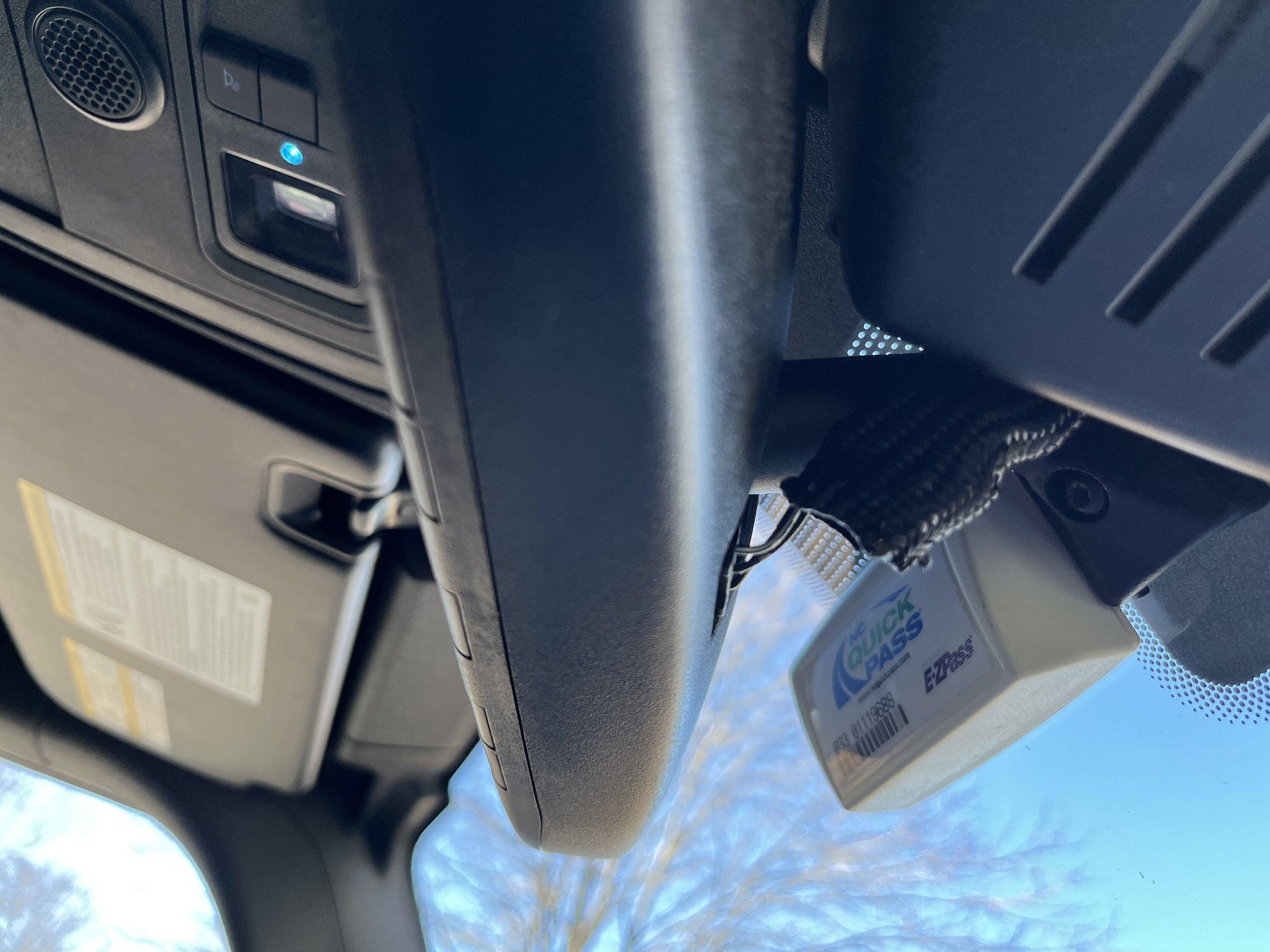

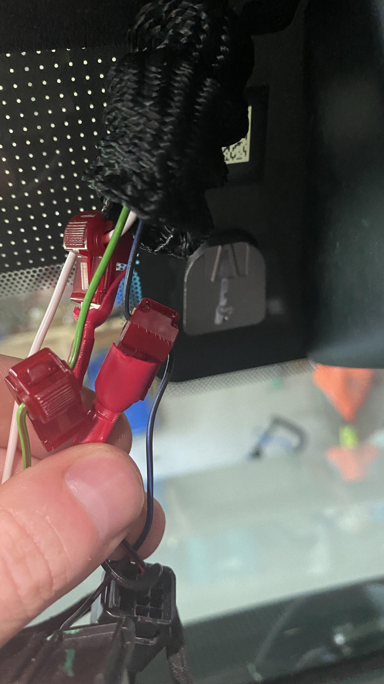

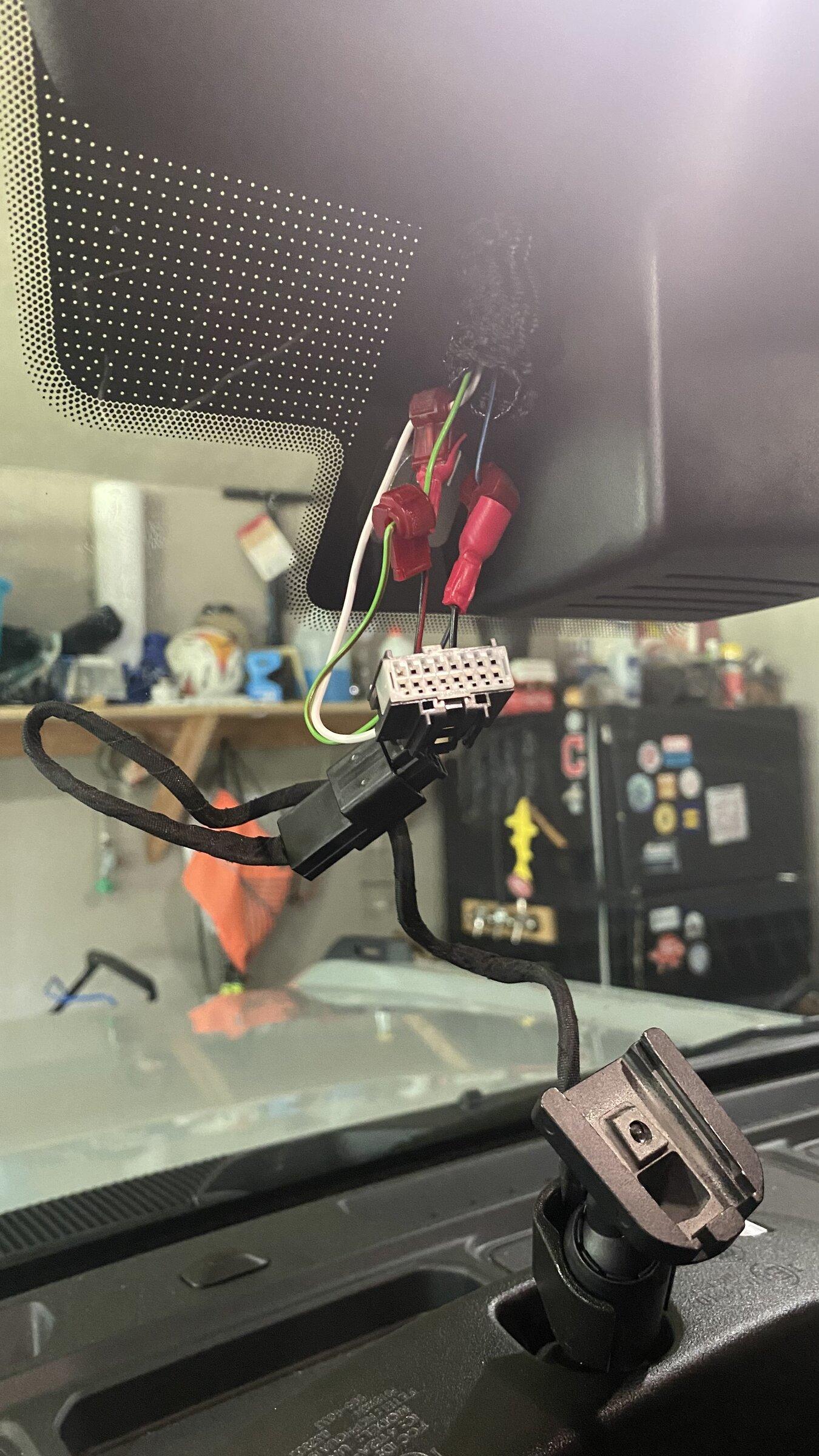

Look for one off a Nissan. Mine was from an Altima and only had 3 wires. 1 negative, 1 positive for Homelink and 1 positive for auto dimming. Hooked both positives to the keyed power and it works perfect. Took me about 20 minutes and looks totally stock.
Ford Bronco Rearview Mirror w/HomeLink F2D6A471-44B2-49C8-83AE-B4EA409FCBBC
Ford Bronco Rearview Mirror w/HomeLink 48129744-C3BE-45B5-96DC-0EFC2762EAAB
