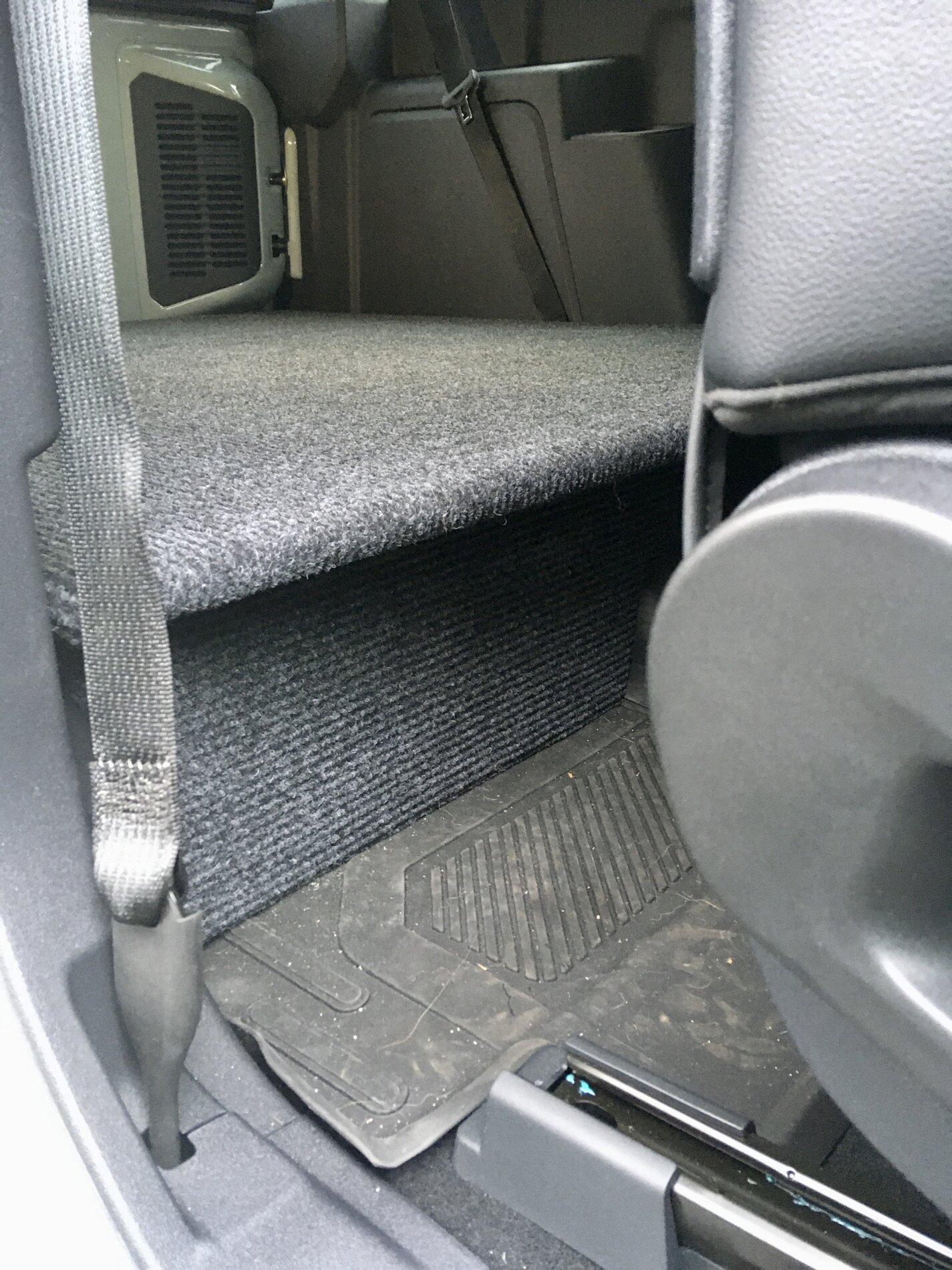

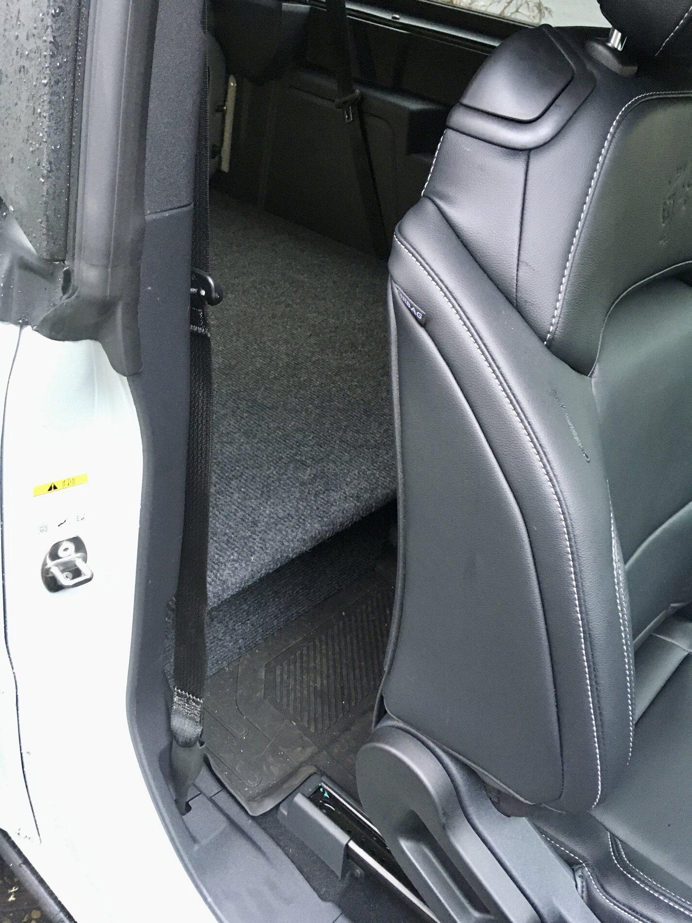

Nuked my back seats on my 2-Door and made a deck from wood to fit the contour. The deck fit just fine from the front to the back with out bolting down. Between the bolt tops, side seatbelt brackets and the rear tailgate lip it just fit level. Covered in a Lowes outdoor 5x7 rug cut down to fit. I have a working trapdoor that just needs just cut out that the carpet is still covering. Simple KISS design. Had to unbolt the speaker to get it through the back door.

Looks great! I understand the rear seats have wired sensors on them....curious what you did with the sensors to avoid any electronic issues or "warnings". Thanks

I just detach the seatbelt female end clip from the seats and plugged them back in. They tuck in fine under the factory foam carpet. No warning signal sent now.

Here is the front support. The boards velcro in place to the floor deck. This project cost lest than $100 bucks and is not bolted down, snug fit into place.
You did an amazing job! You could prolly sell this as a kit, or, at least a DIY Template project. I really like that it's not bolted down. Nicely done!!
