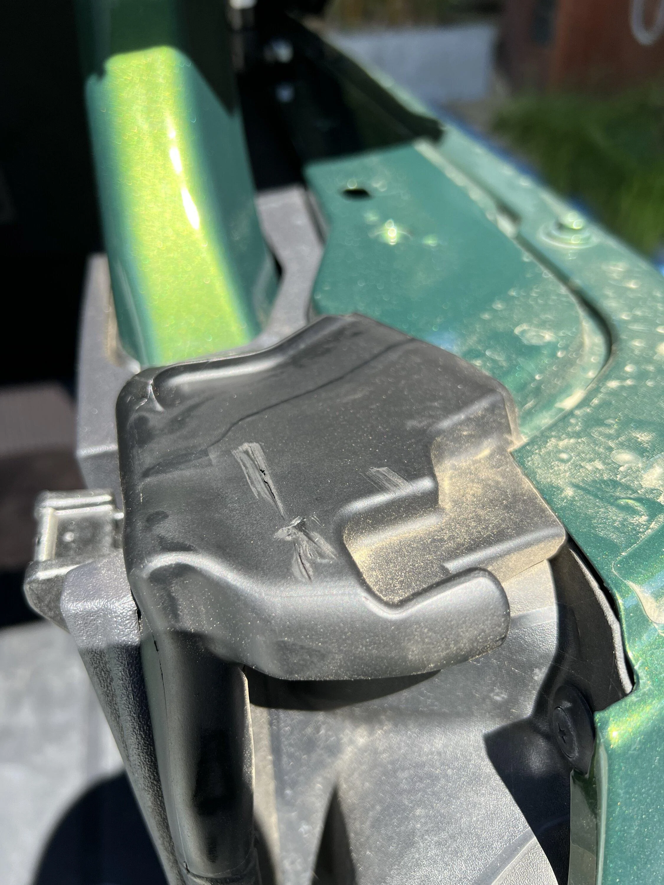

My soft top rattles some days from the rear. Recently something on the soft top has been cutting into the rubber on the passenger side where the soft top locks down in place.
I just noticed this as well. Only on the right side; not the left.
