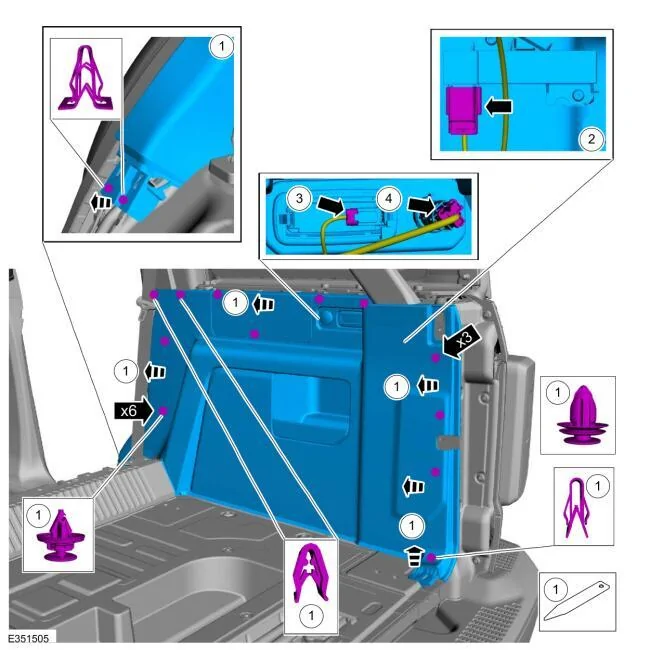

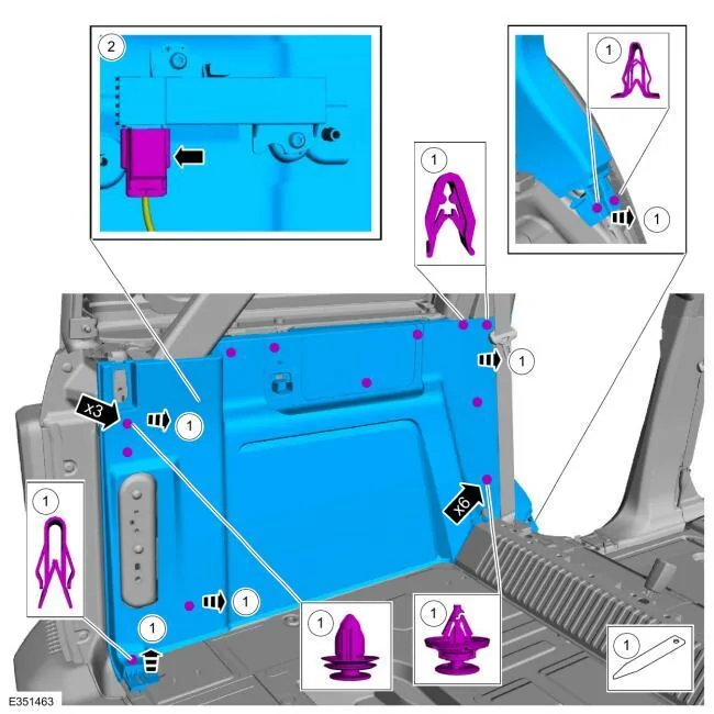

There are multiple PATS antennas in the rear cargo area. They may have forgotten to plug the driver side cargo area antenna back in when they put the panel back on.
Bat signal for @Ducati1098 .... cause I know he has a picture handy.
@Haelous
Not the best picture, but its near the rear top of the panel on the inside.
#2 in this picture

@Haelous
#2 in this picture
This picture makes it look like passenger side. Is that right? Moar Doar Wildtrak.
Just checking since Rag mentioned driver side.
Ducati1098
9,976
23,180
Midwest
Thats my bad, I copied the wrong picture. It is on the drivers side. Very similar though

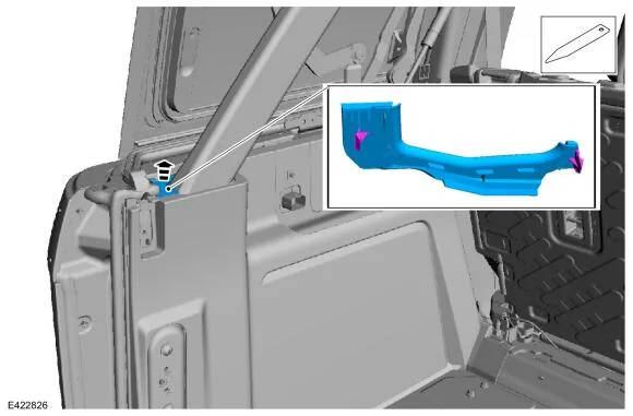

No problem. You may be able to carefully "peel" back the top corner to get enough room to reach your hand in there to see if it is plugged in or not.
Don't forget to pop this small plastic cover off first:

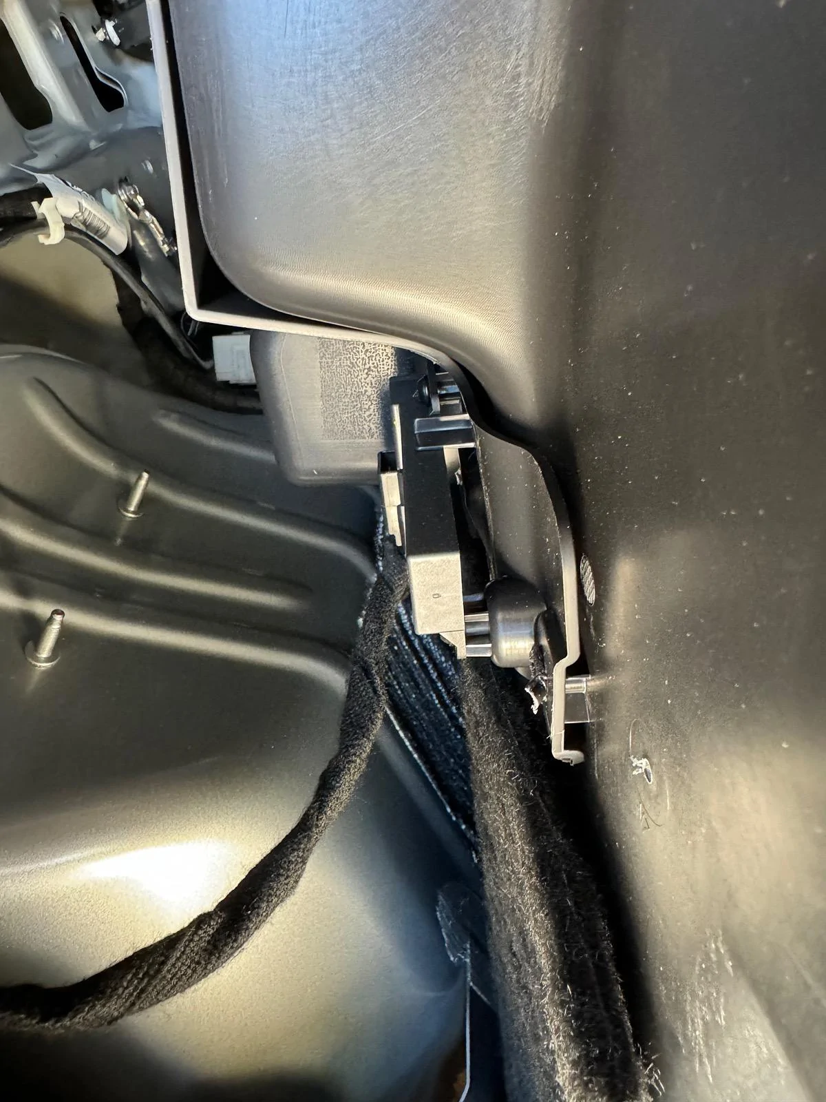

Just in case anyone finds this thread and needs another pic, the antenna is on the plastic trim panel.
