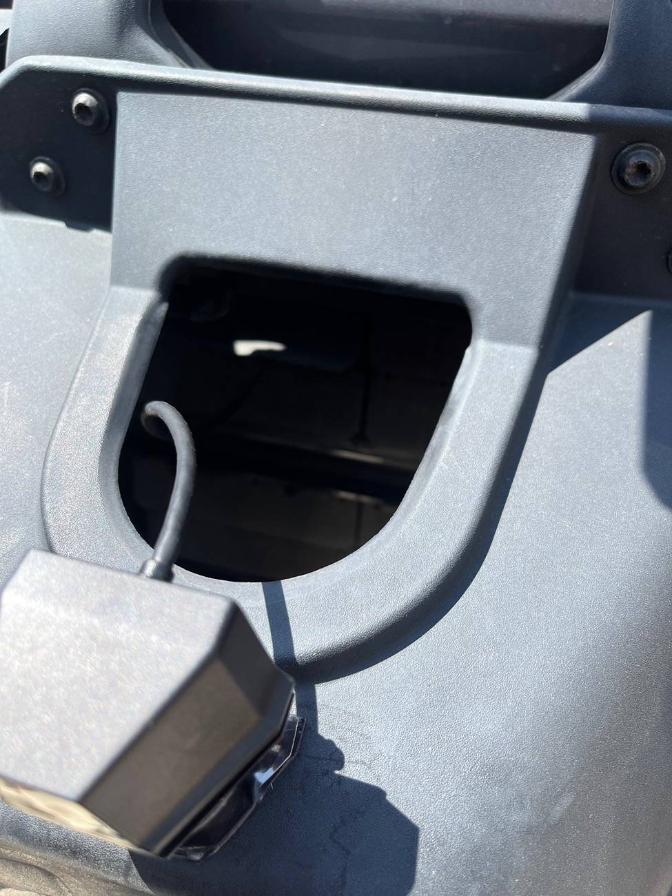

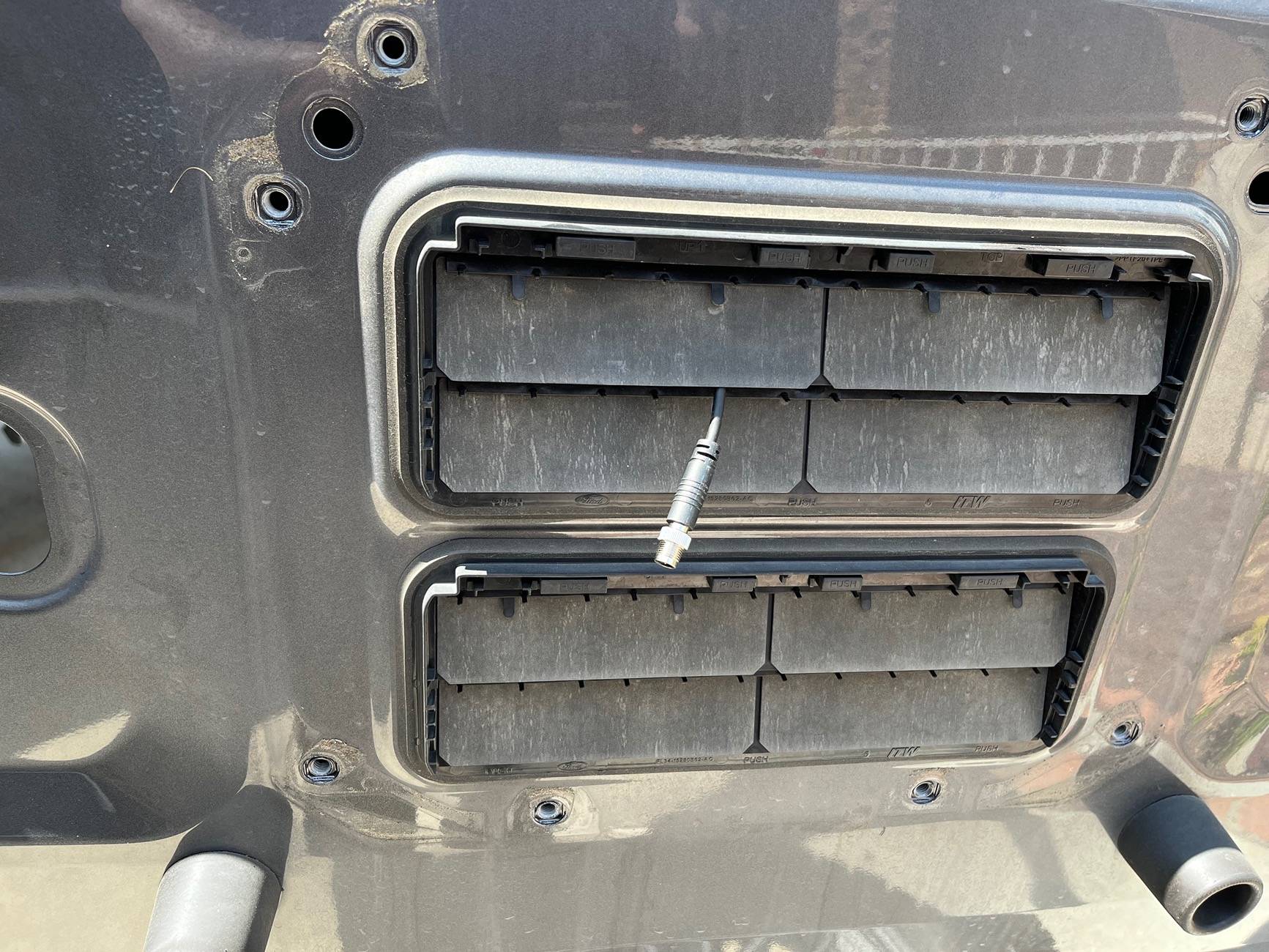

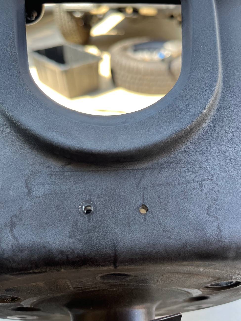

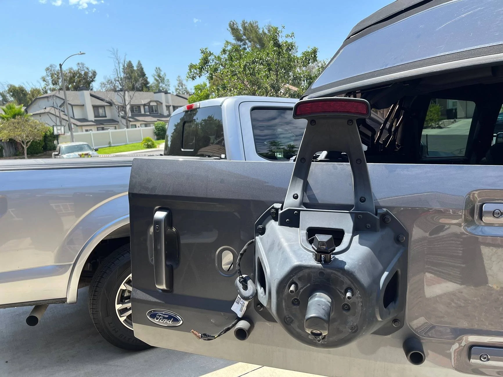

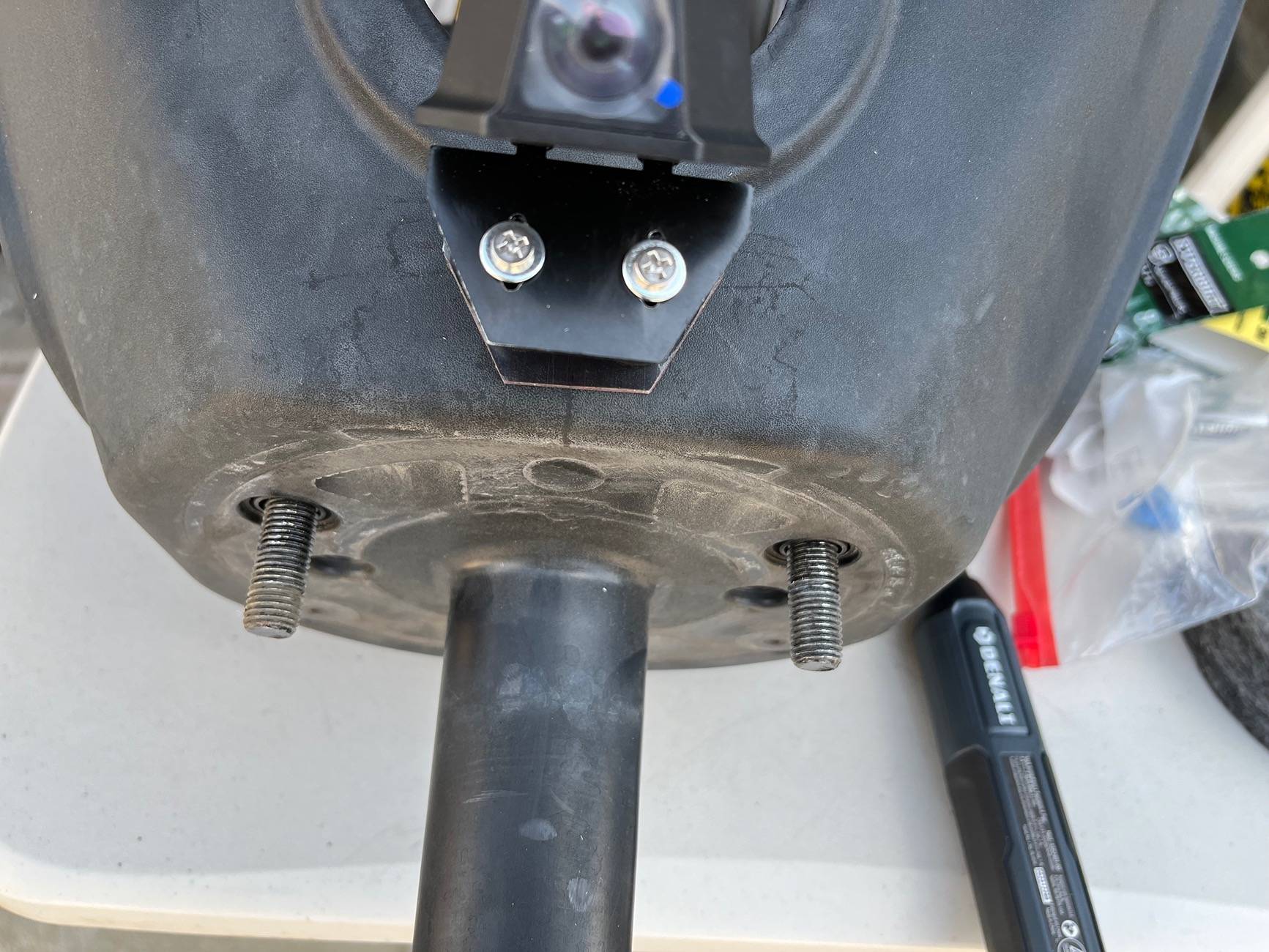

I love this! This is the camera my Uncle has and recommended. A couple questions;

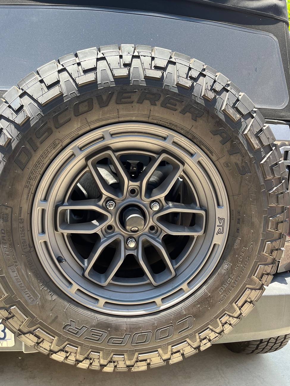

How is the view for the rear camera? With the placement, I am curious if there is a "tunneling" from the aftermarket wheels.
How long of a cable did you get for the exterior camera?
I am considering this for my Bronco, but possibly down near the license plate.

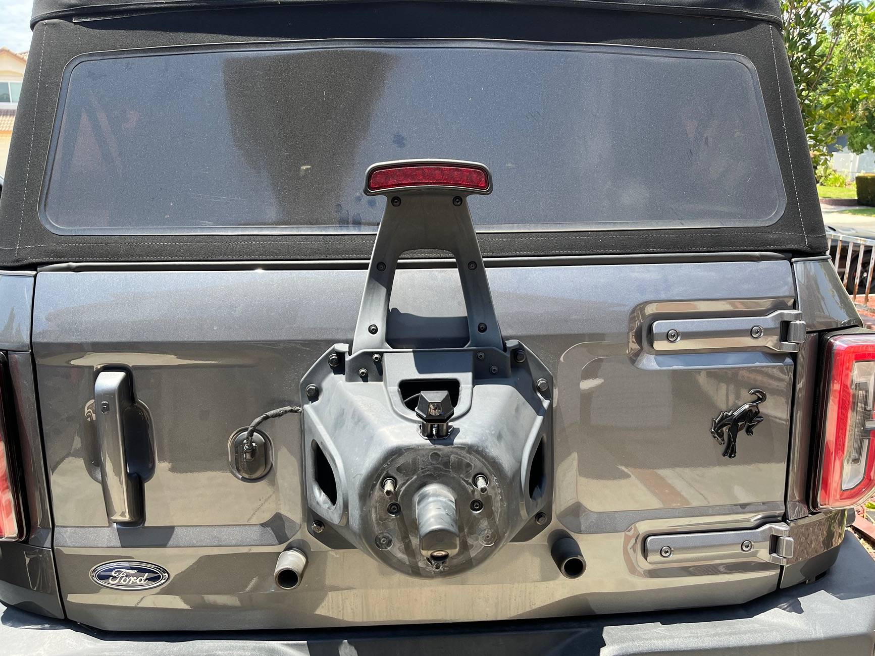

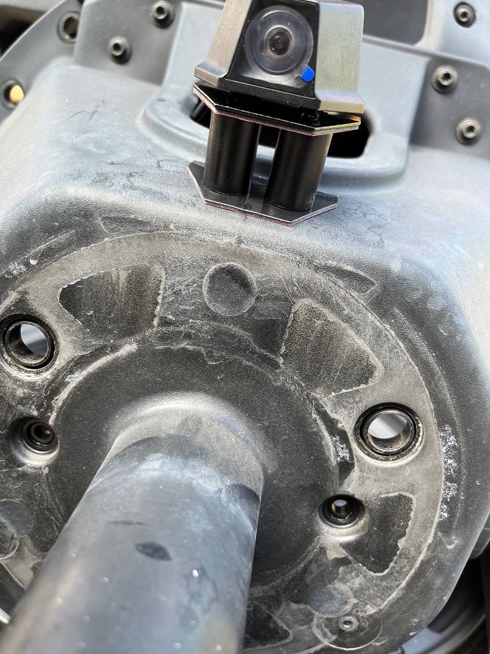

Yes, there is a slight visual tunneling effect because of the wheel. However, it allows me to see an area the width of my vehicle which is all i really desired for potential rear end collisions.
The length of the cable was 9.5 meters (i have plenty of extra cable coiled and hidden in the tailgate). I could have easily gotten away with using the 7.5 length but i wanted the flexibility in case i switched locations later.
