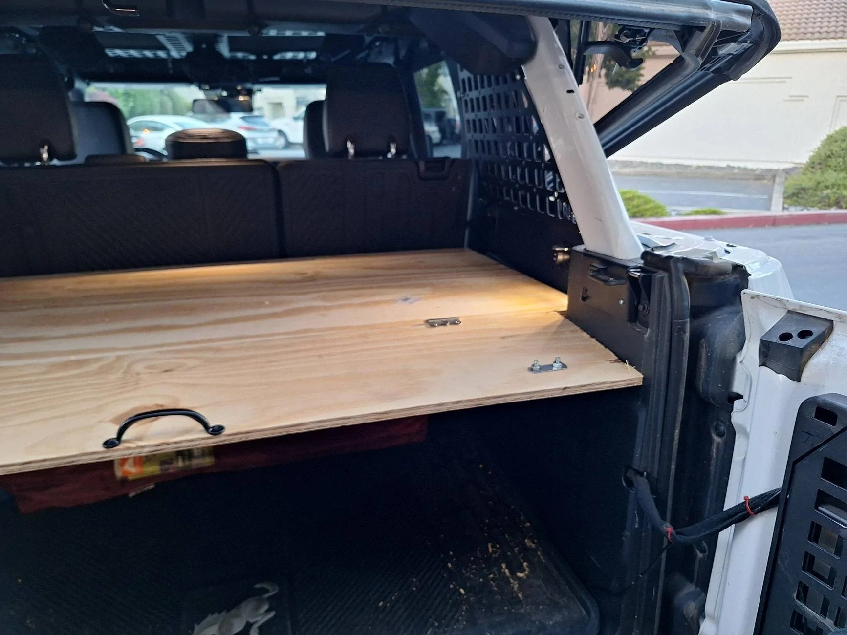

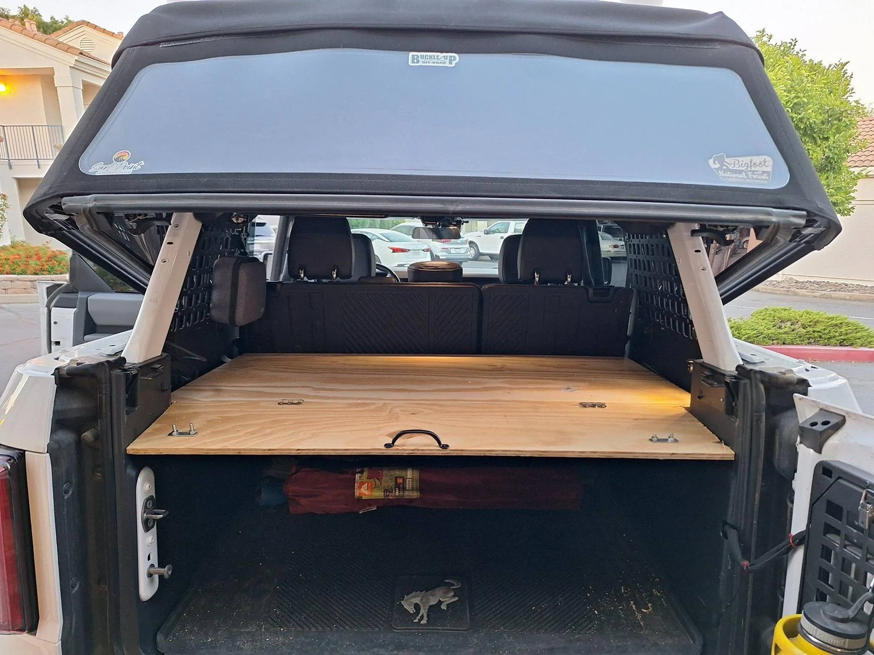

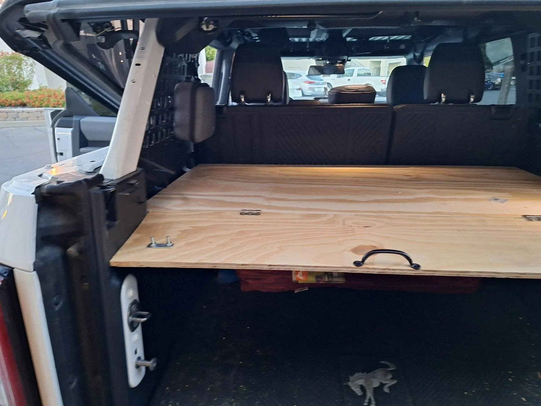

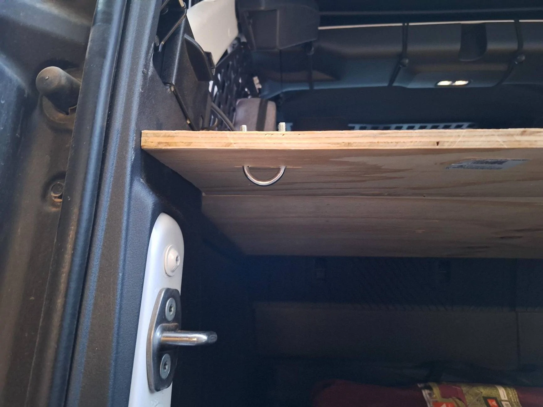

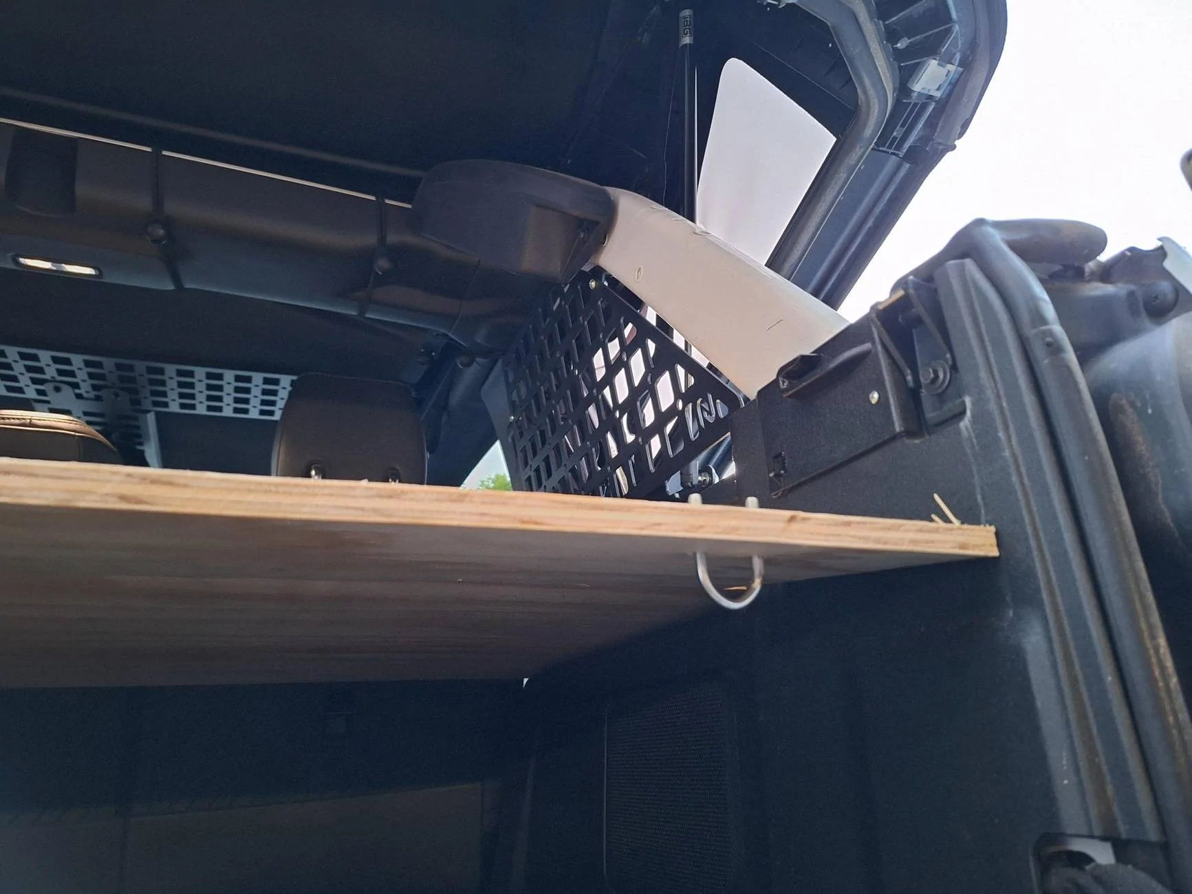

Well here is what I ended up doing tonight. I finished by adding 15 inch chains to the underside connecting to the tie down points. For $50 I feel like this was a successful little project.

That's not a bad idea. Is it just wedged on the plastic to hold it up?

The portion closest to the back seats are just sitting on the moulding ledge on the sides of the cargo area. The portion closest to the tailgate, I actually put a small nail into the driver side moulding to hold it up and avoid hitting the bulging out part of the tailgate (driver's side) when I close the tailgate. I may cover the entire thing with a fabric, felt, or may even paint it. The portion closest to the tailgate is a separate piece and I put hinges on it, so I can open it and put things into the cargo area without opening the tailgate.
