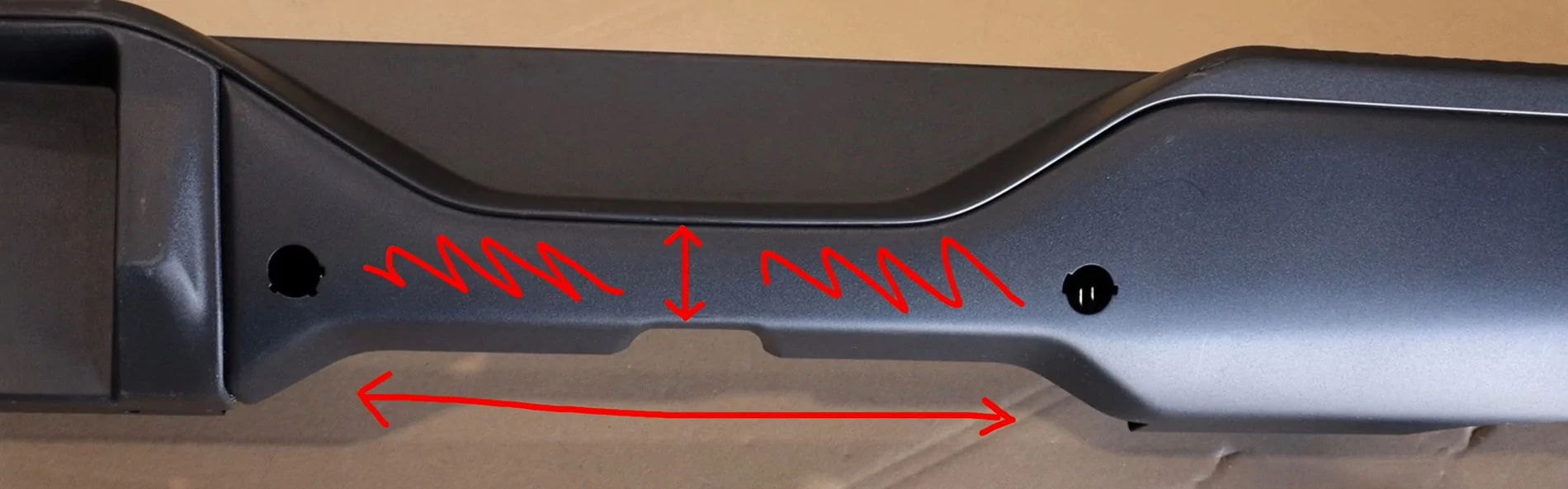

Hello, im still waiting on my ‘26 to show up and dont have an actual car to measure the following myself so I wanted to see if anyone here could give me a hand.?
Im trying to obtain these dimension on the rear bumper. Look at A photo it looks fairly even but i dont have a good profile view.. I’m trying to determine if Diode Dynamics SS6 flush mount light bar could fit there.
Much thanks in advance!

The bottom arrow is about 15” side to side in the flat.
2 1/4” for that narrow area.
Between the sensor holes is 15 3/4”.
On my 2024 bumper.
