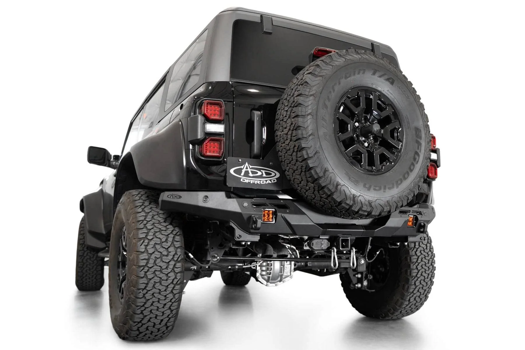

Getting a bumper that has cut outs for bumper lights, I don't wheel often and almost never in the dark but may do it in the future.
Should I put in floods or spots?
