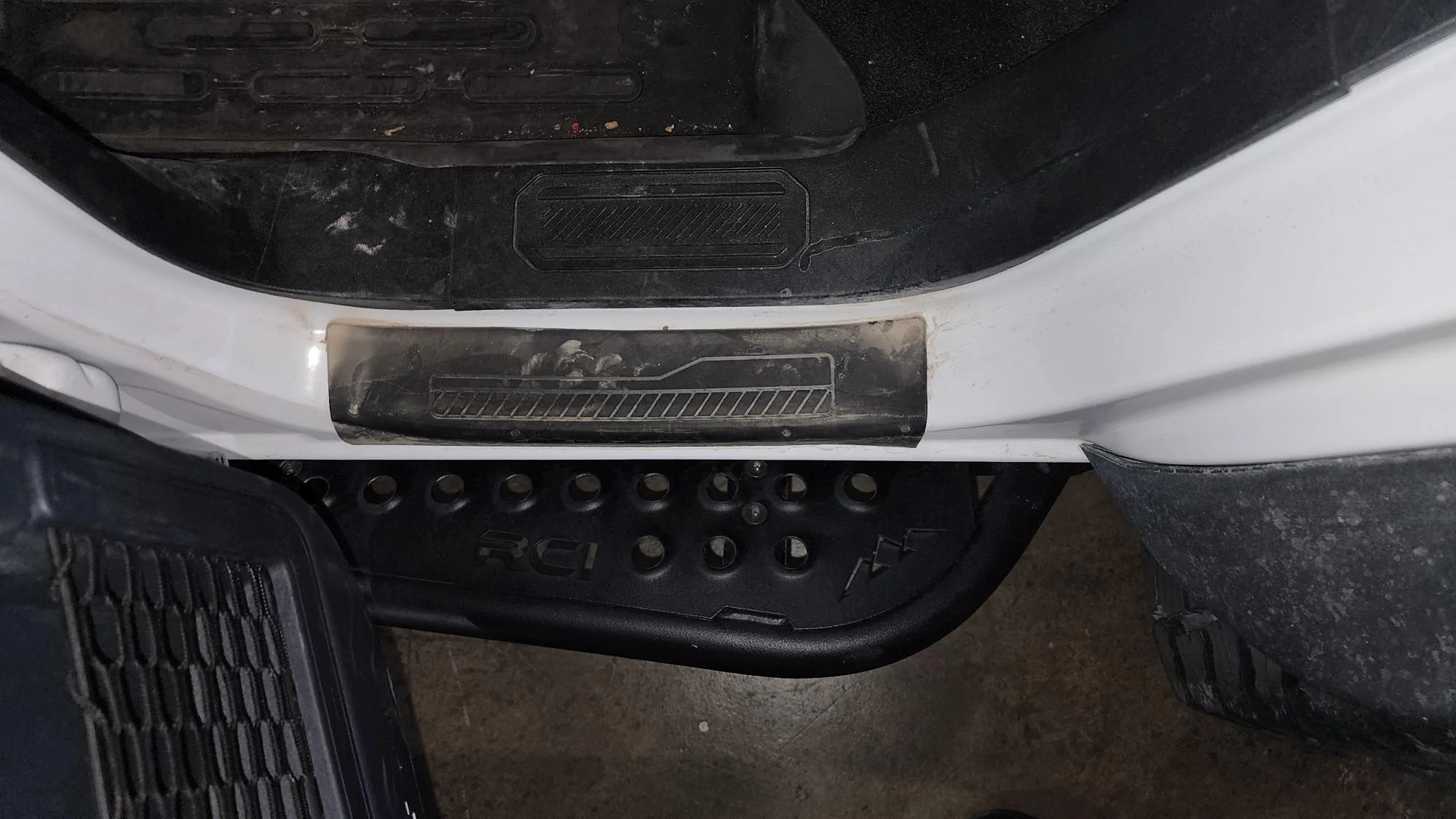

Non-biased initial review after install for the RCI 20º slider for the Bronco.
Ordered and received in about a month and a half. Surprised at how simple the packaging was, no foam of any sort to cushion the sliders. Just one sealed thick plastic with the end corners plastic wrapped. First to arrive was the passenger side, noticed while opening the box and plastic, the leading edge already had scuffs but wasn't a big deal but could have been avoided for sure.
Ford Bronco RCI 20º slider post install (LONG READ) 20231017_165634

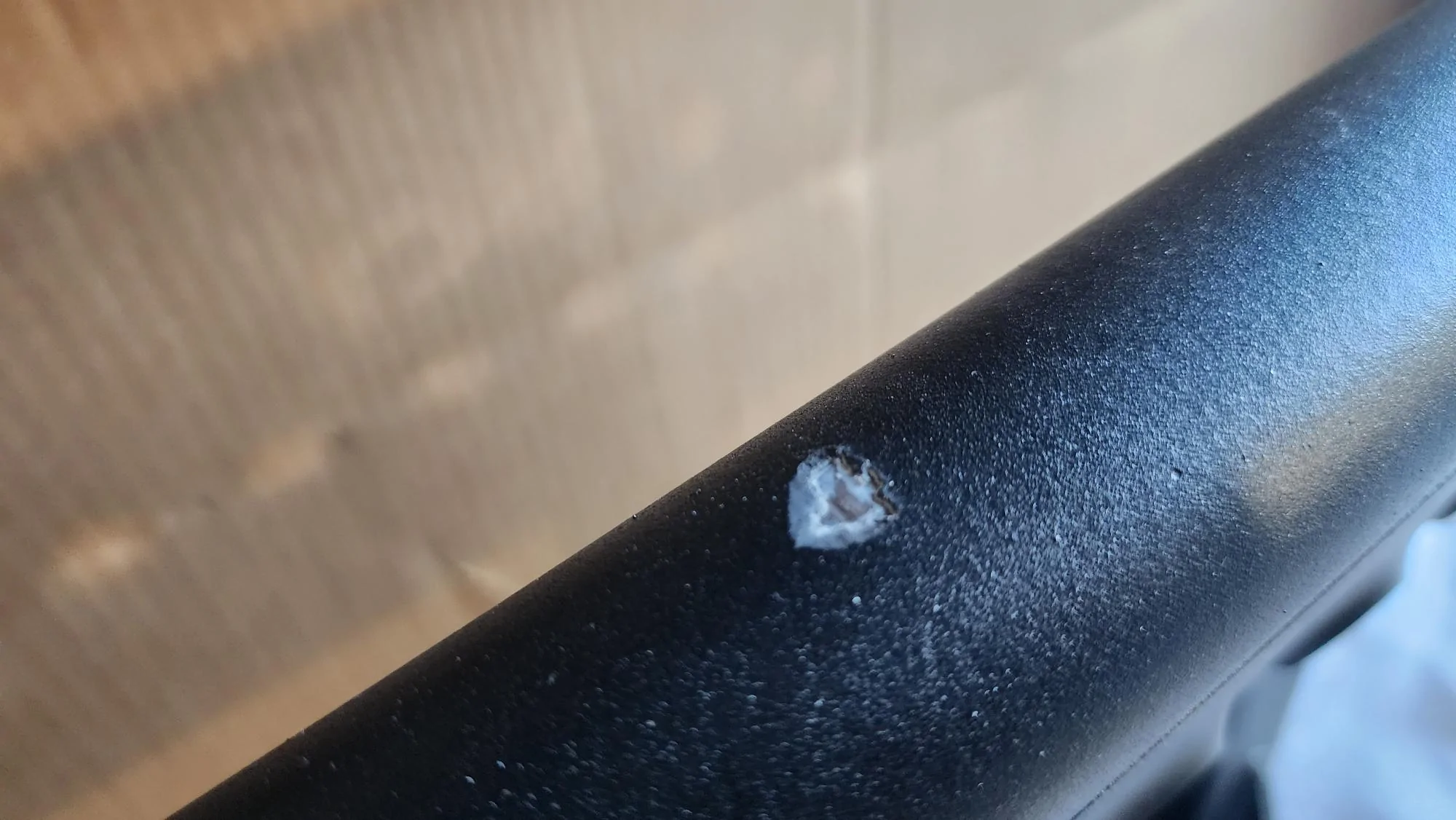

Then noticed a nice sized chunk taken out of the powder coat maybe a 3rd of the size of a penny. The plastic that wrapped the entire slider did not have any visible damage, makes me wonder if anyone at RCI noticed the scuffs and damage. I know someone else mentioned something similar and notified RCI and was told to just paint it.
Ford Bronco RCI 20º slider post install (LONG READ) 20231017_165638
Ford Bronco RCI 20º slider post install (LONG READ) 20231017_170157
Couple days later the driver side showed up, had my install table, laptop with instructions, tools, drinks, etc. all ready to go. No damage that I noticed but the hardware package, main bag of bolts/washers were for a 2 door. Got on the phone and no excuses were made, RCI did as expected and priority shipped the correct HW pack for my 4 door.
Last Friday the HW pack showed up and I get to work using a 5 gallon bucket which turned out to be near perfect height. Along with my kids to hold the bucket and slider in place while I bolted up one side then the other. I had a constant doubt about if everything would go together smooth. I also was wondering if the slider would have enough room to step up on for passengers and myself. It does, makes thing much easier getting in and out of the rig.
I will say that I could not find a proper install video on YouTube however..... The instructions from RCI are pretty damn good when viewing on a tablet or pc. The delay on parts gave me plenty of time to review how it all gets attached and I think I went over the instructions at least 8 times lol.

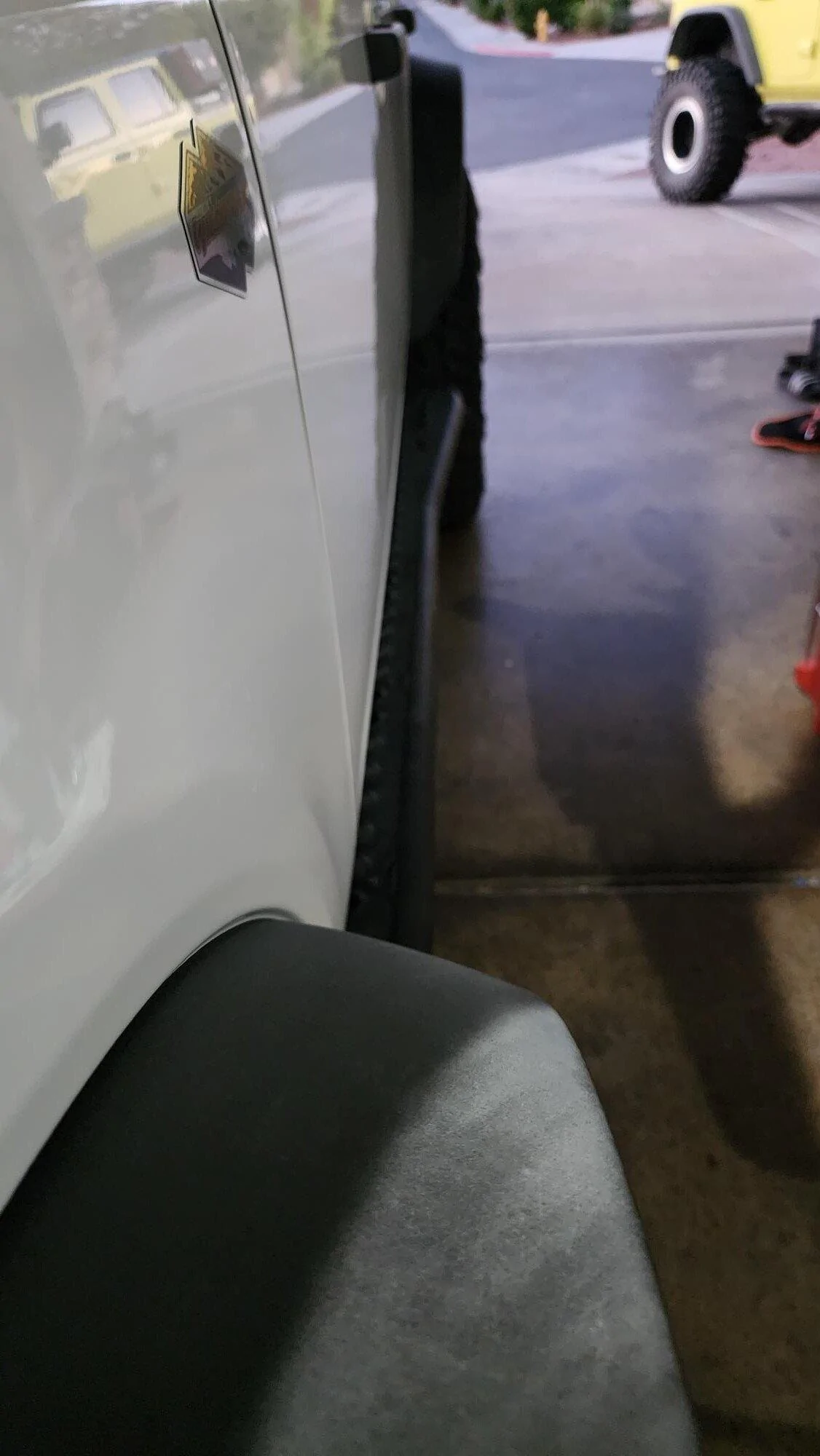

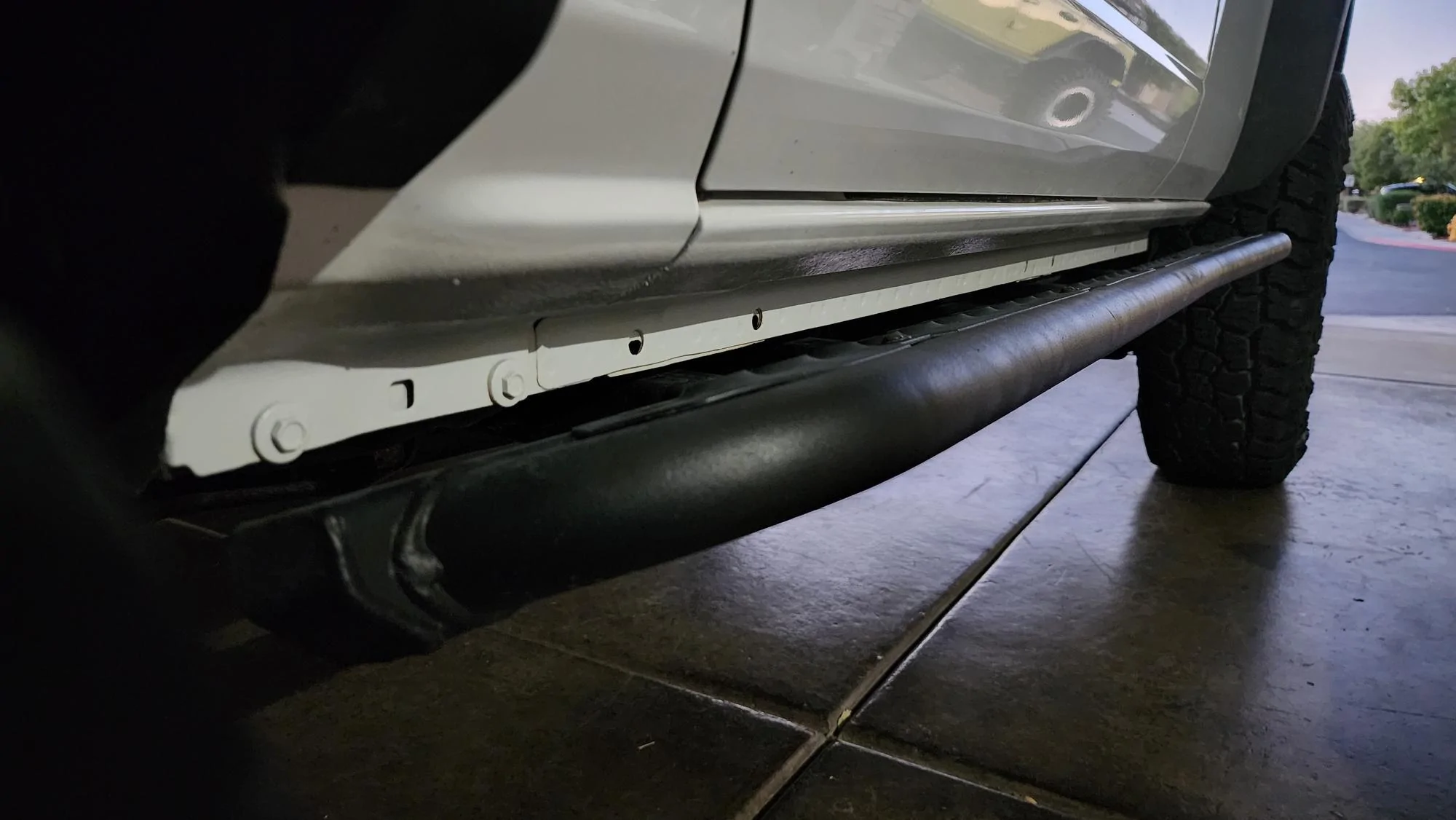

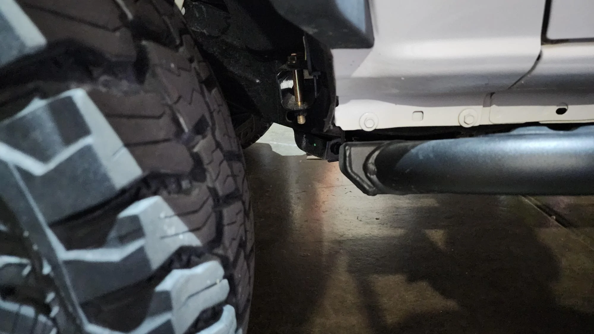

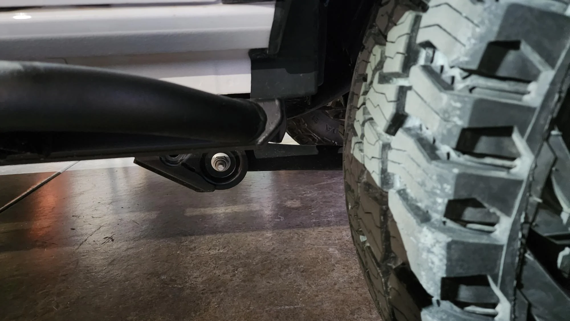

ZERO fitment issues, no problems lining anything up, no modifications of any sort. These things are strong as expected out of the box. I have a more purpose built rig for banging down on things but this will eventually have its test as well.
Closer view, keep in mind this is on 37s
Ford Bronco RCI 20º slider post install (LONG READ) 20231023_063817
Ford Bronco RCI 20º slider post install (LONG READ) 20231023_063940
Front fitment
Ford Bronco RCI 20º slider post install (LONG READ) 20231023_063914
Rear fitment
Ford Bronco RCI 20º slider post install (LONG READ) 20231023_063905

- Already damaged upon arrival, and due to the undamaged plastic, it must have left RCI this way (WHAT AN EYE-SORE)
