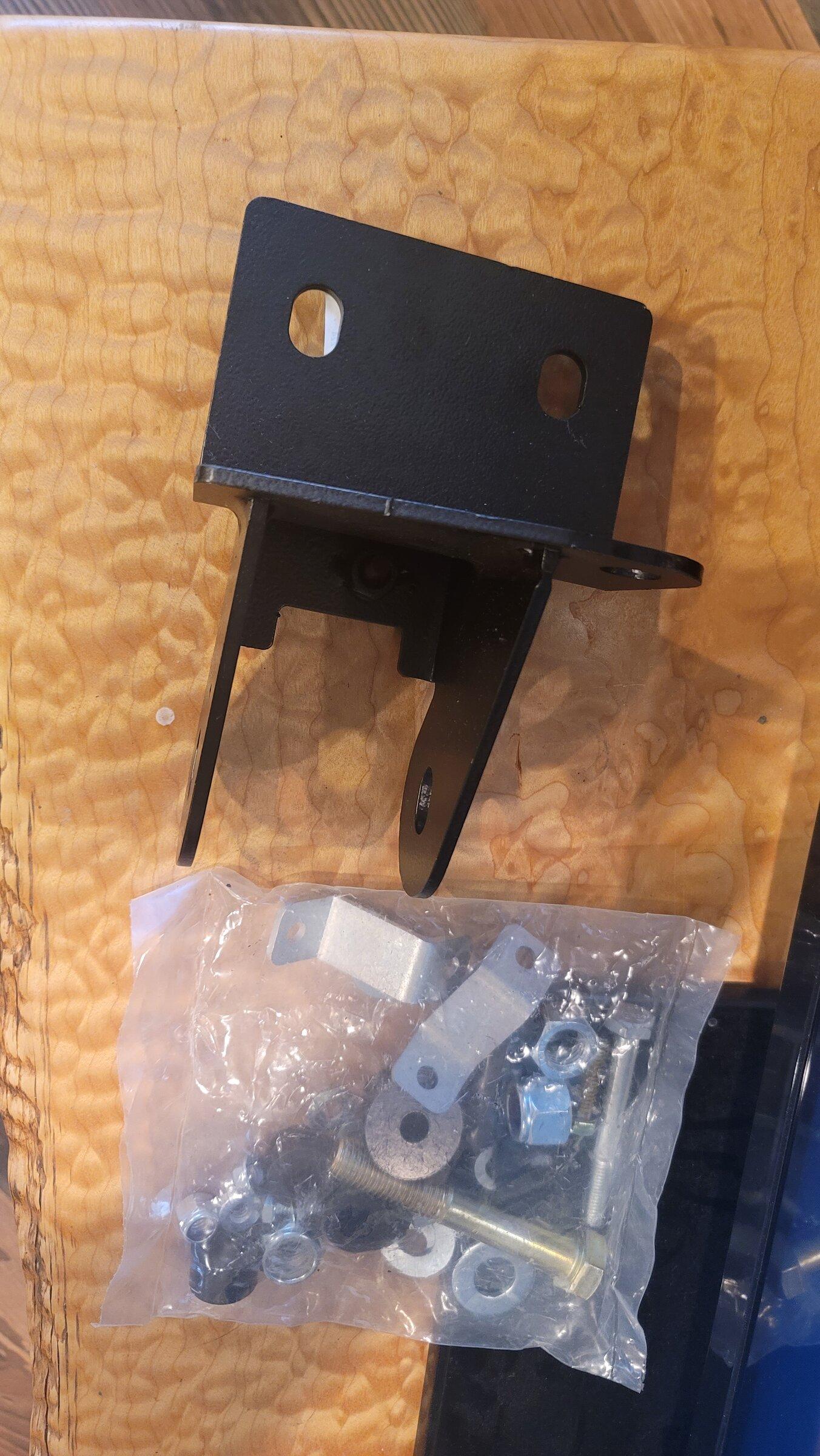

Thank you for the update.

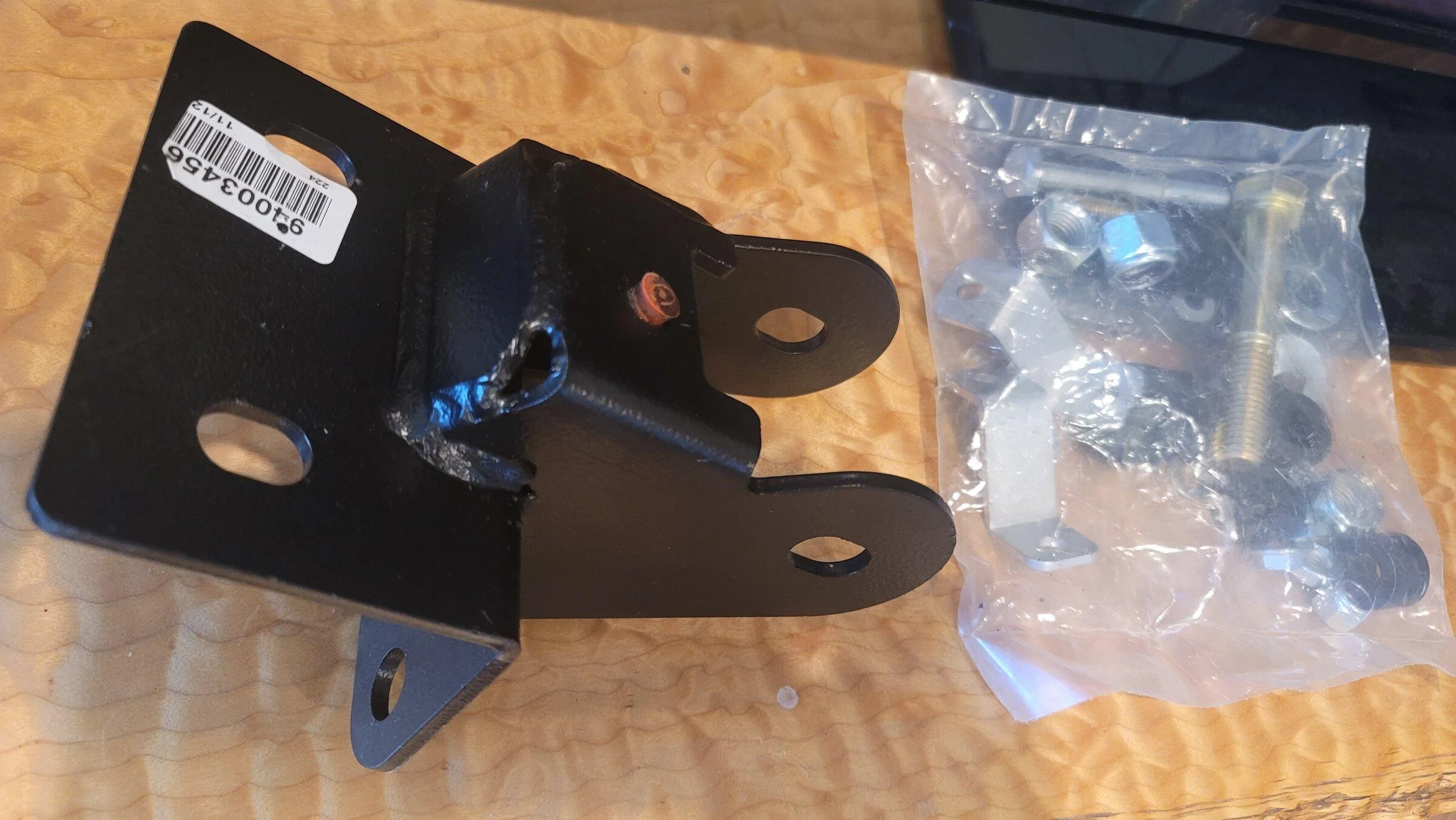

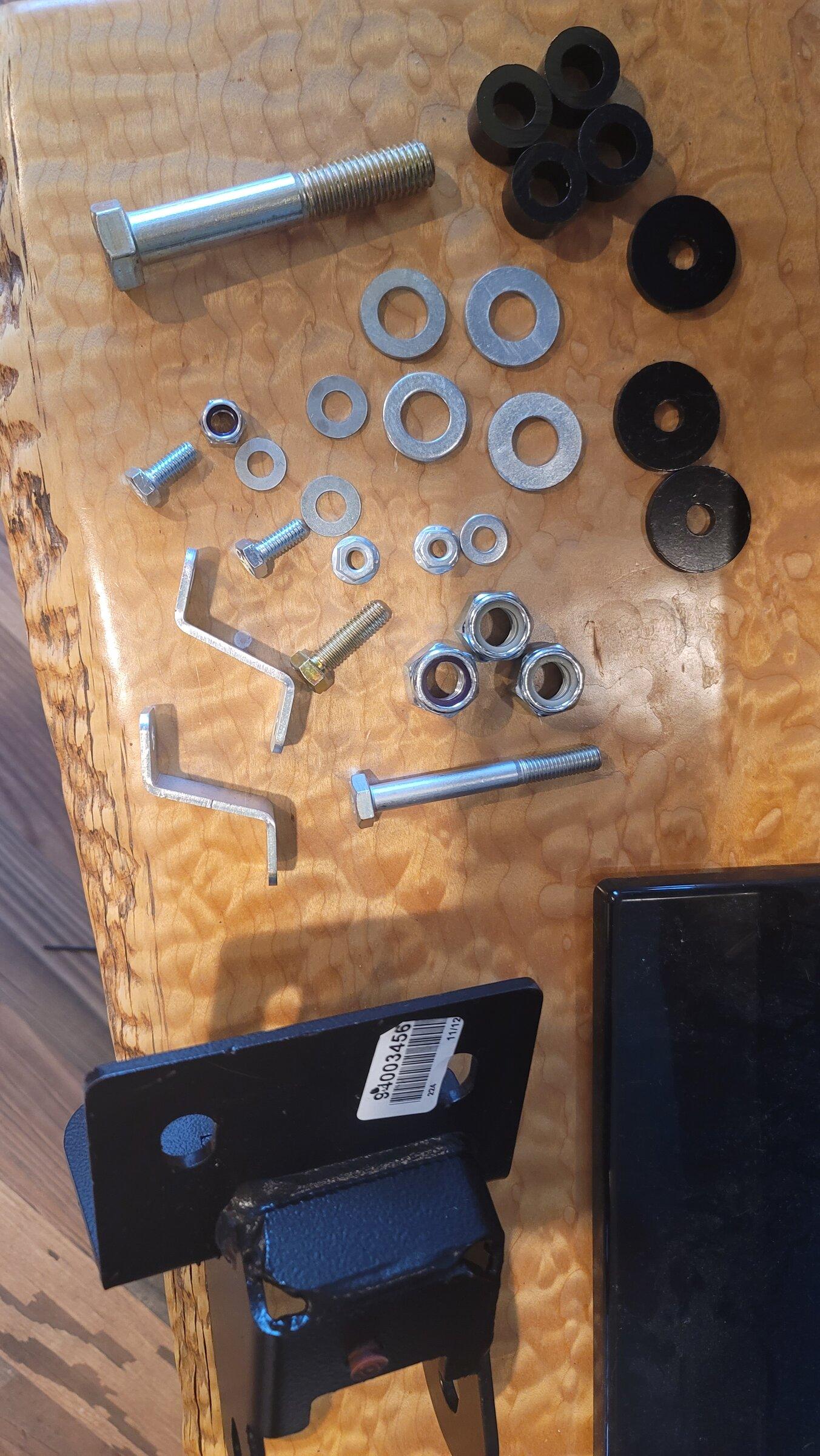

It's pretty much what I thought. The kit only drops 3/8" (two 3/16 washers).
I think RC has determined that max droop CV is pretty much met with the 2 inch kit (Base,BB,OBX). In order to get to 3.5" on the kit with the diff drop they added a spring pre-laod. But, they didn't want to overdo the preload (0.75" preload x 1.47 ratio = 1.1 preload lift). So the front spacer is bigger than the 2" kit (1.8" vs 1.6"). The added lift from the bigger spacer is 0.2" x 1.47 = 0.3".
Given that the preload does not add to droop, they put in the mini diff drop to avoid binding from that additional 0.3 inches of front end lift.
I was thinking of ordering this to use with my RC 2 inch lift just to keep the CV angles down, but after the comments, I'm not sure it's worth the effort...
Yeah it would be more cost effective to just cut and re-weld the factory front mount. And source some spacers and new bolts .
The front two mounts are easy no Brainers, the rear mount is the one that's a bit more technical, and tricky.
I will be adding some reinforcement to the rear mount and the passenger side mount also, as I've witnessed other rigs in the past complete destruction of the factory IFS mounts under very hard off-road trails. And once everything is bent outta wack, it's difficult to get it back to factory ideal positioning again.

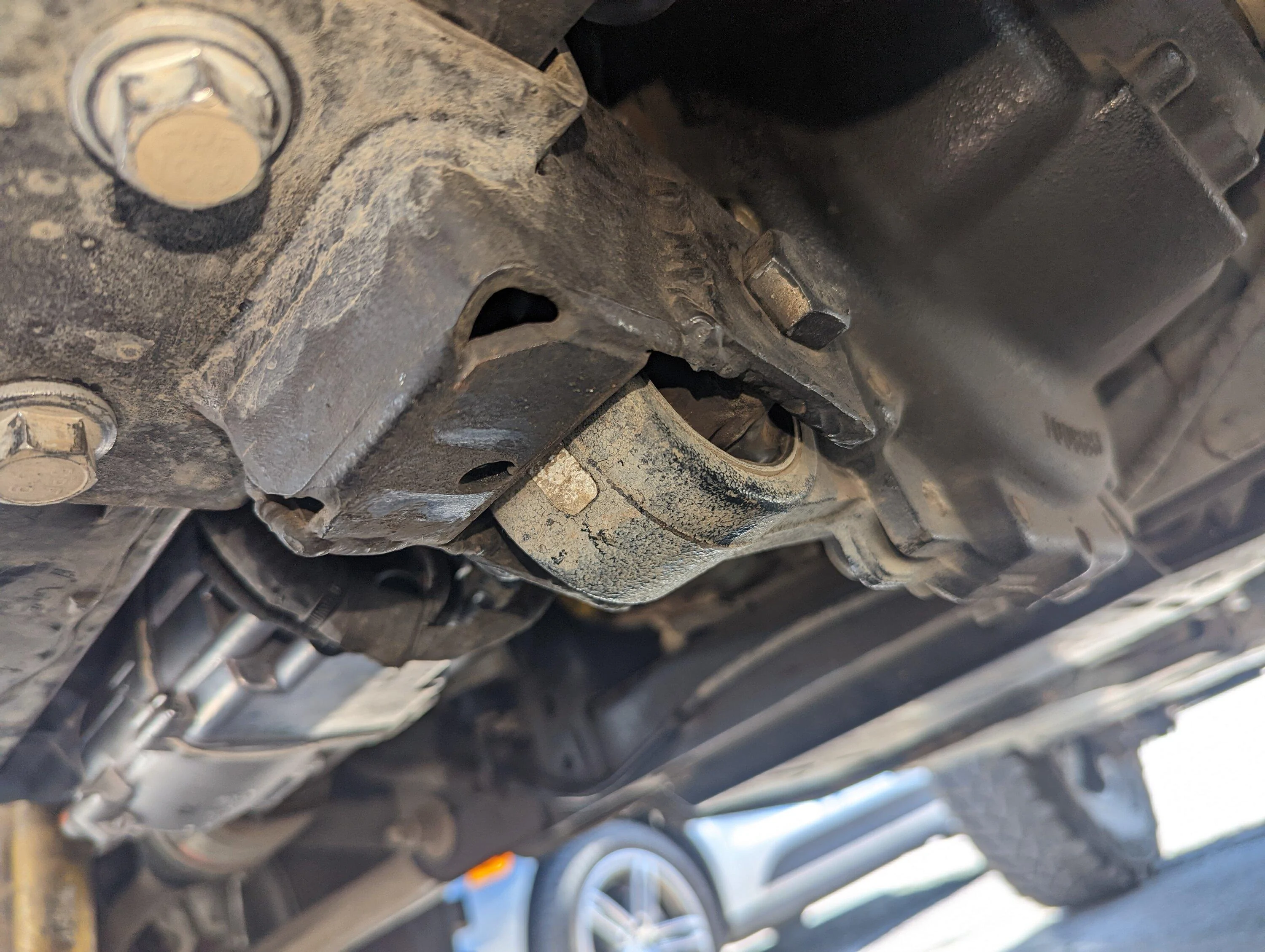

Here's a better pic of the rear diff mount repositioned UNDER the frame plate.
Ford Bronco RC diff-drop kit arrived! 20220430_064647
Ford Bronco RC diff-drop kit arrived! 20220430_064622

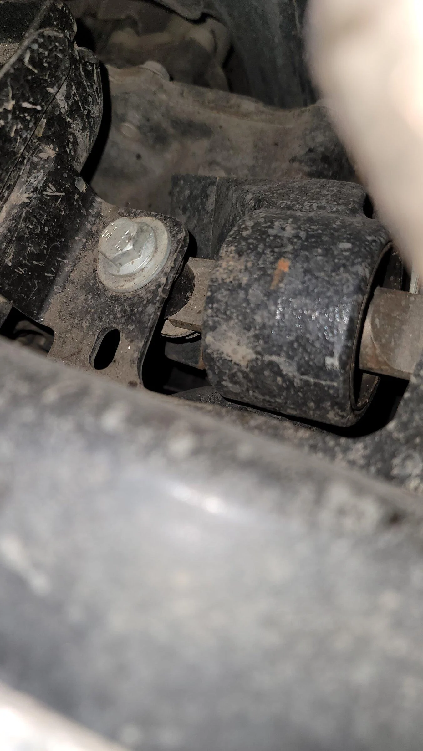

What did you do for the front mount to get to 1.5"?
I have the King coilovers and get clicking of my CVs when I'm at full steering lock at normal ride height (4" lift or so).
A "Z" bracket could be easily made to move the upper rear mount down. Something akin to a leaf spring "shackle" could be fabbed up for the front lower mount.

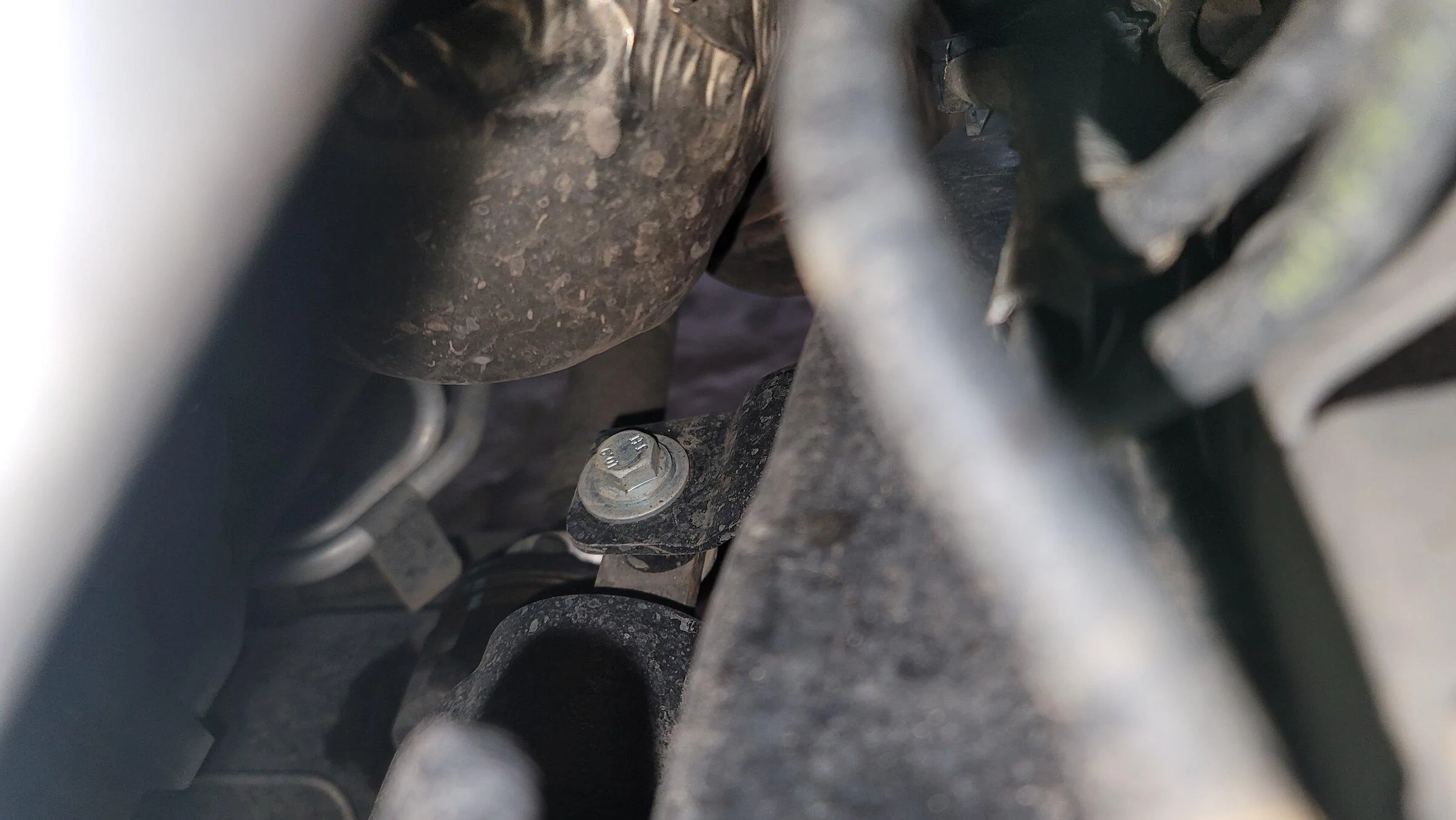

On the forward drivers side mount I cut the RC mount up and basically built a spacer and re-welded the bracket with the bolt hole in a lower position. On that passenger side a longer bolt with spacer and washers.
Ford Bronco RC diff-drop kit arrived! PXL_20220824_193743408
