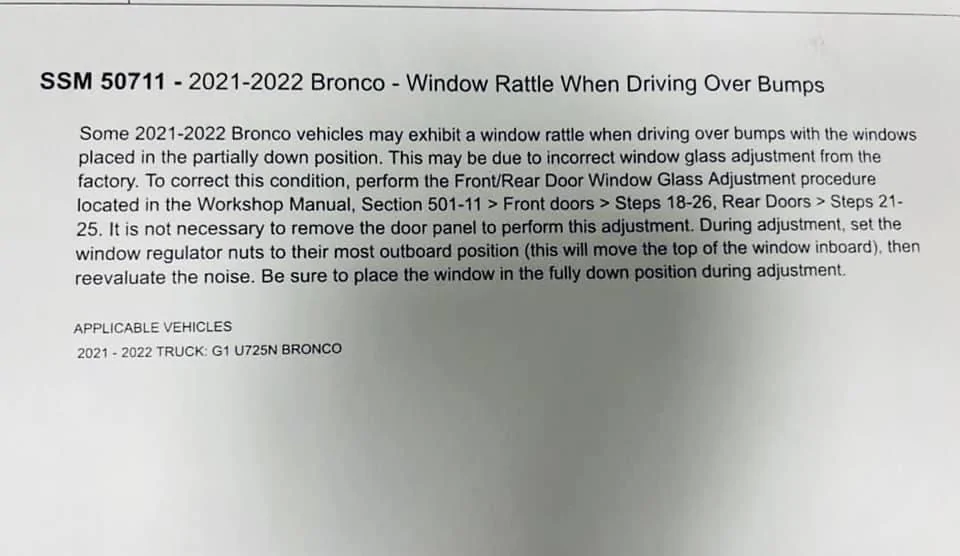

Saw this on a Facebook Bronco group.
I've seen this floating around, and am hoping someone has access to the procedure.
If the panel doesn't have to be removed, I am wondering if the adjustments can be performed at home (if no special tool is required).
I’ve posted the window adjustment procedure on several other threads, here it is again. This is also used for the window caught on weatherstripping issue.
This is great! Thanks.
I'm glad the TSB specifies to adjust-only, rather than all of that measuring and math in the other steps! Whew!
That TSB and these procedures definitely needs to be a sticky somewhere (if it actually works and if they aren't already).
Those other math steps are for the windows catching. I’ve done it on all 4 of mine lol.
